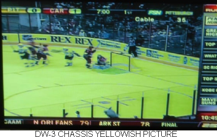

    I am repairing a Hitachi Plasma P50S601 and could use some help.
    A relative was watching the TV and the bottom 1/3 of the screen turned yellow and then the whole screen went black with the Blue LED flashing. She had to unplug the set to restart the TV and it worked fine again before going black after a short period of time. This repeated itself a few times until now when turning it on, the screen is just black and the blue power LED stays constant and on. She doesn't know how many times the LED flashed providing a fault code.
    I did my forum homework and read about the normal bulging capacitors on power supply and bad buffer boards with this model TV. The capacitors were bulging and measured 2800uF out of circuit when they were supposed to be 3300uF so I replaced them. I tested both SDR buffer boards by checking the continuity of the small caps at each IC and they were all fine. Unplugging one board at a time made no change either. The power supply Vs and Va voltages only read about 3.8V. Vcc is fine at 5.1. I'm thinking one of the boards is either pulling the power supply down or the power supply isn't getting the ok signal from one the other boards and not coming on. I've already tried a different power supply and no change. The TV responds fine to the remote control commands and the audio works as well. Any suggestions on which board to try next? YSUS or main board maybe? Both YSUS and XSUS boards don't have any grounding when checking Va, Vs, Vu or Vcc on them. Sorry so long but thought I'd get all the info out there. Thanks!

      Here is some trouble shooting information
      Any Time Vs/Va voltages do not appear and a test is made, each time a new test is to be made,
      • Press the Power Button and Turn the Plasma OFF.
      • Wait until you hear a "Click".
      • Unplug the CN68 connector.
      • Re-Plug the CN68 connector. If this is not done, the Turn On command for Vs/Va at Pin 7 and 8 of
      the CN68 connector will not happen.
      You can unplug both upper & lower buffers, do the reset and then mointor the vs or va while turning on the tv, if the voltage comes up and stays up, I suspect one or both of the buffers, try each each buffer by it self reseting P.S. between tests, If the voltage comes up for a second and drops off I would suspect the ysus being bad and possibly one or both buffers.
      A Yellowish-Green picture or highlights Can be caused by the logicboard

        Thanks for the guide and information. Using it, I've confirmed that all voltage readings are correct on the CN63, CN64, CN68, and CNPPS connectors except for the Va and Vs Power Supply voltages on CN64. I checked the turn on commands from CN68 pins 7 & 8 and the Vcego at pin 7 is correct and working but I'm getting no output from the logic board Vsago at pin 8. I've tried unplugging the CN68 connector to reset the logic board several times but it has no affect. I've even tried many combinations of unplugging certain boards and then resetting the logic board but still never get power on pin 8. I tried a jumper wire to force pin 8 on which does cause a change but the Vs and Va voltages on the power supply then fluctuate and never stay consistent. I have 2 power supplies and I don't think they would both be bad. I'm leaning towards replacing the logic board. Any thoughts?

          I replaced the logic board and now get the correct Vsago turn on voltage and also finally get a picture on the screen. However I am getting some black horizontal lines from a few IC's on the upper buffer board and some off color vertical bars in two spots. The Vs, Va, and Vcc voltages on the power supply are now constant but are way too high. I'm not able to adjust the voltages down anywhere close to the correct reading. I'm thinking the high voltages are causing the lines and bars but I'm not sure why the voltages are off so much. Both of my power supplies read high. Any thoughts where to go from here?

            The horizontal lines were corrected by reseating the ribbon cables on the upper buffer board. The discolored vertical lines were corrected by reseating the ribbon cables on the new logic board for the lower ABUS-B and ABUS-C boards. I now have a good picture however the power supply voltages are still way too high. All of the power supply connectors show the correct voltages when the TV is in standby mode however they go high when the TV is on. I did notice the grounding pins on all of the power supply connectors show a voltage across them when the TV is on. I have been unable to find a short anywhere to be the cause.
