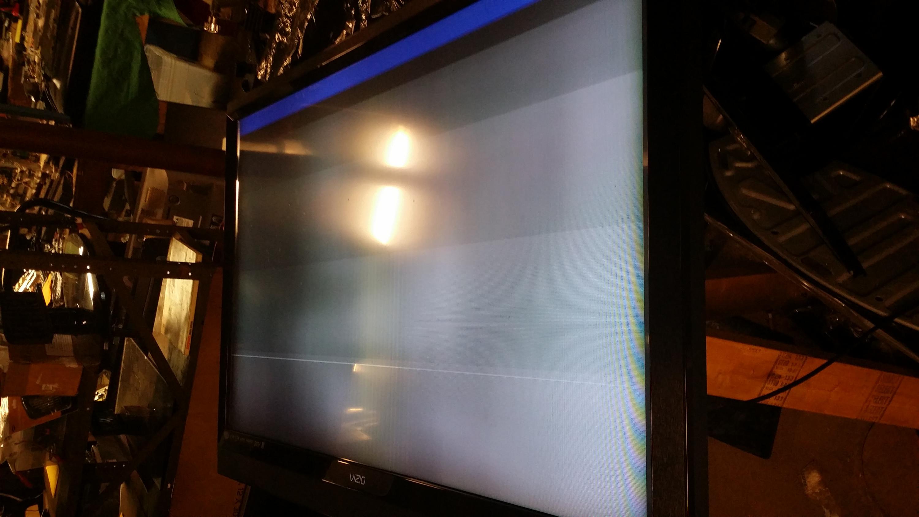

    got this vizio turns on with no problem customer said it still has sound but I don't know for ure if it does I haven't checked yet but my first instink was bad panel so I wasn't even going to try it. but once powered on it has the blue horizontal bar then slowly fades the whole screen to white or could it be tcon?
    Re: 47 vizio lcd bad panel or main?
    That is bad panel. Did you try having just one flat ribbon cables between the LCD panel and the T-CON board connected one at a time to see what you get?
