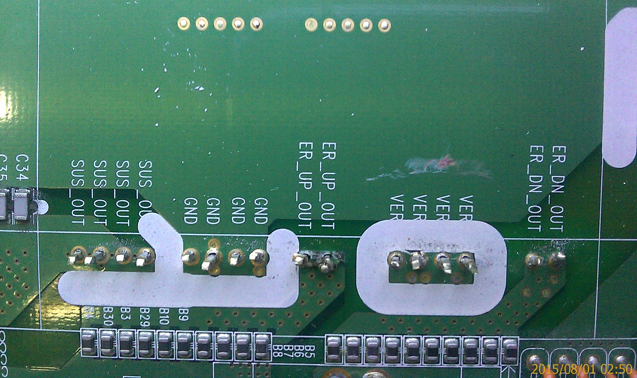

                  Re: toshiba plasma 42hp66 sound ok no picture
                  one question i do have is i removed the stk chip out of the board....using unconventional way since i dont have proper tools.....since i wasnt able to desolder it off due to two sided board and lead solder...i cut it out using a dremel tool and surgically removed it....but i ruined a few copper pads on top of board...can someone tell me if these pads are important .... here is a pic of z board with stk chip removed and i left the legs..
                  and was not able to remove the inductor copper coil....like budm said its almost impossible to remove but i was able to remove stk without removing it ....couldnt melt the solder since much of the heat just went through the whole coil and not where i wanted it to go
                  i hate lead solder and i hate double sided boards when trying to remove components....
                  • shelby5041
                    • Feb 2009
                    • 1505
                    • united states of america usa
                    here is a pic marked with pads that have been ruined...

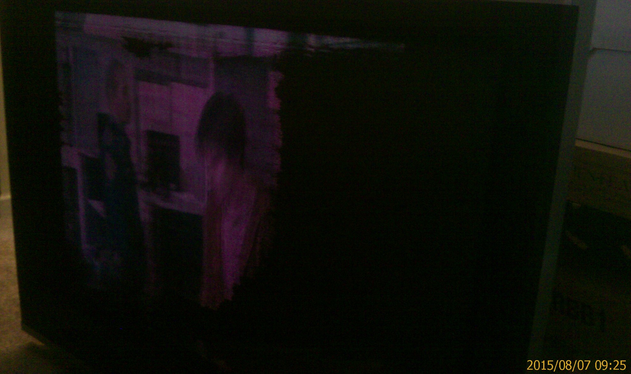

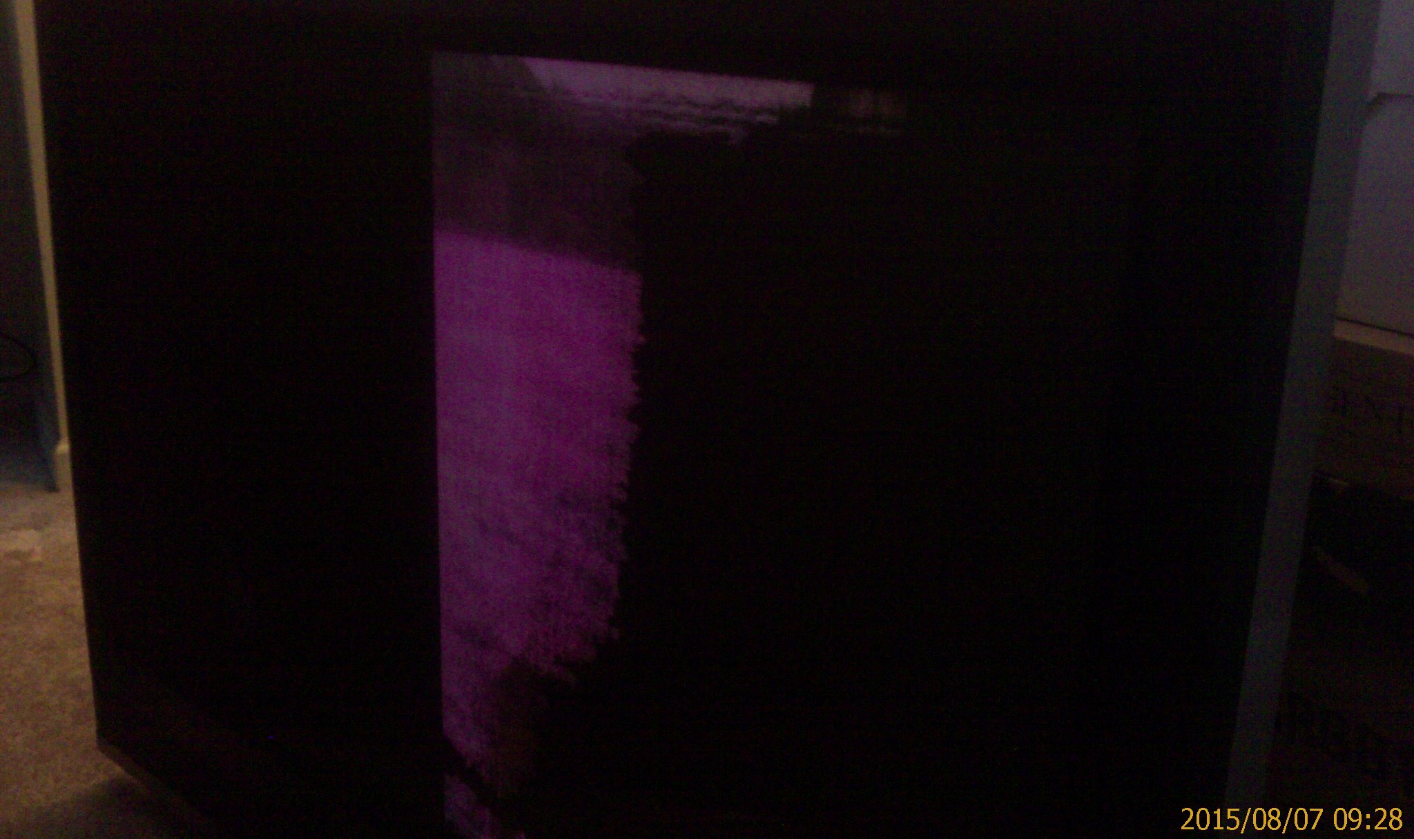

                      hi update
                      i ordered a used z board on ebay .did some basic testing on it..fuses good and ipm is not shorted out....original z had open fuse and ipm tested shorted so i assume it needed a new z board..installed it today and tv still not working'
                      originally i said there was no picture in my post but actually there is a slight real grainy partial picture ...i had tv in bad location couldnt see very well when i originally started troubleshootiung......'
                      'i have taken pics with the replacement z board plugged in and without it plugged in and there isnt much difference.....any ideas??
                      the y board fuses are good and the large heat sink get hot when tv on....havent done any testing on y board since the fuse on z was bad and ipm shorted i figured thats 100% the issue...even coppell tv thought it was when i called them...
                      could the z board i bought be bad even though ipm tests not shorted and fuses ok..or is there some other multiple issue going on
                      the partial picture is very very grainy and little pinkish and the display area starts small when tv turned on and seems to get a little larger after a few minutes it like expands...but then stops ...
                      i would like to get this tv fixed if anyone can help me out...
                      the first pic is with replacement z board installed and 2nd pic with z board unplugged
                        Looks like Zsus to me again. This is a reason why I always repair sustain boards than buying used ones you never know what you are getting. Possible that the ipm on the Ysus if it uses one could also be toast if there is anyway you could replace the ipm on the Ysus and possibly check the Zsus over for loose joints ect.
                                going by the pics I would say replacement z-sus is faulty.
