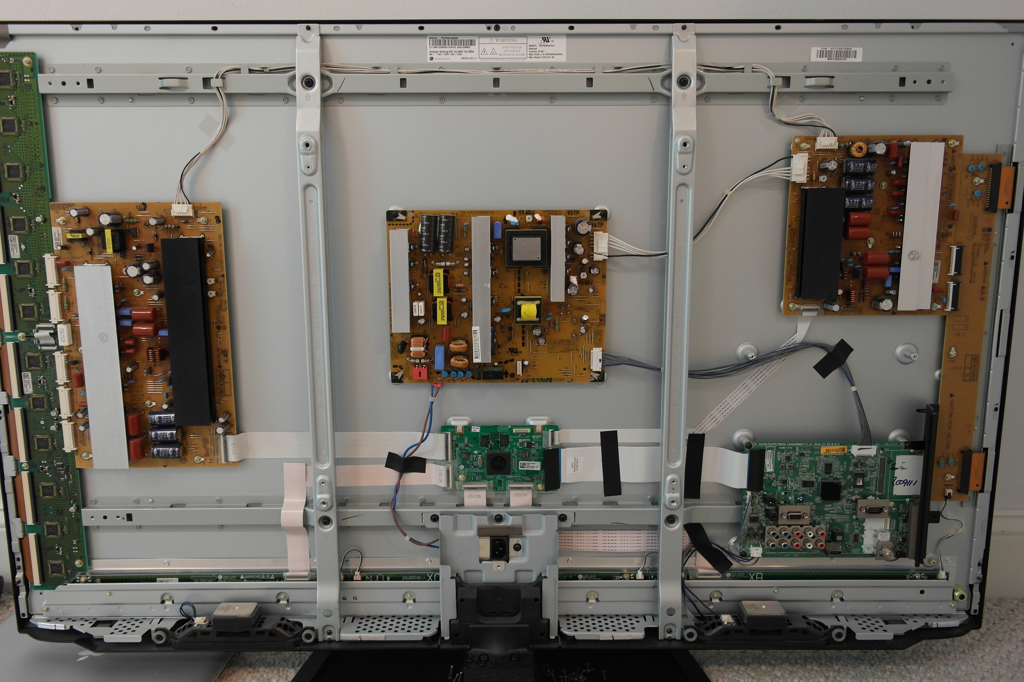

    Tv was in the trunk of my car when i bought it, the previous owner was moving and couldn't take either with him.
    He didn't speak English very well but he said that it didn't work. and wasn't going to take it with him.
    So i told him i would get rid of it for him.
    I got it home and looked at it and the panel looked good so i figured i would see if i could fix it with information i find here.
    I plugged it in and nothing no clicks or lights. so being here in Florida i figured possibly a bad power supply.
    I removed the rear cover and found the main board disconnected. So i reconnected everything and powered it back up.
    I got a click and a red light on the front of the tv,
    i pushed the power button the red light went out and flashed twice. about 5 seconds later i got white noise threw the speakers. and the panel black and has no glow.
    i have 54v at the VATP and 204v at the VSTP, I tried removing the upper buffer and powering up and the panel still black. The tabs appear to be in good shape having read about them having issues.
    I tried disconnecting the main board from the logic board and jumping the logic and nothing on the panel and still black.
    i have to get the resistors to try the other jumper testing i had read.
    Is there anything else to try to confirm a bad main board before i buy one?
    Thank you.

    Also i found a sticker on the back of the tv that appears to be an invoice number from a repair shop, so they may have diagnosed it and left the main board unplugged.
    But i would like to be able to diagnose it myself.

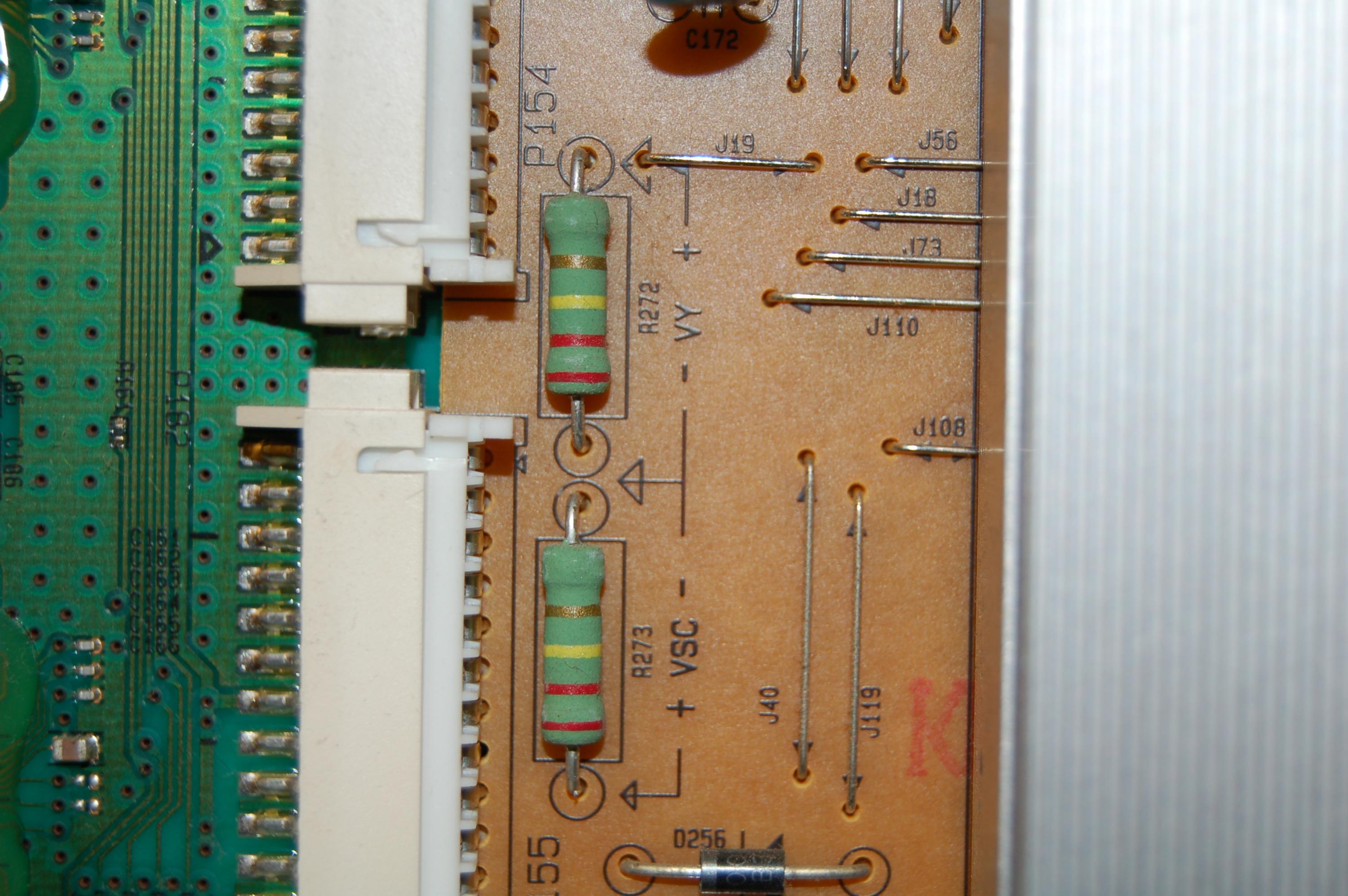

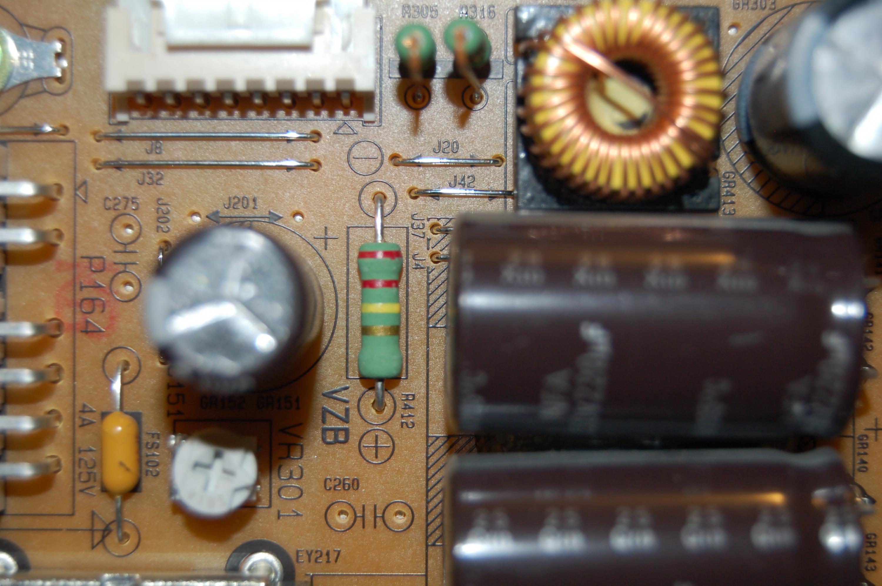

      You need to check vsc, -VY, and z-bias
      Vsc and -VY are on the y-sustain.
      Zbias on the z-sustain.
      They should have test points marked + and - for the corresponding probes for your multimeter. Sometimes they are measured accross a resistor.
      Post your results.

        Am i measuring voltage with the black probe to the chassis and red to the positive side of the resistor? or measuring voltage across the resistor?
        Measuring with the black probe to chassis and red to the positive side of the resistors are
        VSC 197 - 202v
        VY 253 - 265v
        VZB 149v
        measuring across the resistor
        VSC 0v
        VY 57 - 68v
        VZB 149v

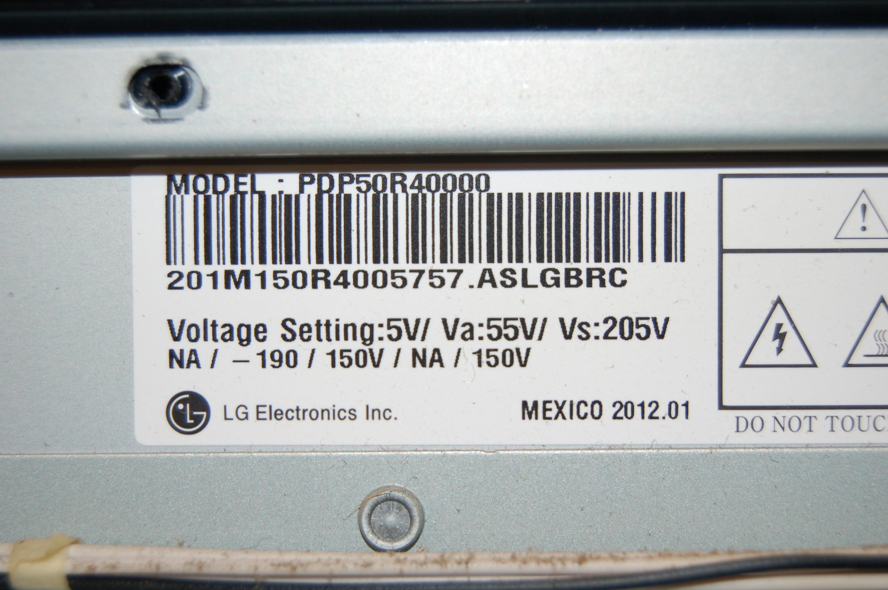

                I take it that matches your panel sticker like in my post above?
                • joecool869
                  • Jul 2015
                  • 12
                  Re: LG 50PA6500 have sound, no picture
                  the readings with the top buffer removed are now within 1v of the sticker on my panel, correct
                  • Hamie
                    • Apr 2014
                    • 1383
                    the look accurate anyway.
                    You have a bad buffer board, maybe both, maybe just one.
                    See if the TV runs with just the top one plugged in. If you get a perfect image on the top half of the screen you have a blown lower buffer IC

                          Ok so the top buffer has a shorted buffer IC.
                          You can check it over if you want?
                          Uploaded a photo of the top buffer.
