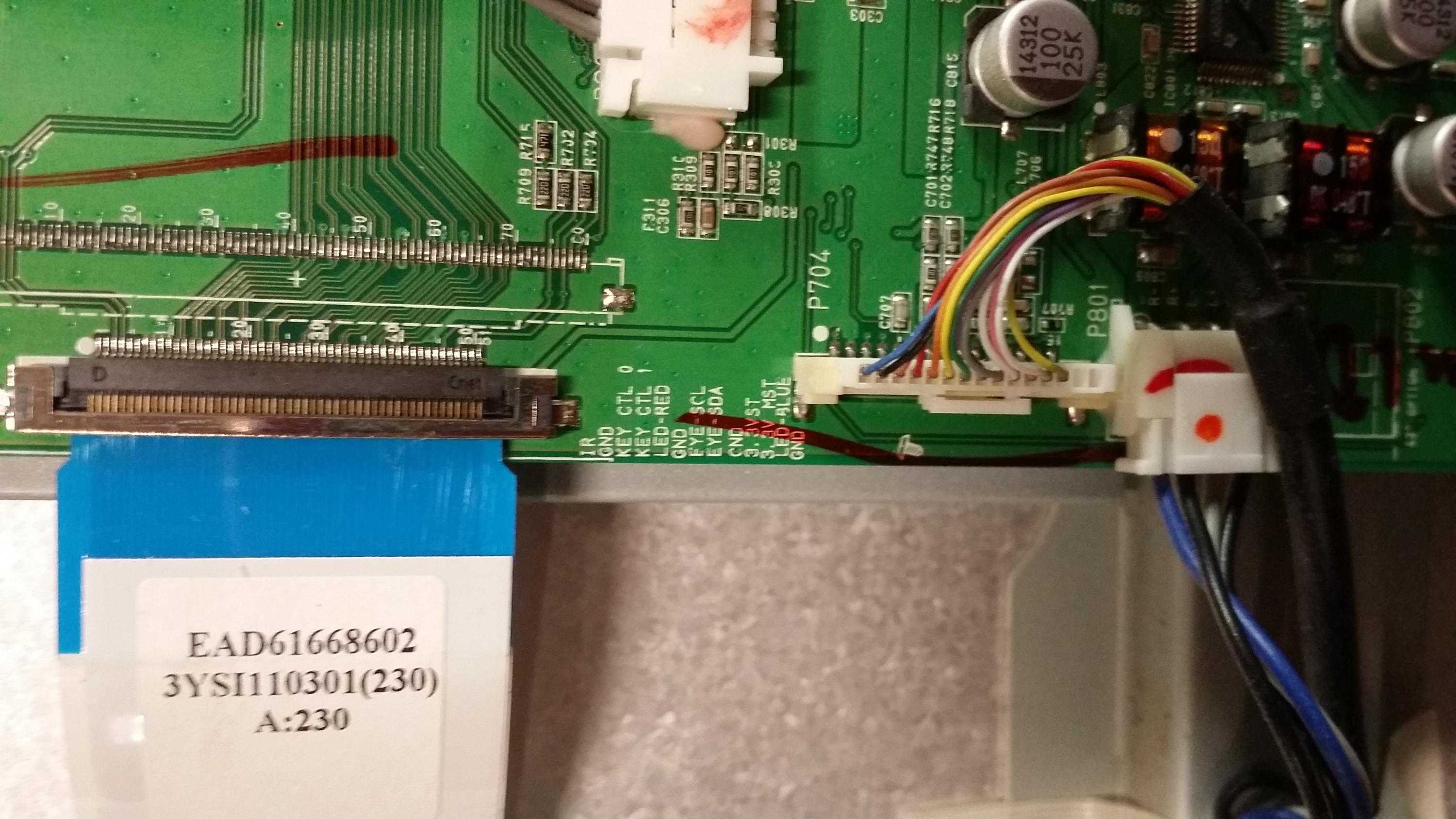

        Re: lg 50pt350-ud goes on and off picture
        hamie I don't have that on my main. here is what is on my main

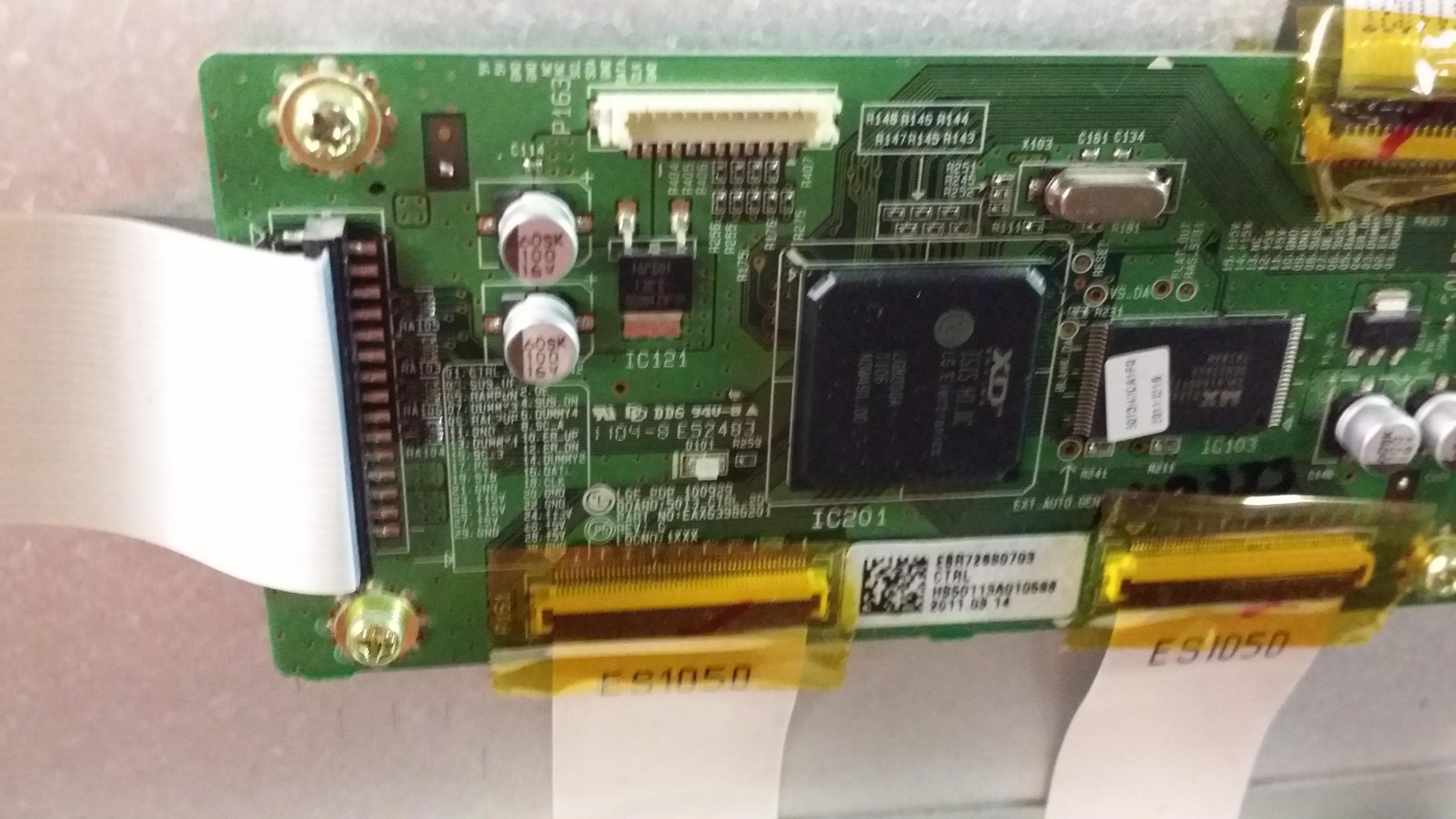

          ok it seems the picture goes on and off after it warms up alittle picture will come and go but sound will stay on, im not to sure what the little light on the tcon board is for? but t blinks then it will stay on then stay off its a little green led light. its in this picture, then I noticed the middle heatsink on the ymain is pretty warm not too warm where you cant hold your hand on it, just warm. but the tv is weird like the picture will go out stay out for a min then come back for ten then go out and such, I was wondering what that little green light is for on the tcon or digital control board
            You do have it you've read my post wrong.
            Control board is the small green board in the middle of the TV.
            I can see the test points in the photo you've uploaded.
            After connecting the 2 holes, disconnect the LVDS cable (the cable that connects the MAIN AV Board to the control board)
