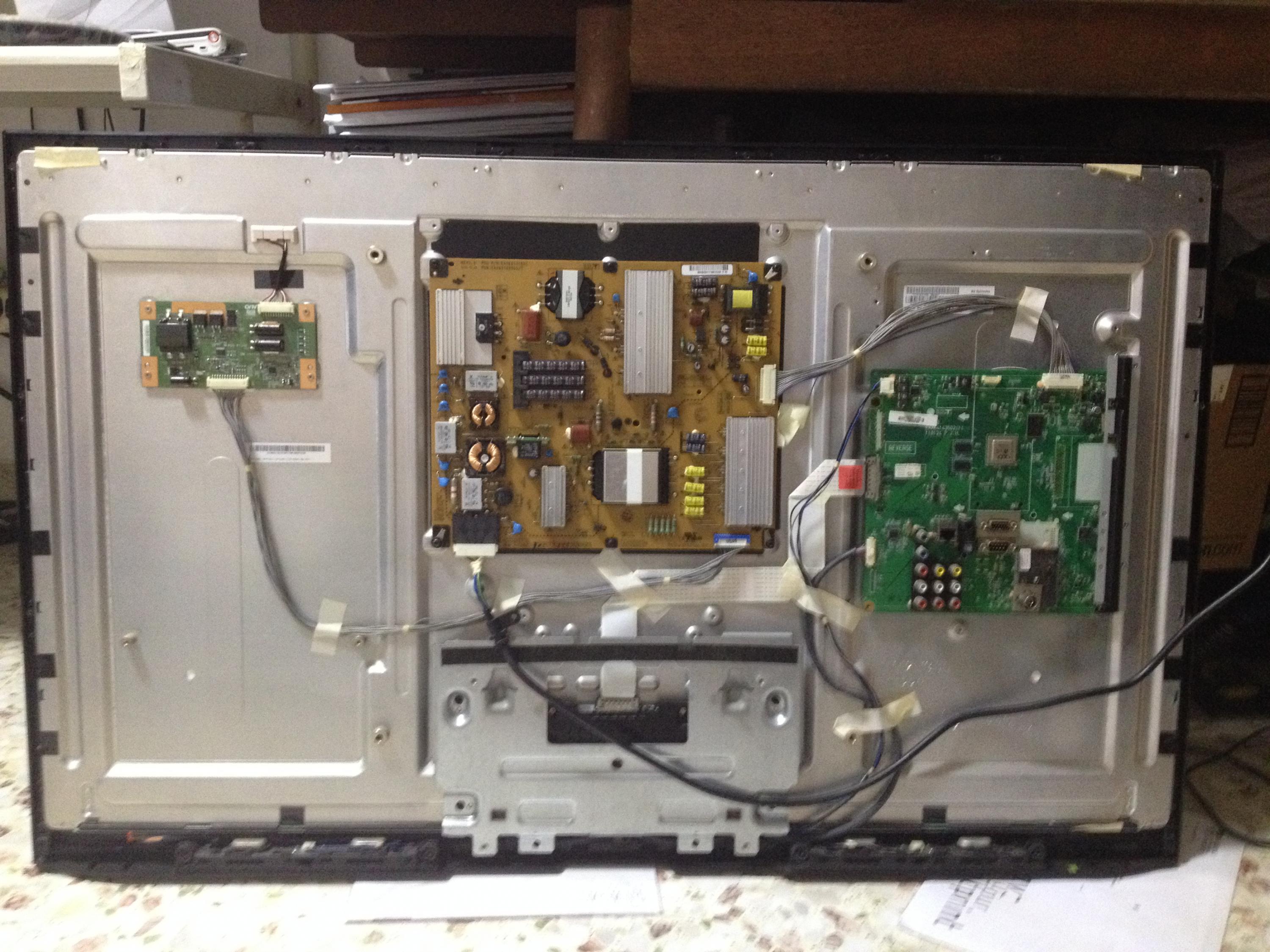

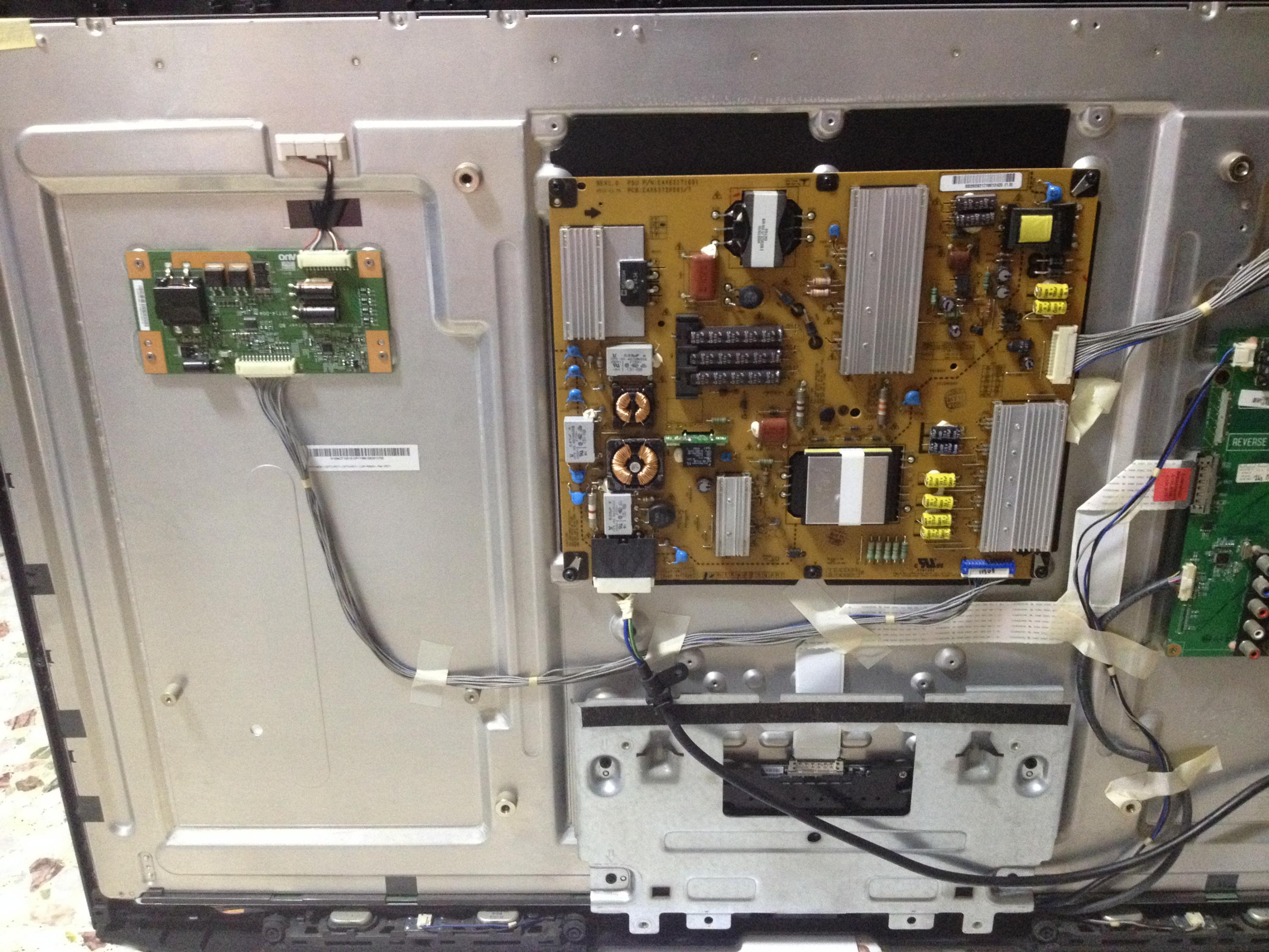

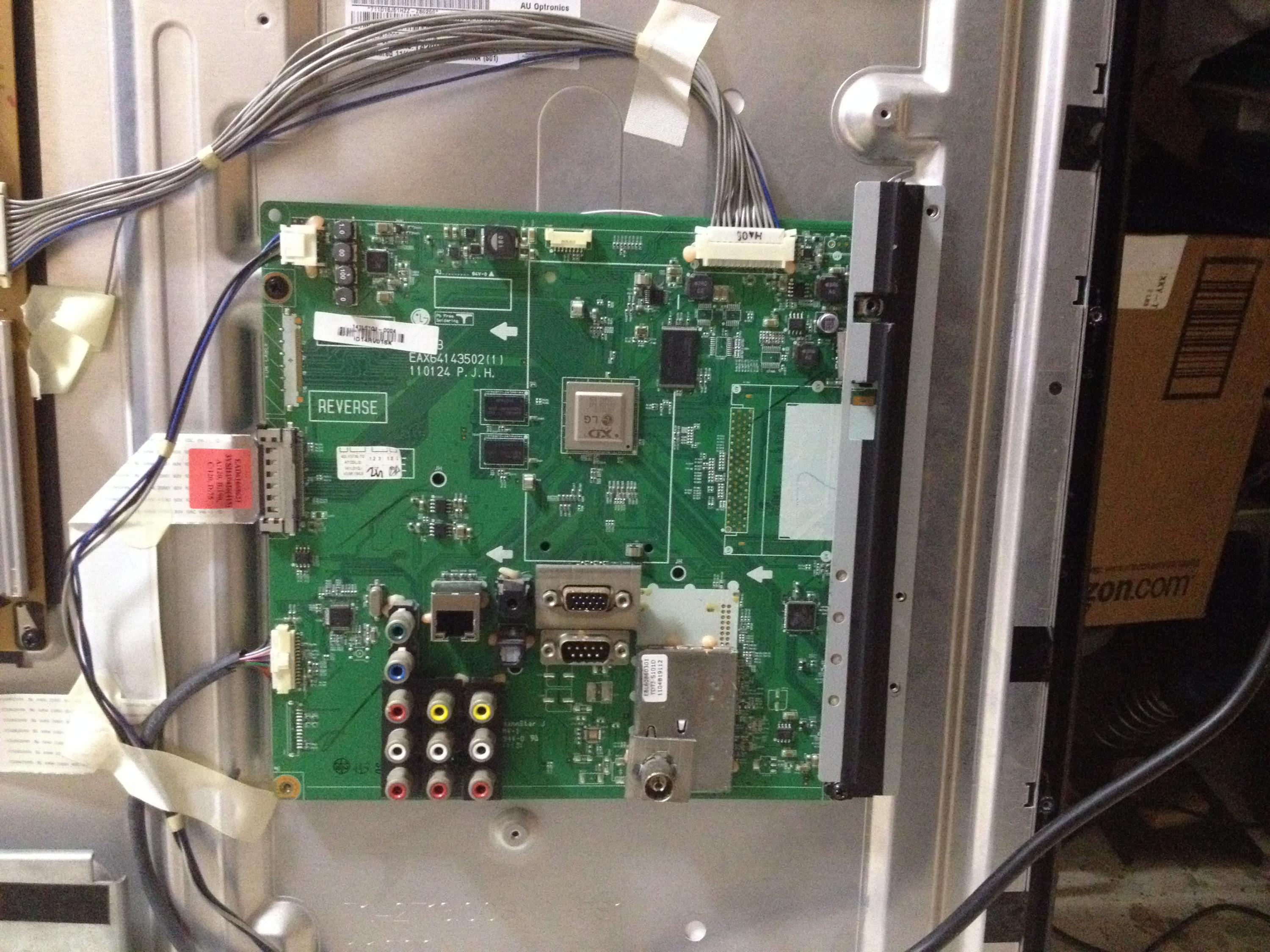

    here are photos

      You have a bad mainboard.
      Baking it might solve the problem for a while. But it might come back once the solder under the processor starts to crack again.
      For a permanent fix it needs reballed, but for a fix that lasts much longer I recommend baking it too about 120c then use a heatgun and give the chip a good blast to ensure all the solder reflows.

        I will go with the bad nand flash memory. what the nand part number? its look like a Hynix

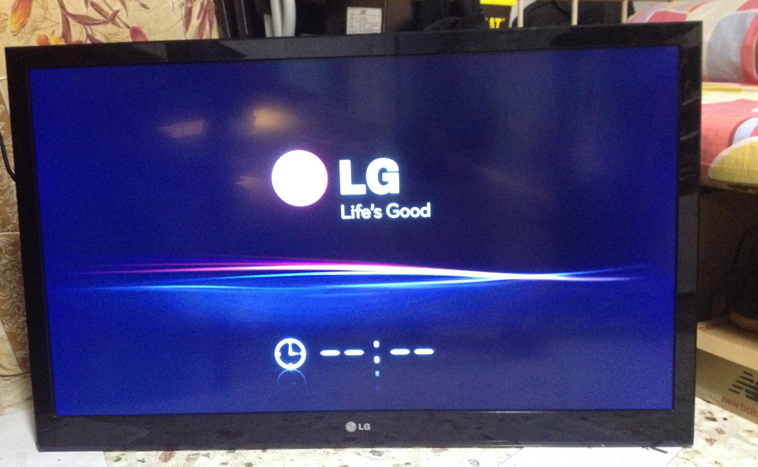

          here is the stuck image every time on power up.
          I believe the LG gif must be stored in the Flash, my guess is the flash should good to retrieved the gif. but the boot rom is also in the flash, so why did it stop loading the boot sequence. maybe poor contact likely
          flash is Toshiba - TC58DVG350ETAD0

            TC58DVG3S0ETA00 That the correct part number, its 1GB NAND memory by Toshiba
            Depending on the age of your TV nand memory developed bad block over time and data goes bad within the bad blocks, TV shut down or come to a HALT.
            replace main board or replace nand memory chip if you can find someone selling a program nand chip for your TV.
