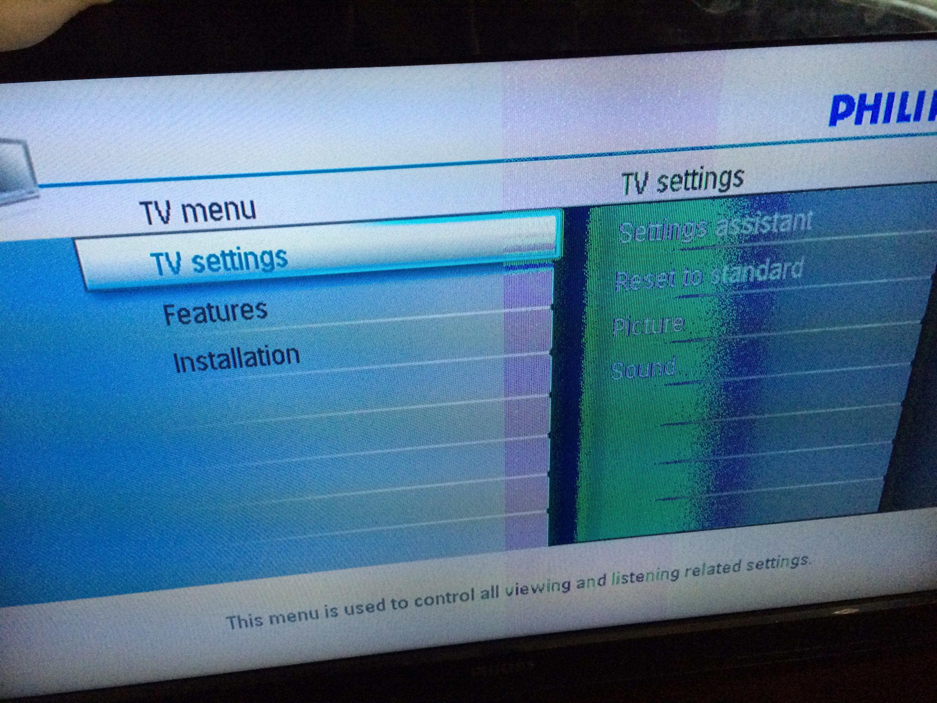

    Philips 42pfl5332d Half screen distortion(pic)
    Half of the screen on this TV seems to have a green tint and flickering pixels in the affected colors. The picture is Still viewable but terrible to look at.
    I attempted a tab fix by applying pressure but the picture didn't react to pressure on any of them, reseeting the tcon ribbons made no difference either.
    There's 2 buffer boards(i think that's what they are, there non replaceable) and i have seen that I should check on some fuses, i'll be doing that next.
    If anyone has any further tips I'd greatly appreciate it.
    Thanks in advance,
    - Tom

    Re: Philips 42pfl5332d Half screen distortion(pic)
    What type of display is it?
    -David VanHorn
