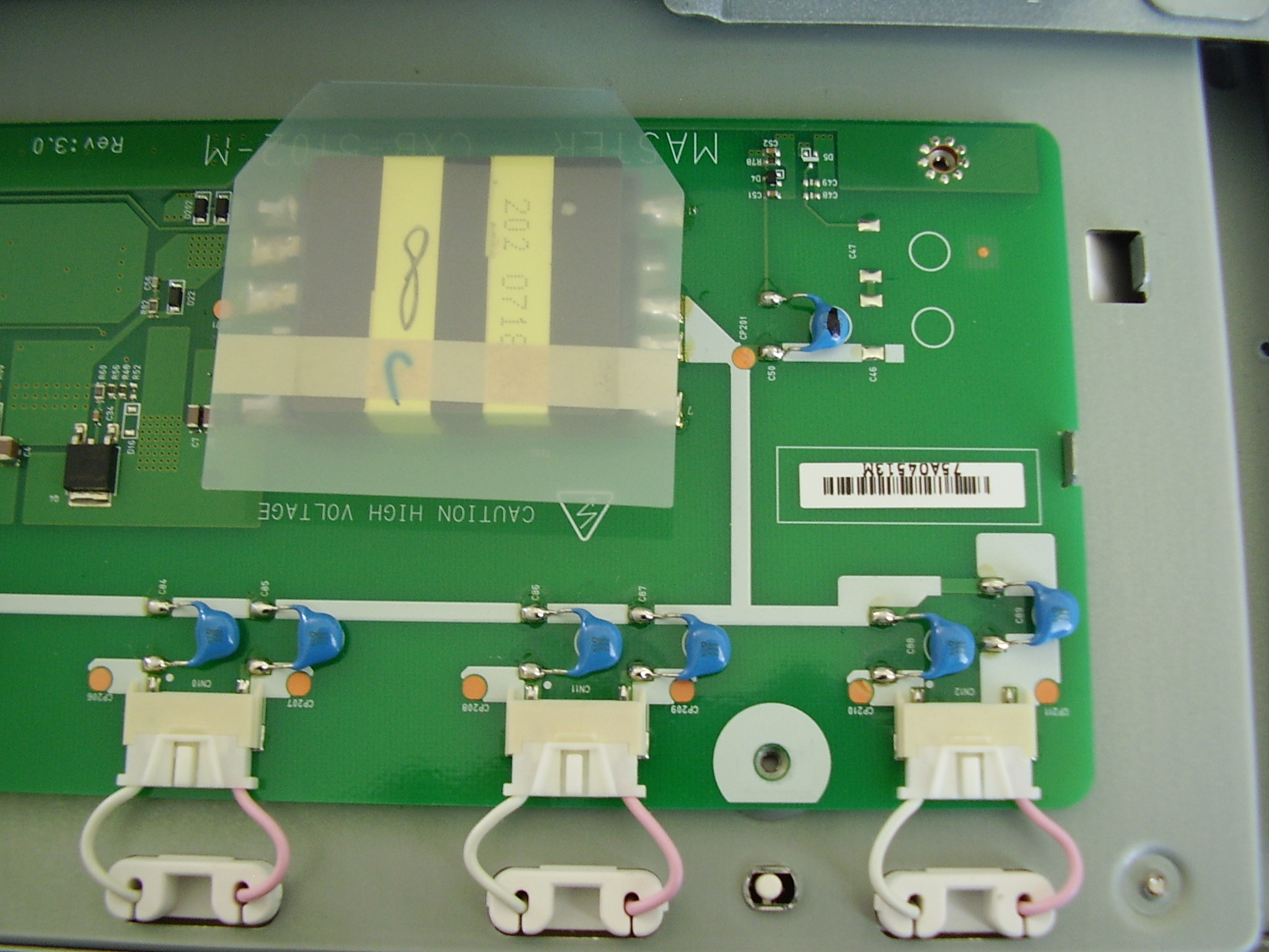

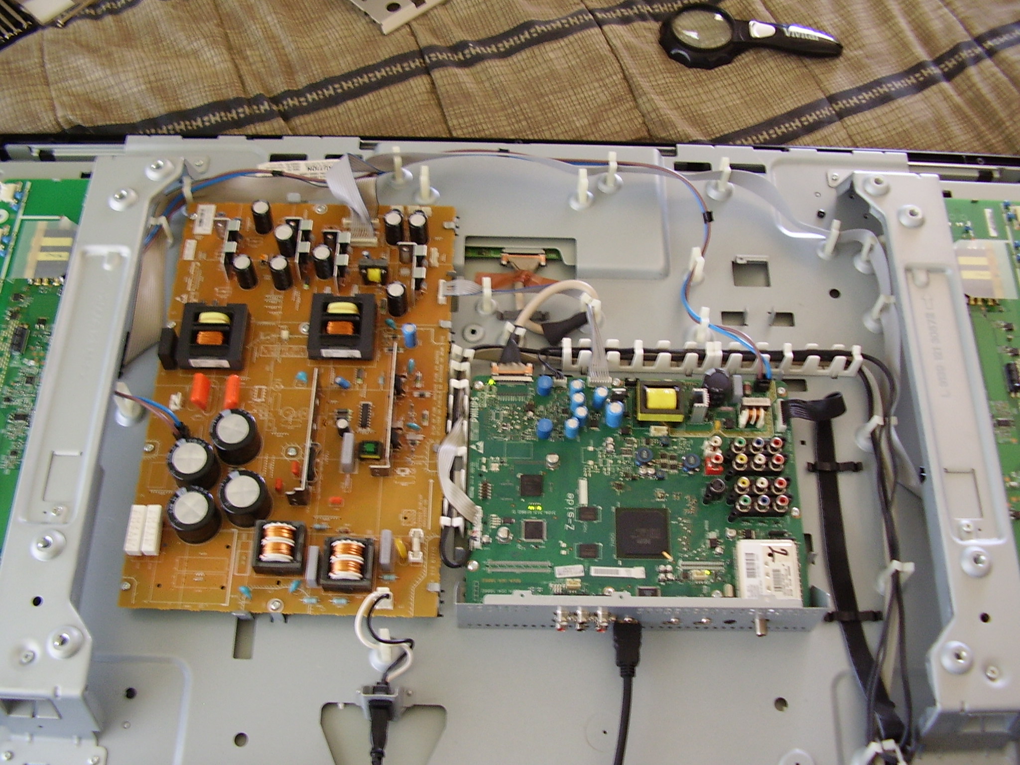

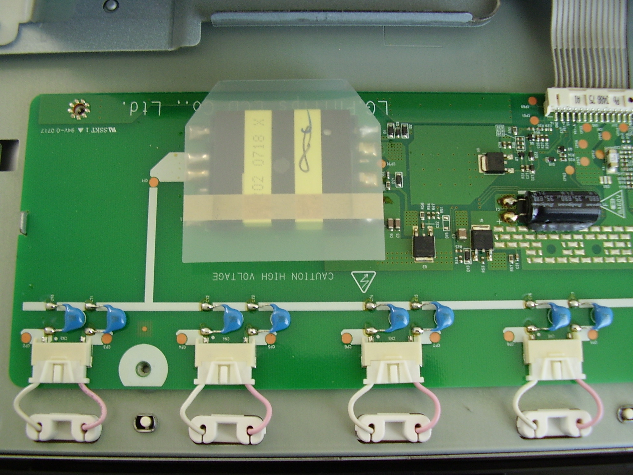

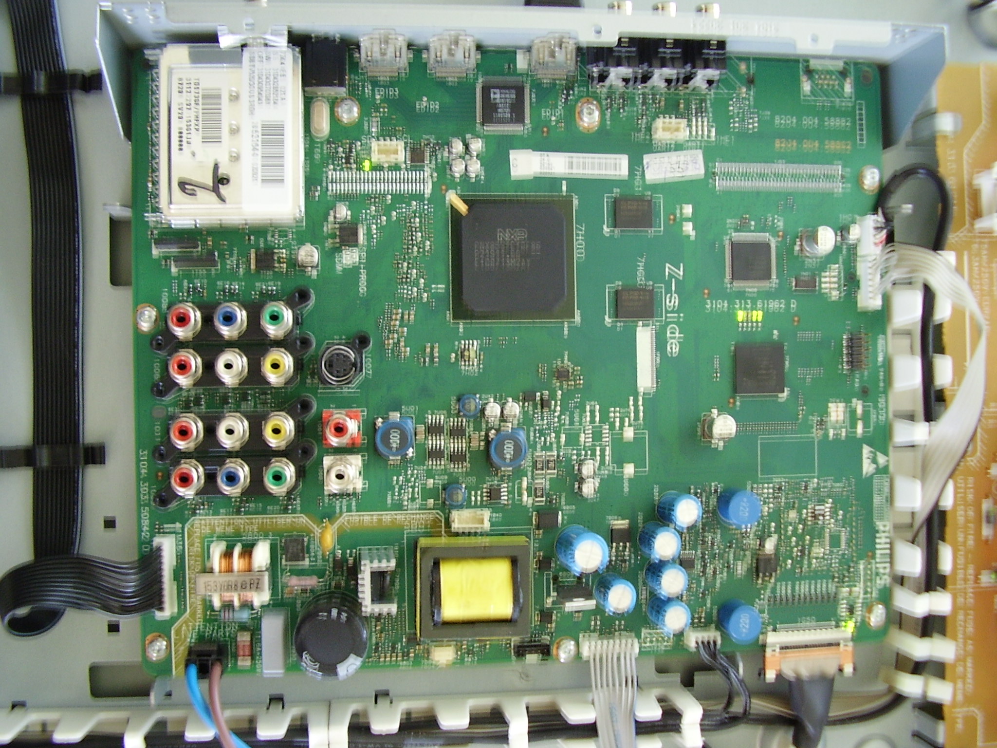

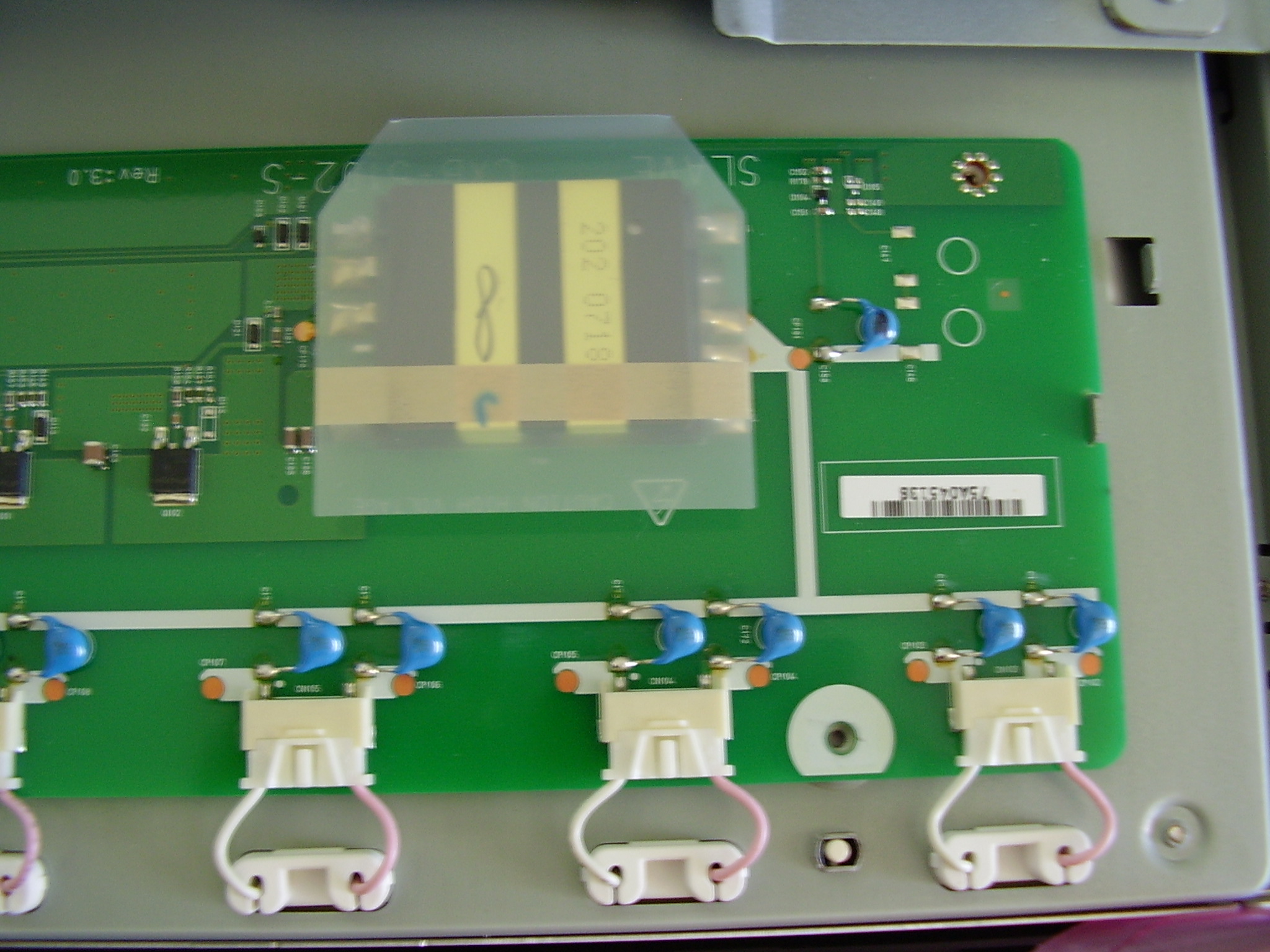

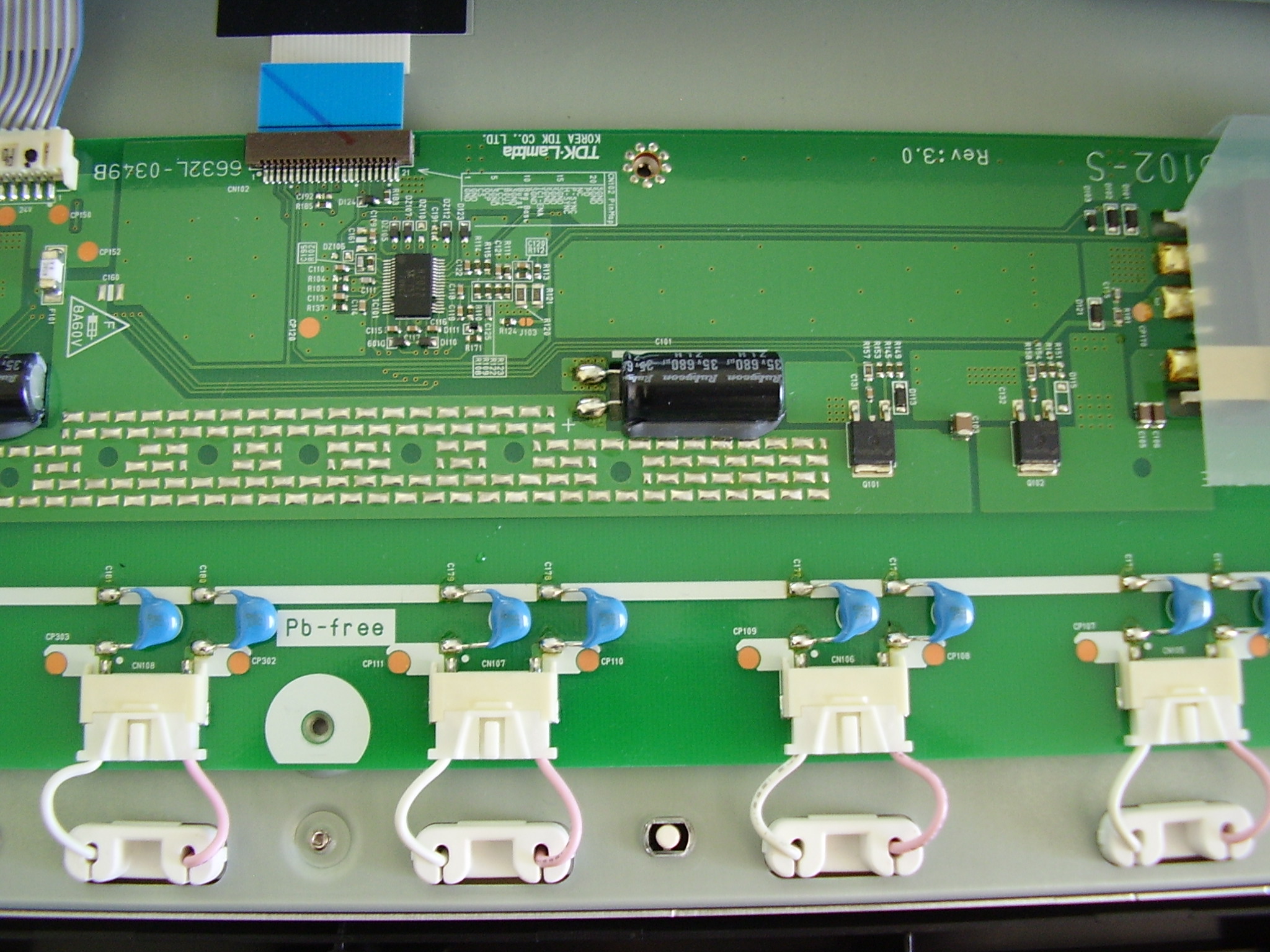

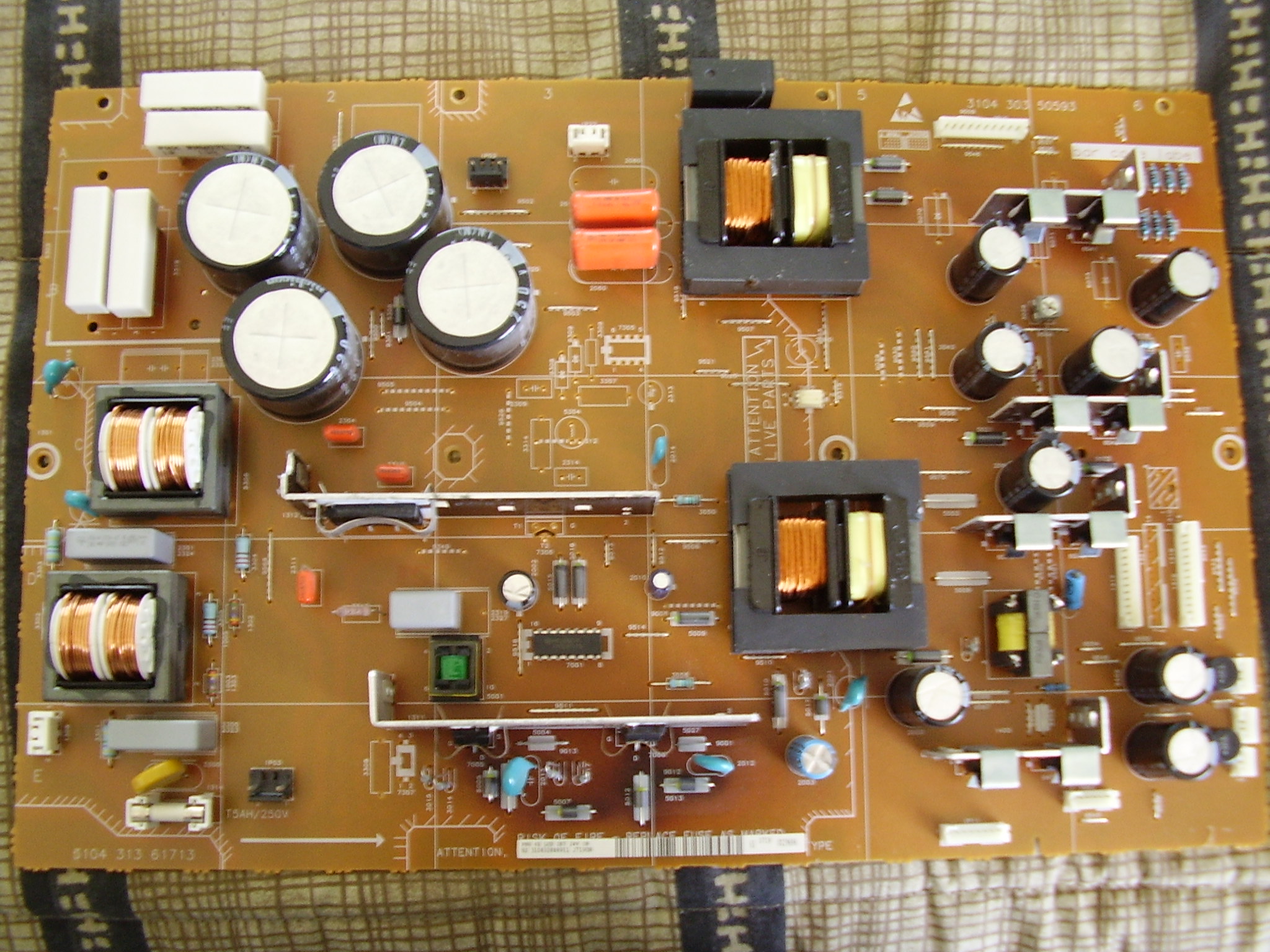

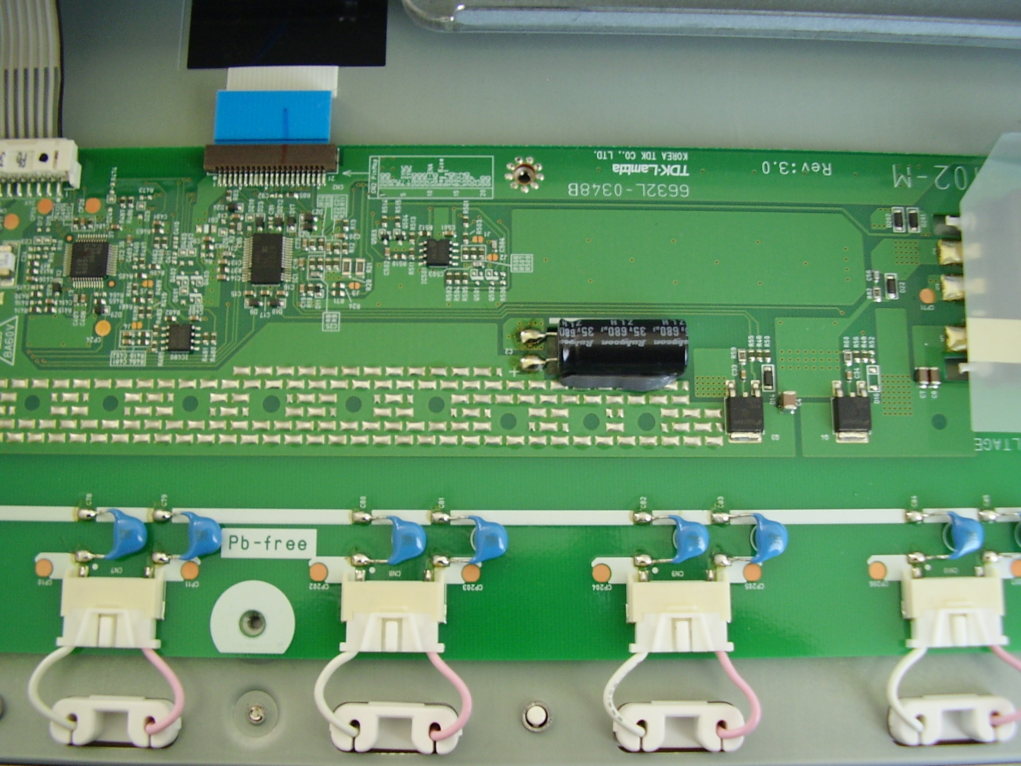

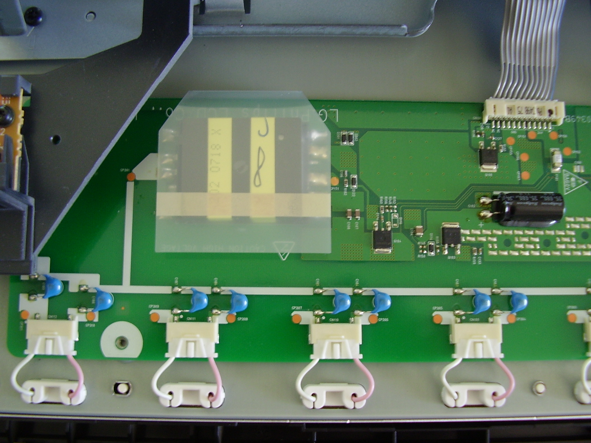

    Hello everybody, I have this Phillips LCD TV 42PFL7422D/37 that I am attempting to repair. When I first got it and plugged it in it was completely dead, no power lights, no clicking, no nothing. I checked the fuse on the power supply and it was fine, I found a used ps on ebay for $18 bucks and ordered it. Now I get 2 seconds to black (sound but no picture)but during those 2 seconds the whole screen is flickering and the right side is a lot darker. I checked voltages at the inverters and I am getting 22.1V, it should be 24V. Is 22.1V close enough or not? And the red indicator light does not work but when I push the power button the blue light comes on, I do get the 5.6V stand by voltage but the red light does not work. Maybe it's an option in the menu to turn the indicator light off or on like my Vizio has?? Any suggestions? I have included some pics including the old power supply, the new(used) power supply is a different variation but according to ShopJimmy it will work.

    22V is not sufficient.
    Did you get *exactly* the right board?
    37" board will not work for example, cannot deliver sufficient power to light 42" panel.

      the number on the old board is 310432848911 and the board from ebay is 310432848913, every site I have visited says the 8913 is a substitute for the 8911.

          I can install the old power supply and try to find the problem with it. I see someone had success replacing the ceramic resistors maybe a good place to start. The last picture in ,my original post is the original power supply, Any suggestions?

            I see different components on the two boards, so I am not confident they are interchangeable.

              Yes there are only 2 ceramic resistors on the one I ordered and 4 on the old one. If I put the old board back in where would be a good place to start?
