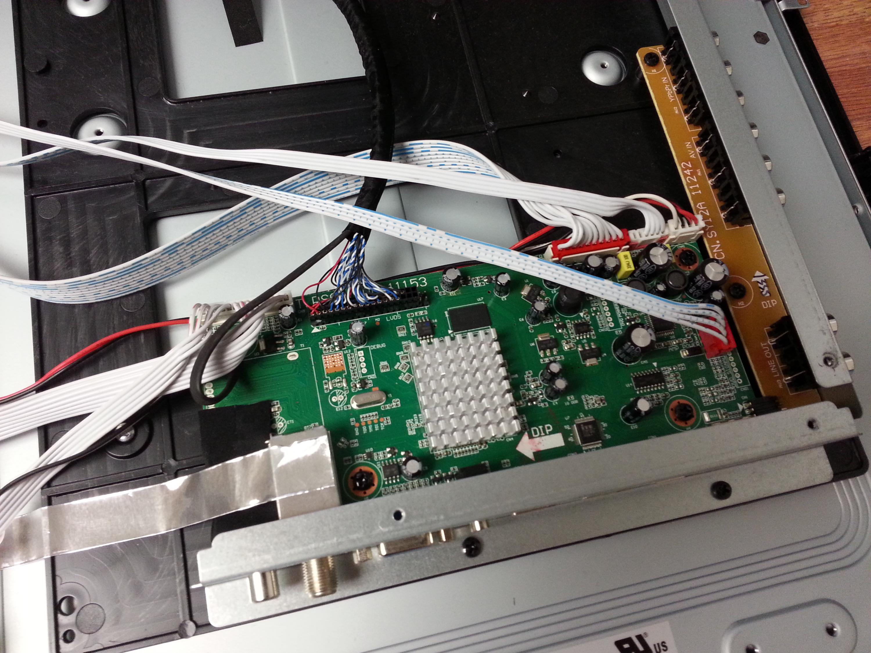

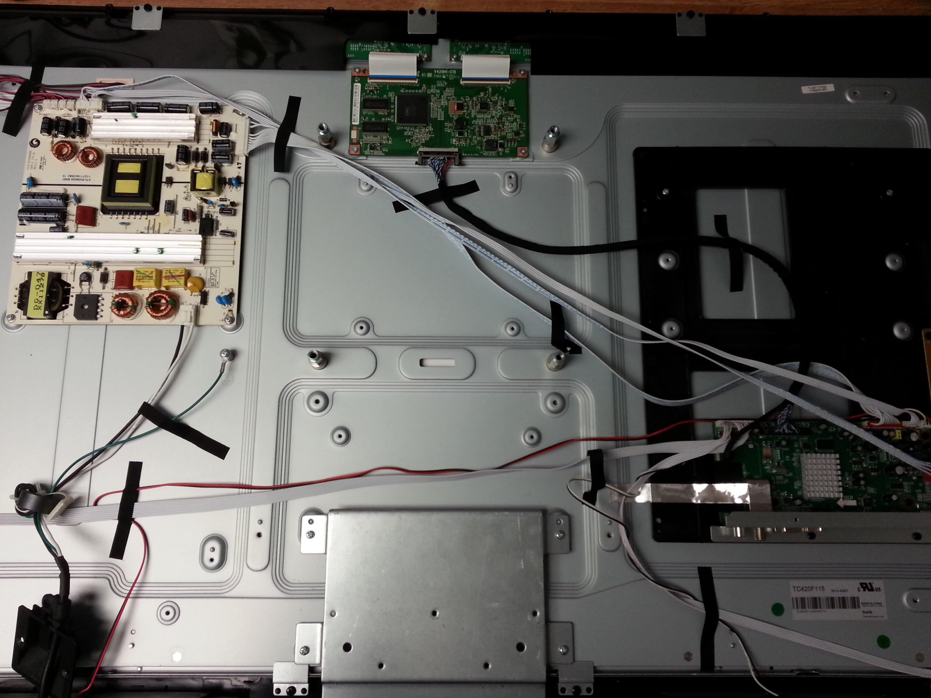

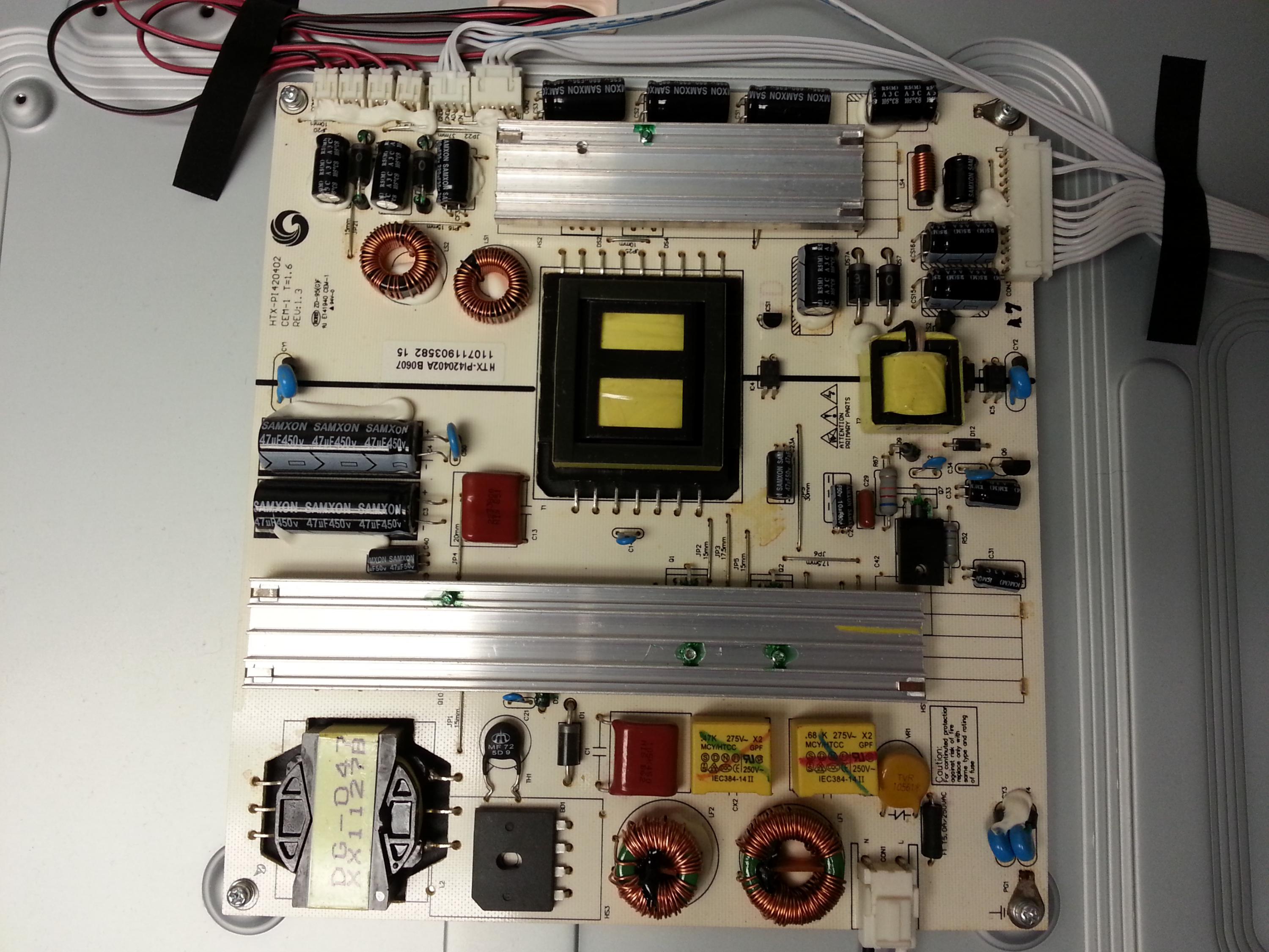

              Well firstly check the blon voltage that goes to the led driver, can you take close up pics of all the boards please ?
                Pictures
                I have taken pictures of the mainboard, T CON, and power supply. As for checking that voltage, where would I need to test to find that?
                (badcaps.net attachment uploading is giving an error right now, pictures are hosted on TinyPic instead)
                Mainboard Left: http://tinypic.com/r/21lia/8
                Mainboard Right: http://tinypic.com/r/2n6fehd/8
                T CON: http://tinypic.com/r/w1v5ua/8
                Power supply top: http://tinypic.com/r/24mglrl/8
                Power supply bottom: http://tinypic.com/r/30xbt07/8
