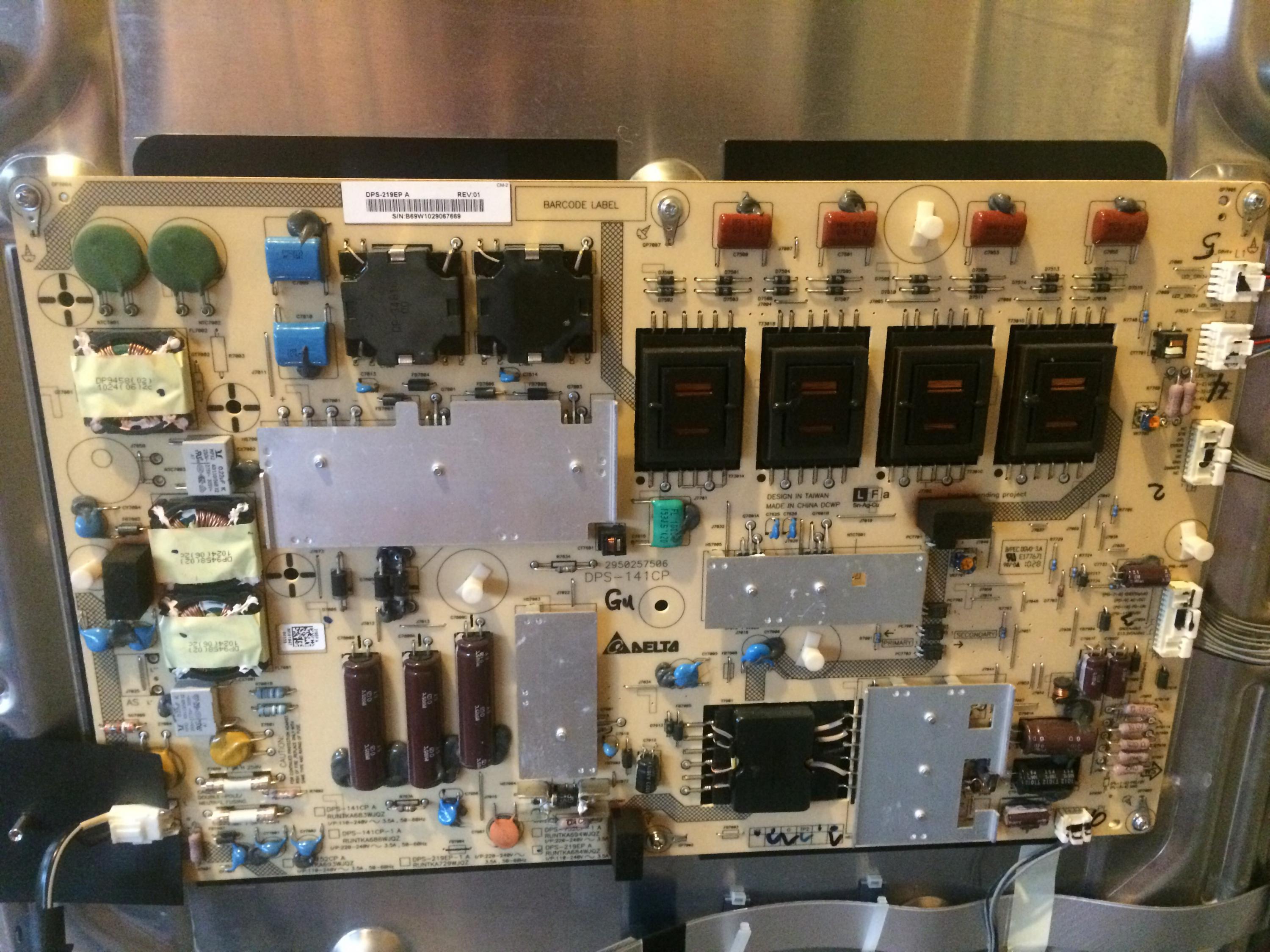

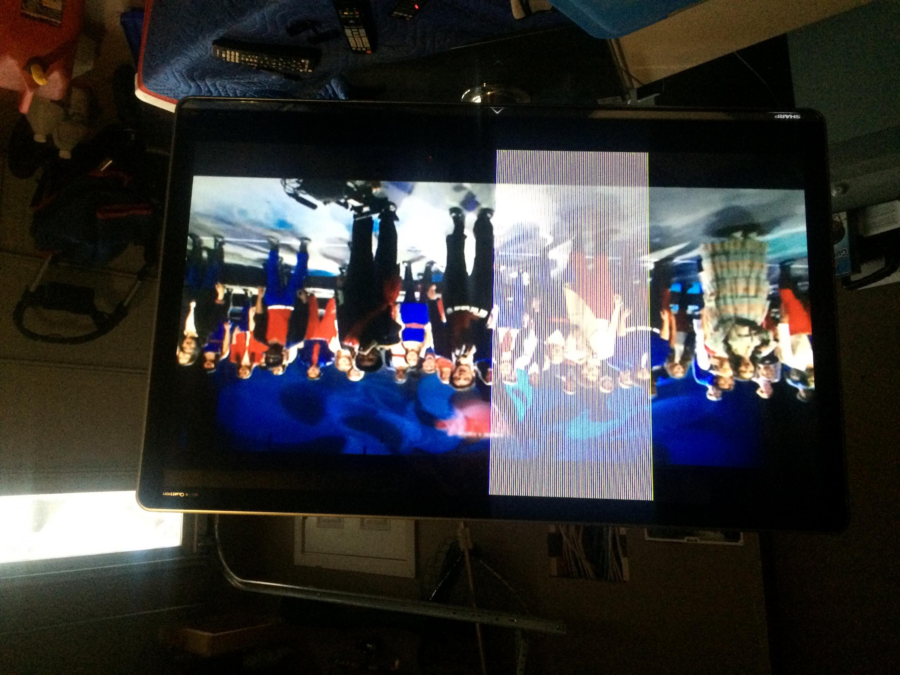

    My 60" sharp Lc-60le820un has vertical line on it. I can still see the picture but there seems to be coloured lines for a quarter of the screen. It starts at the center and goes to the left about a quarter of the screen. I have no other problems. No indication that anything is wrong. Where should I start?

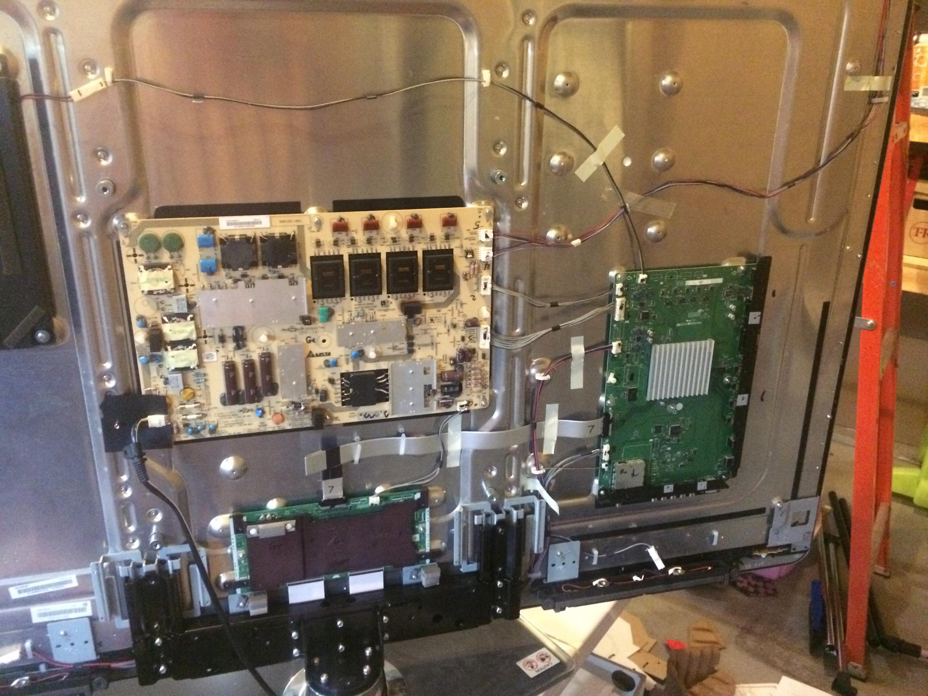

    Pictures of the problem the screen displays and the rear of the TV with the back cover removed, please.
      Re: Vertical lines on 1/4 of my LC-60le820un
      Sadly if it's an LE8xx series Sharp this is almost certainly a bad LCD panel (this seems to be a common model with these sets.) Generally a bad LCD cannot be resolved. More diagnosis is necessary to be sure.

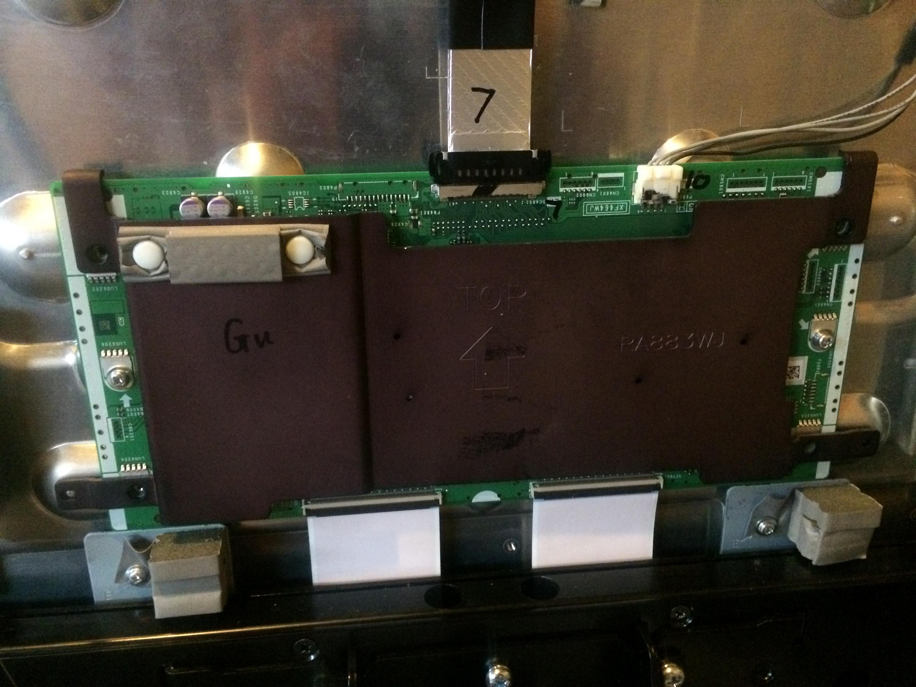

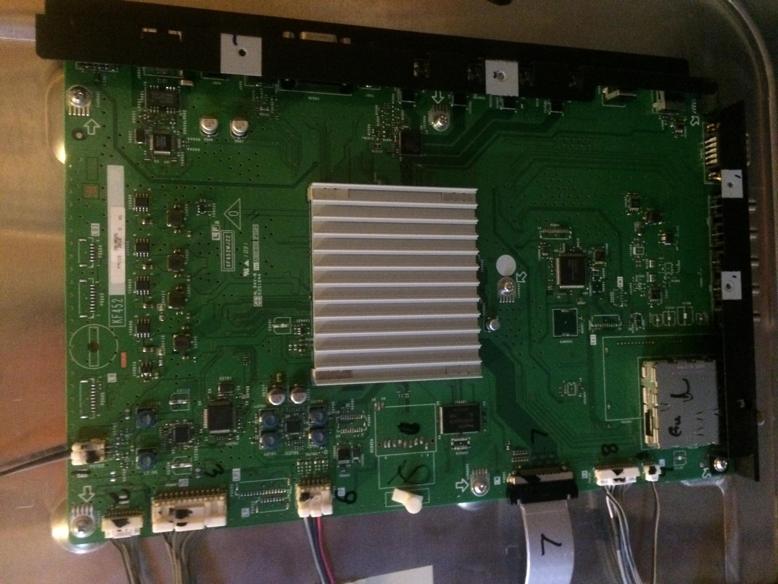

                  Sorry for the numerous posts but I haven't posted pics before and it didn't seem to let me post more then one at a time.
                  • mmartell
                    • Oct 2013
                    • 3189
                    I saw the first two pics and it looks to me like a bad tab bond or driver ic. You may have to strip it down to the panel but of course wait for more input...
