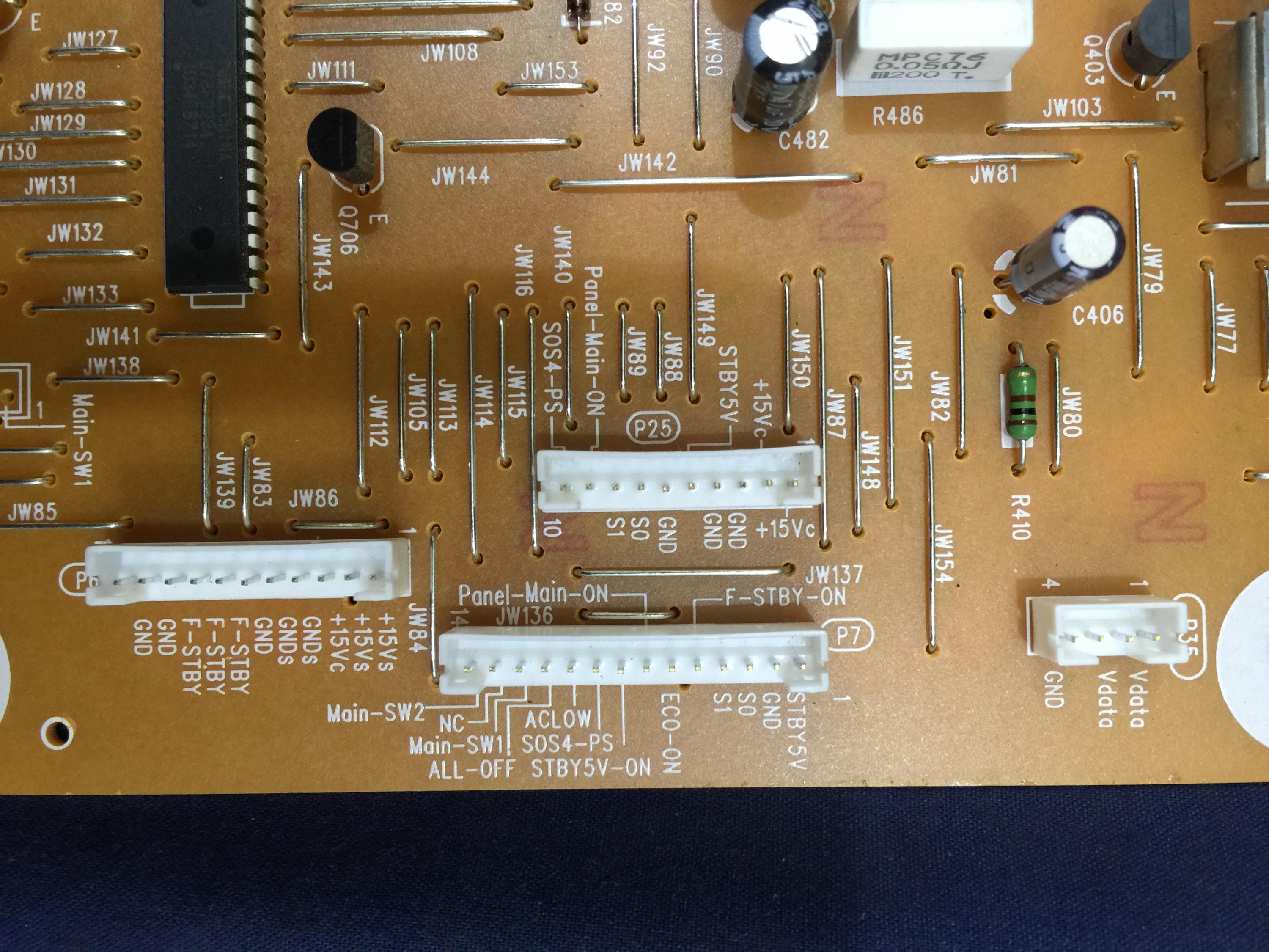

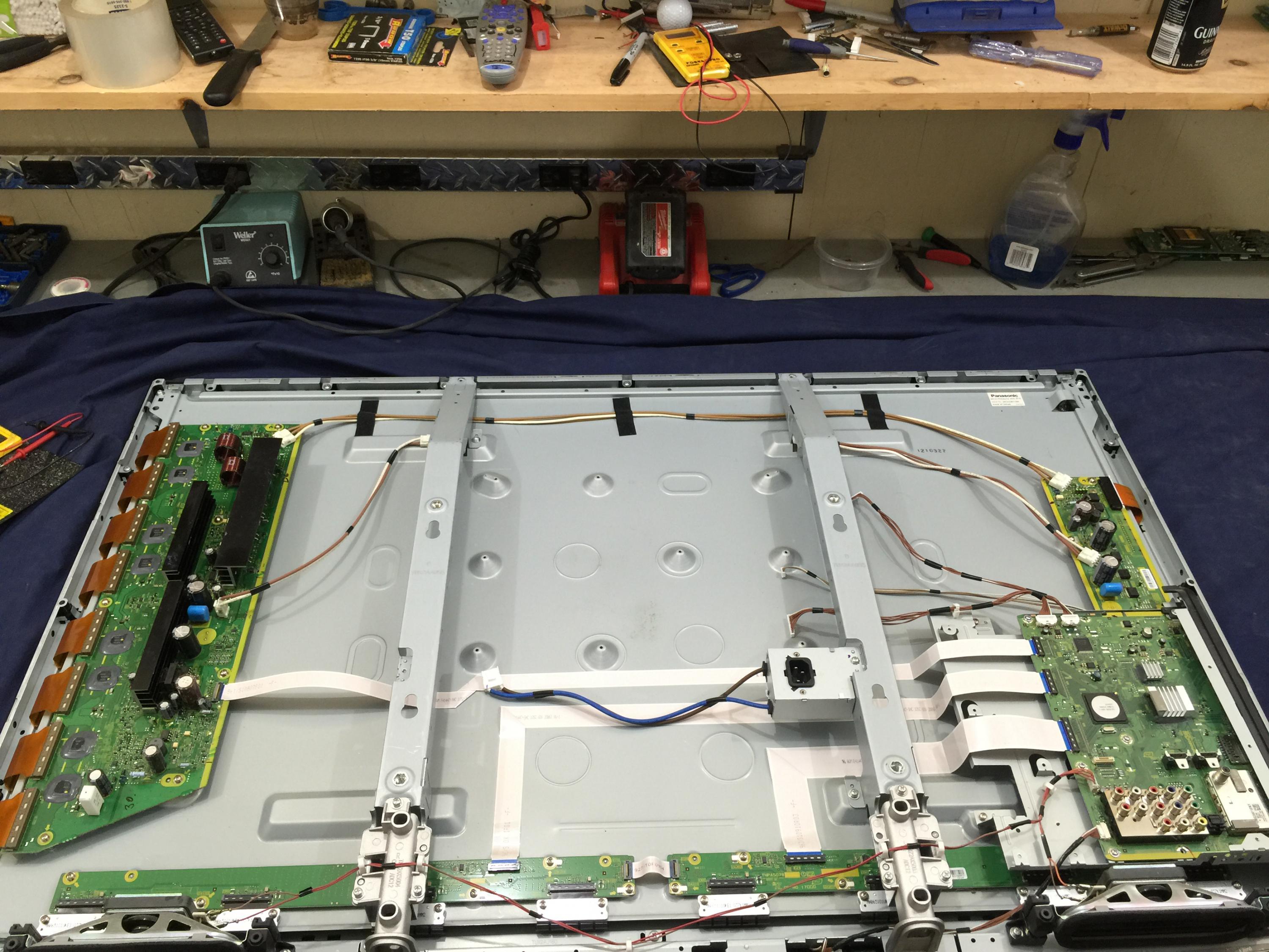

    Well, after all the learning I've done here I rarely get stumped on troubleshooting any more but this one has me guessing. Picked up the TV for $10 a couple days ago with problem unknown. Was told it wouldn't turn on. I got it up on the bench last night and plugged it in to check it out.
    When the power is connected, there are no clicks or noise whatsoever. I'm not sure if the P board in this model is supposed to engage or not upon connection but most Panasonic sets I've dealt with do so I'm suspicious of the supply. However, it does have 5V present on the standby pin so I'm not real sure. Pressing the power button has no effect on it at all so that makes me wonder about the A board.
    Other things to note. Per the attached picture, the pins labeled Main-SW1 and Main-SW2 have 5V on them even when disconnected from the A board. And STBY5V-ON never goes high, nor do the relays engage when I force that pin high.
    My question is, am I going about forcing the P board on the right way or am I missing something? The P board is only around $40-$50 but I don't want to throw boards at this thing for no reason.
    Thanks in advance for any assistance!
    Aaron

                  Tried that too. I cannot get the relays to click on with any combination. I'm not sue if I need multiple things engaged or what. I find it strange that the SW1 and SW2 pins have 5V on them with nothing attached. Makes me think that those may need to be pulled low but I don't want to try it without verification.
                    Re: Panasonic TC-P46C2 -- Completely Dead
                    SW1,SW2 are for AC power switch. One is source, the other is sink. If you press the toggle power button on the side of the set the voltages should change.

                          perhaps panel main on with 5vstb

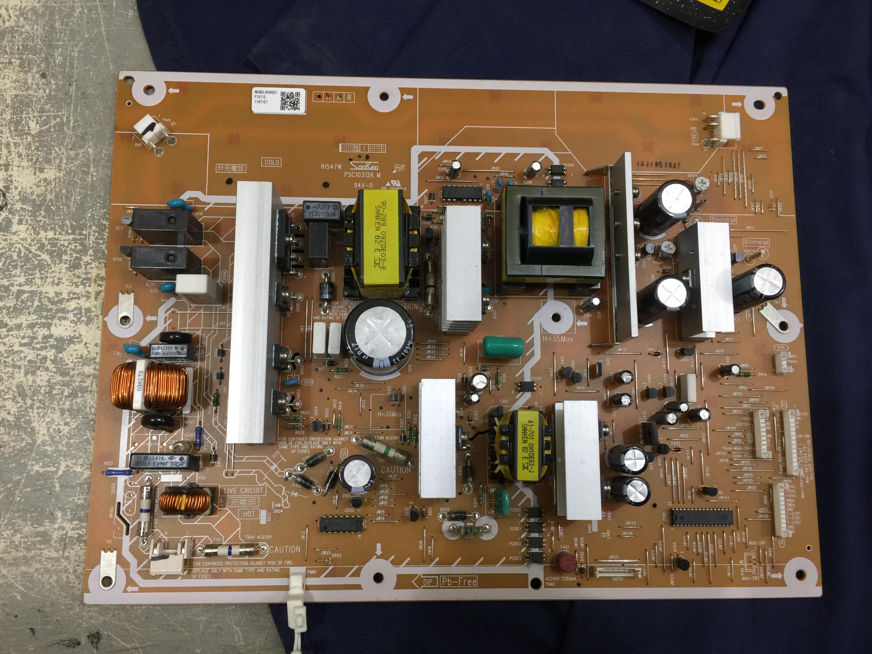

                          Thanks for the suggestion on this. That did the trick. Voltages are all present and stable so the A board is off to Moduslink PTS today for repair. I'll give an update once I have it back but I am certainly expecting the TV to power right up at that point.

                              Thanks. I basically just powered it up in the TV like you're describing. I got a brief screen glow and unplugged. The A board was not responding to the power button or the remote, nor was it sending voltage to the PNL-MAIN-ON pin so it's off for repair.

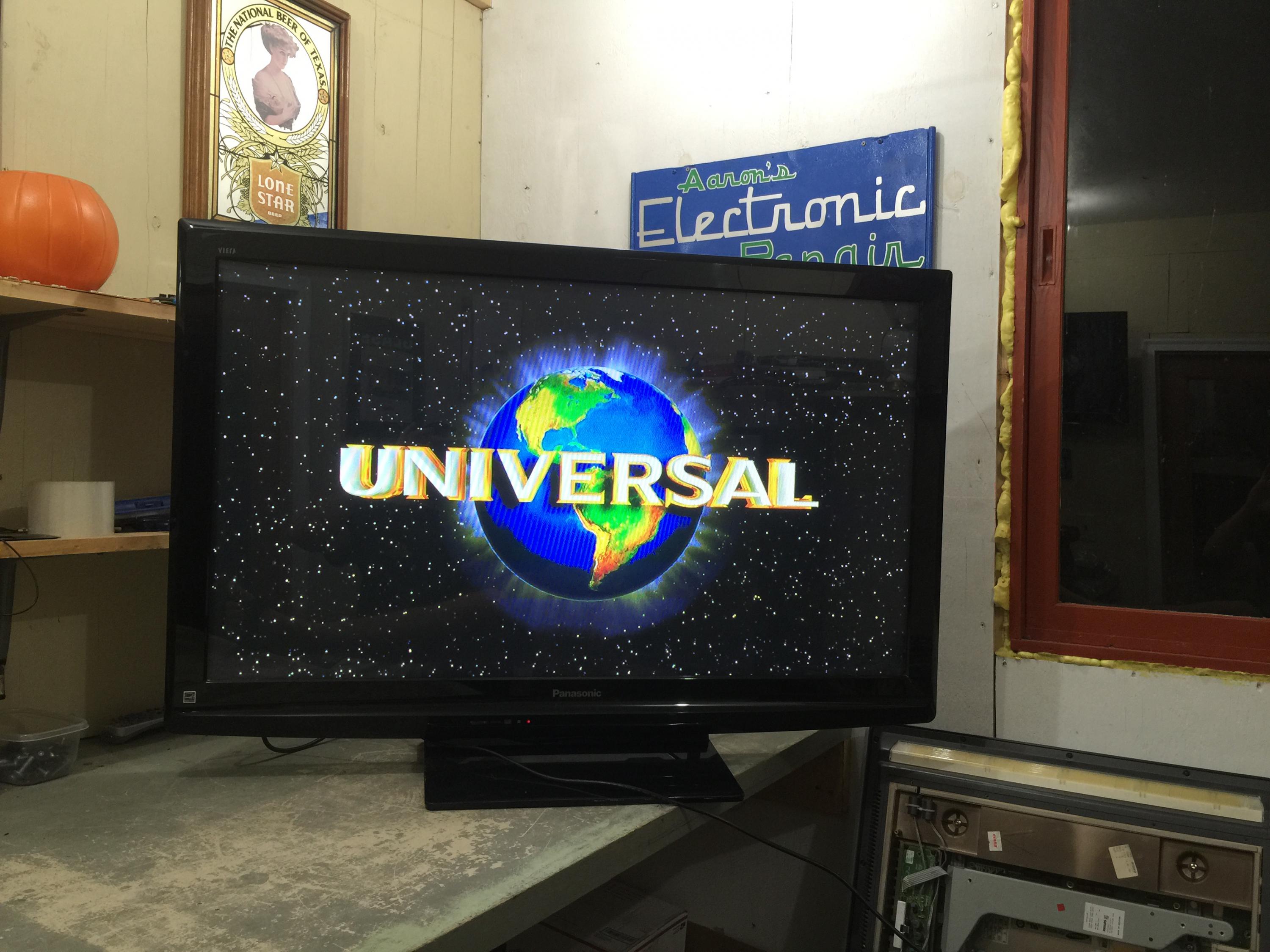

                                  Just a follow up on this. Received the repaired board back from Moduslink PTS and the TV is now up and running. Looks like they either replaced or reseated the main processor chip on the board. Not sure if there was anything else but that's the only thing that I noticed.
                                  Thanks to everyone for the tips and advice.
