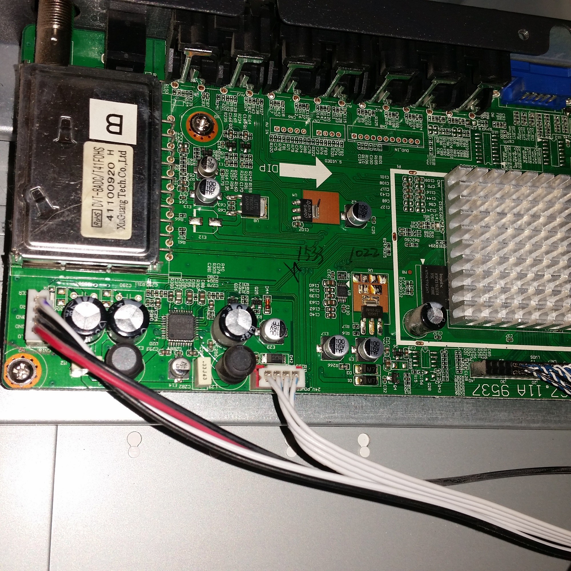

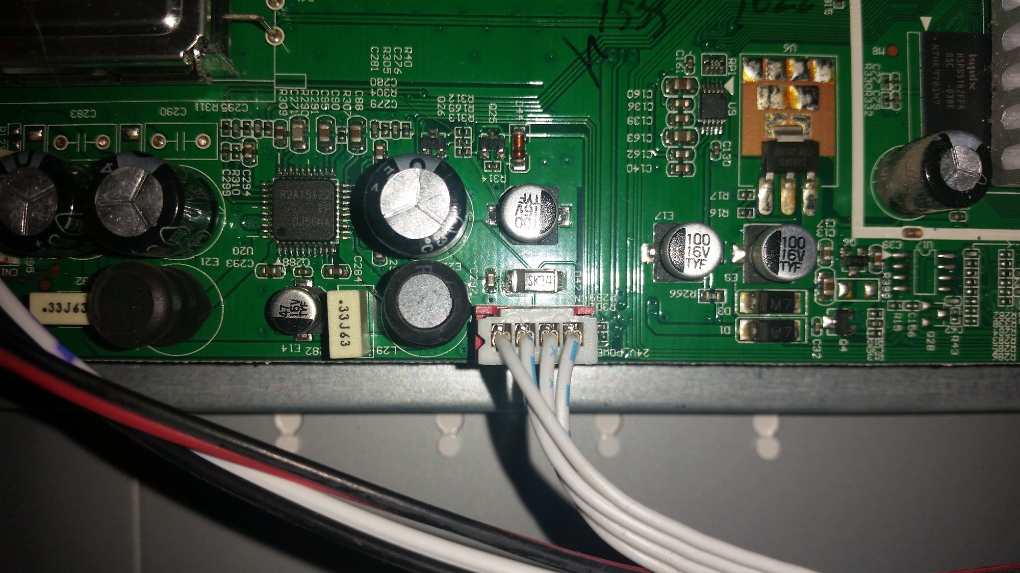

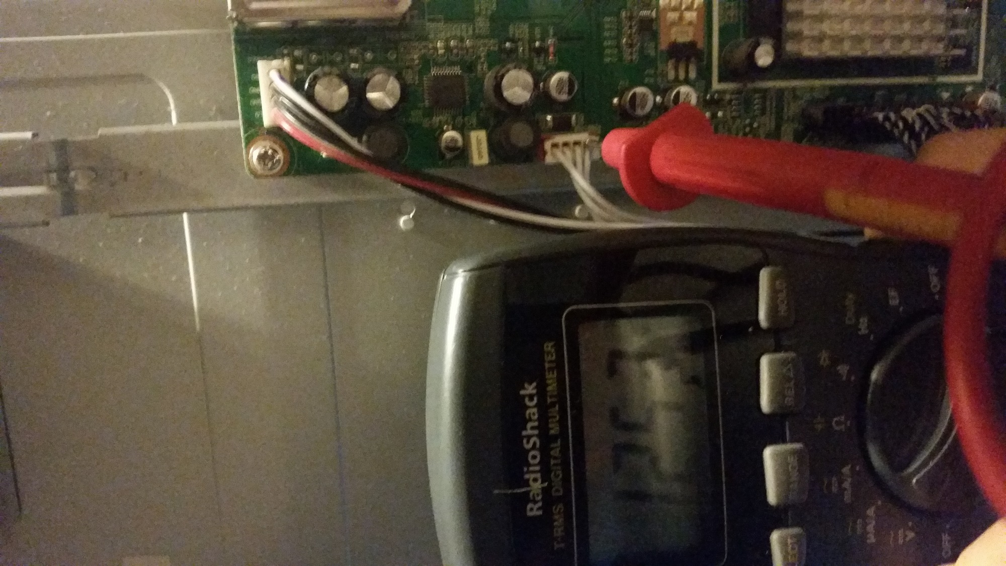

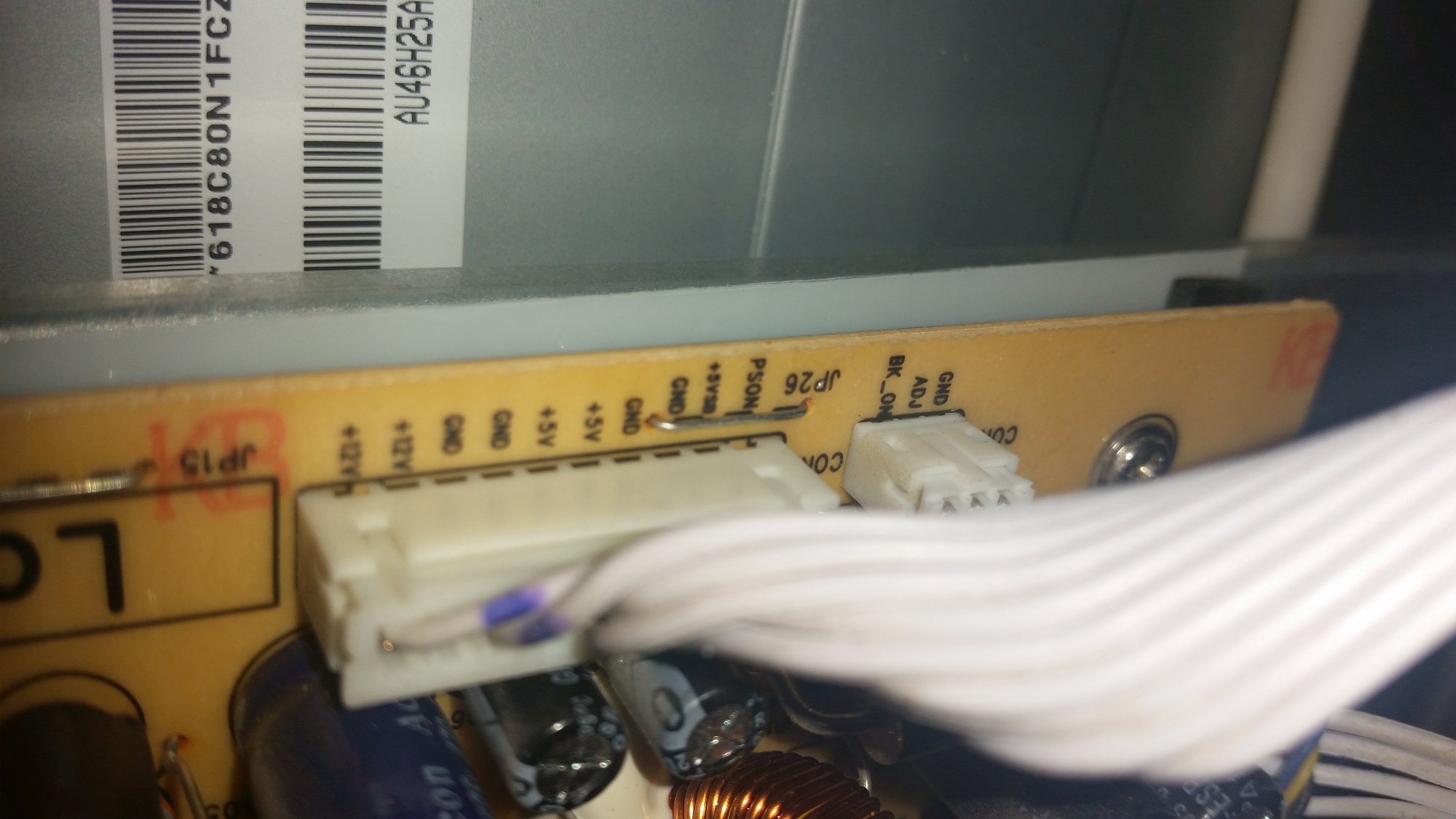

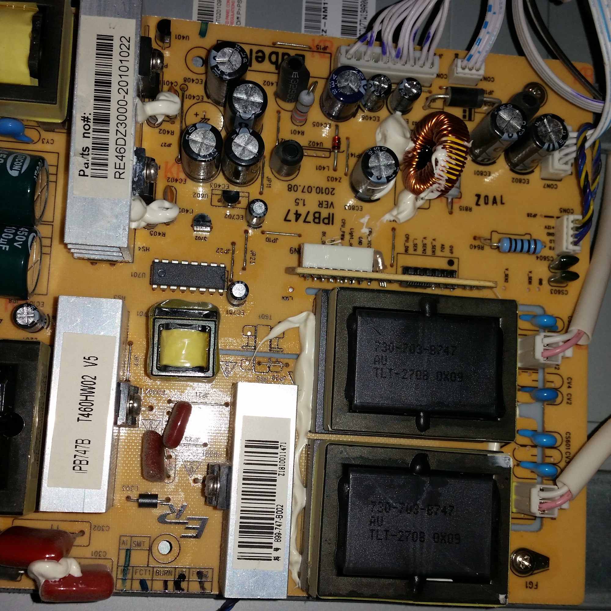

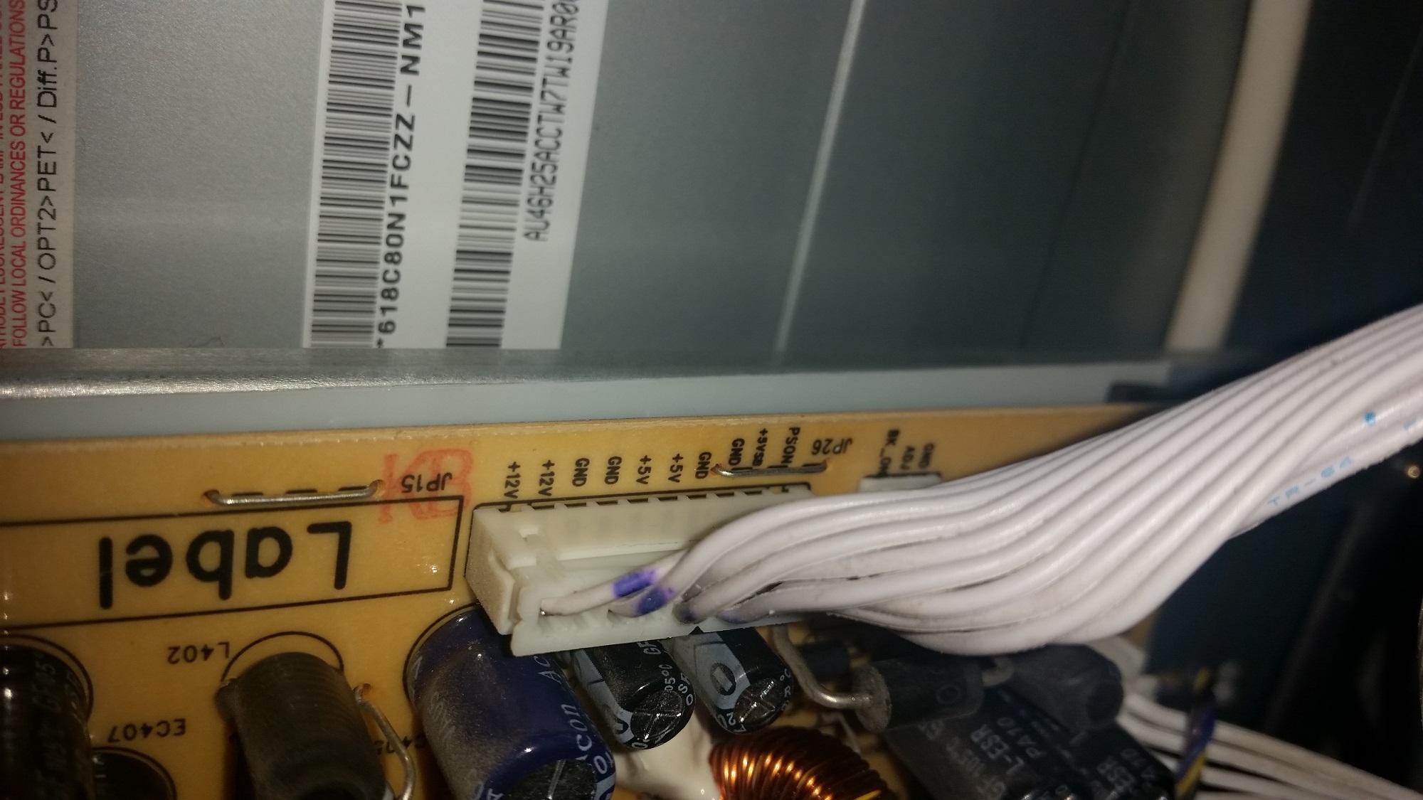

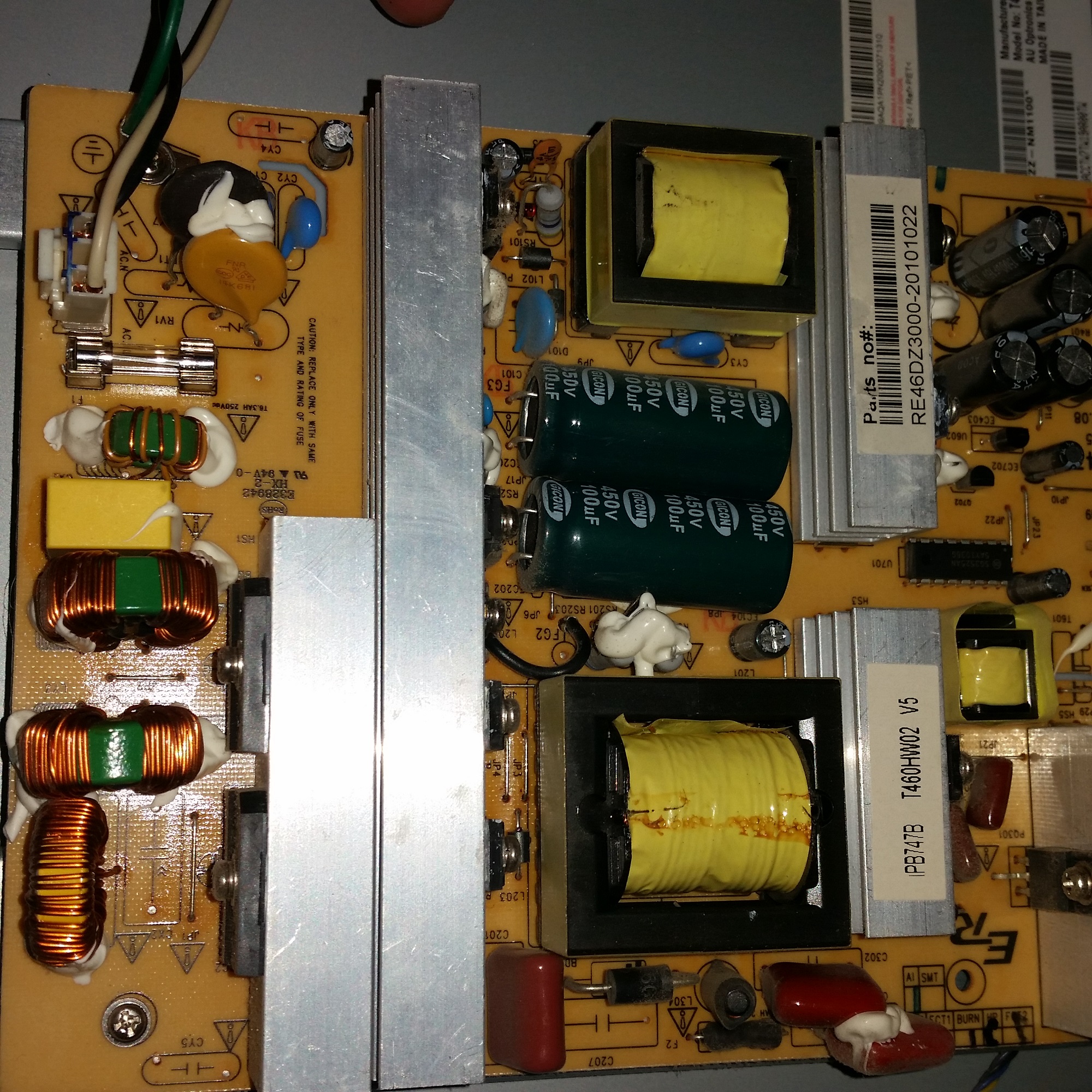

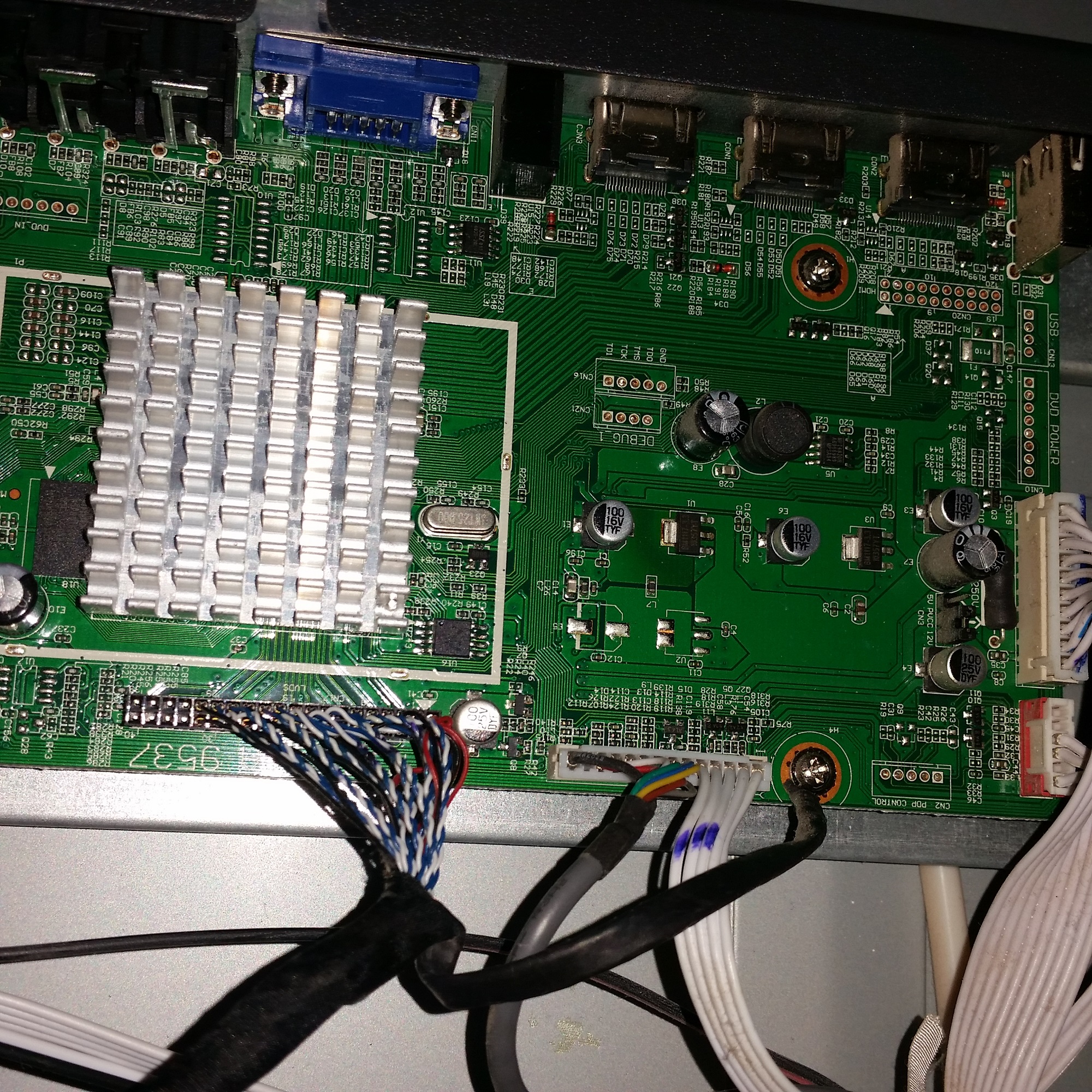

Hello, I have a rca 46LA45RQ that seems to not have power but it does have some on the power supply. Theres no standby light or backlight flash. I have tested the voltages on the power supply and they all test good. The 24 volt on the motherboard is at 12 volt not 24. other then that it all looks fine.

It needs standby Voltage to keep the main board alive.Never stop learning

"4.78 PS ON" You have power supply on signal.
".06 BK_ON" You do not have backlights on signal.Never stop learning

I know but i Cant figure out want needs to be checked on the back lights. From some video i watched it looks like this set has all the voltages on regardless if the set is on or off. Just not sure about the BK_ON. I also dont have any kind of standby led or power on led. The button does work though as i can measure voltage spikes when its pushed.Comment
Re: RCA 46LA45RQ no standby light or turning on
The command is generated by the main board, you have PS-ON signal from the main board so it is partially working. You have main board problem.Never stop learning
