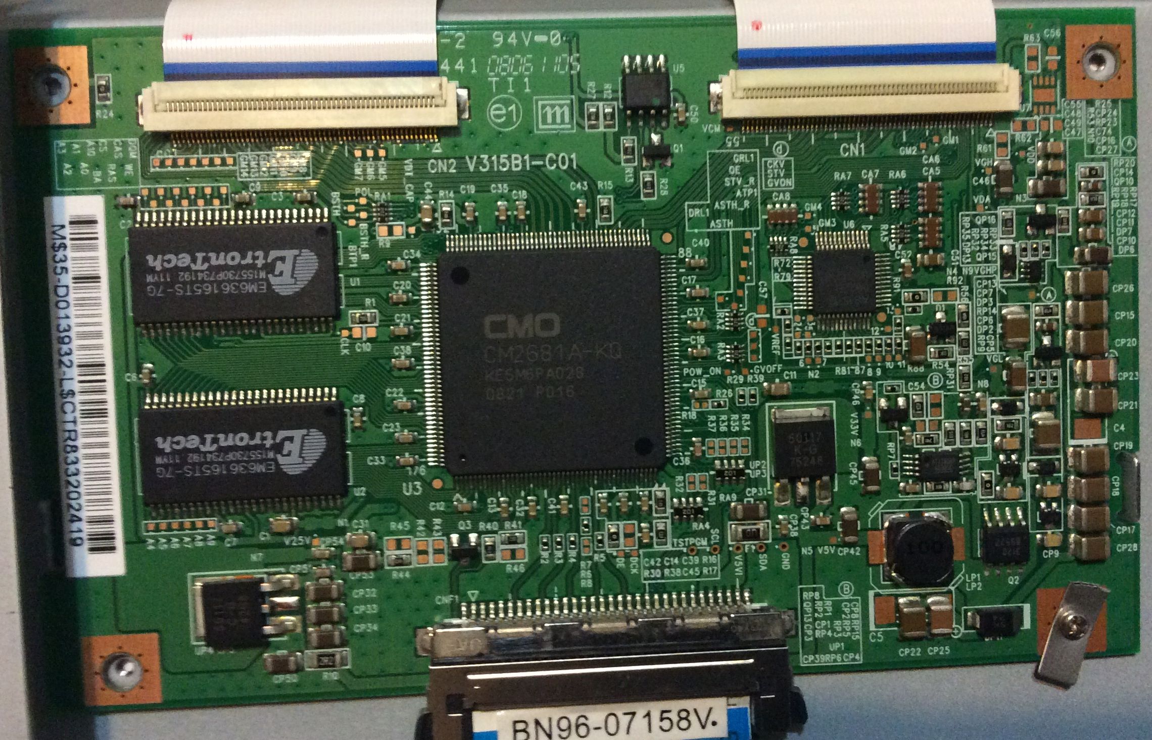

    T-Con Board: M$35-D013932-L$CTR833202419 Bar Code with AS15-G IC

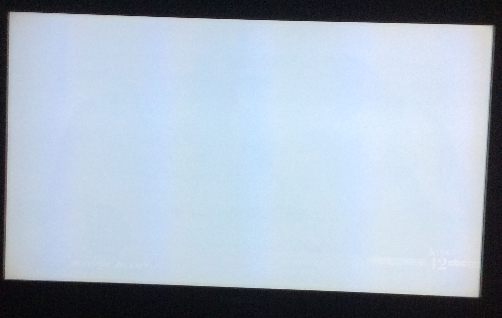

    Not a technician just trying to learn to fix my TV. Any help appreciated. TV powers on normally and has good sound, but the display is white with a very dim hard to see image in the background. I have searched the forum for this model TV and it seems like the place to start is to clean and reset the ribbon cables, which I have done and no change. Next I have checked the voltages on the T-Con with these results.
    GW1: 4.41, GW2: 10.06, GW3: 9.65, GW4: 9.04, GW5: 8.60, GW6: 7.56, GW7: 7.14, GW8: 7.09, GW9: 10.29, GW10: 5.44, GW11: 4.56, GW12: 3.58, GW13: 2.99, GW14: 0.00, VCM: 13.51. Do these look within tolerance?
    The AS15-G IC is very hot to touch. Is there more test points I should check? Is more information or pictures needed? Thanks
    Re: Samsung LN32A300J1D Whitescreen
    You have bad GAMMA IC (AS15).

      T-CON Board defective. You can get this exact replacement from ShopJimmy (SJ). They are reasonably priced and they have friendly assistants to answer any questions you may have. I purchased this very part from them not too long ago and it worked on first go and is still working about 3-4 months ago. Great place to shop... Cheers

        Thanks. I was afraid that was the problem but was hoping for the best. Will see about finding a replacement or having the IC replaced locally.

          You can purchase the AS15's for a few dollars on ebay. You will likely need someone with a hot air rework station to change them though.

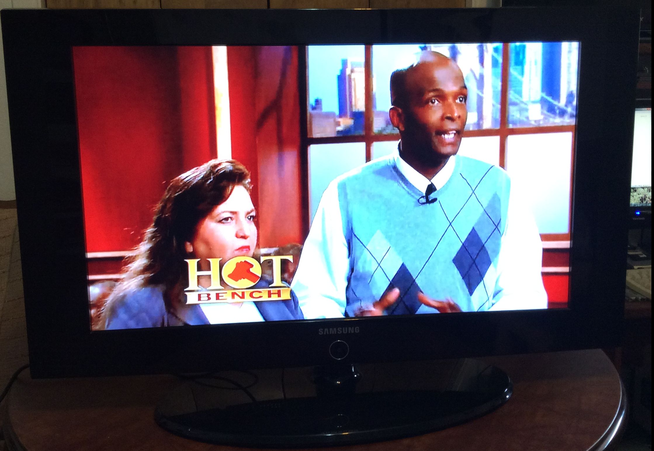

                          Wife said no to rework station so to keep peace in the family I got a T-Con board off ebay. TV now working great. Thanks for the help.
