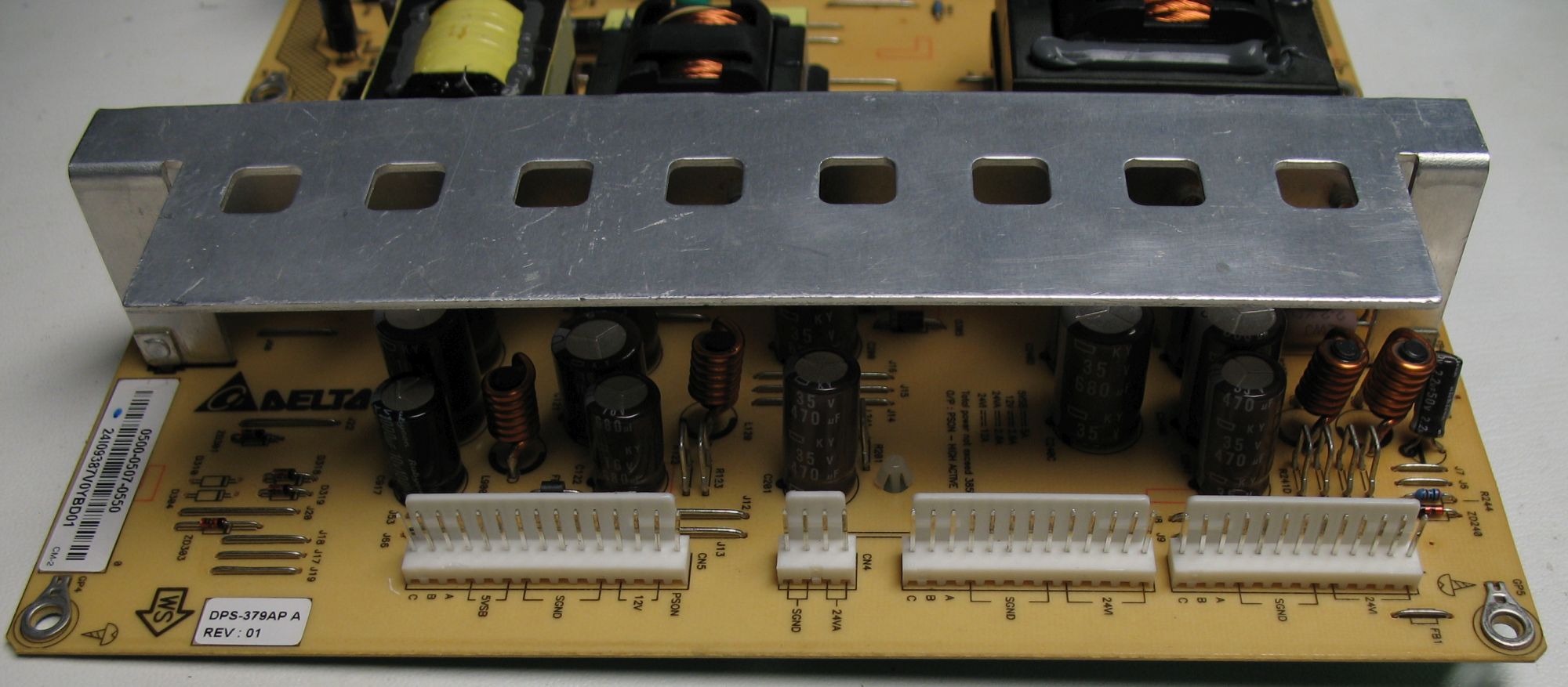

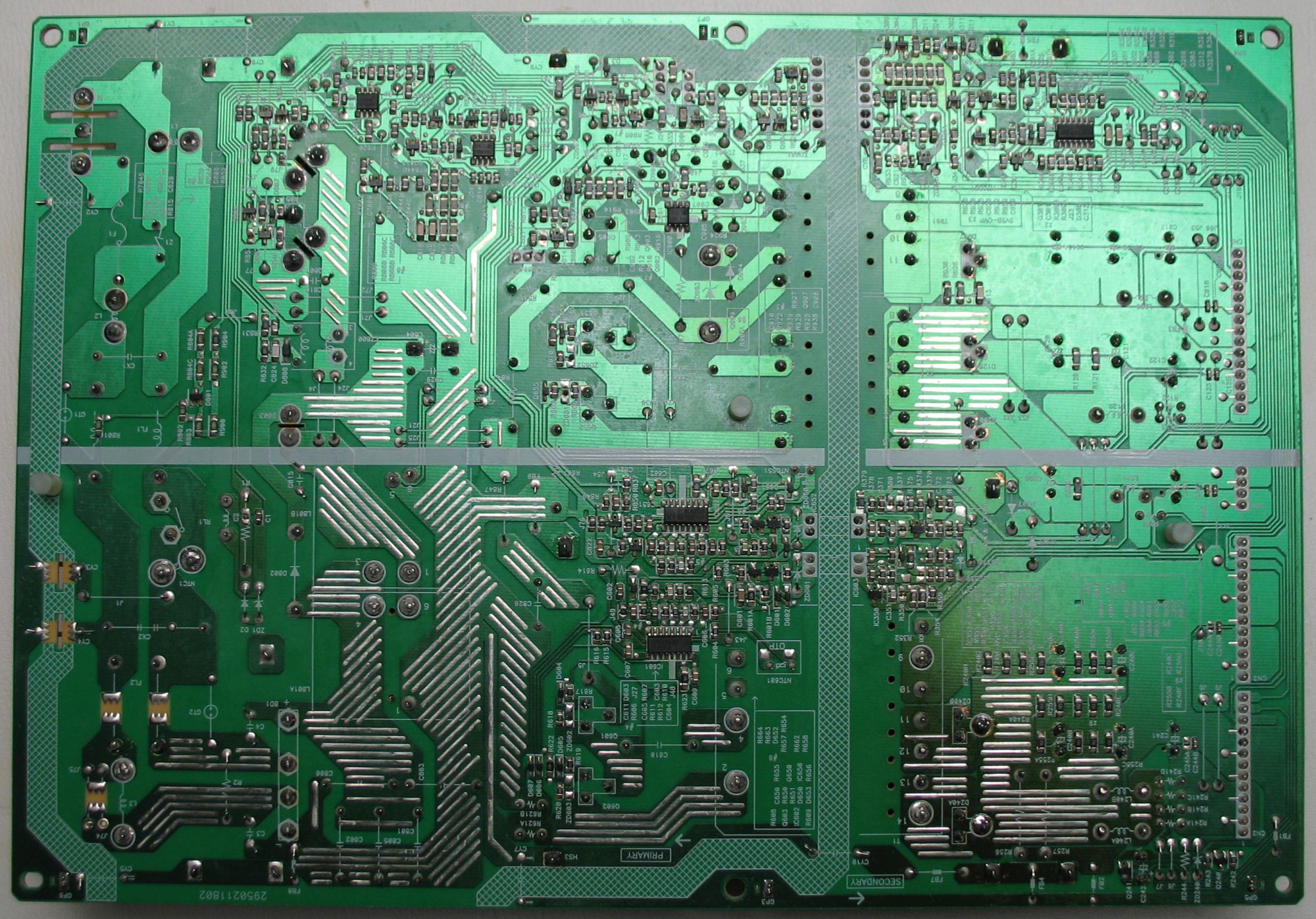

    I have a Vizio SV470XVT1A 47” LDT TV with a DPS-379AP power board.
    The board has the 5VSB and that's it no 12V or 24VI the Vizio logo on the front light orange.
    I have removed every Capacitor and tested it with an ESR Meter they all test good.
    All diodes, Resistors, MOSFET test good.
    I am new to working on the SMPS so kind of need some direction on where to start testing really wish I could find a schematic for the power supply but I don't think they exist.
    The main filter cap has around 170v DC on it.
    Let me know what else you need and I will provide it ASAP.
