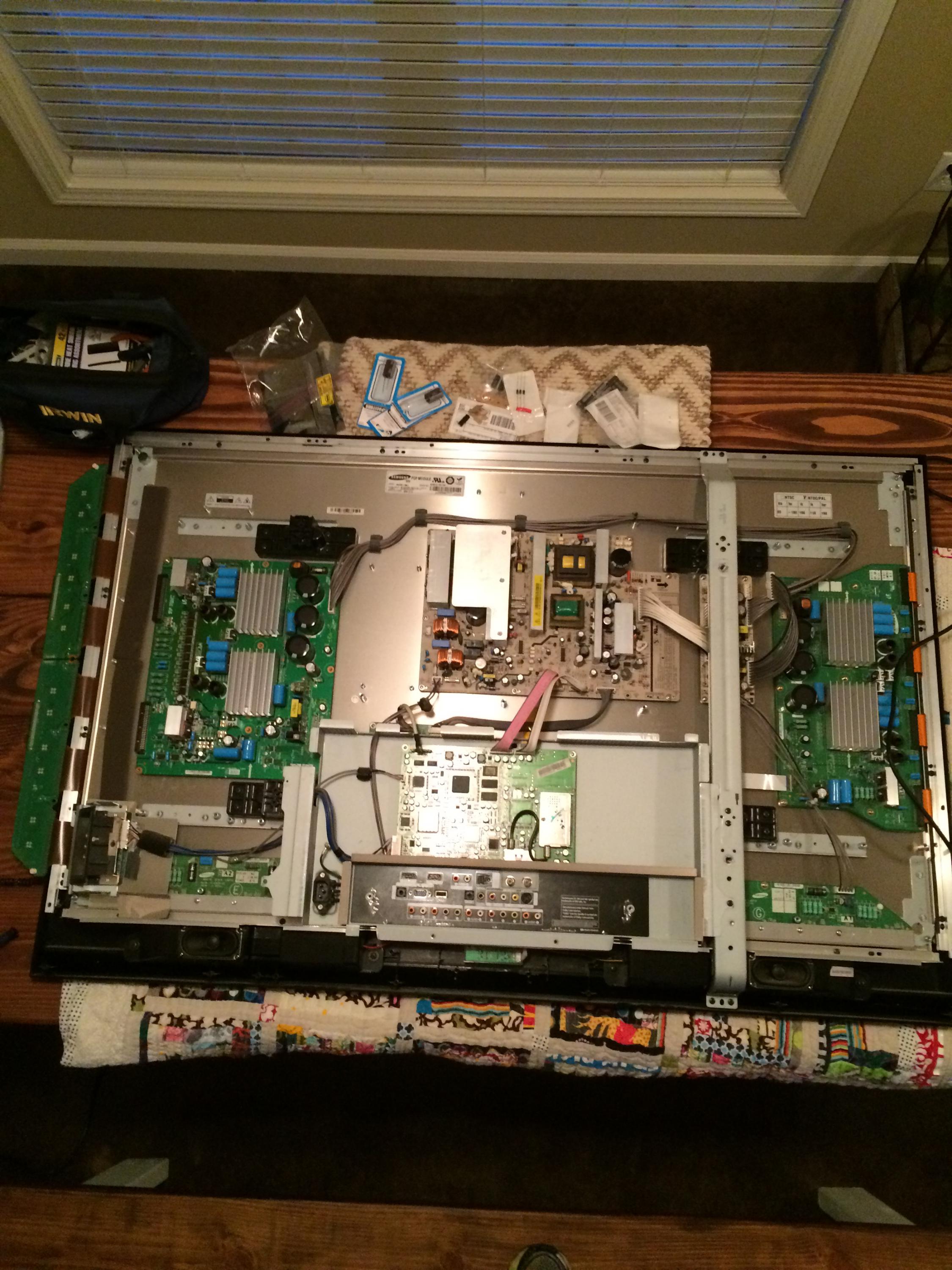

    Hello Everyone,
    Trying to fix an old Plasma for a friend. This is my second thread on here, similar situation (audio, no picture), but last time the issue was on an LED.
    TV Specs: Samsung 50" Plasma, Model# HP-S5053
    Ymain PN: LJ92-01436A
    Symptom: Audio, but no picture, not even the slightest glow, pitch black
    Checked so far:
    1. Power Supply-Outputting correct voltages on all pins, seems good.
    2. Ybuffer boards - upper & lower ICs all look ok visually.
    3. Ymain - replaced 2 bad caps, (C5034 & C5000-25V 680 microfarad), but still no picture. Also checked the resistors,fets, & diodes common b/w the upper and lower boards.
    Moving Forward:
    I believe the issue lies in the Ymain board (PN LJ92-01436A). I'm hearing a clicking noise that seems to be coming from C5907 (B, 472k, 1 kV), which is on a sub assy PCB (PN LJ92-01216B). Should I go ahead and replace that Capacitor or is something else causing the issue?
    I've browsed this site and the web for quite some time now, but haven't quite found what I'm looking for and figured I would save some time and ask you guys for some guidance.
    I apologize for not posting photos, but I've seemed to misplaced my camera (recently moved). When I find it I will load photos to help troubleshoot.

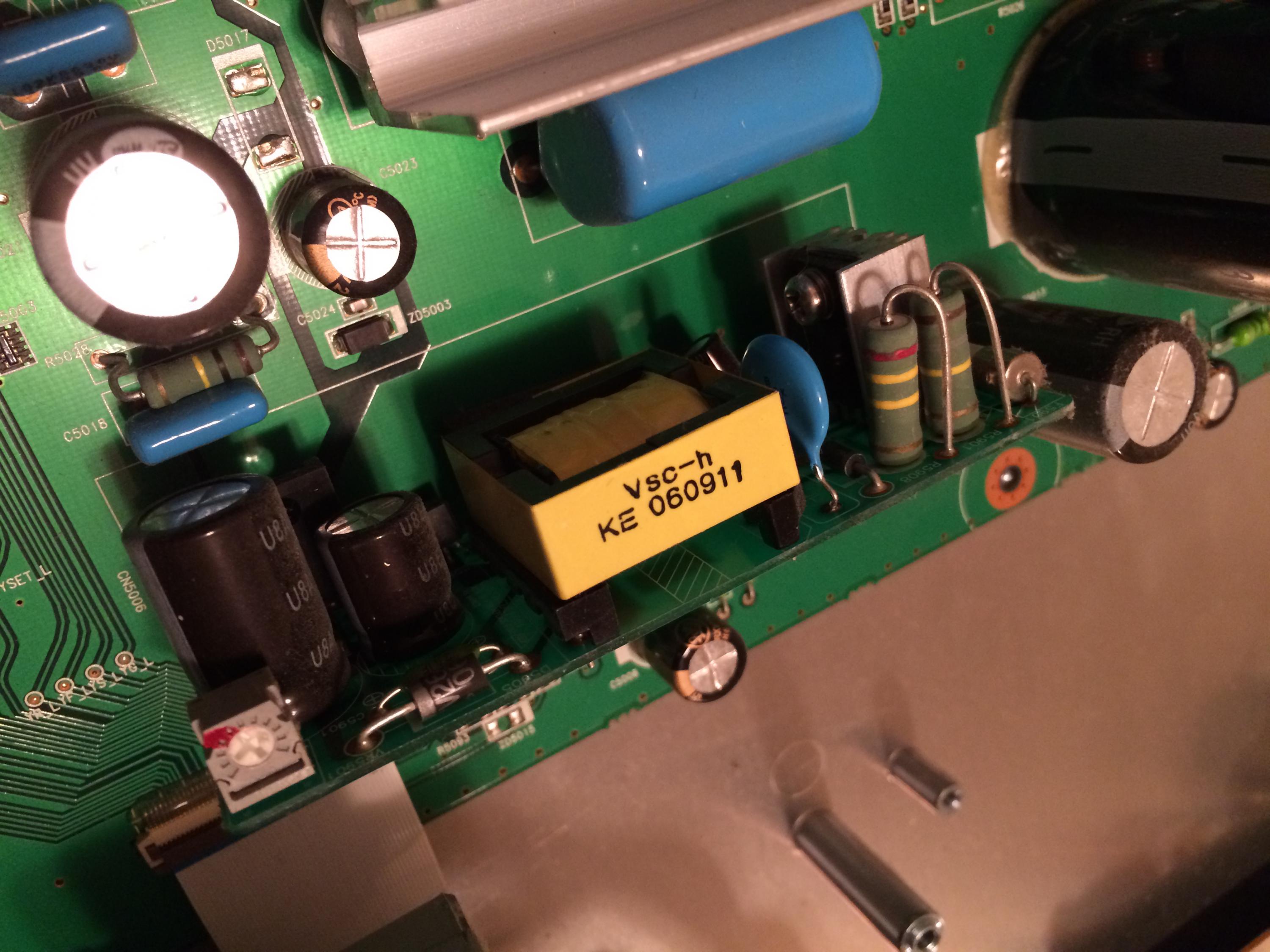

              Everything looks good except for Vsc_h located on the Ymain. The reading is oscillating from -4 to -7 volts. I've checked most of the neighboring components, but no luck as of yet. Anyone out there know what may be causing a failure at Vsc_h or how to troubleshoot?

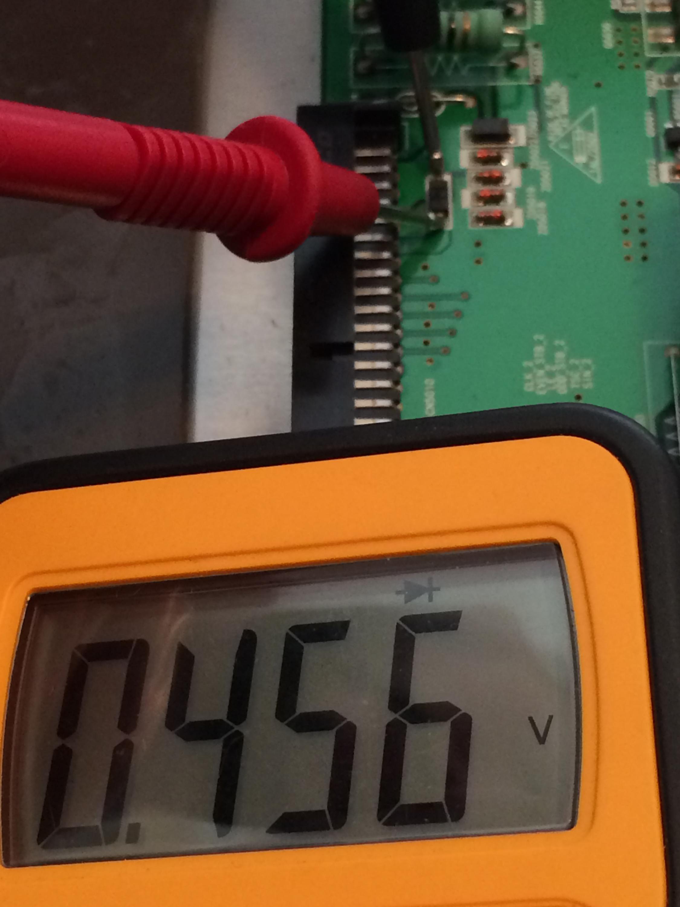

                I'm by no means an expert but I would be checking for a shorted or failed diode like crazy. I usually find one or two after replacing vented caps. Lift one side of the diodes legs if possible but i have had good success checking them in circuit with my VMM. Be sure to power down and discharge the board first. (just saying for safety's sake). There is also the possibility of a partially failing power transistor. The one on my plasma had 7 legs but was basically a mosfet. only one part of it was failed so like you most of my voltages were ok except one rail. Hope this helps.
                • Vandy30
                  • Sep 2013
                  • 27
                  Re: Samsung 50" Plasma, Model# HP-S5053, Audio, but no Picture
                  Thanks Doc,

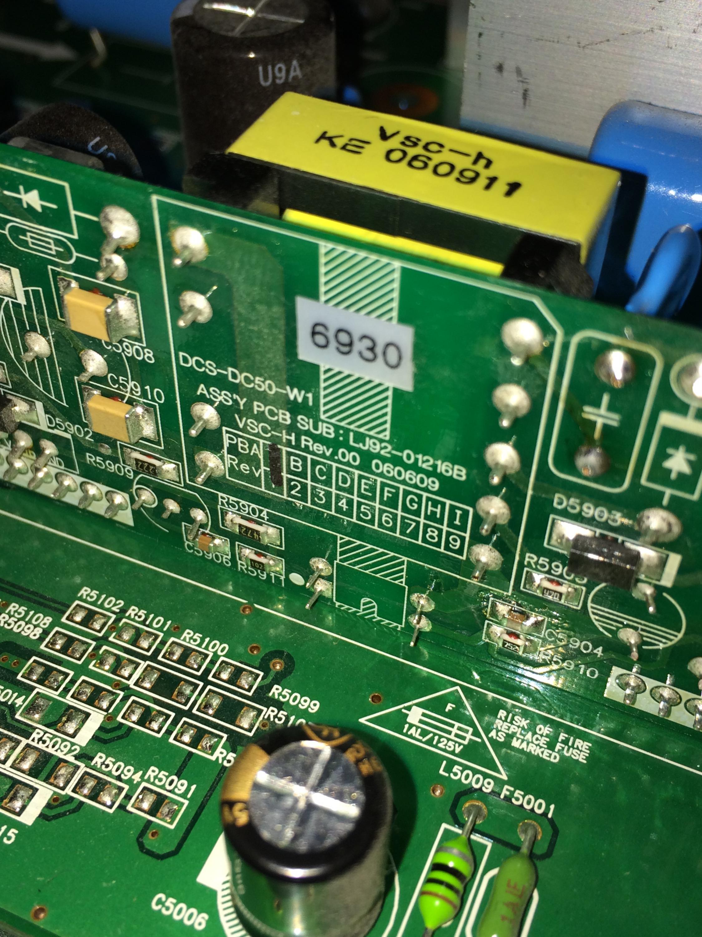

                  I went back and found 2 diodes that I'm not sure if they've failed or if the surrounding circuitry is causing a strange reading. D5203 is the one in question (probing in photos 1 & 2, close up of location in 4th photo). It is showing s/c. This is on the lower y buffer. The exact same diode on the upper y buffer is reading the same... 0.001V regardless of the position of the leads (see pics 1 and 2).
                  I'm not very good at desoldering smd's, so before I attempt to do so, I was hoping someone could lead me to a direct replacement for the diodes in question, F4 6H (close up in photo 4) in case I damage during removal or the diode is in fact bad. There are quite a few of these on the board, and most read around 0.45V everywhere else, this is the main reason why I suspect the 2 in question. Any advice is greatly appreciated! Thanks in advance.

                    It is a EC11FS4 ultra fast recovery diode 1A 400v marked F4 xx you will need to check it off the board ? if you have any old faulty boards you will find them used almost every were the 6H is the date code Flocko

                      Thank you for the info Flocko. Sorry for the delayed response, been busy.
                      I was able to remove the 2 diodes I inquired about (F4 xx) and they tested ok out of circuit. I also removed another diode in a different location and a zener diode and both tested good.
                      I really don't know what I need to do next. I still think the issue is on the Ymain, in particular some of the components related to the Vsc_h since that reading is jumping around from -4 to -7 volts and is supposed to be -70 from what I understand. I've probed all associated components, but not finding anything wrong. I still hear a clicking sound coming from a small transformer, I'm not sure if this is normal or not, but it makes me wonder if the 2 are related.
                      Any other ideas? Could all the boards be ok, but something actually be wrong with the plasma and I'm just spinning my wheels? This one has me baffled lol.

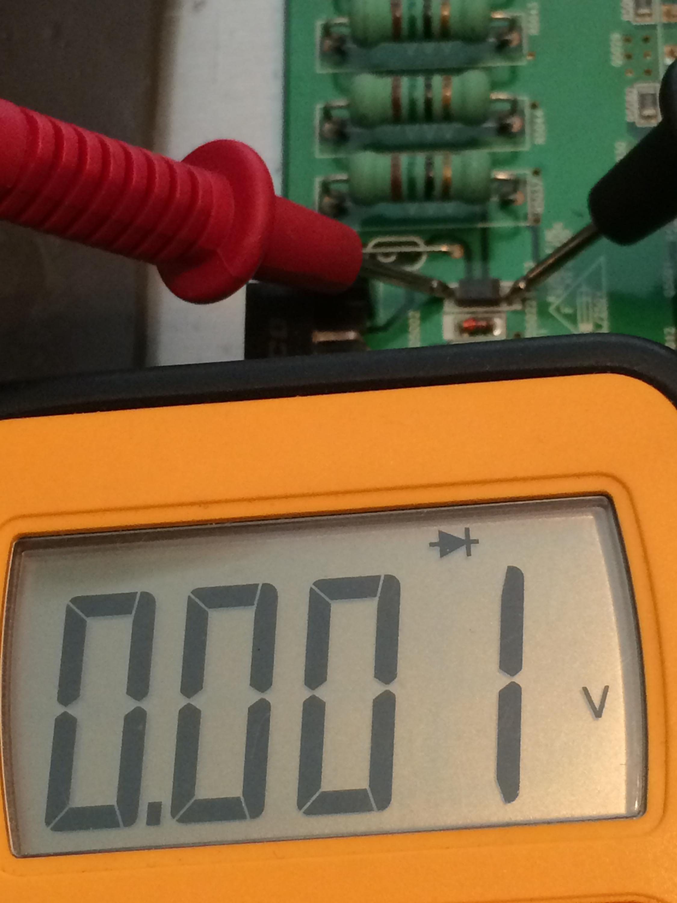

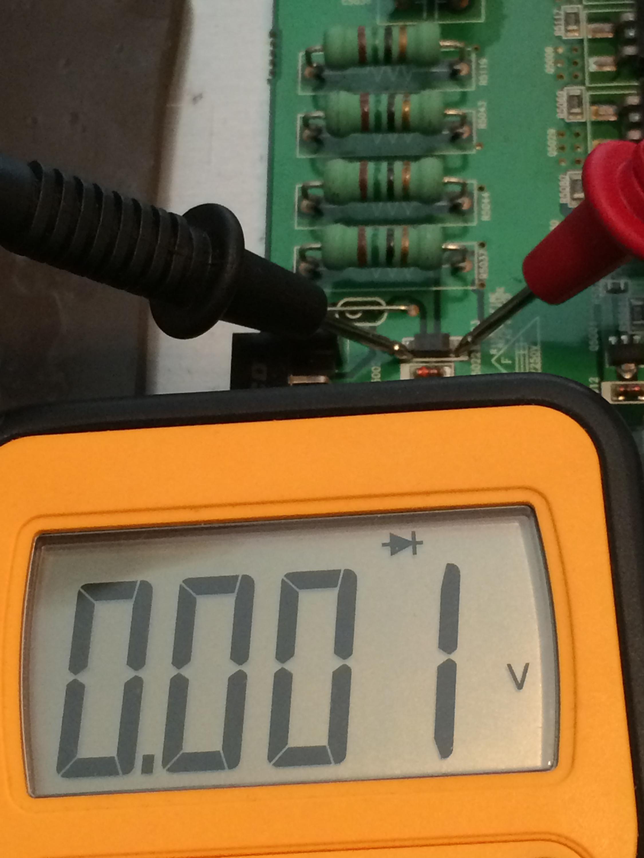

                        I just received the exact same tv in my shop today, and just like you I have sound but no picture. All voltages appear correctly on my DMM, but there is no picture.
                        My set does have a dead give away however since that diode that you are testing and reading 0 going both ways, that one is black on my board along with the 4 little red zeners below it.

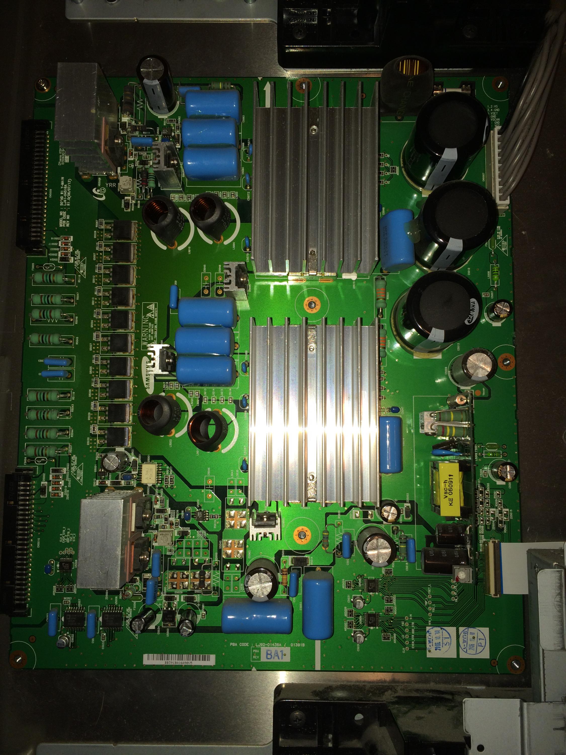

                        If I were you I would check the transistors that are soldered down to the board. Make sure those are good, mine are all registering a short.
                        I would also check the voltage going from the Y to the buffers.
                        I luckily have another similar Y sustain with a lot of similar parts I can scavenge from. I will attempt a repair myself and let you know of the results. If I can get it up and running, we can start comparing output voltages, and component readings.

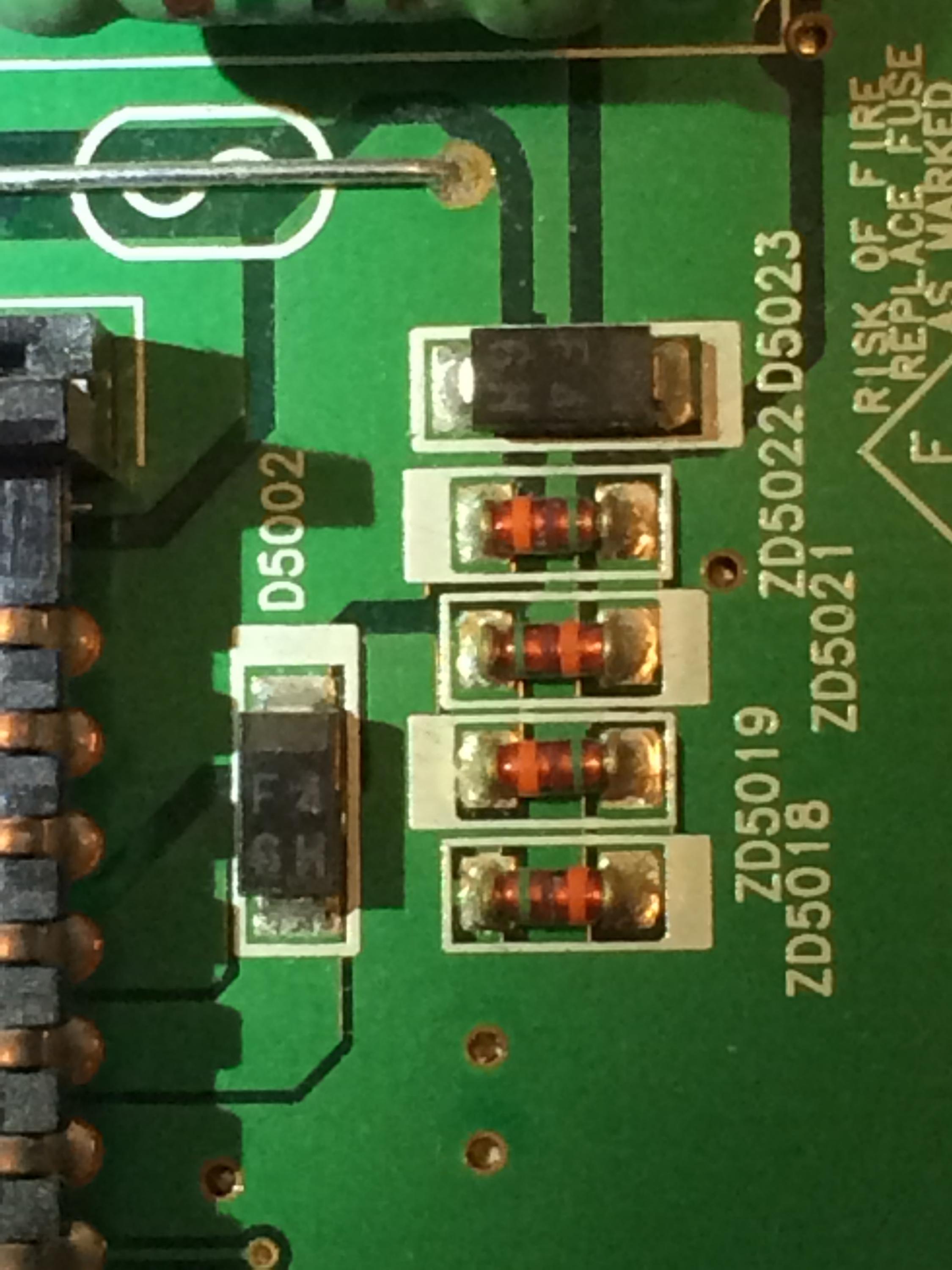

                          Q5013 part number TA50N28T voltage regulator was registering a short. It caused the entire row of transistors connected in parallel to show a short as well. All the others were ok after I replaced the one. I replaced it with a TA36N30P because that is all I have on hand. Originally I thought that the spare board I had was the same but its a different version, so the voltage regulator is slightly different, and unfortunately I can't find a data sheet on either of these guys so If anyone has info on this little guy please share. I have it soldered in but I doubt I will fire it up with it in there unless I can get confirmation that they are substitutable. Probably will end up buying a spare off ebay or something.
                          Any way, I also replaced ZD5018 ZD5019 ZD5021 ZD5022 since they were all shorted out. The traces were completely burnt and black, so I had to do some creative soldering to put these back in.
                          D5023 and D5024 are supposed to register to be almost shorted since they are in parallel with a 15 ohm resistor.
                          On the other board I had scavenged from, I noticed that the resistor R5004 was registering a short so check out that guy, its supposed to be 100k ohms.

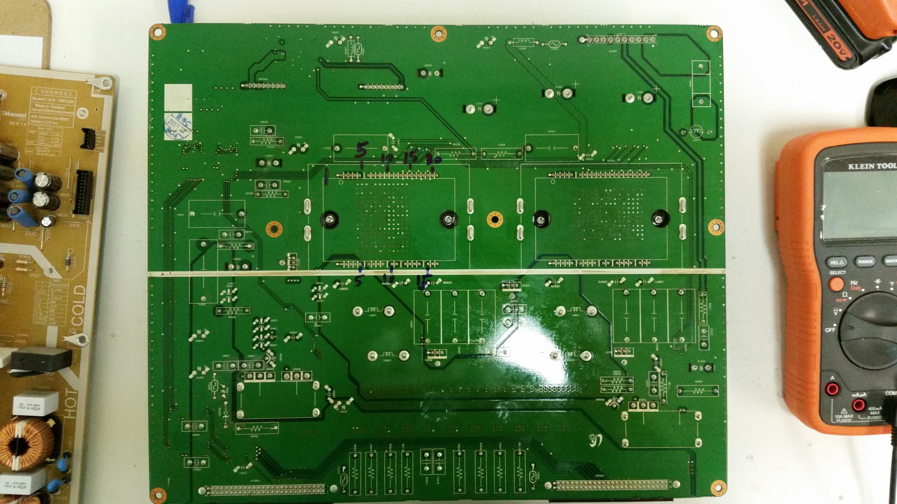

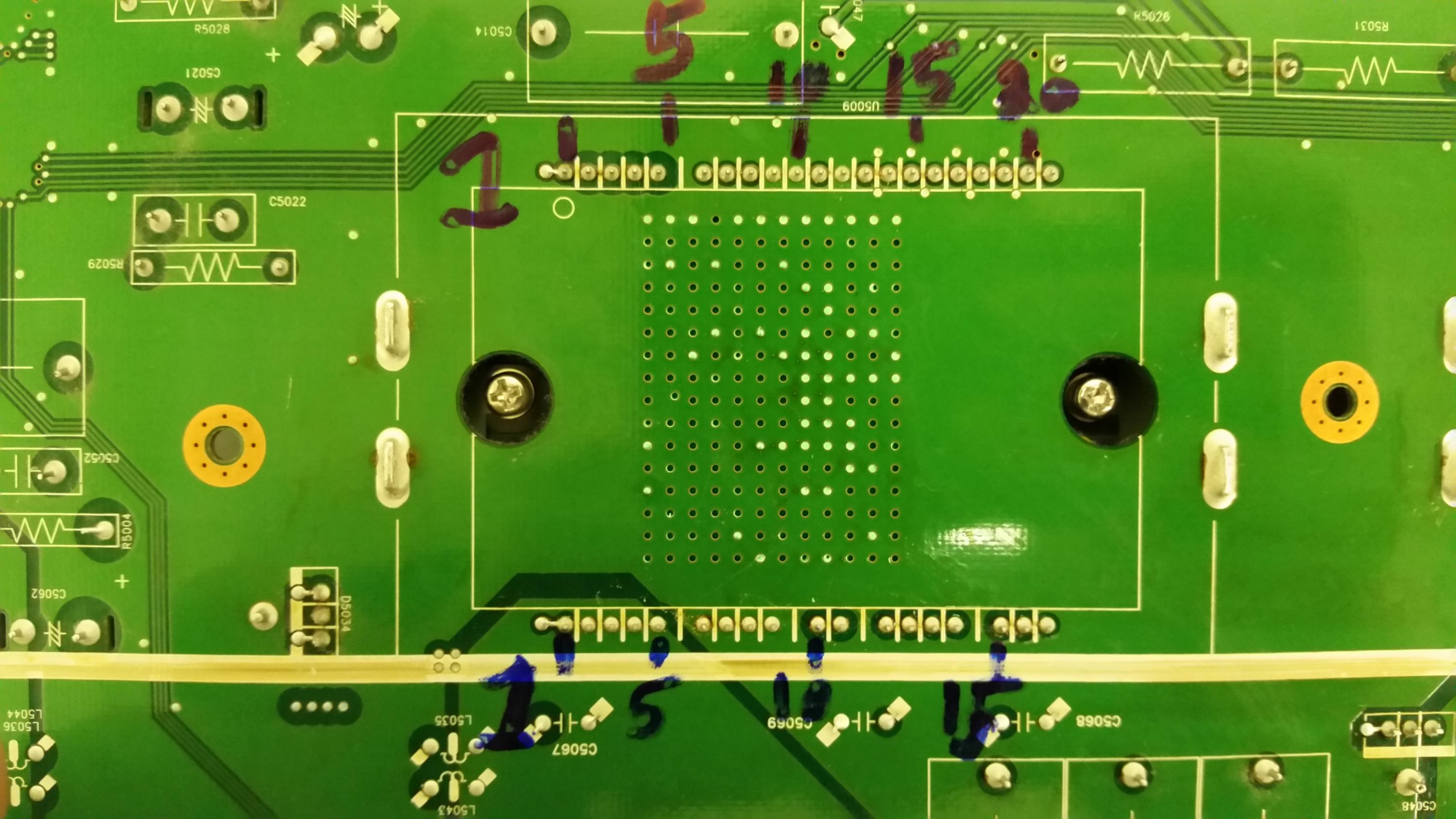

                                • Nick's Tvs
                                  • Jan 2014
                                  • 621
                                  Vandy30
                                  I am sorry I have had a really busy week at the shop. I have not gotten my board fixed yet since I have yet to get the part ordered from china. It is supposed to come in today or tomorrow however according to tracking.
                                  Here is what I found out. Please see pictures for the pin numbers.
                                  More than likely those are not the correct pin numbers but just follow my numbers. Also all of the measurements here are taken in diode mode.
                                  Upper pins 2/3/4/5 pins 9/10/12 and pins 14/16/18/20 are 3 groups of pins that are shorted with one another within their groups.
                                  Lower pins 2/3/4/5/10/11/15/16 and pins 6/7/8/9 are 2 large groups of pins that are shorted with one another within their groups.
                                  Here is what I found out with Red probe top pins black probe bottom pins.
                                  Top Pins 2/3/4/5 and 9/10/12 bottom pins 2/3/4/5/10/11/15/16 read 0.344V
                                  Top pins 14/16/18/20 bottom pins 2/3/4/5/10/11/15/16 read .747v
                                  Top pins 14/16/18/20 bottom pins 6/7/8/9 read .505
                                  Here is what I found out with red probe bottom pins and black probe top pins
                                  bottom pins 2/3/4/5/10/11/15/16 top pins 2/3/4/5 read 0.342v
                                  bottom pins 6/7/8/9 top pins 2/3/4/5 read 0.522
                                  bottom pins 6/7/8/9 top pin 6 read 0.464
                                  bottom pins 6/7/8/9 top pins 14/16/18/20 read 0.500v
                                  This is slightly confusing I know, so if the way I am writing this out doesn't make sense, please tell me and I will try to formulate it differently.

                                    Alrighty,
                                    First off, Thank you very much Nick, I owe you one. Here are my readings.
                                    On the Upper Pin continuity check, groups 2/3/4/5 & 9/10/12 were connected, but 14/16/18/20 were not, on both modules.
                                    On the Lower Pin continuity check, groups 2/3/4/5/10/11/16/17 & 6/7/8/9 were good. It looks like you may have labelled bottom pin 16 as pin 15 in the picture so I think you mean 16/17 if i'm not mistaken?
                                    For me:
                                    2/3/4/5 to 2/3/4/5/10/11/16/17 read OL/OL (left module/right module)
                                    9/10/12 to 2/3/4/5/10/11/1617 read 0.333v/0.333v
                                    For me:
                                    14/16/18/20 to 2/3/4/5/10/11/16/17 read 0.624v/0.624v
                                    14/16/18/20 to 6/7/8/9 read 0.386v/0.386v
                                    For me:
                                    2/3/4/5/10/11/16/17 to 2/3/4/5 read 0.331v/0.331v
                                    6/7/8/9 to 2/3/4/5 read 0.513v/0.513v
                                    6/7/8/9 to 6 read 0.452v/0.452v
                                    6/7/8/9 to 14/16/18/20 read 0.383v/0.383v
                                    In summary, most of the readings are fairly close, with exception of a couple that look to be quite a bit out of tolerance. Is it safe to assume my modules are bad based on these readings? The fact that pins 14/16/18/20 are not connected is concerning as well. If modules are deemed bad, is the only fix just to replace the entire board? These look like they would be difficult to work on.
