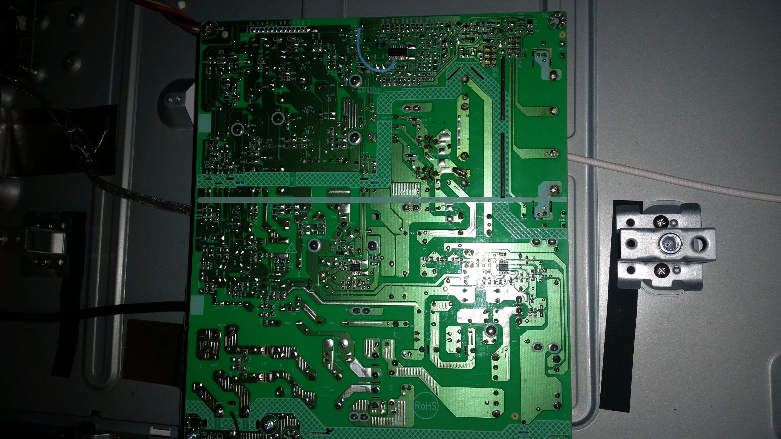

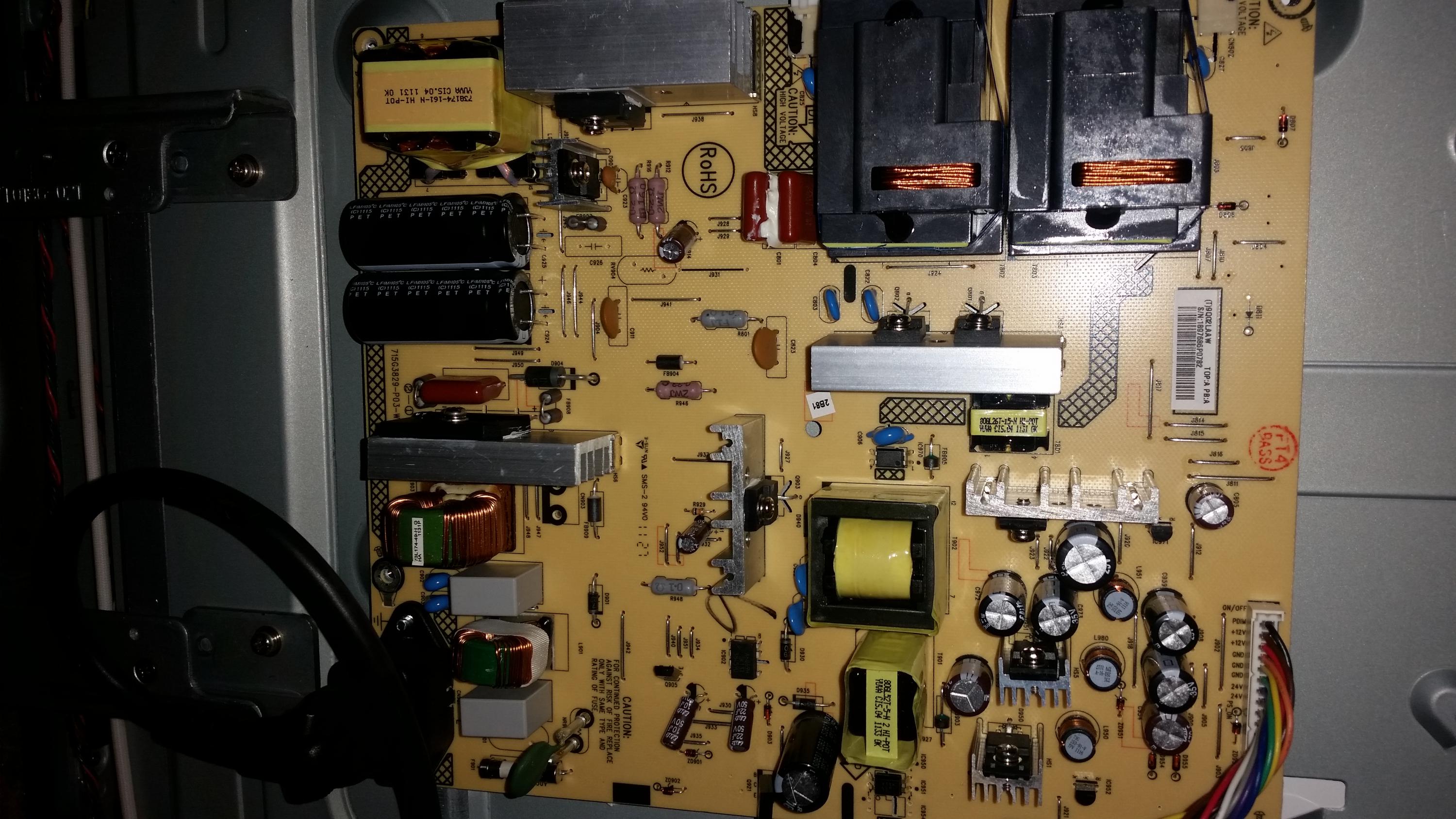

            Here's a pic. More to come hopefully.
            I have a feeling the Inverter ic went belly up

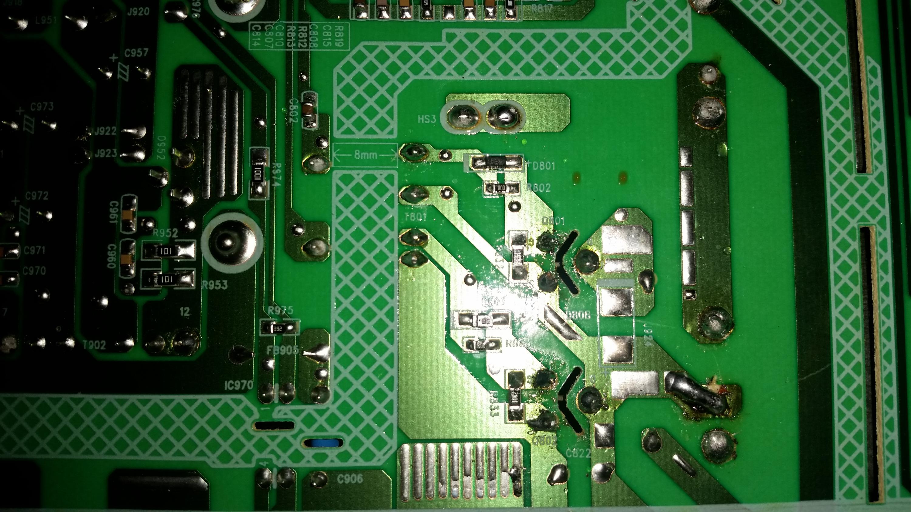

              The only thing.i have found thus far was a shorted 12n50 at location Q802. This is a power mosfet for one of the ballast transformers. The other one appeared to be ok but I replaced both for good measure. The primaries and secondaries ohm within spec of each other on the output transformers.
              like I said before as soon as I found that shorted MOSFET I replaced it. when I powered the TV up I had back lights after about 2 seconds it started to flicker a little dim and back to bright again and then it would go out. But now the MOSFETs are no longer shorted still but now I have no back lights at alllike I said before it soon as I found that shorted much when I power the t_v up I had back late after about 2 seconds started to like you're a little damn back to bright again in and it would go out. But now I have no back lights at all again but the MOSFETs are not shorted.
              Oddly D802 registered shorted across. But removed it's not shorted. on the picture d802 is located underneath the blue jumper wire that I used to test the timer bypass to see if the back lights will come on
