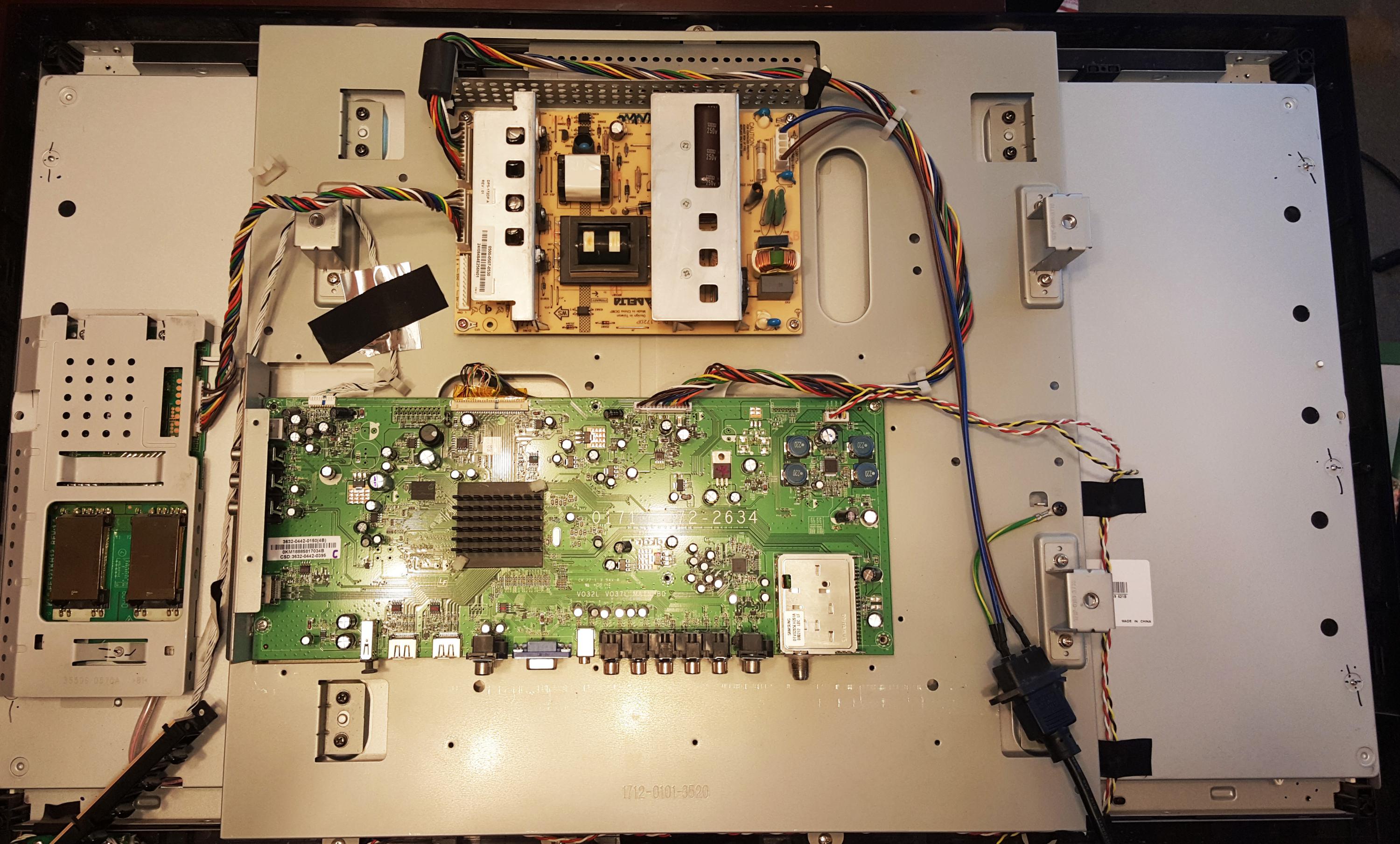

    Ok, this one is kinda boggling my mind. I have a Vizio VO32L that "kind of" won't power on and "kind of" has no picture. I say this to indiciate that i have been able to get it to power on and show a perfect picture but cannot replicate this. further details to clarify this mess of an opening statement to follow:

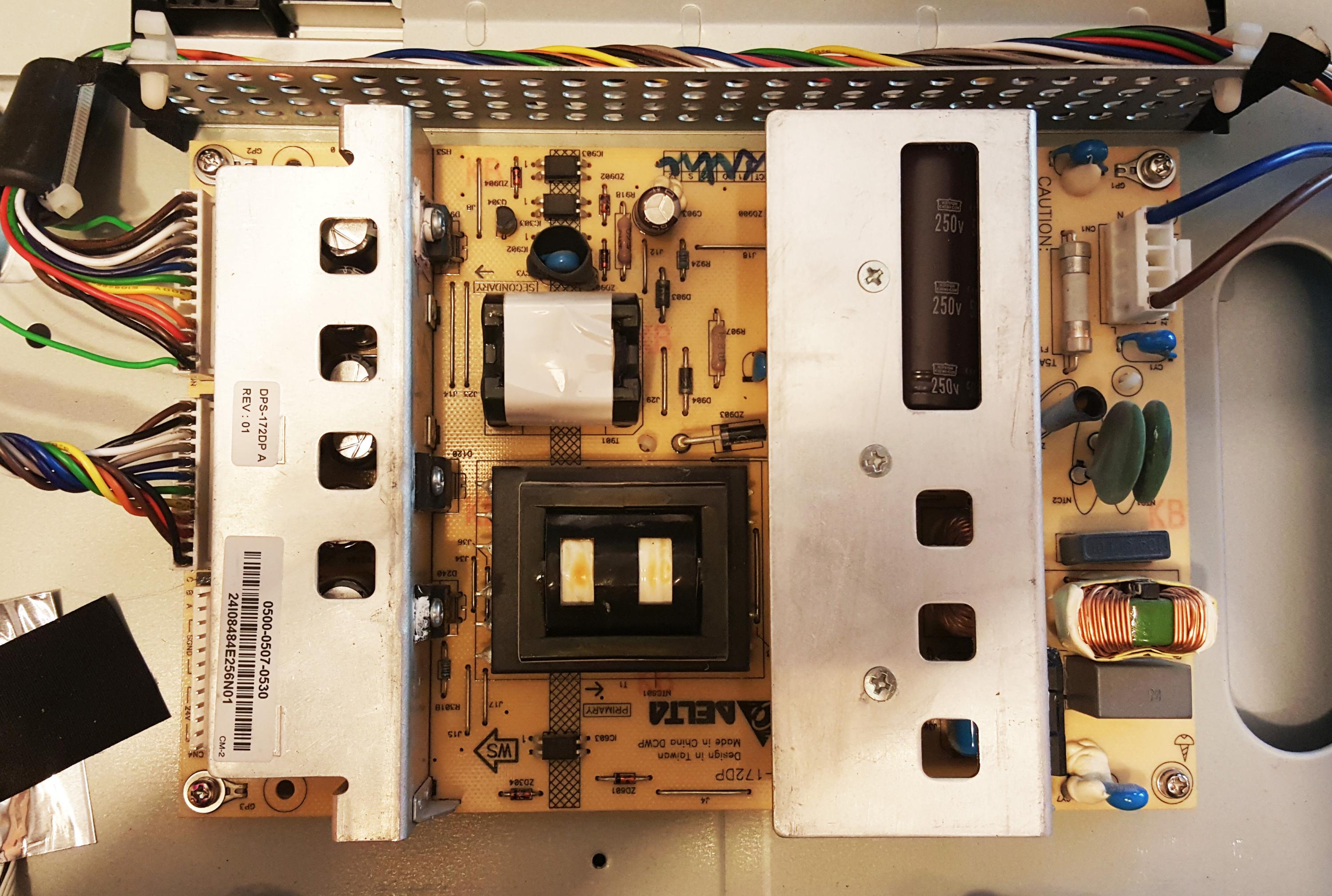

    For starters....when first plugged in, the orange vizio standby light comes on and then slowly fades. It still on, just not as bright. Pressing the power button does nothing. 5VSB is outputting appx. 5V as it should. 12V and 24V pins have 0V as to be expected when not powered on. If I jump 5VSB to PSON, the 12V and 24V pins come up to proper voltage. However the power button still does nothing and it won't power on. Still the orange light.
    Now here's where it gets strange. I took the button board off of the plastic bezel so I could test connections to verify that the power switch actually is working. (didint disconnect wires, just made the board accessible). The switch tested ok. Open when not pressed, closed when pressed. Then I set the button panel down (turns out i set it so the bottom of the board was resting on the shield over the inverter, not paying attention). At this point, I jumped from 5VSB to PSON again, and to my surprise the second I plugged the jumper into the PSON I heard a speaker make a little buzz for a split second, and at the same time a blue led on the back of the inverter came on and quickly faded out, and the backlight was on. I looked at the front of the panel and low and behold the dang thing is on and blue with "no input" bouncing around the screen! Vizio light was lit up bright white. Pressed the power button and the screen turned off, vizio light went orange, then within 1 second (i didn't press the power button again), the vizio light went white and the panel powered back on again working perfectly. Pressed the power button again and did the same thing. Off then right back on again. So I pulled the ac plug, then plugged it back in, and it automatically turned itself on and the screen came on etc. Pulled the plug again, then removed the jumper wire from the 5VSB/PSON pins to see if it would power up on it's own now. plugged it back in, pushed the power button, and not a thing. Tried to jump from 5VSB to PSON again and it's right back to where it was before. Orange vizio light, 12V and 24V power at the corresponding pins, but the set won't come on. it was then that I realized where I had set the button board before, and was wondering if me somehow shorting one of the solder joints to case ground did something that allowed the set to come on, which may in some way indicate where the problem is. As such I tried to replicate by finding the same short. Looks like the only power to the button board is 5VSB, so I shorted 5VSB to ground while it was jumped to PSON, and I heard a cap charge quick and the blue LED on the inverter came on again, backlight came on again, but only for a split second then it went out. Now if I try that same thing I hear that cap charge but its still where it was at the very beginning. All the pins power up but the set won't power on.
    Needless to same I'm completely at a loss here. Thought I was on to something but since I can't replicate the TV powering on I have no clue what to do next. Does someone know the proper steps to manually jump / power on this set? Do I need to ground something or jump voltage to something other than 5VSB to PSON? Something that I was accidentally doing at some point but couldn't figure out?

    Since you have to force on the power supply, it means that the main board is not sending the PS-ON signal to turn on the rest of the power supply, and for the backlights to come on, you will need to force on the bl-on pin also. I will never do the force on WITHOUT removing the control wires (PS-ON and the BL-ON) going back to the main board and I always use the resistors to limit the current in case you jump to the wrong pin or accidentally short them to ground, you can also damage the switched transistors on the main board if the transistor is ON (which is the normal condition to keep the PS-ON and BL-ON grounded).

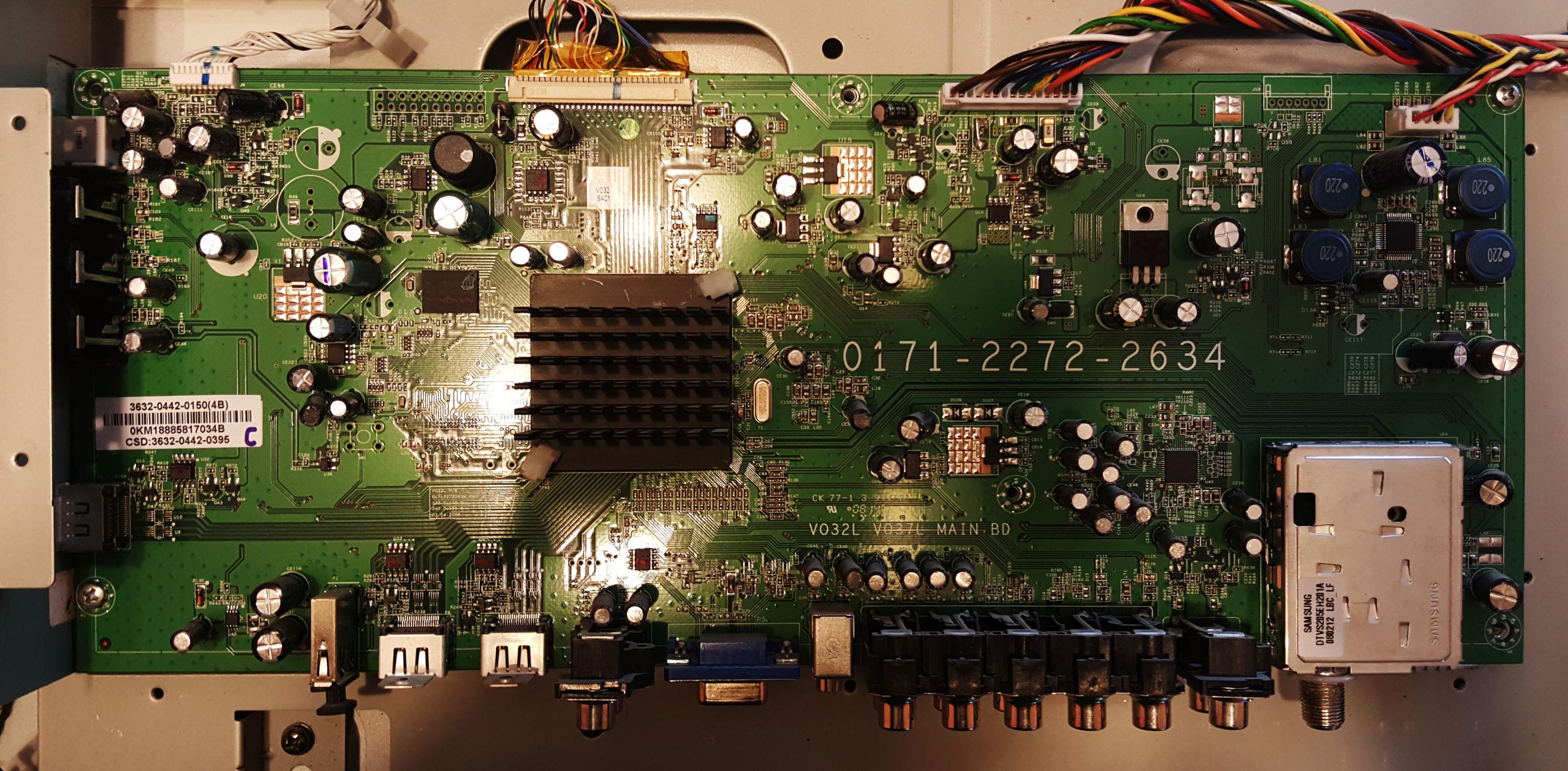

    You should also check the Voltages of the regulator ICs on the main board, this model is also known for bad EEPROM.

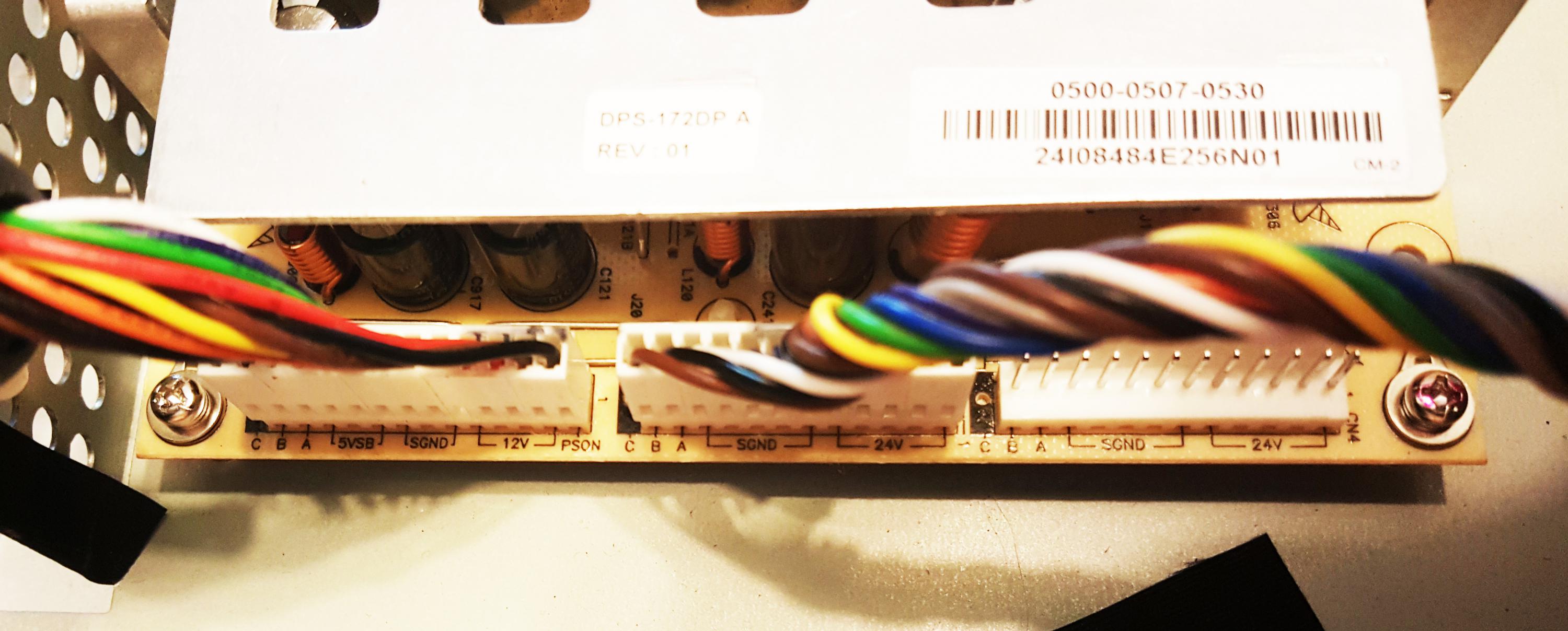

      ok, thanks for the tips. Might save me from inadvertently frying some stuff in the future! I'm having trouble finding a BL-ON pin. Are you able to see from the pics which pin this might be? No luck finding a service manual for this model.

        The BL-ON is one of those A, B, and C signal pins, one of the them for BL-ON, then other two are for Analog dimming and PWM Dimming.
        To find out which one is the bl-on, you need to locate the the BL-ON (or INV-ON, or ON/OFF) on the inverter board connector to see which one goes to the A, B, or C.
        Right now it can be that the main board may not be sending the PS-ON but it may be sending the BL-ON command, so check that signal on the inverter board to see if it is present or not when power switch is activated.

          alright. pin 12 ("on/off") on the inverter goes to "A" on the inv connector on the power board. When I jump 5V-SB to both PS-ON and "A" (BL-ON), The blue LED on the inverter comes on then fades out over about 1 second. the backlight comes on and stays on. The Vizio light on the front stays dim orange. Black screen.
            Re: Vizio VO32L - no picture / won't power on
            OK, your power supply and inverter are fine. Your main board is the problem, I would start checking the regulator ICs on the main board next.

              Ok. All 1117s read 1.23V from adjust to output
              • VividElectrode
                • May 2015
                • 57
                Also, output ~ adj+1.25V for all.
                  So all the readings are within the spec then?

                        Ok. thank you so much for all of your help! I will get a main board ordered up then.

                                It has been sitting for a few hours. Plugged in but the surge protector switched off. Jumpers still in place to PS-ON and BL-ON. I flipped the switch on the surge protector and the set came on, screen came on blue and displayed the input and no signal etc. In other works, working properly. (But jumped). I pressed the power button and it shut off. Vizio light back to orange. Pressed power again and it wouldn't come back on. Just the orange vizio light and the backlights. So I unplugged it and disconnected tcon. With the tcon disconnected and jumpers in place the set comes on with the vizio light white, backlights on, black screen.
                                  Since you did get the pictures on the screen then the T-CON is fine. I wonder now that the problem can be the EEPROM problem.
