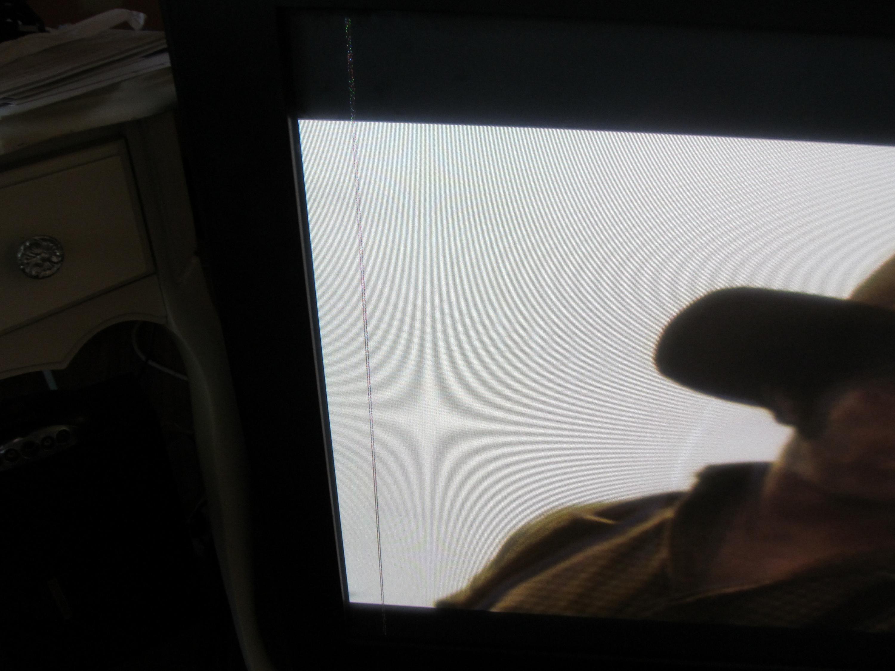

reaseat cables ? line going down the left side of the screen
    i tried to reseat ribbons nothing so far ... got the power supply repaired today and now this
    Re: reaseat cables ? line going down the left side of the screen
    srrry sanyo 50 inch dp50747-00 plasma
    samsung power supply
      This is a panel fault - unfortunately it can't be fixed.
        thanks tom i was hoping you would chime in i was thinking after reading some post it was a buffer board , but when you say panel im guessing you mean in the screen itself ... probably my fault when i put the power supply in one wire i left off and i forgot the tv was on , and yep it arched on me i bet i sent it to the bone yard dam i paid 50 buck to fix the power supply yesterday lol i guess life lesson
        yea its 2 pixalated lines flickering all colors like static
          Yes, if you connect Va voltage to panel while it is live and the rest of the set is "dead" this can kill the panel.
          It's a good lesson for the future... 2 thin lines... you got off easy.
          I've seen panels, where the whole display is covered in lines (due to Va connection while live.) Ouch!
