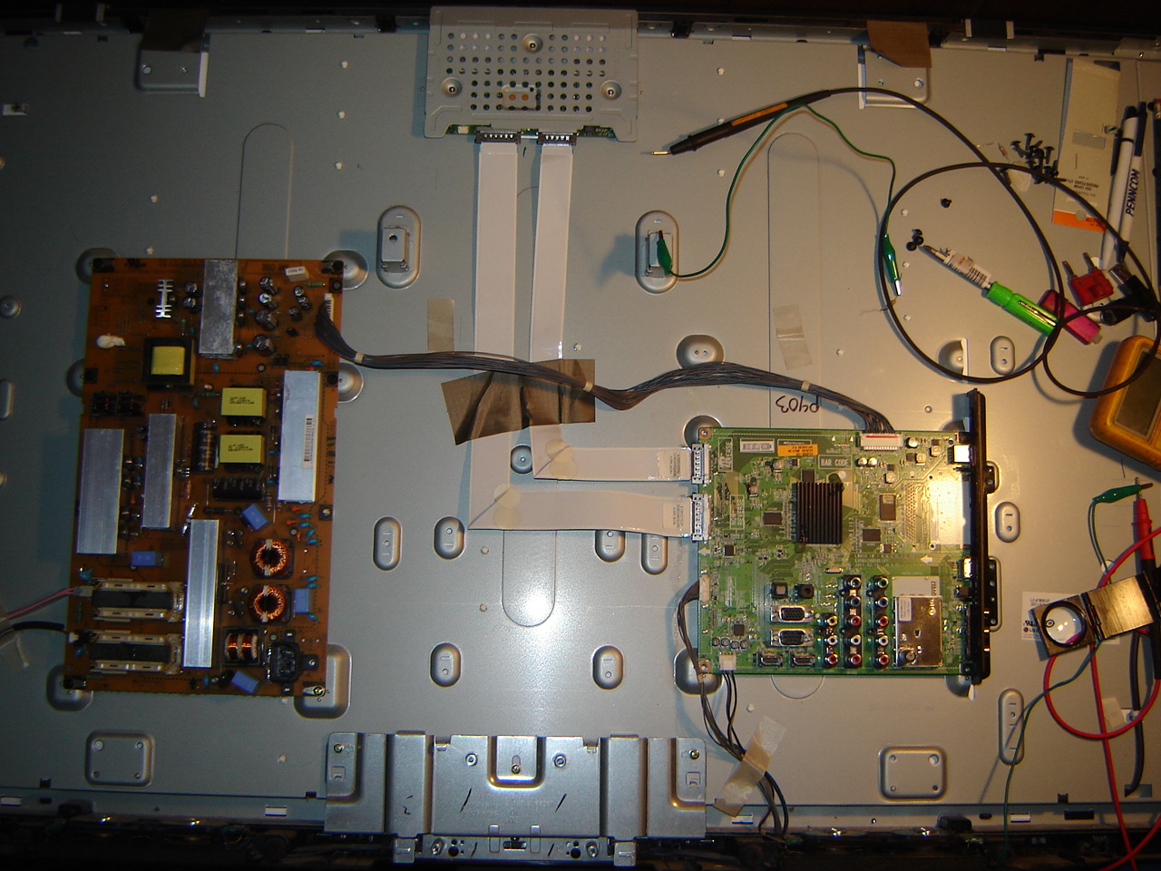

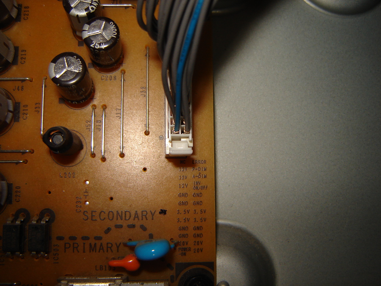

            Re: Lg 47lk520 no start pulsing led
            I think its 3.3 logic but im not 100%
            First photo overall 2nd photo at power supply.
            I guess I could fire up the power supply by itself and read the error volt at the power board.
              Check the resistance between the ERROR pin of the power supply board and the ERROR PIN 24 of the main board to see if it has direct connection. Also check the the resistance of that pin 24 of the main board and GND to see if it shows < 1 Ohms. At this point I am not even sure if the diagram matches your board or not.

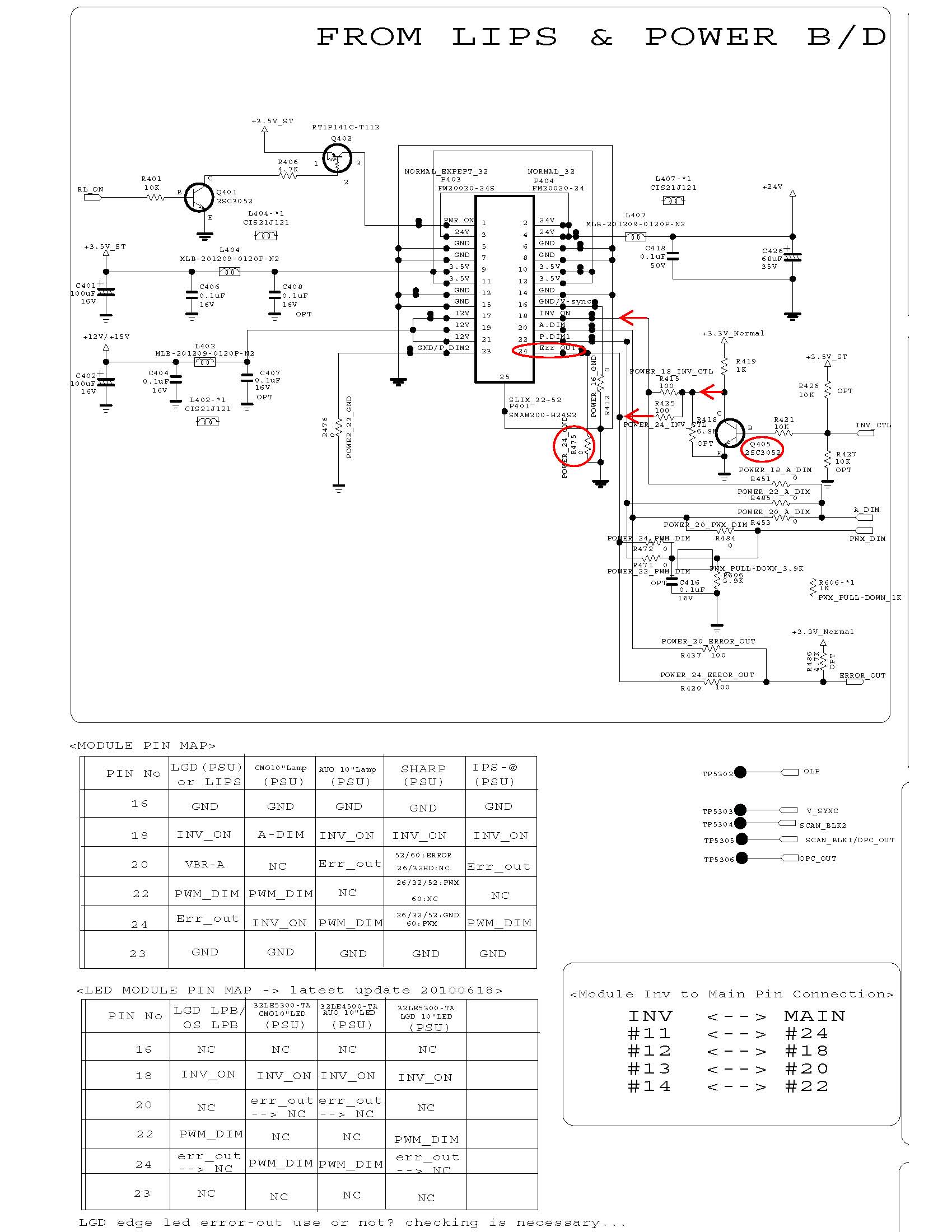

                      OK, if you at this diagram:
                      https://www.badcaps.net/forum/attach...2&d=1433288508
                      You can see the Collector (output) of Q405 has resistor R415 (100 Ohms) to goes to the pin 18 INVERTER_ON (output) for turning on the inverter board, then you can also see resistor R425 (100 Ohms) which is also connected to the Collector of Q405, the other end of this resistor is connected to pin 24 (ERROR pin).
                      Q405 is normally on so the Collector DCV will be < 1VDC, when the power switch is activated then the processor will turn off Q405 which will cause the Collector to go high toward 3.3V (>2V = HI).
                      So check and see if that how those resistors are connected and in place or not.
