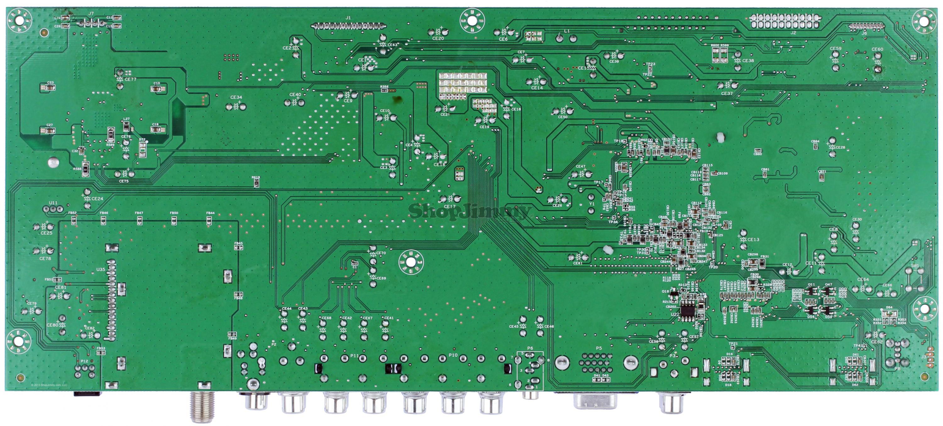

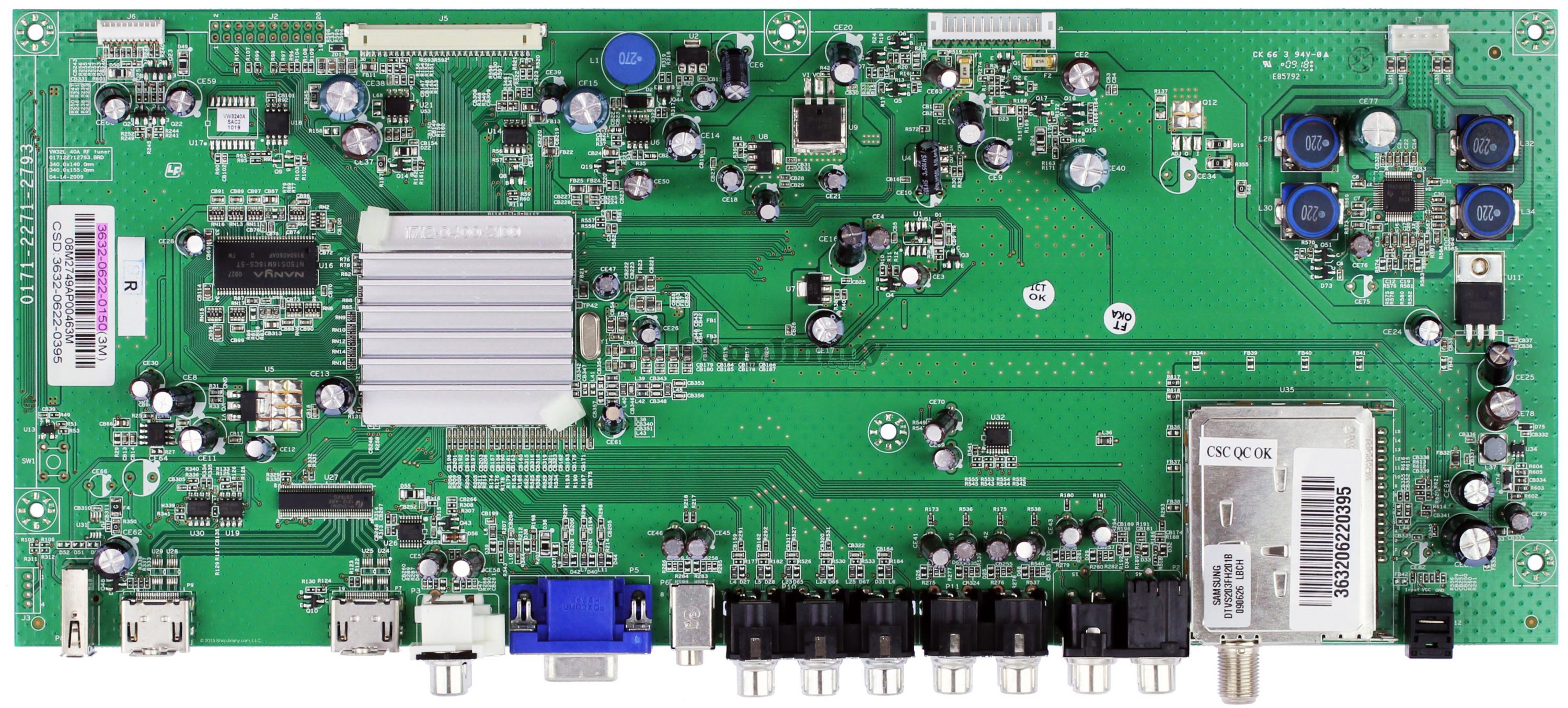

                                Which one of these is your board?
                                http://www.shopjimmy.com/catalogsear...+vw32L+HDTV40A
                                This one?
                                http://www.shopjimmy.com/vizio-3632-...32lhdtv40a.htm
                                That F1 fuse is fed by 5VSTBY. So check the resistance between the lower pin (top pin of the fuse is connected to the connector) of the fuse against the chassis to see if it shows resistance. The shorted circuit can be after the active devices so it may not show up at the fuse terminal.
                                F2 is fed by switched 12VDC.

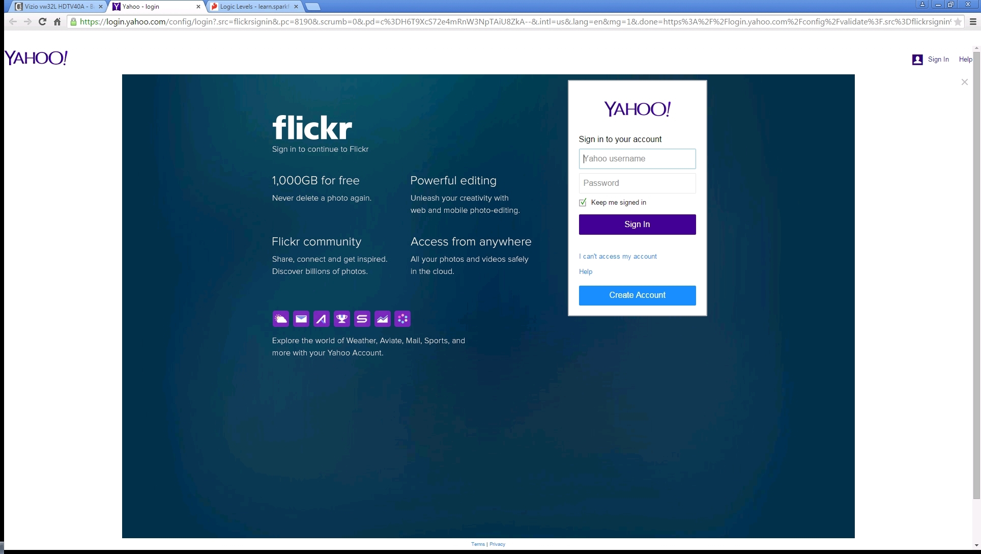

                                  yes but I have given a link that has the photos https://www.flickr.com/cameraroll
                                    Re: Vizio vw32L HDTV40A
                                    That link does not work, it want me to sing into YAHOO account, see the screen shot when I click on your link. I am out.

                                      My board is 3632-0622-0150 Thanks
