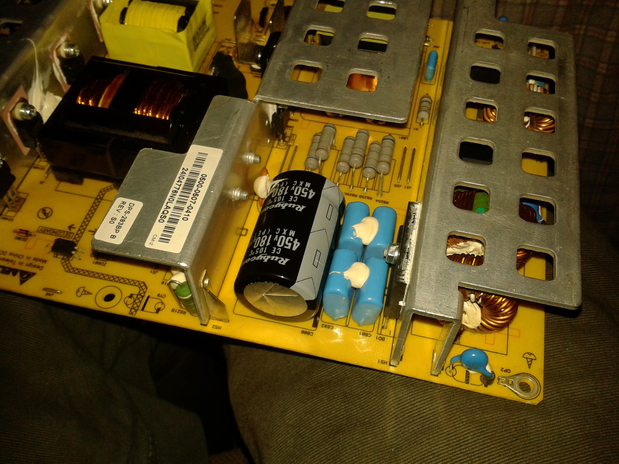

    Part # on the board is DPS-283BP B Rev S0

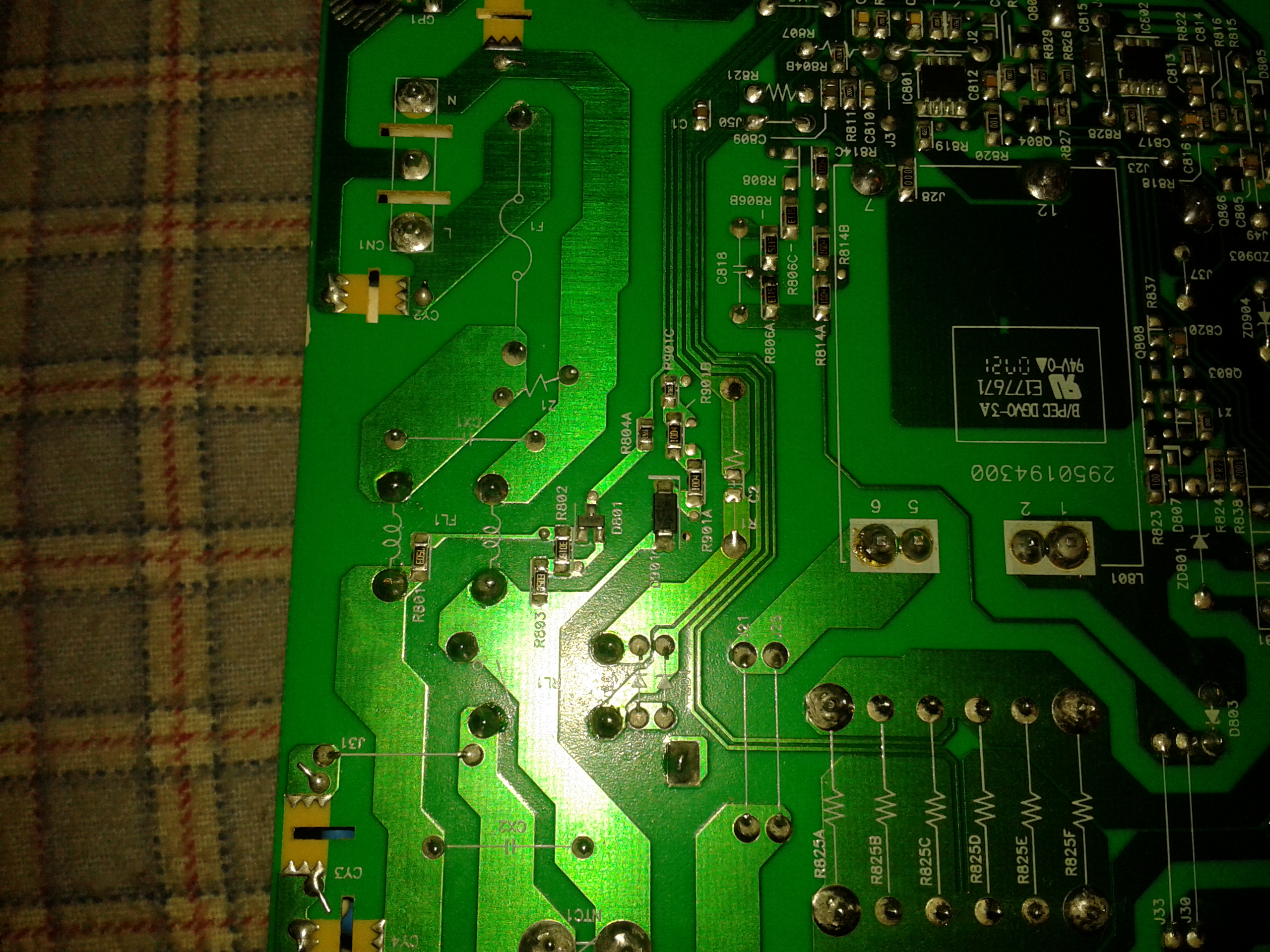

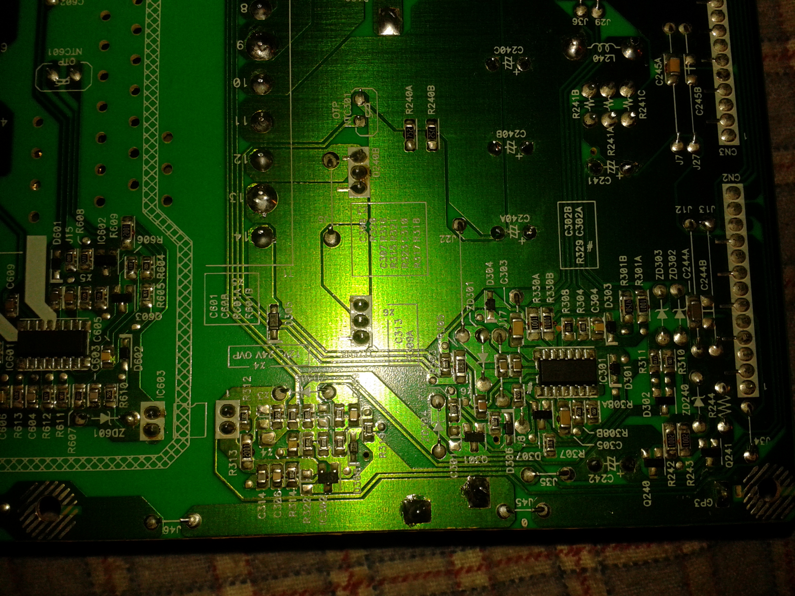

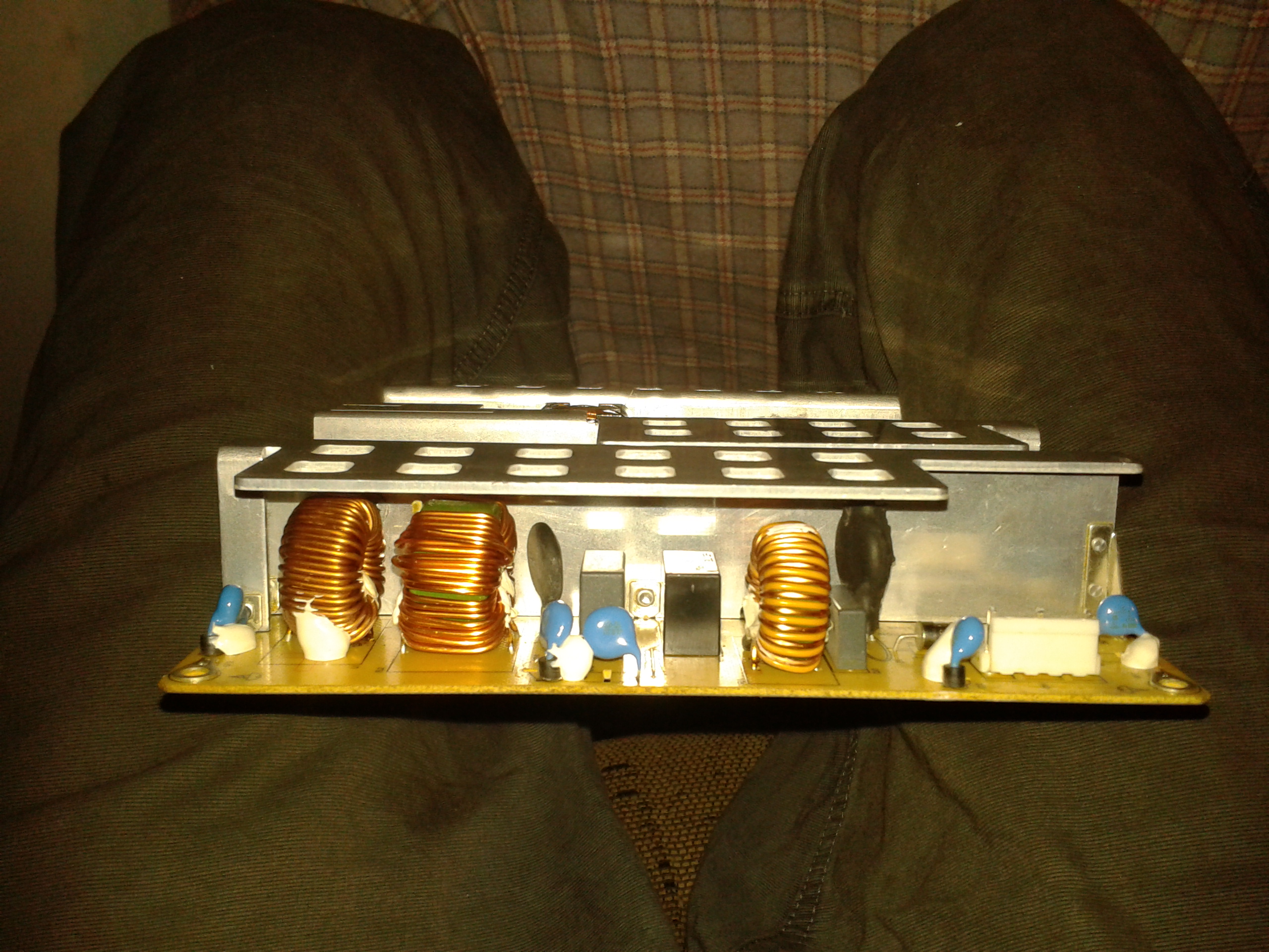

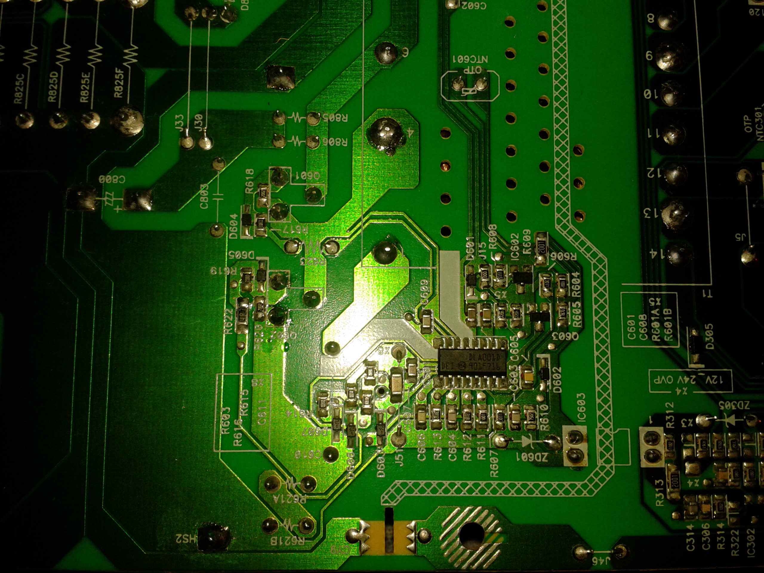

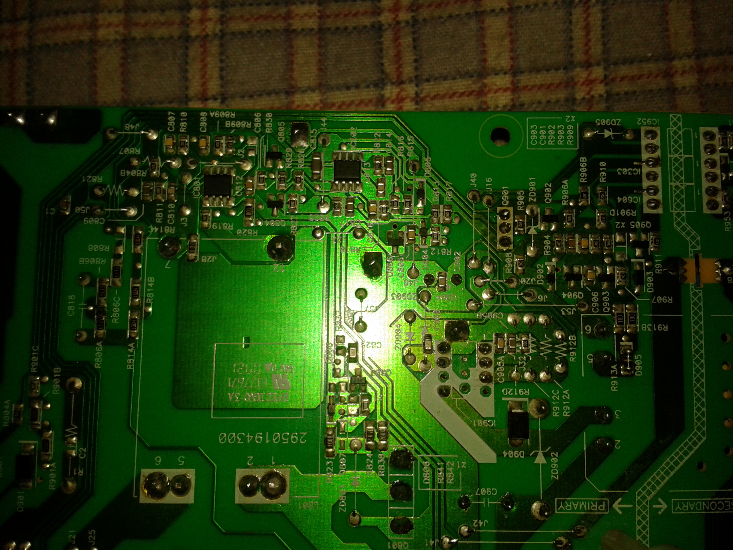

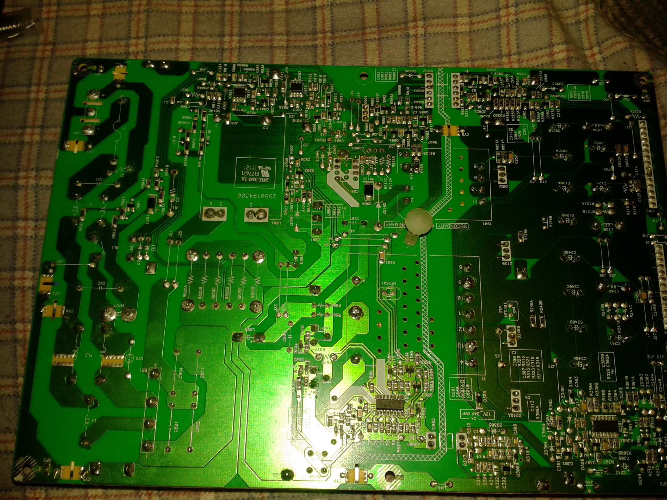

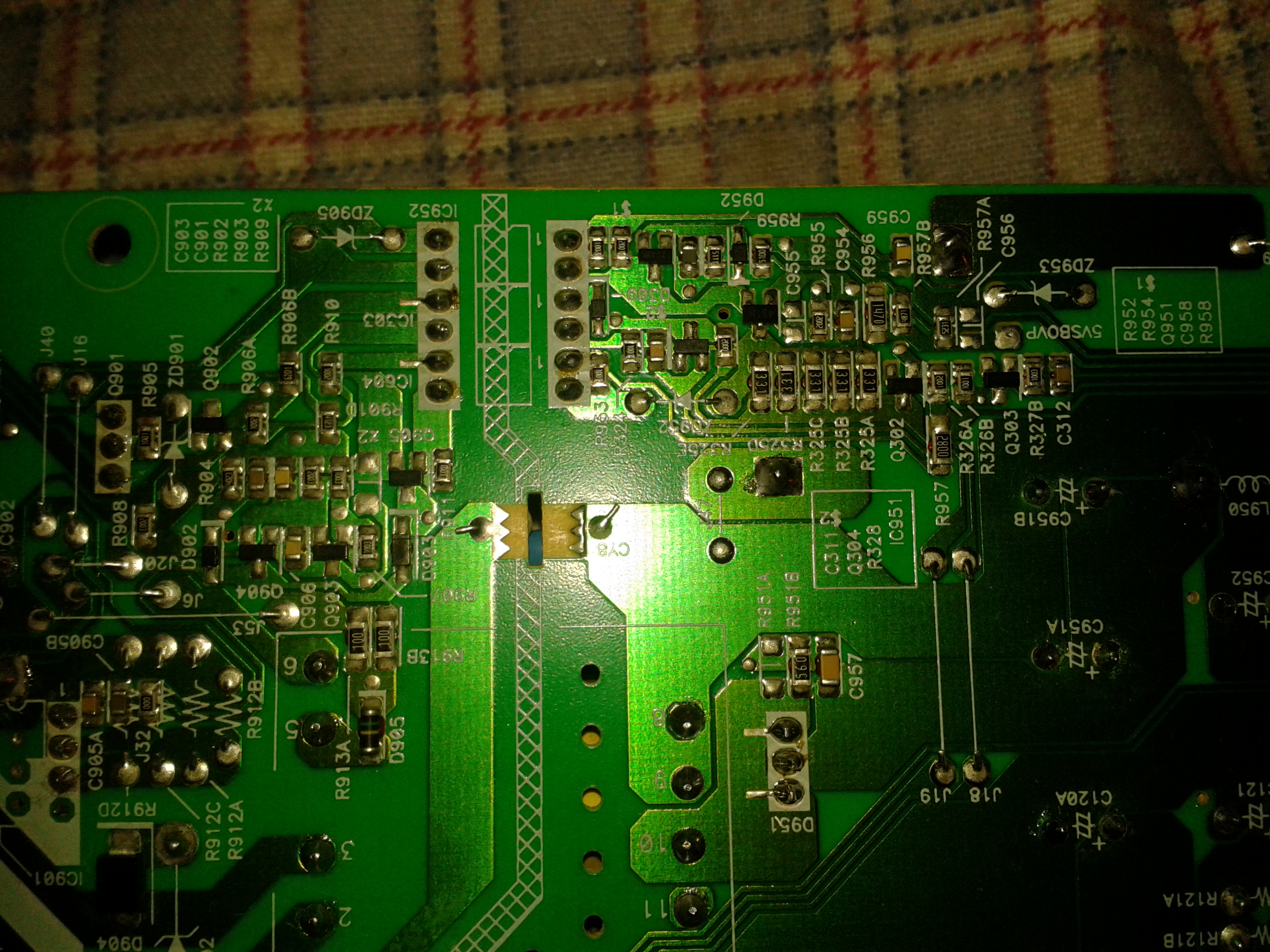

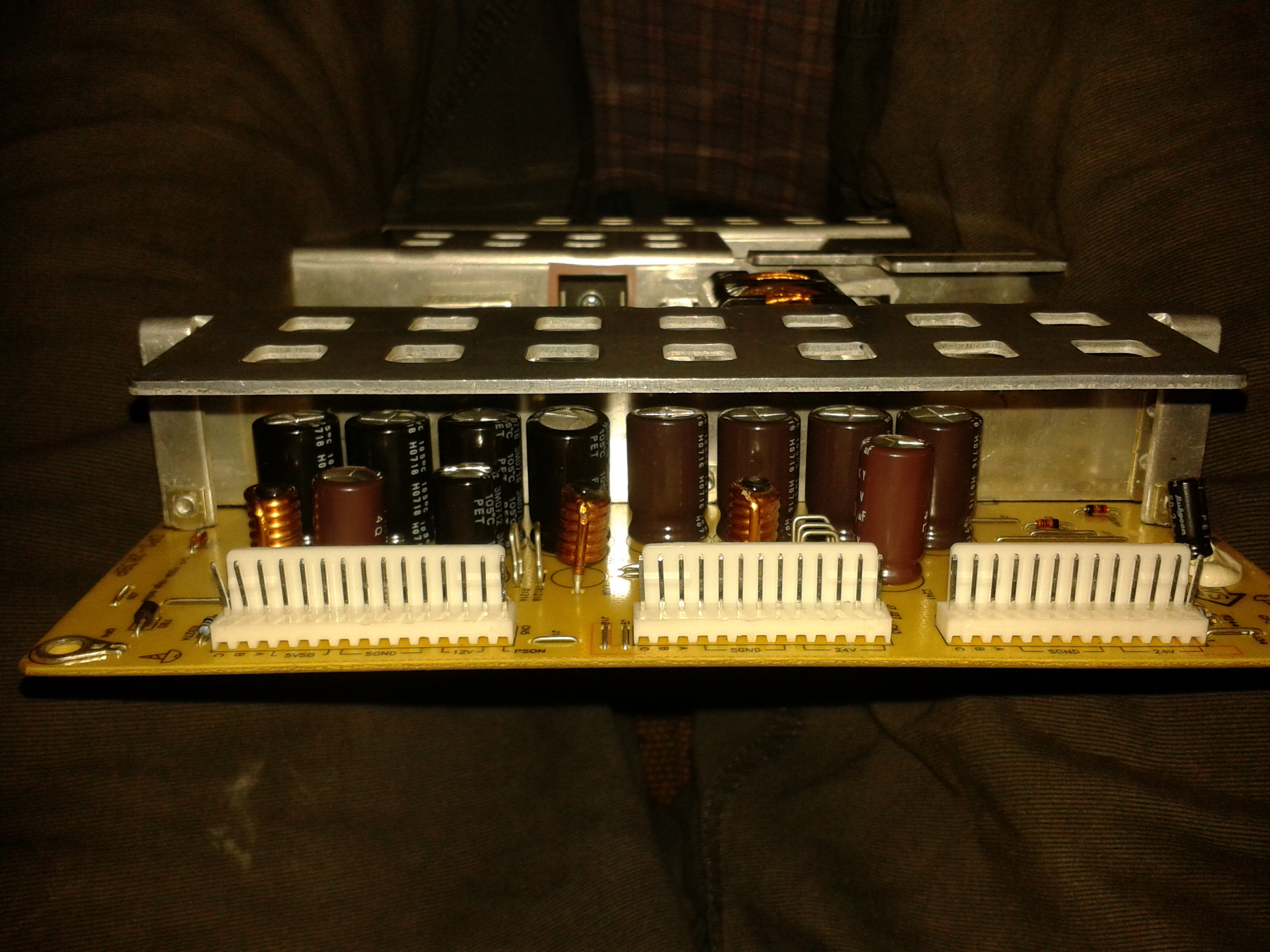

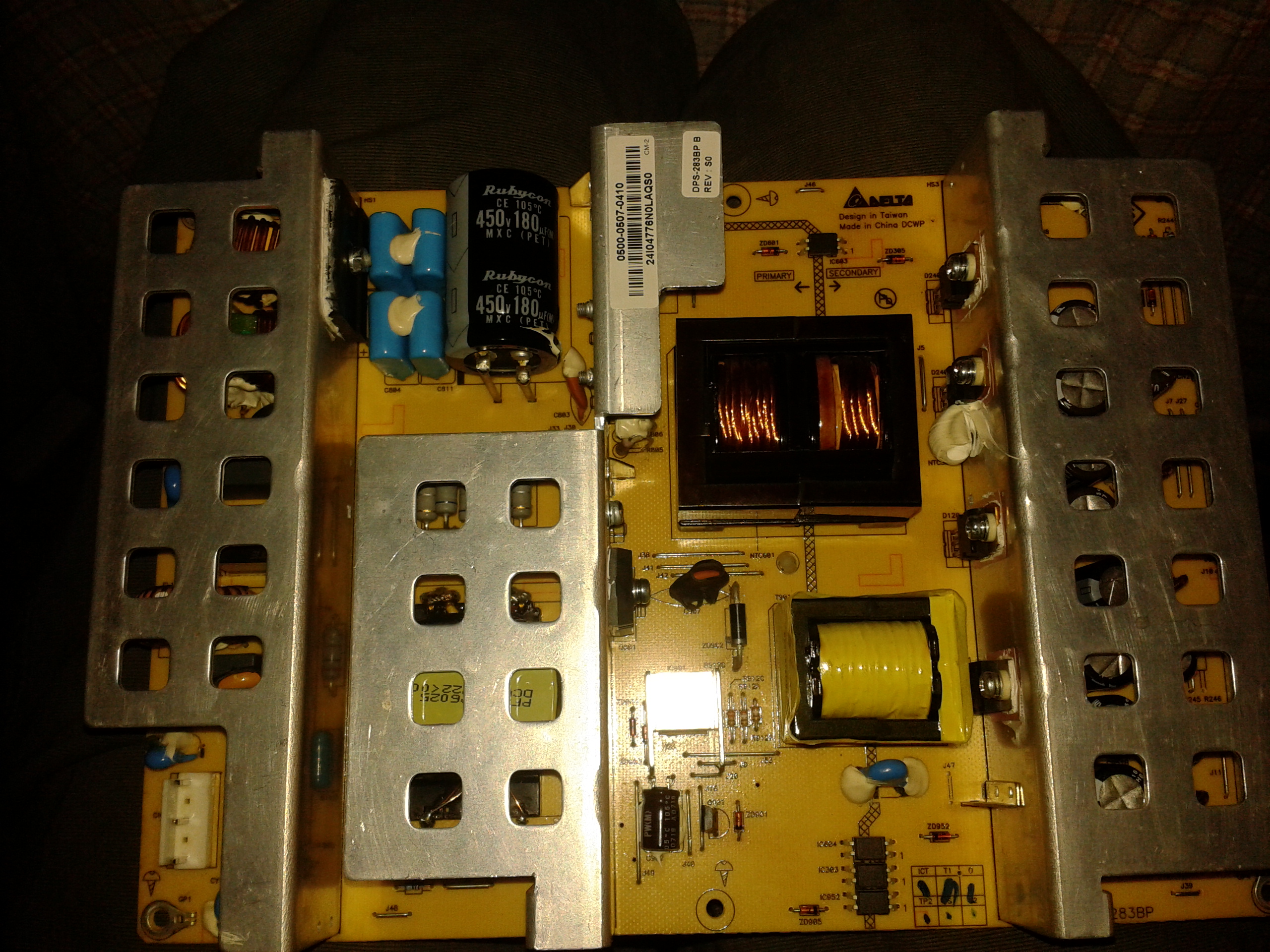

    I got this tv recently and have been doing a bit of troubleshooting, but not much luck. I figured I'd make a post here to confirm my theory and to see if anything jumps out that I don't know about.
    Here are the symptoms:
    -No power, no orange light
    -Power button does nothing
    -5VSB circuit reads 1.2v initially then slowly climbs to 3 volts, all the while fluctuating +/- 0.25v
    -All of the capacitors on the secondary, including the 5v line read at or slightly above their rated capacitance ratings.
    -Tested the diode array, the ones just after the secondary from the transformers, they all read about 600 ohms.
    -Checked the fuse, 0 ohms.
    -I have not checked anything to do with the SMD components
    -Replaced the power mosfets just because I didn't have much to go on
    -When I jump the 5VSB to PS_On, The relay clicks on/off repeatedly. When I jump it with batteries, it stays on but I only read about 0.1v on the 12 and 24 volt lines. I replaced the relay just because.
    I re-soldered everything attached to the heat sinks, the transformers, and the inductors. I did re-solder some SMD components that looked pretty goobered.
    -There is no physical damage to the board that I can tell, pics included.
    My theory is that the 5VSB line is not working properly, and something along the 5VSB circuit has a bad connection, but I can't for the life of me find it.
    Also if anyone can find me a circuit diagram or manual on this thing that would be awesome.
    Re: Vizio vx42l hdtv10a Bad 5VSB Circuit
    Did you check startup/running cap C902 in the primary side next to the stby SMPS IC with small heatsink on top?
      Yes sir I did, it was good according to my capacitance meter. I think tomorrow I am going to pull all of the heat sinks back off and check the resistors / diodes.
      I should probably mention that all of this testing has been done off the TV with nothing else connected to the power supply. I noticed when I connected it to the mainboard the 5v line dropped down to 1 volt.
      I might also replace all of the electrolytics just because, would there be any reason to think they are bad? I honestly sounds like a capacitor problem to me but they all check out.
