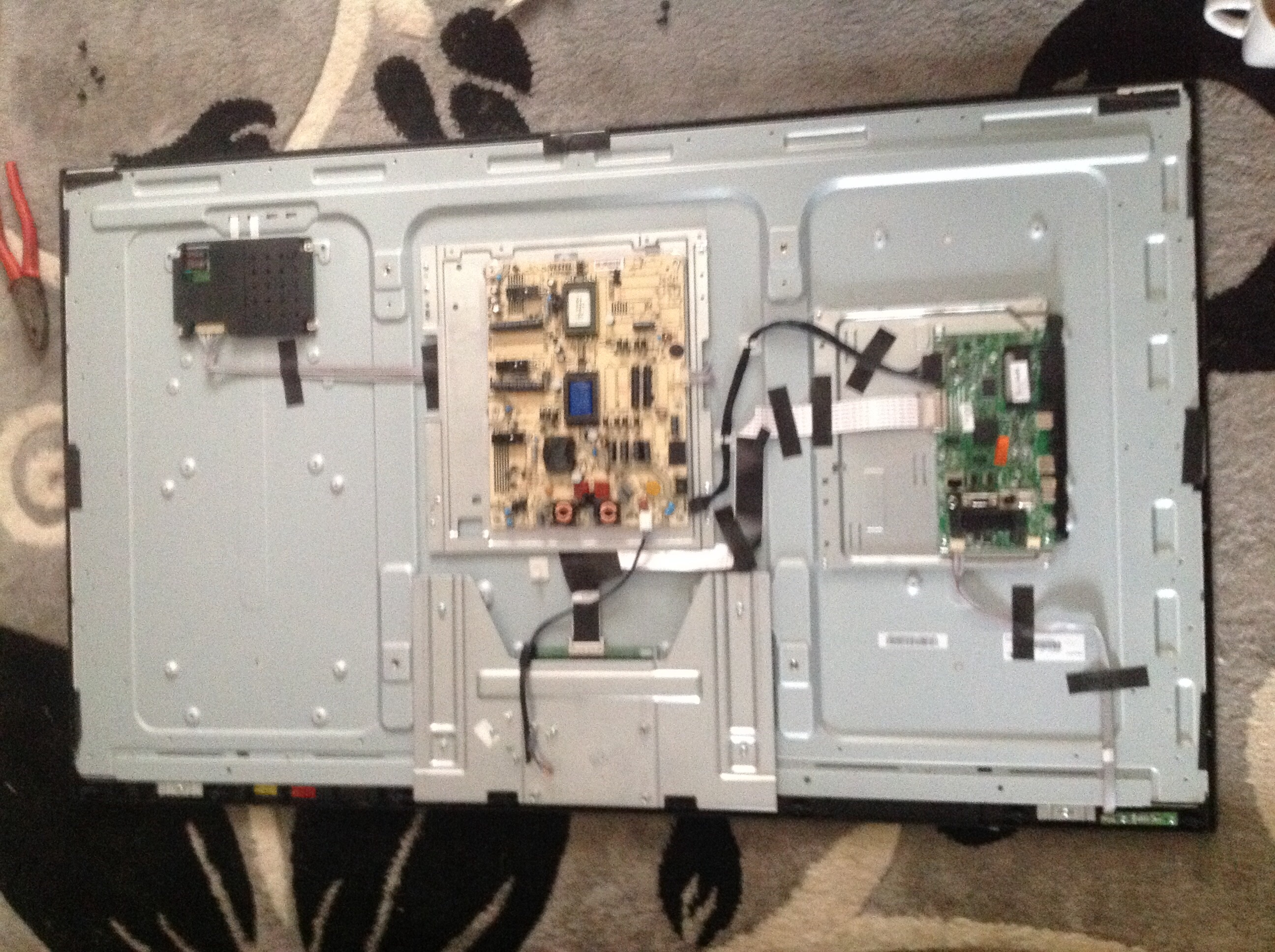

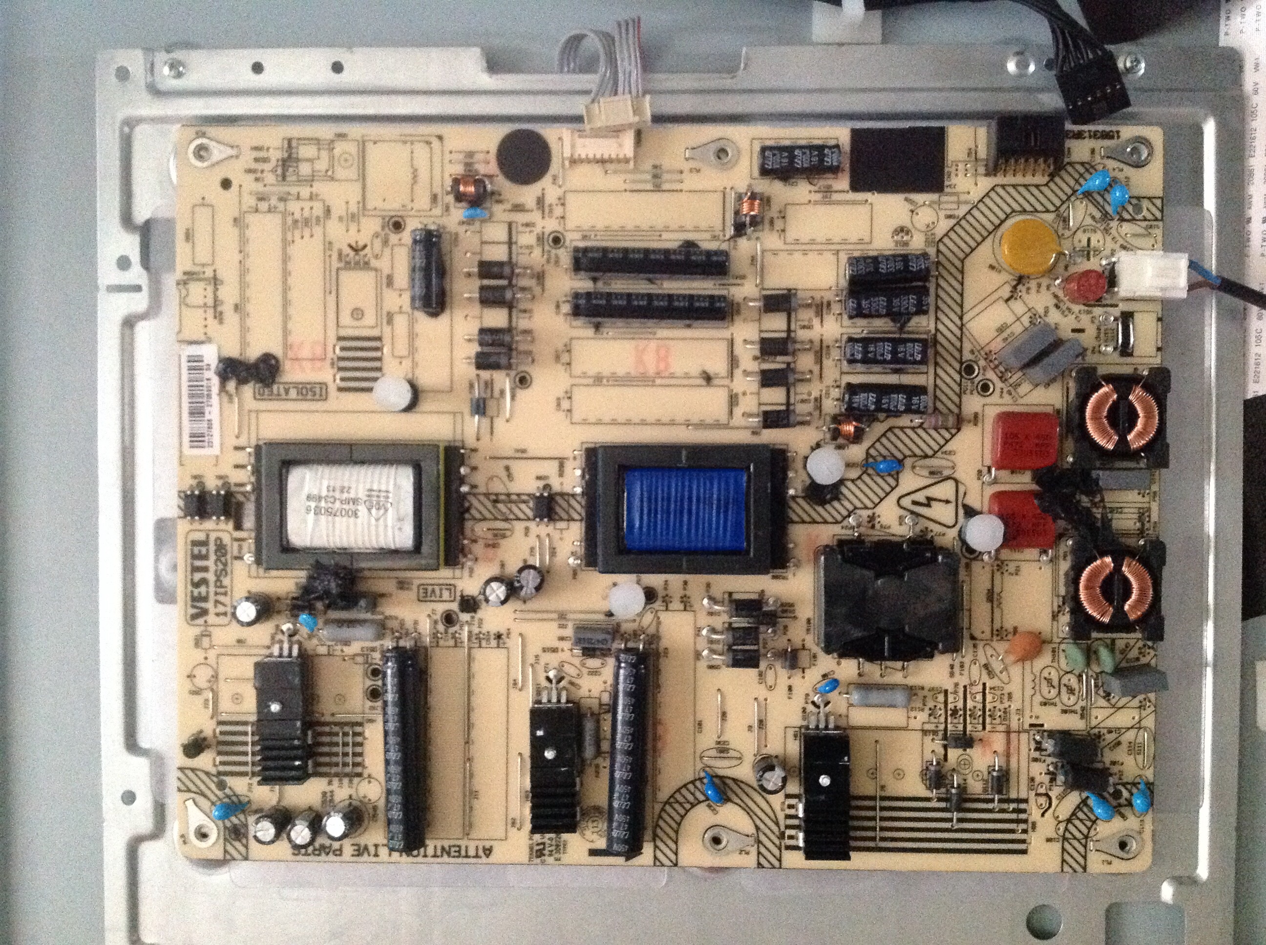

    I've got a Luxor tv model lux0150001b/01 tv turns on for about 3 mins then seems to go off with a few flashing standby lights then turns on and repeats the same cycle over and over the power board inside is a vessel 17ips20p can anyone help? Thanks in advance john

          Some pics

                Anyone any ideas where to start

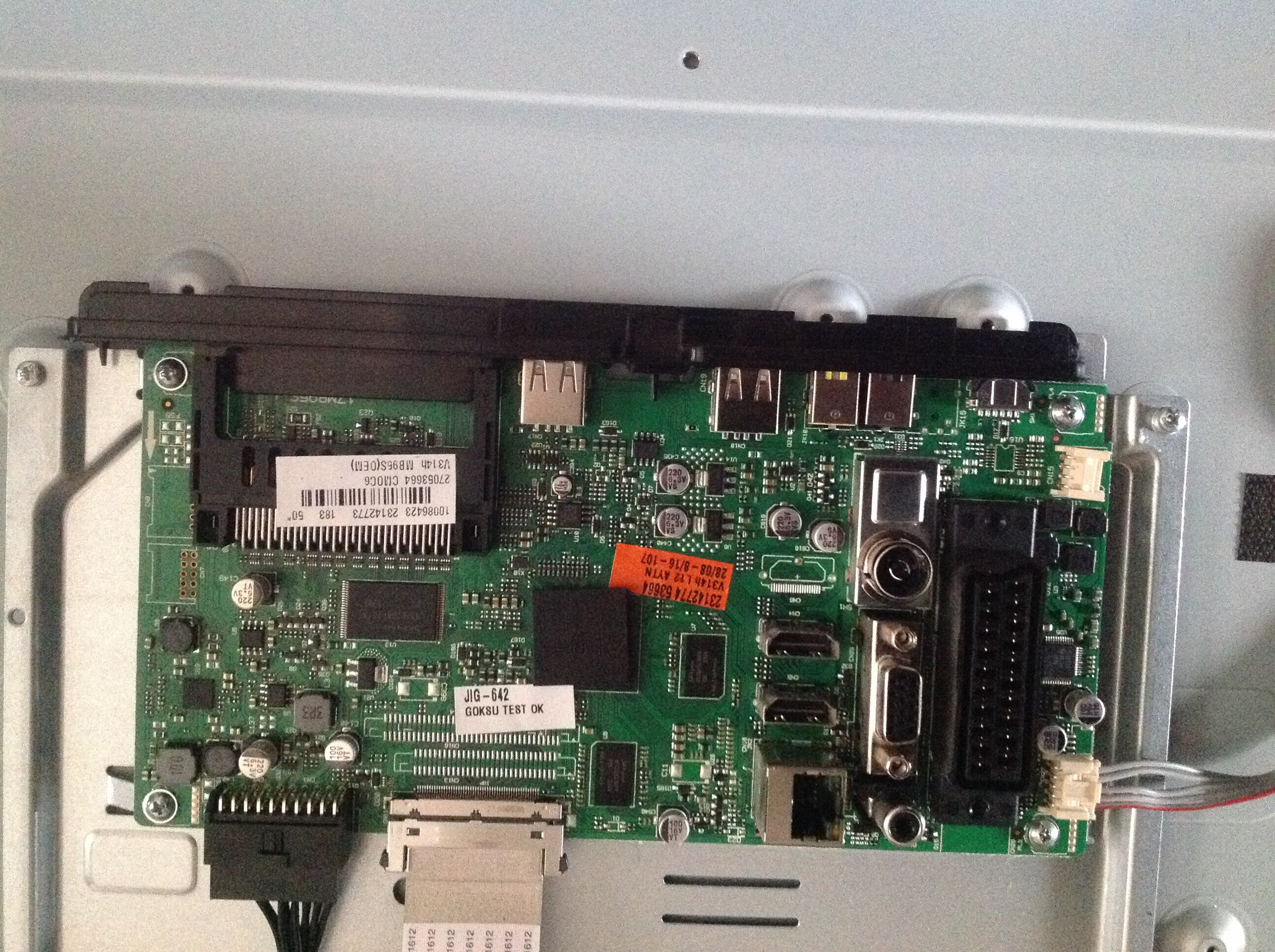

                  Also the remote doesnt repond or the buttons on tv dont work could it be software related as tv is only 14 months old

                    Highly possible it is a software fault-time it to the second for the time it stays on-before going off.if the timing,to the second,repeats itself,then I would suggest the flash ic is corrupt,and,if available ,then update the software via usb pen drive-if you can find the software.
                    I have spent around 6 hours finding the bin. file for a 17mb65s-3,also vestel.got there in the end,no thanks to vestel,who are unhelpful.they just want to sell their wares,with no interest on any other issues/problems.
                    goog luck!
