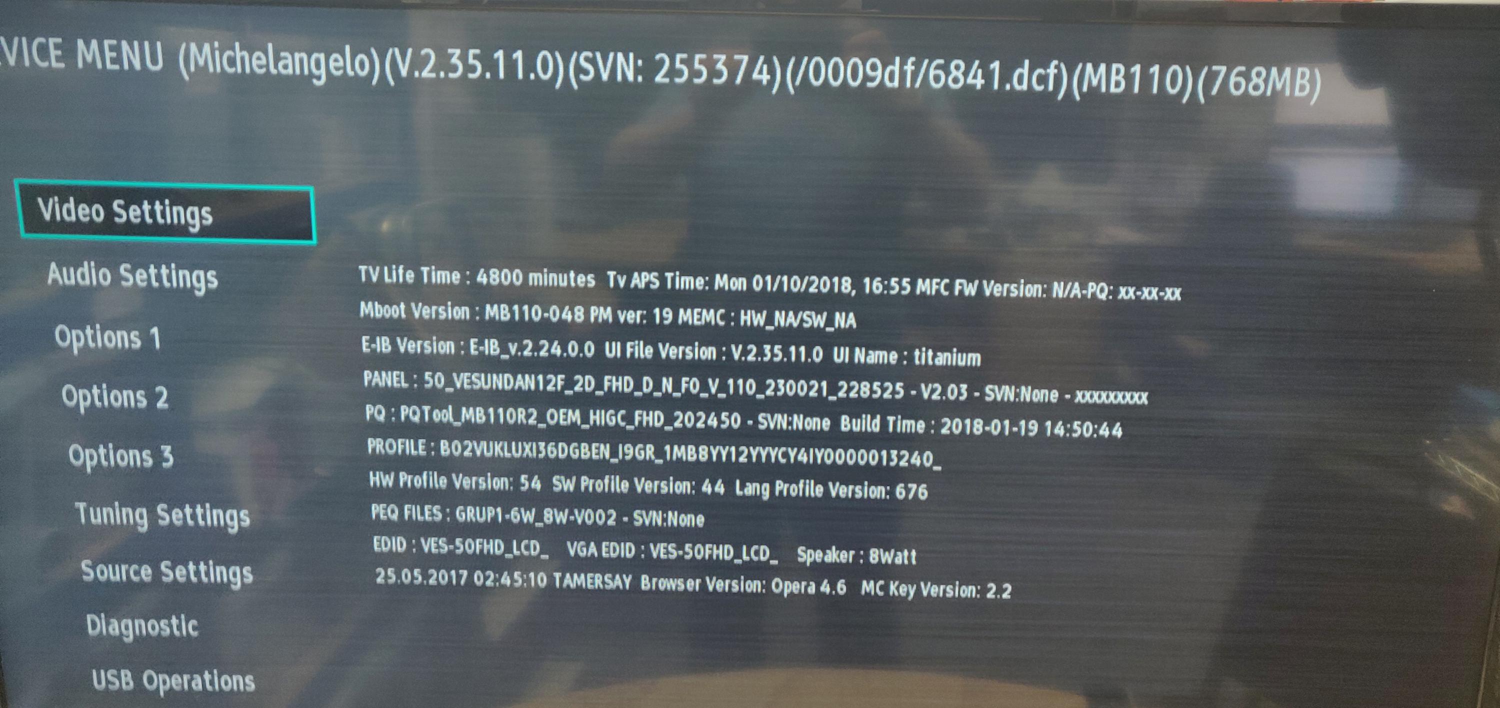

    I have attached the engineers info from the hidden menu if that helps.

      What is the result when you run the Diagnostic
      • loadedboyuk
        • Feb 2014
        • 26
        • uk
        Re: Vestel / Luxor TV 50 inch UK Not reseting
        ALL SAYS OK
        apart from DDR Settings that says NOK
        I should also say, when I do a reset from either menu (service or retune) the TV looks like it will reset then goes to standby mode

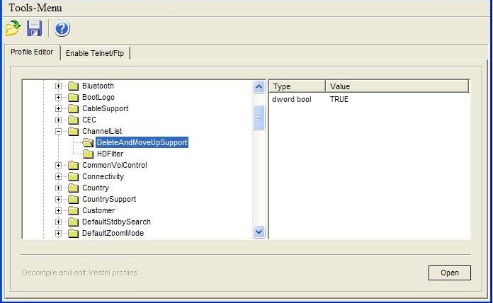

                    its firmware issue.. since its Vestel mb110 you can use the service menu USB Operation to download all profile and write back or change what ever you want.
                    how to:
                    on PC format USB drive fat32 and great file in name DownloadProfile.mb110 ( the extention should be as it written .mb110 )
                    inset usb at the Tv and turn on go to service menu and press USB Operation ..
                    all file you will got on the usb drive... u can zip them and upload over here to modified them to you..if you like..
                    also . downgrade the firmware will be a good idea

                        yours SW Profile all Normal. only you have Hotelmode was wrong encounter menu
                        delete all the file you download before.. just keep the file you generate with extension .mb110 and make folder on the usb with name ( profile ) and put the file attached after unzip inside profile folder and do the same way as you downloaded the files via service menu usb operation

                            downgrade the TV firmware.. or write a core firmware.. this is Turkey language page they have core recovery firmware for MB110 register required or any turkey member over here can help you by downloading.
                            tools to read and modified Language / SW / HW profile of Vestel Main boards , and other one stand alone only for edit SW Profile attached too to any one need.

                                      this what i found at your SW_profile.bin was wrong at hotel mode menu.. it counter 0x000005 i changed it to 0x000000.
                                      you can try edid the sw_profile with first attachment i put here.. under config find hotelmode.. and change it from TRUE to False and write it back to the TV... before you start to scann make hard reset
