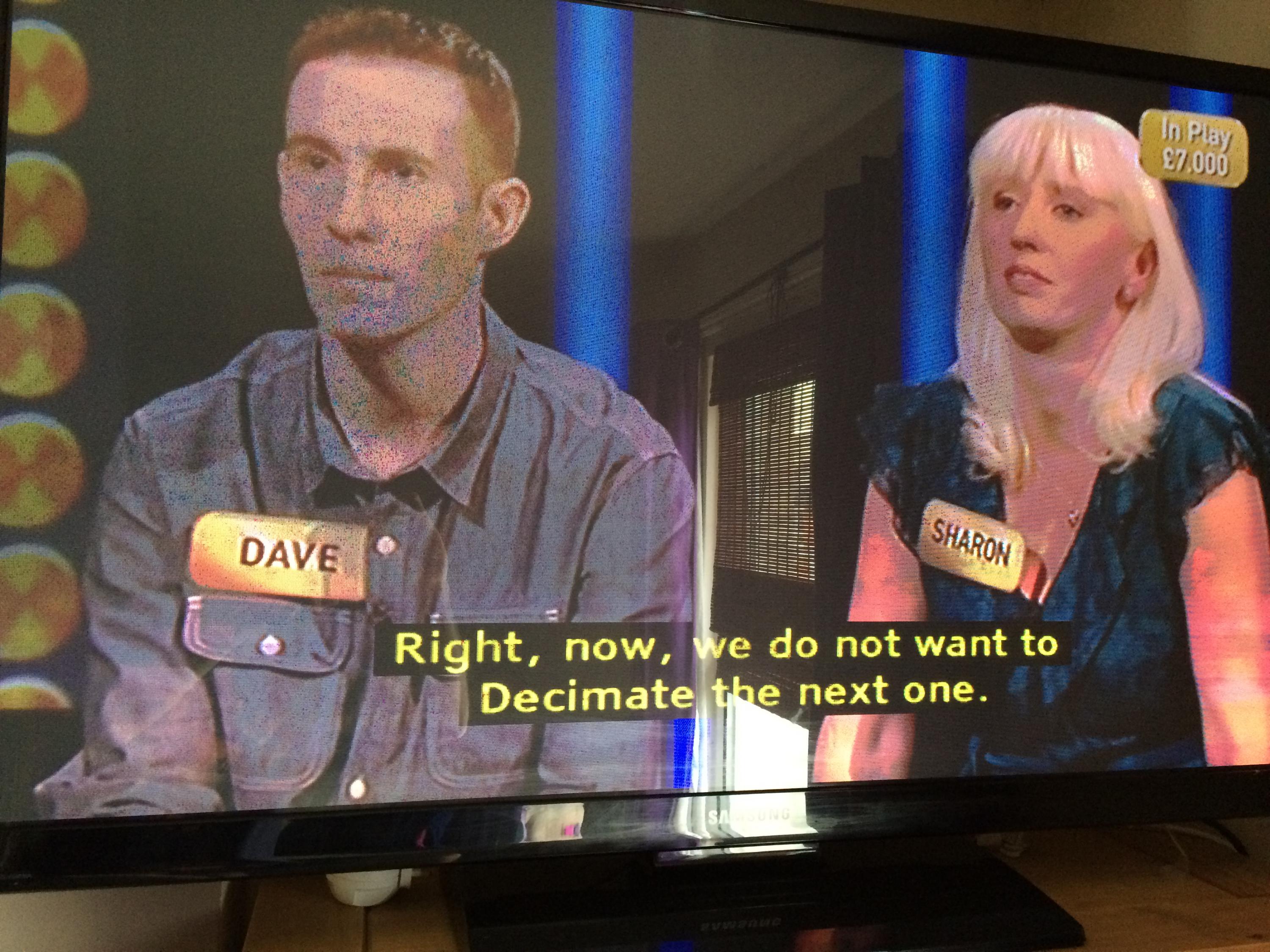

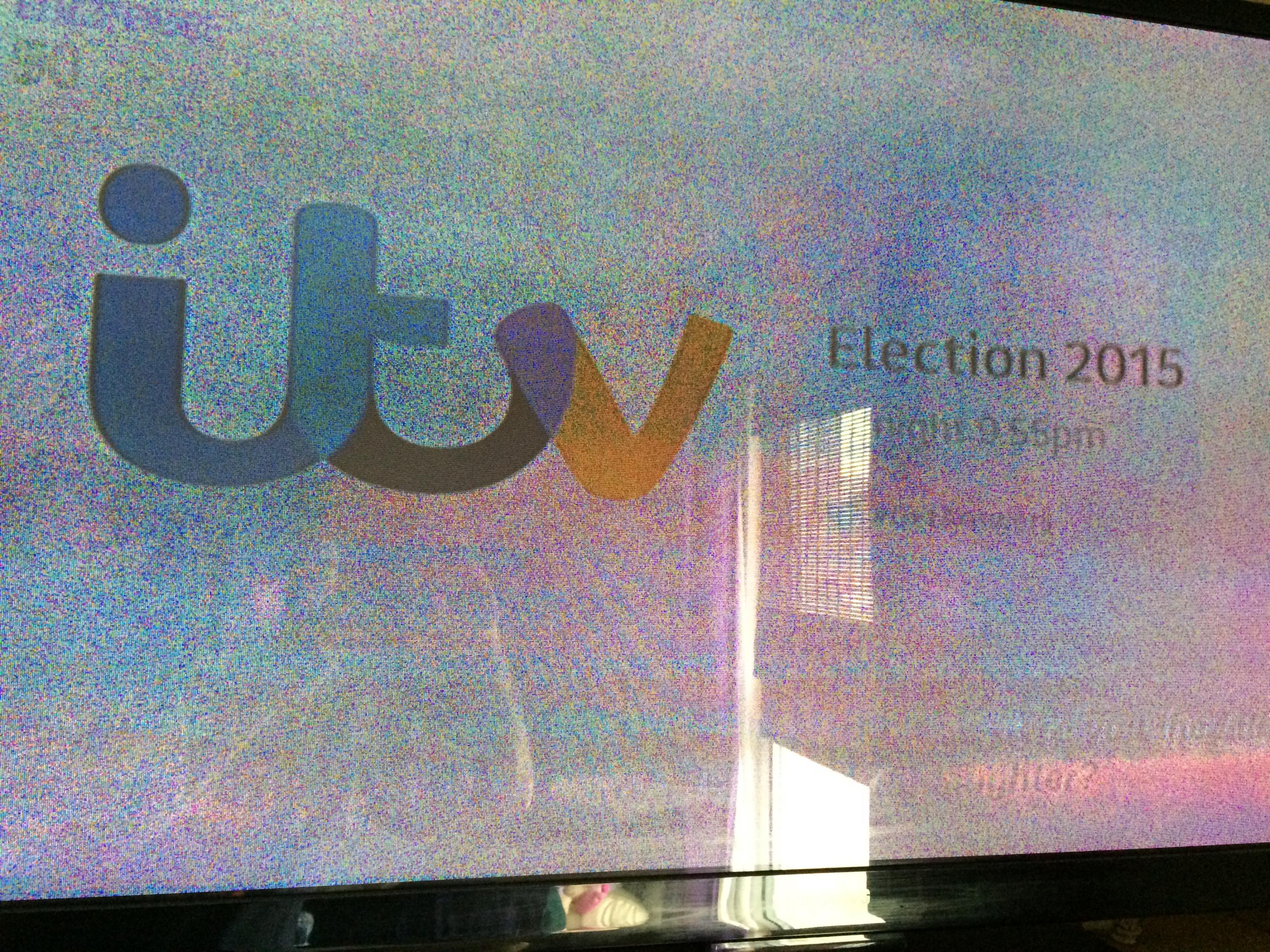

    Hi Guys,
    I got a problem with weird picture, tv just out of warranty. It looks like fuzzy snow and you can see previous static images from lets say tv menu when looking at whites area, it looks like it is keep holding in the background, but the main issue is that there are dots everywhere and image is distorted.
    Now, I checked VS and VA on power supply and they are perfect 201 and 58, VScan on Y board is also perfect stable 180.
    Any ideas what could be? Shall I replace y and x board now both ?
    Re: Samsung PS51e450 strange picture problem
    Is Ve OK? Can be problem with X- or Y-main initialisation ramps, have you got a scope?
      Nope I don't. Do not know actually what value VE should be, where can I find this, no info on sticker...
      Sorry I am a beginner in fixing plasma's, so thanks for your patience This VE is on YSUS board right?
        Ve is used by X-main but may be generated by either board.
        Approx range 80-120V.
          If not in range shall I just replace both boards? Would it be easiest way?
            Do you have an oscope to check?
            • ellah
              • May 2015
              • 9
              • Poland
              sorry, no.
                Then I guess you will have to try both boards.
                • ellah
                  • May 2015
                  • 9
                  • Poland
                  thanks then, I will try and let know
