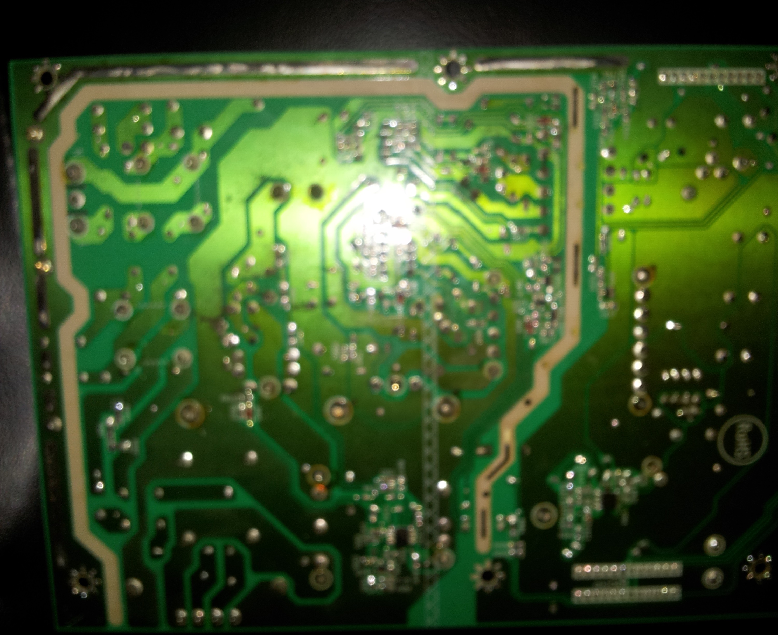

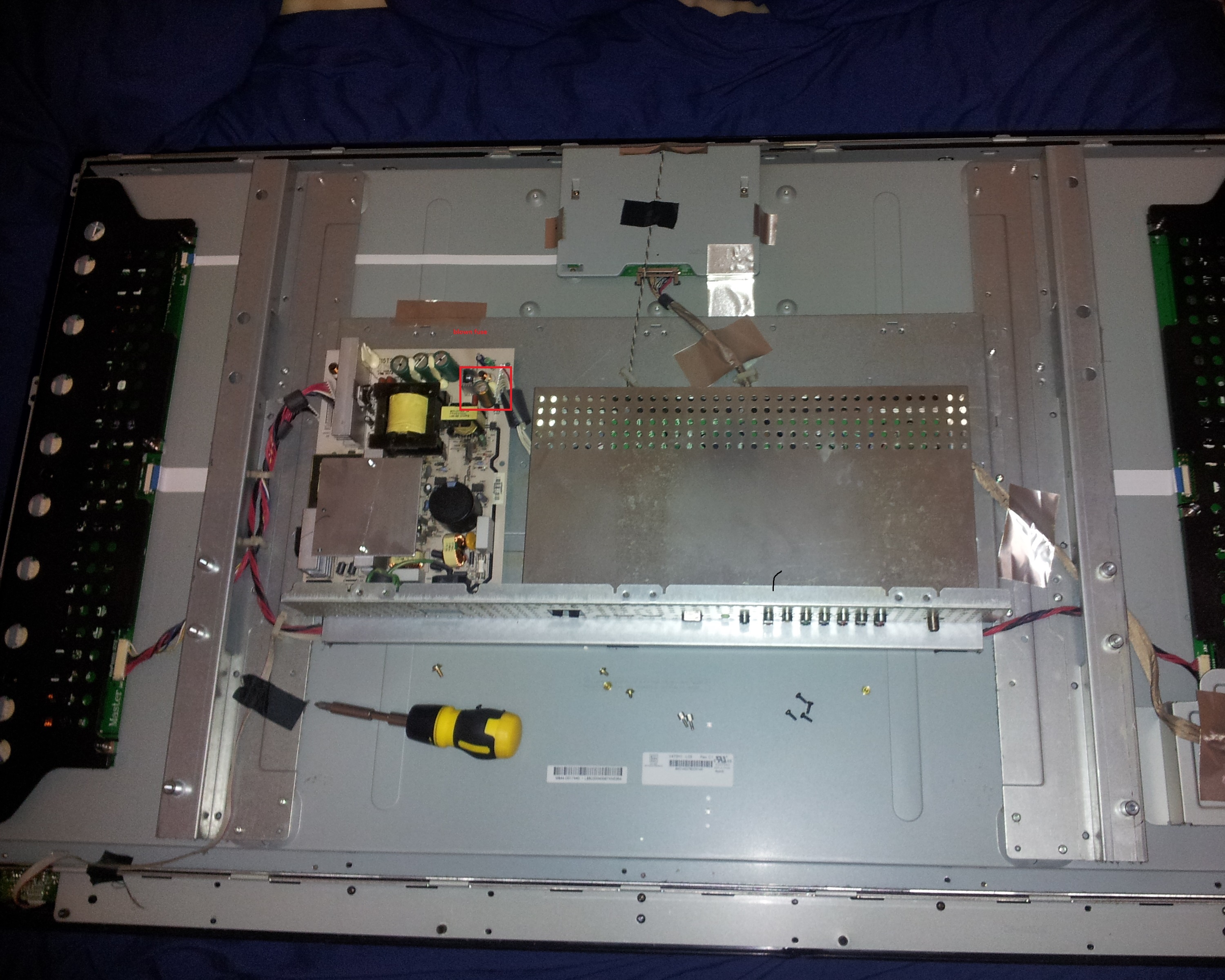

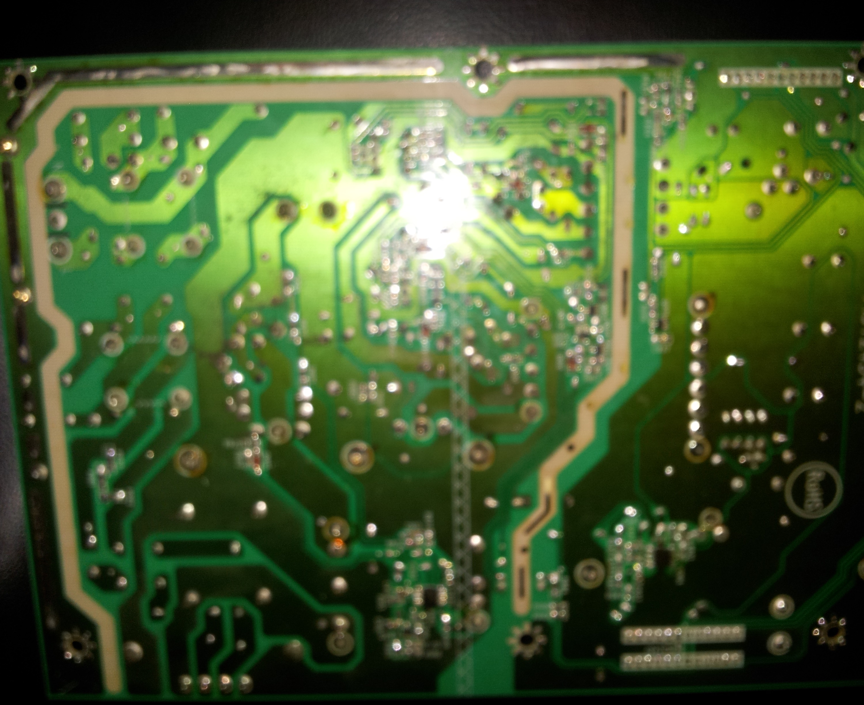

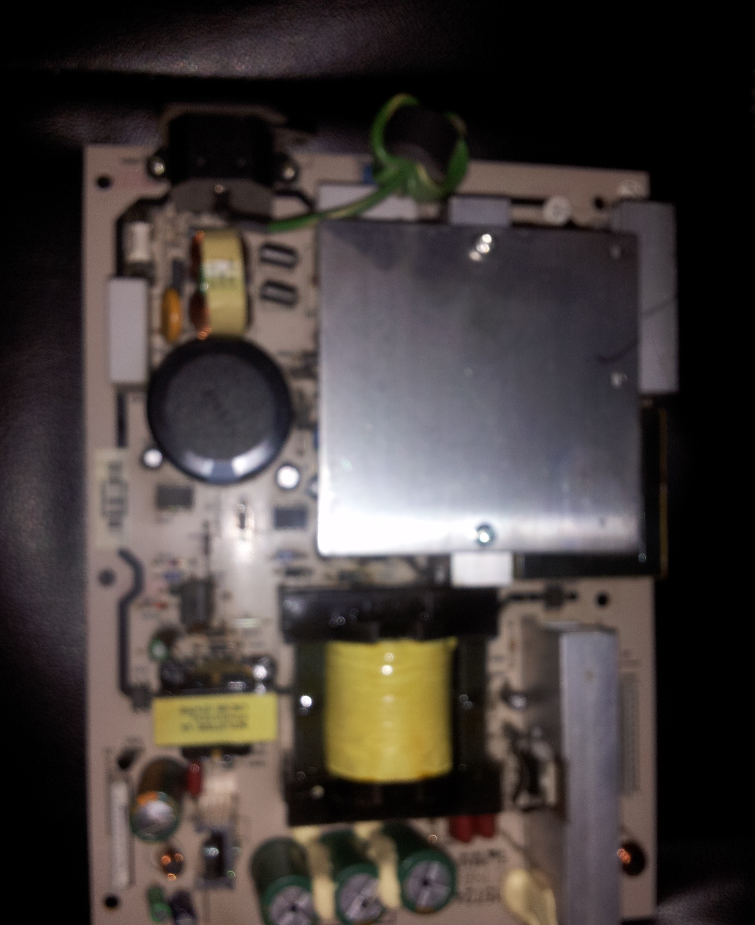

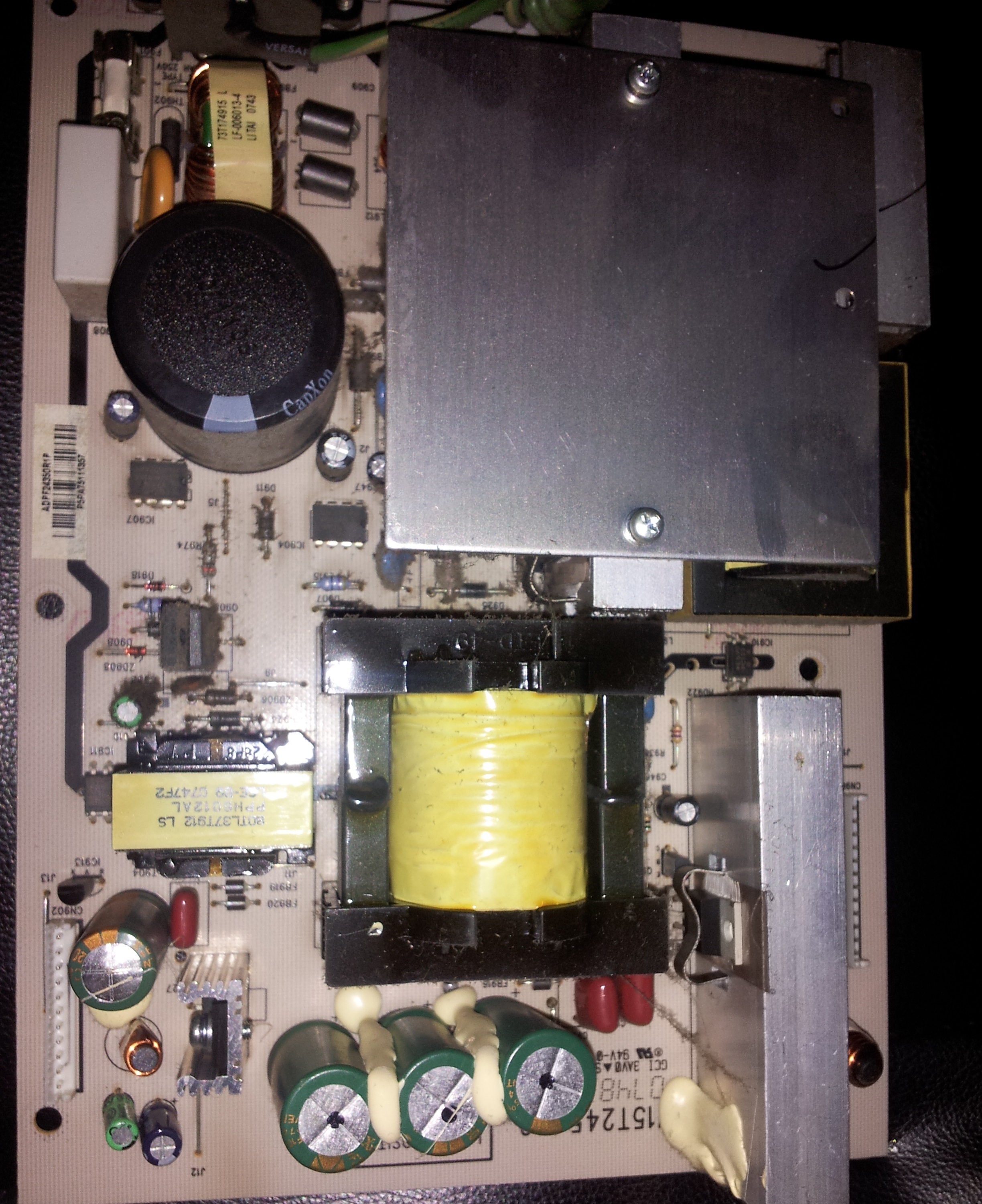

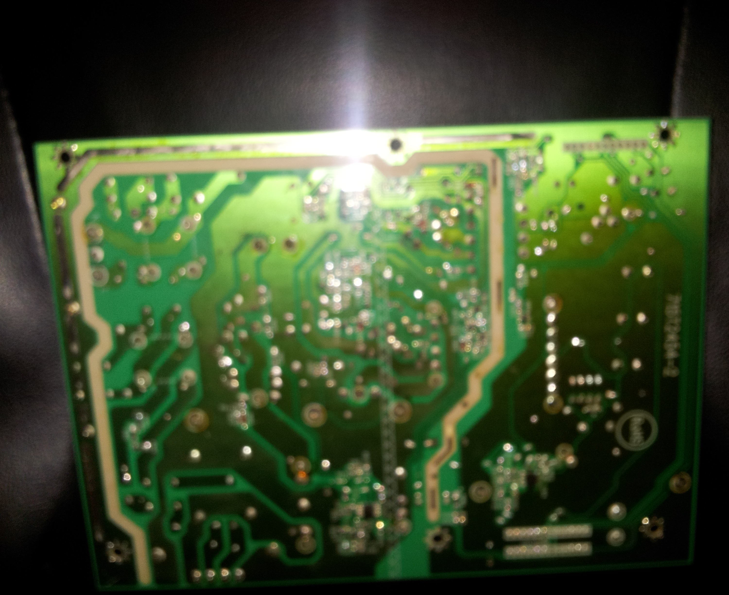

    Opened it up and the PSU has one bulging capacitor.
    Read up on previous posts on the forums that diodes seem to be the majority of the problem of the make and model of this tv.
    The TV is:
    Magnavox Model #:47MF437B/37 serial #:BZ5A0751360493
    I've also attached some pictures for better idea.
    I apologize that they are poor quality as my phone is not really all that great.
    Thank you for both the help now and previously.

      Well since the cap is obviously bad change that first, but yes shorted ZD902, ZD904, D925 diodes are common. Although without a multimeter you will be at the mercy of a spray and pray approach. I see a multimeter in your future....

            Thank you for the assistance, replaced the capacitor leaking the electrolytic fluid and changing I think 925 diode solved the problem just fine.
