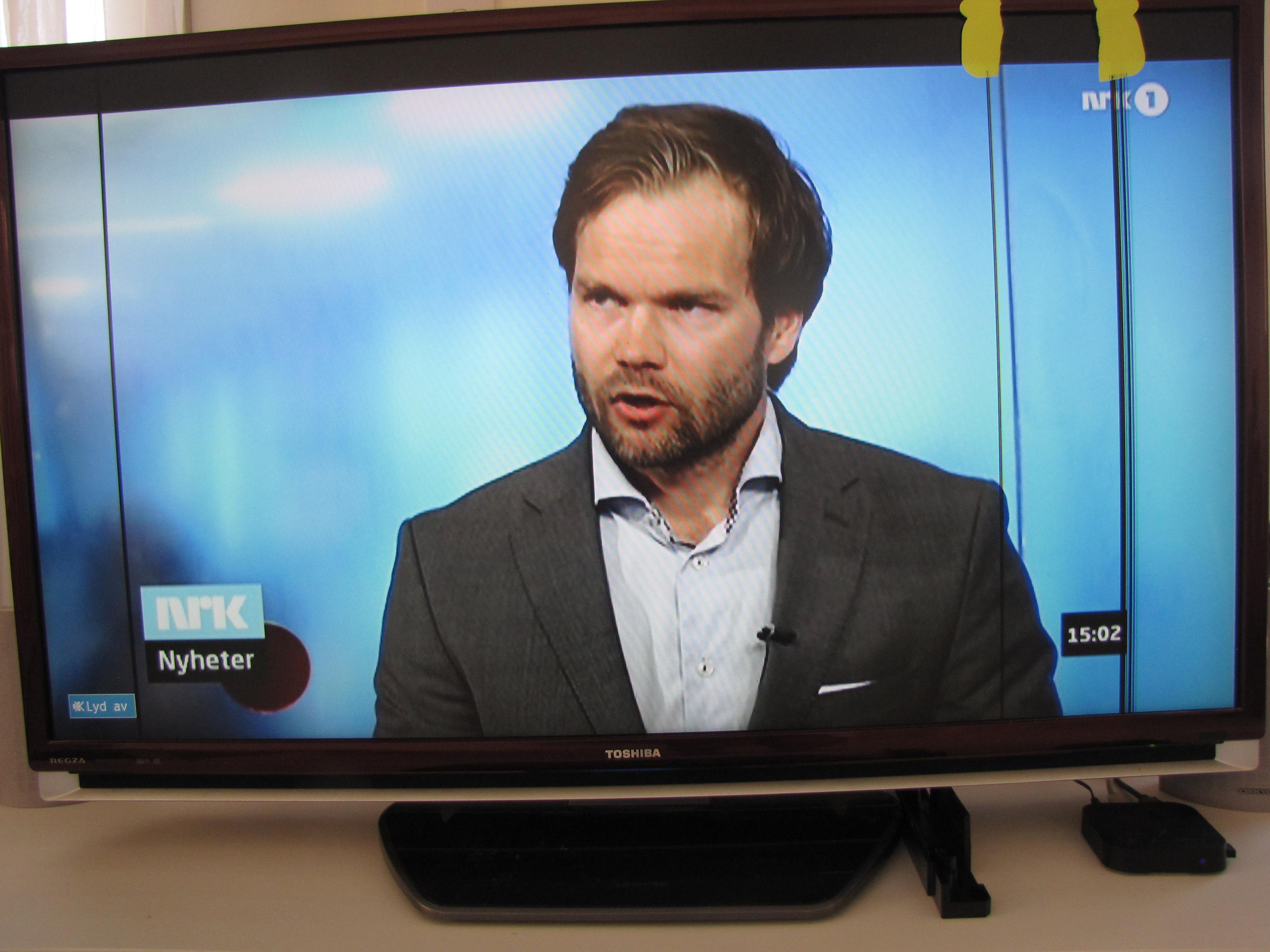

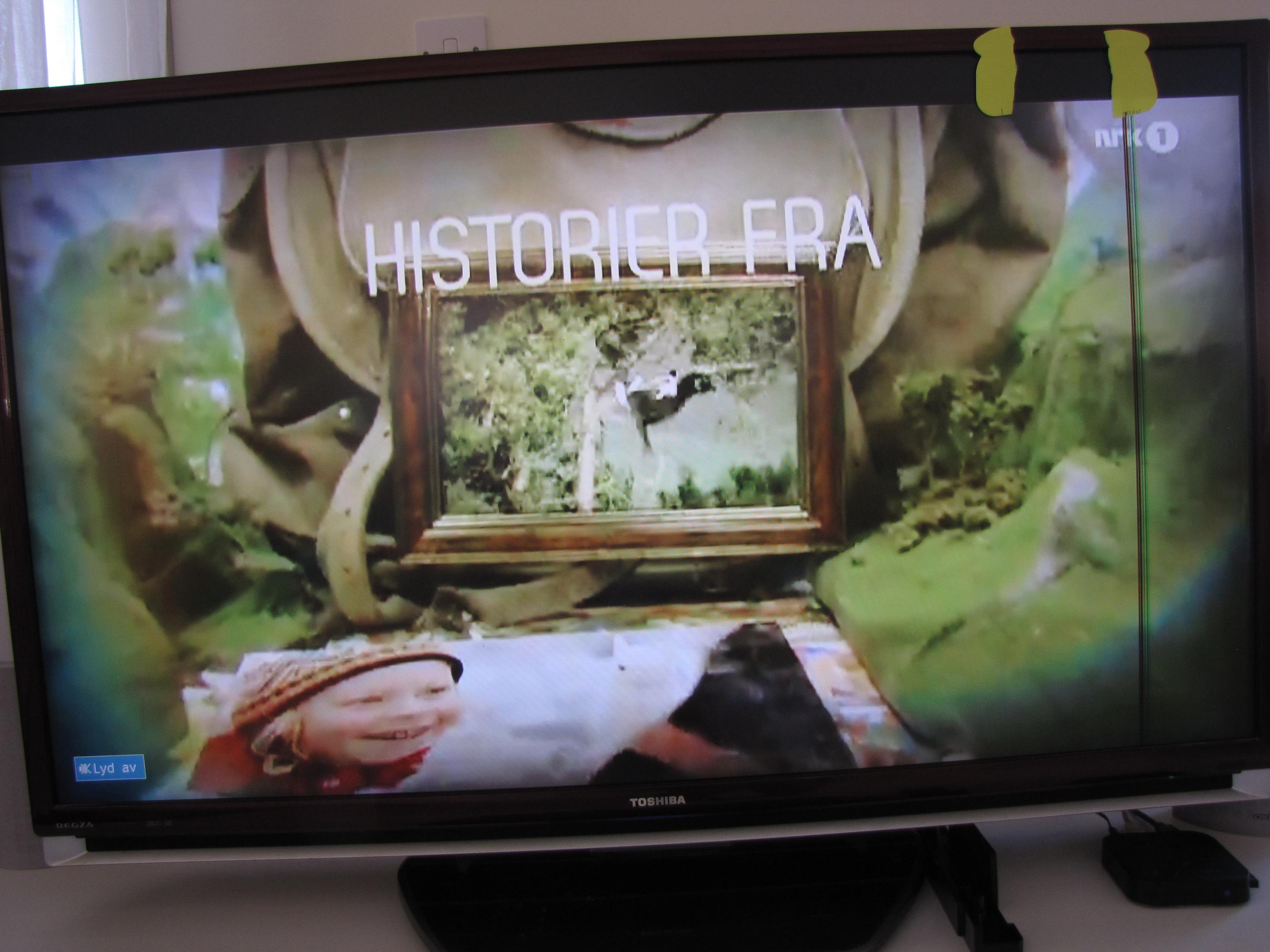

                Re: Toshiba 46XF356 T-conn problem
                Here are two screen shots. I will open the set later on to show the board.
                On the first shot (1397) appear one group of lines two the left of the screen, another two groups to the right. This is right after the set was turned on.
                The second (1398) about an hour later, shows (although a bit dark here) that the two first clusters are gone completely and the third substantially smaller. A few lines more will go away eventually, but most in this group stay.

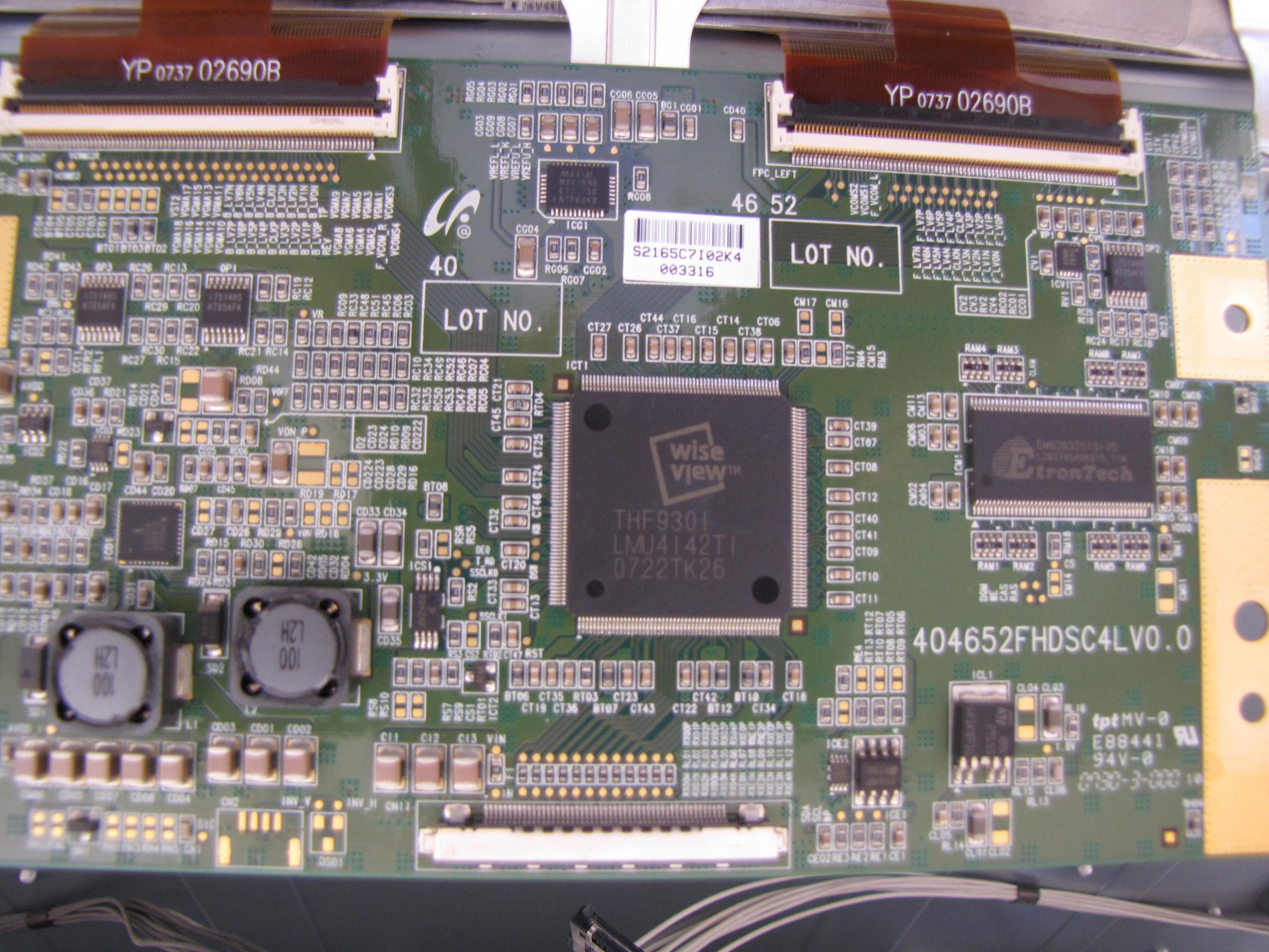

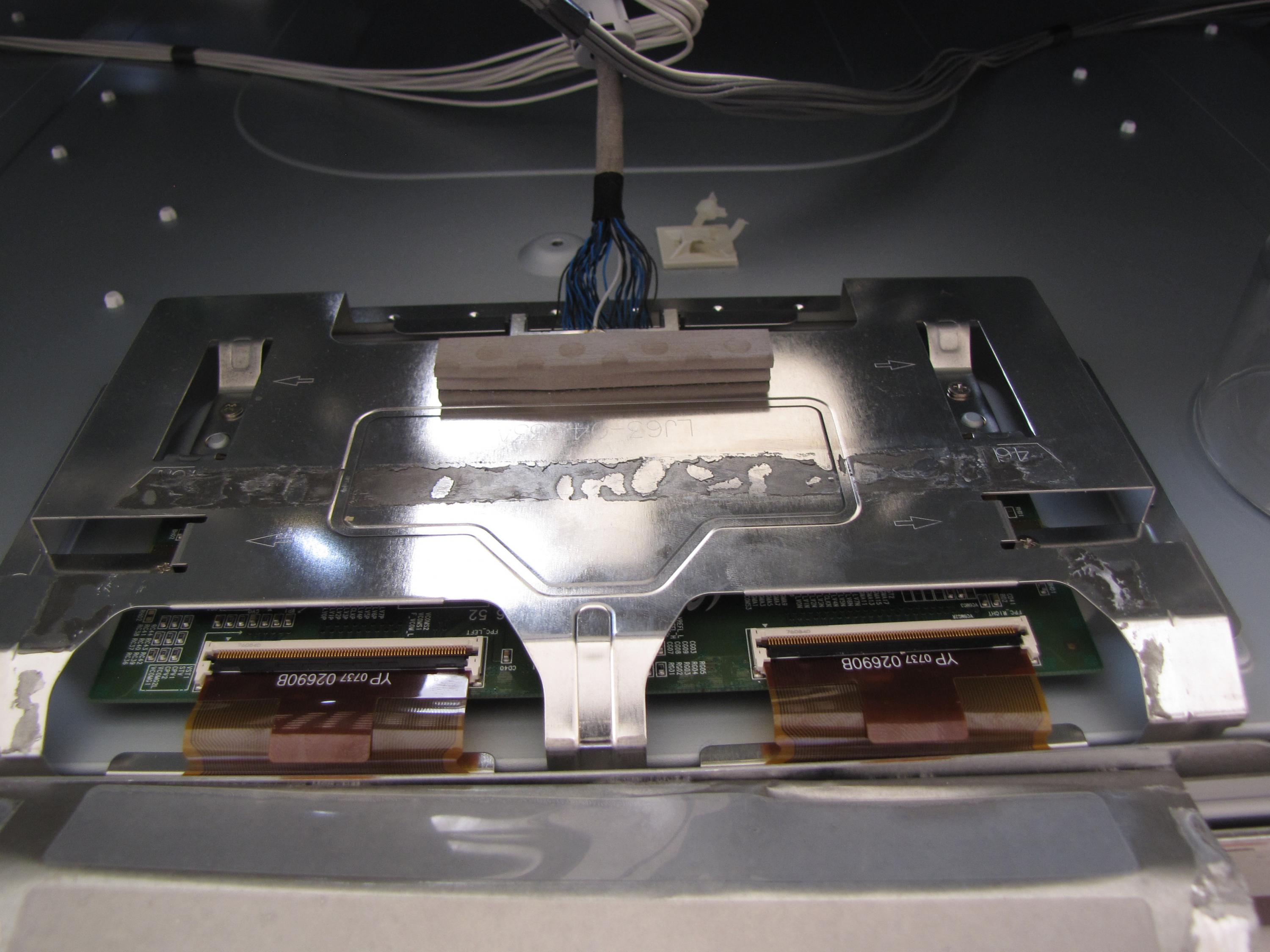

                    Here is the board and connectors. The cover (1400) says LJ63-04553A. I did not remove that the first time when I opened, but still with this closer look I am not able to see any lock.
                      I agree budm that it may have something to do with the board, but before I go ahead and change it, I would like to try to refurbish the connector as per the advice that I have read previously. So all I am asking at this stage is how to remove it. Is there a lock or do I just pull harder.
                        No point changing it, The panel is faulty.
                        It isn't the board at fault.. Its the LCD itself that is

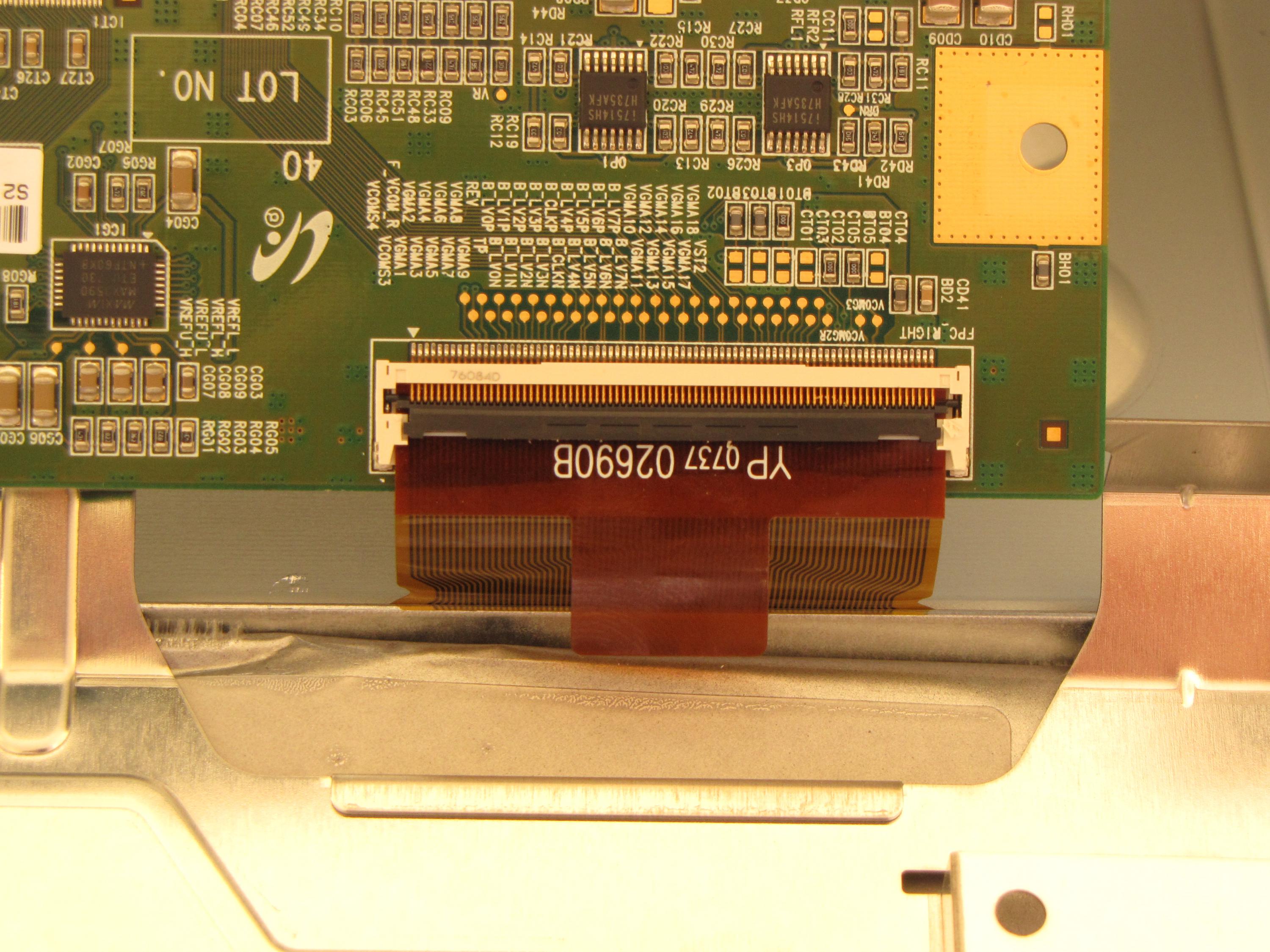

                          Possibly just bad tab bonds?
                            Originally posted by mwalsh
                            The use of "just" in that question is wrong!
                            You can attempt to press the bonds down but TBH looking at the amount of lines and being on 2 bonds your repair chances are very slim!
                            Lift the brown tab in the motion shown in image.
                                  Thanks for the advice to lift tab, newtothis. I was too impatient to wait for your post, though, so I found out myself by chance, but in a way that may have been too rough. Now I am not able to get the ribbon back properly any more.
                                      I will not subject the board to any more of my amateur fiddling. If I had been told immediately that the ribbon has no connector plug, that the top side is in fact a flap to lift, and that the removal is a delicate operation, I might have handled it better. As it stands now, a professional repair shop is the next stop.
                                        Professional repair shop won't be able to 'fix' your fault.
                                        Unless they are able to replace tab bondings, and the chances of that are slim to none.
