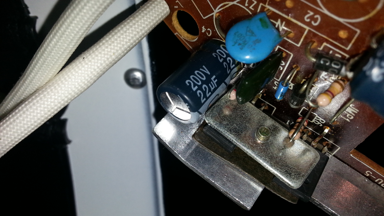

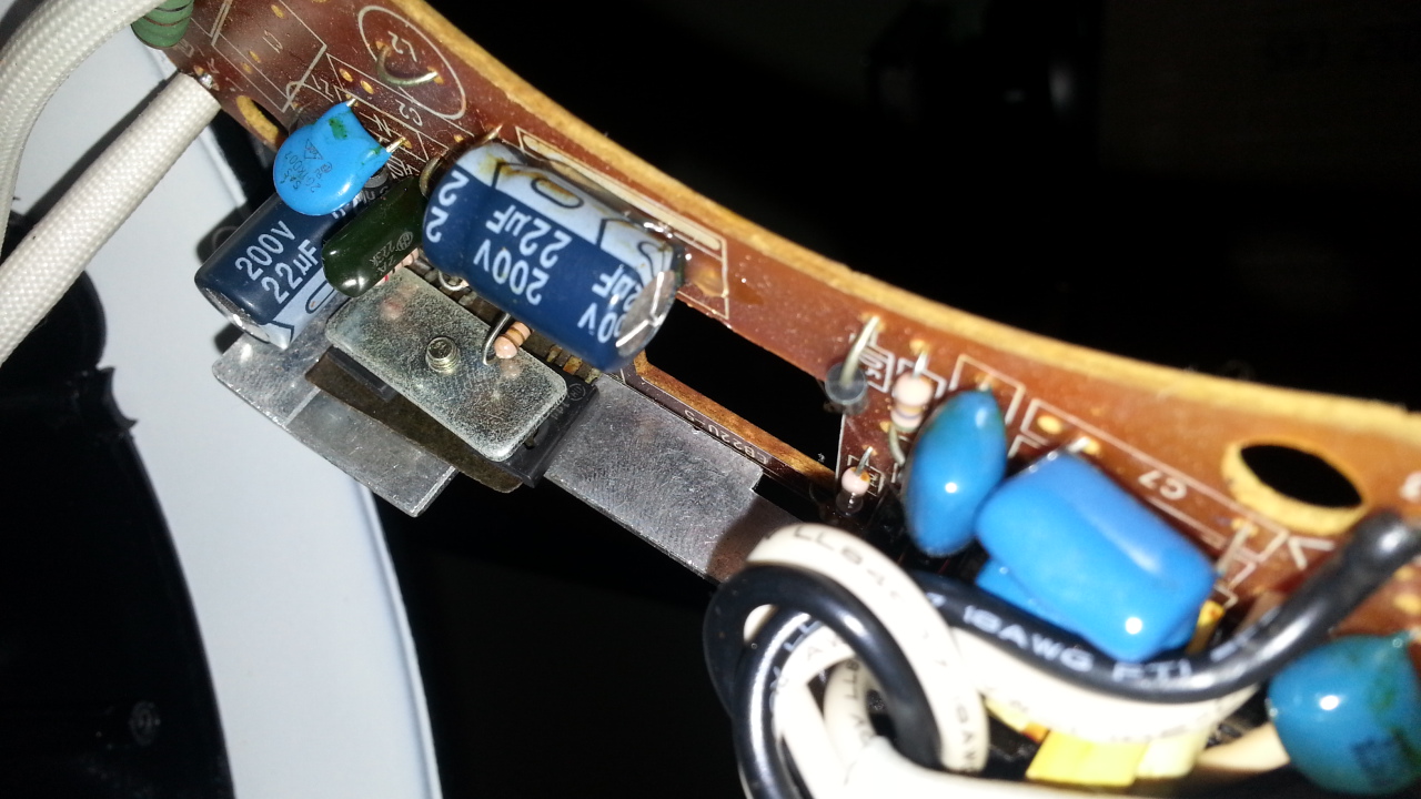

    So of course I purchase and install a new lamp (circline fluorescent) and nada.
    Hmm. Check my old lamp with another fluorescent fixture in another room and of course it's working.
    Pull down the ballast out of the hobby light and find a swollen 200v 22uf cap. There are two of them but the second isn't too bad looking.
    Bust open a burnt cfl bulb I had around and harvest two 200v 15uf caps (it's all I had!) and unit functions again.

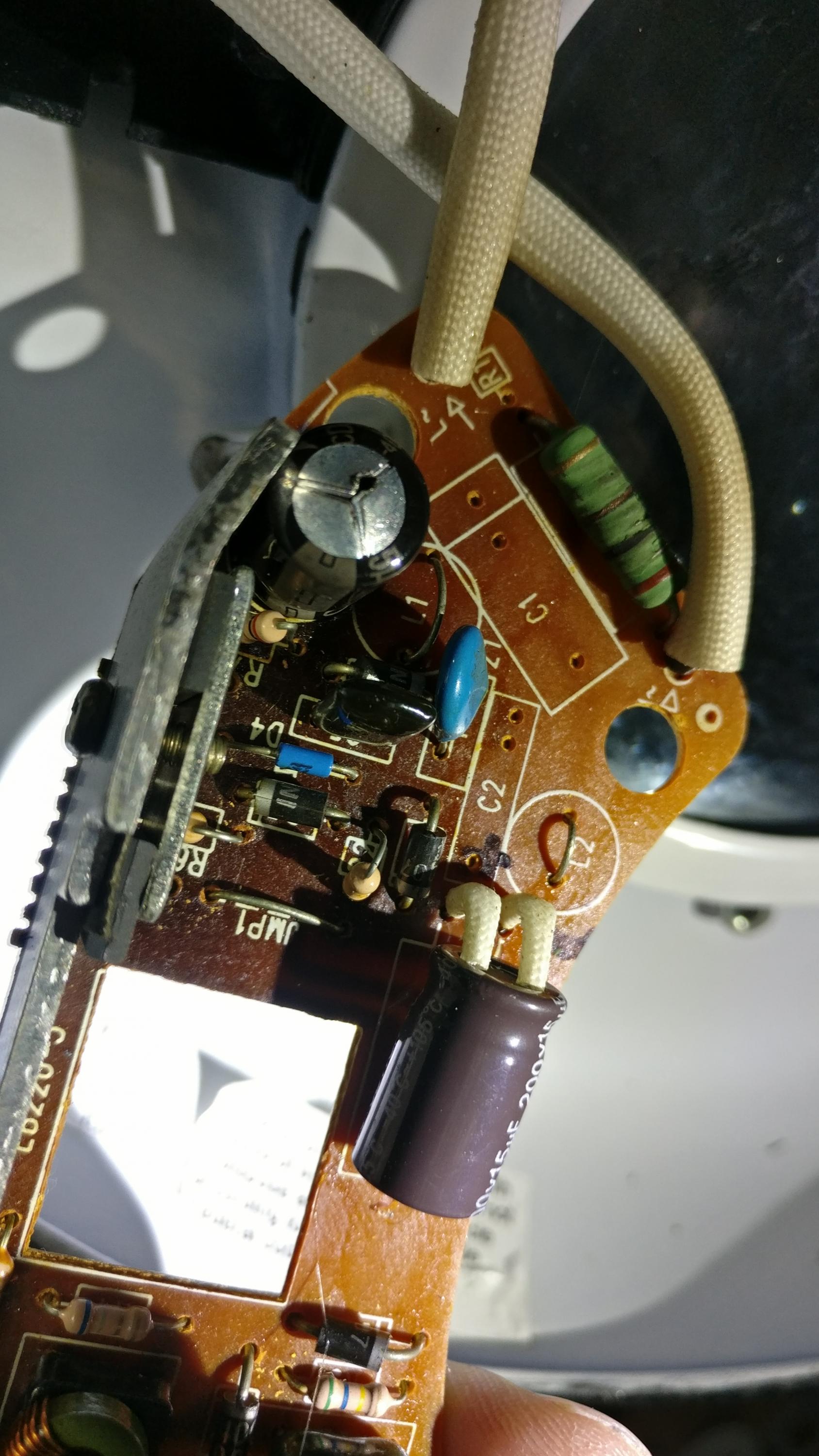

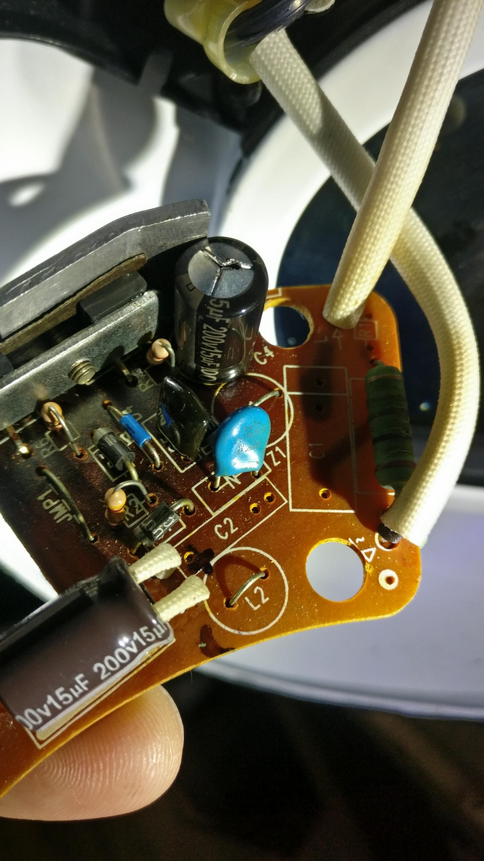

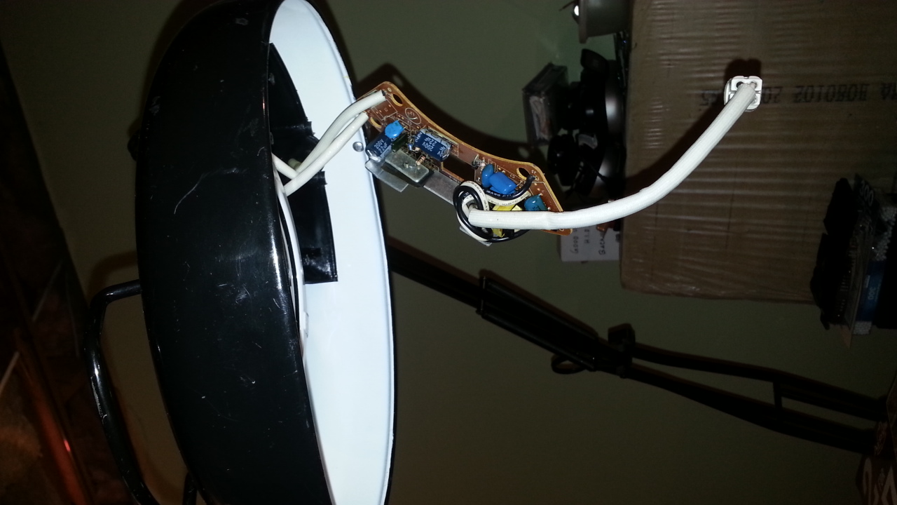

    Fast forward four years...

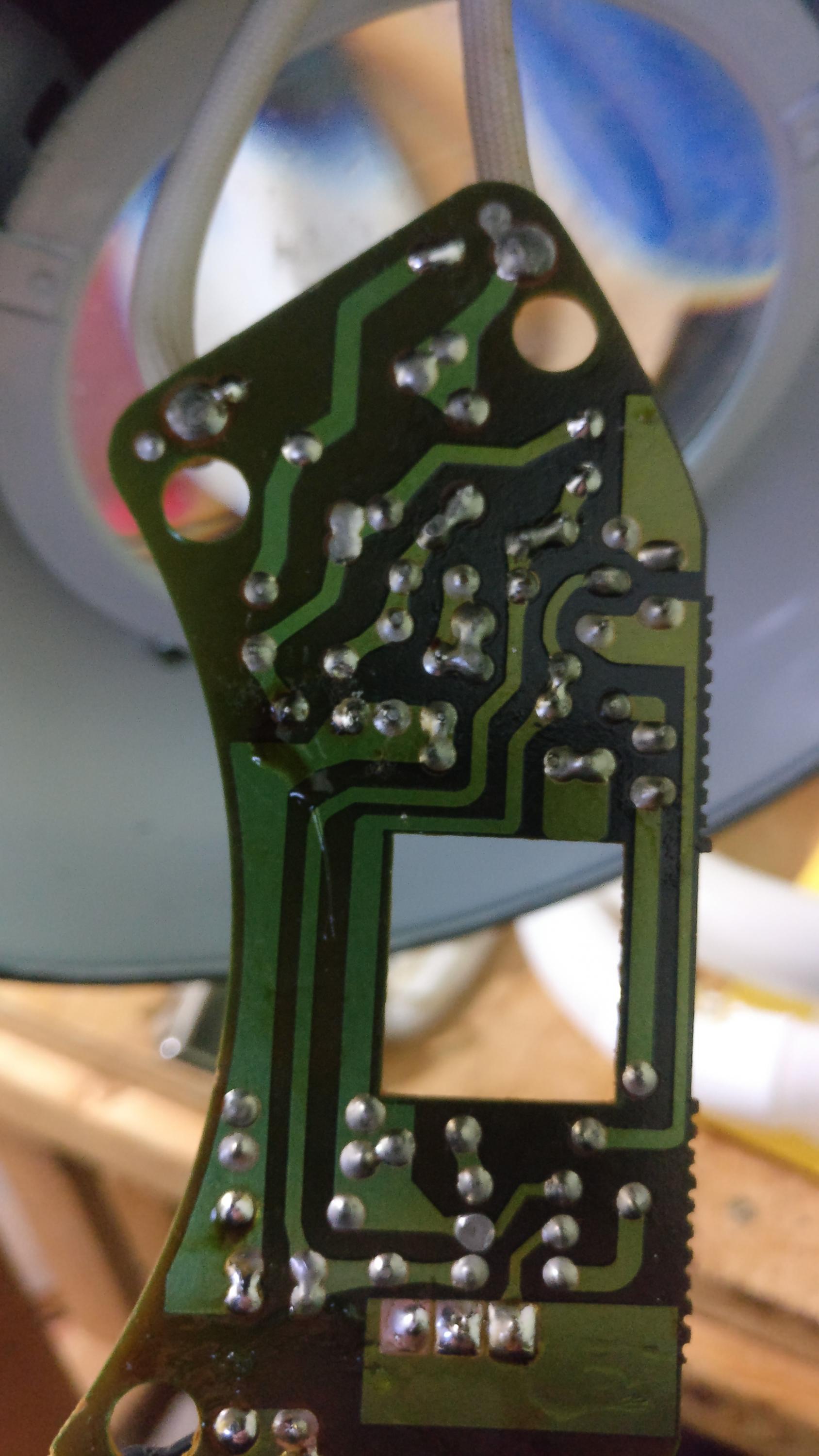

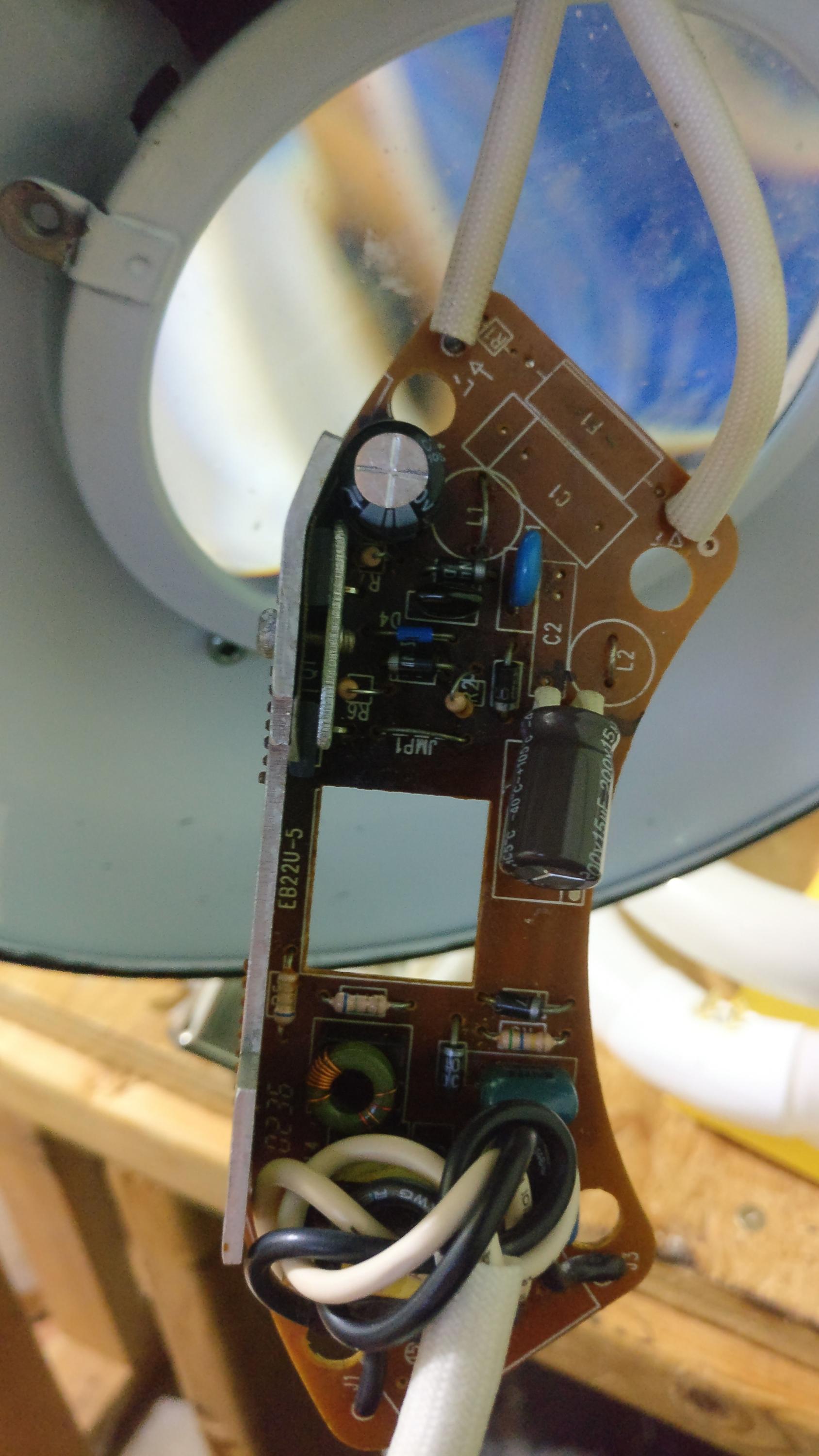

    The lamp stopped working and again a replacement didn't work either. This time the other cap at C4 had vented but also the fusible resistor at F1 had gone open.

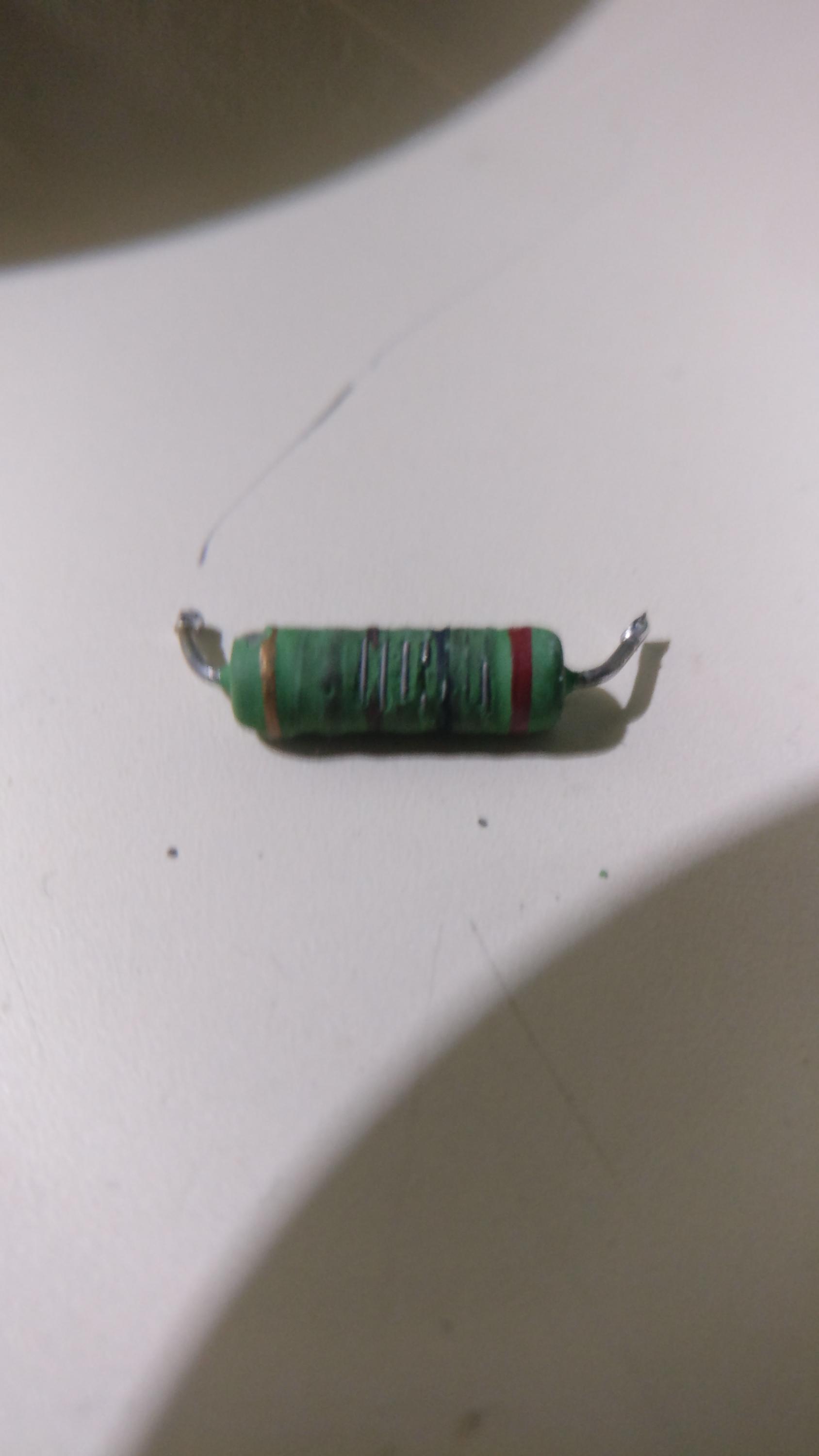

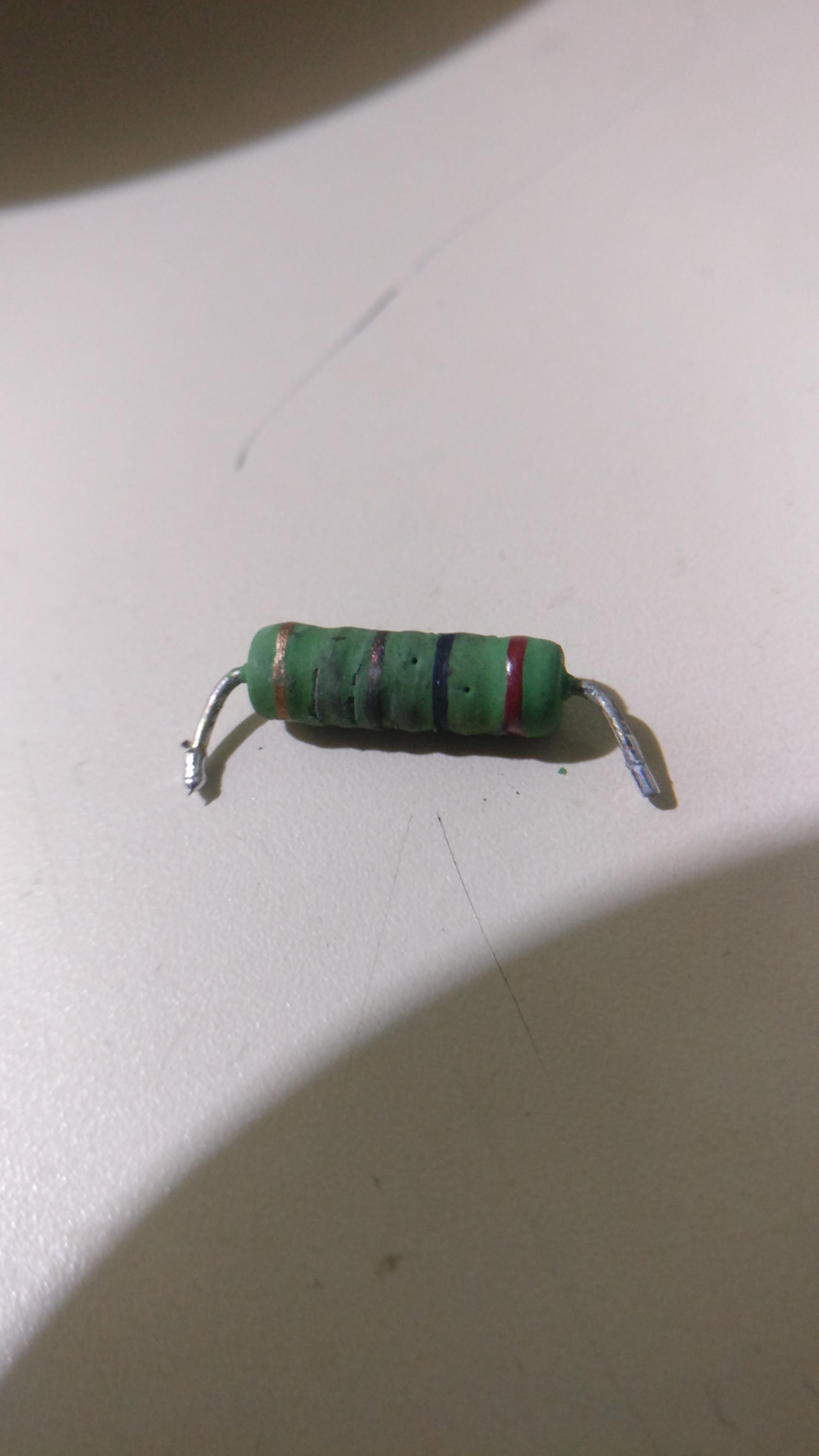

    I can't read the colour bands off it (see photos). Can anyone suggest a value for this resistor ?
      Re: My Hobby Light/Magnifier Stopped Working
      https://www.badcaps.net/forum/attach...0&d=1556939673
      You can see where the breaks on the spiral wire is.
      You can check the resistance between each leg and where the conductor spiral is open and subtract the probe wires resistance of each reading that will give you resistance of one spiral, the do the same for the spiral, then add them up.

        What budm said. The colors look to me to be RED, BLUE, BROWN, GOLD.
        It would help to know where in the circuit the resistor was. Also, can't you get a value from the fixture in the other room?

              I thought there was another band (five band) looks like an outline there but maybe you're right and it's just a four band.
              I named the location of the resistor in my previous post, F1. You can see it in pic 3, it has been removed but its position is between the two incoming wires at the top of the circuit board.
                I see what you're saying bud. I didn't realize the resistive material was so close to the outside of the resistor. I would have thought it to be embedded deeper.

                      Since it's F1 it'd more likely be red-violet-gold-gold, 2.7Ω fusible/flame resistant. Thinking about it more, red-violet-brown-gold 270Ω is way too high for the application. It'd have to be at least a black band there.
                      I'd be more worried about why this resistor failed in the first place...did the transistors short out?

                        I measured roughly 1.4 ohms to each side from the break so minus lead resistance should be somewhere around a 2.7 ohm resistor. That would make it Red Violet Gold Gold I suppose that's possible since the third band is somewhat toasted.
                          Yep, that is about right.
                          So next thing you need to do is to verify that there is no shorted component that caused that resistor to blow.

                            I couldn't find the proper resistor in my parts bin but tried something a little larger in value and the lamp lit but after a few power cycles the resistor went high again. Instead of ordering a proper resistor and at the risk of having further problems in the circuit I have decided to follow awyatt2's lead and do the led conversion.
                            Thanks for everyone's help.
