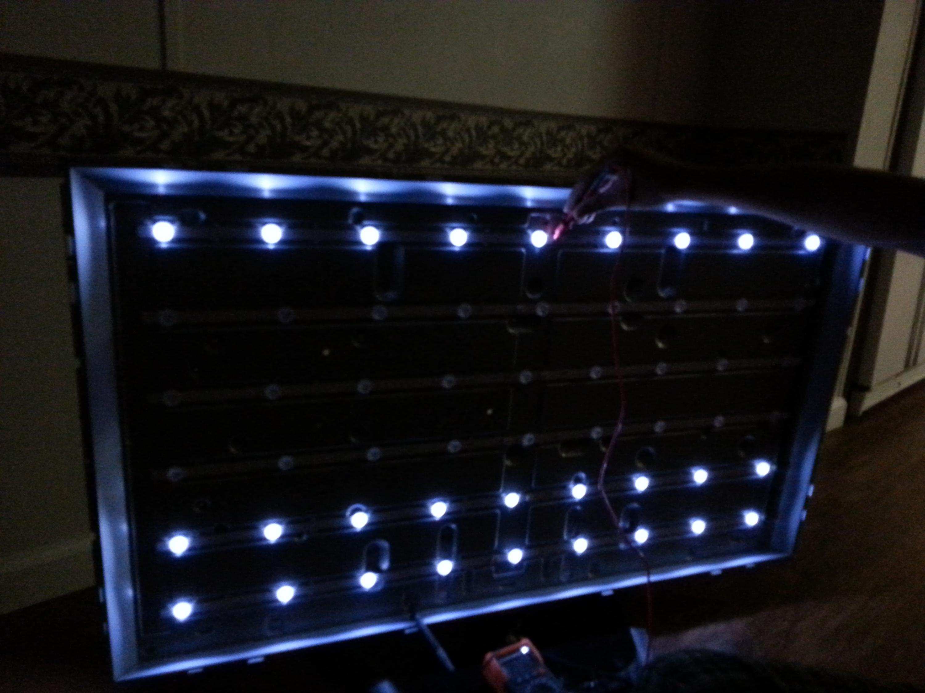

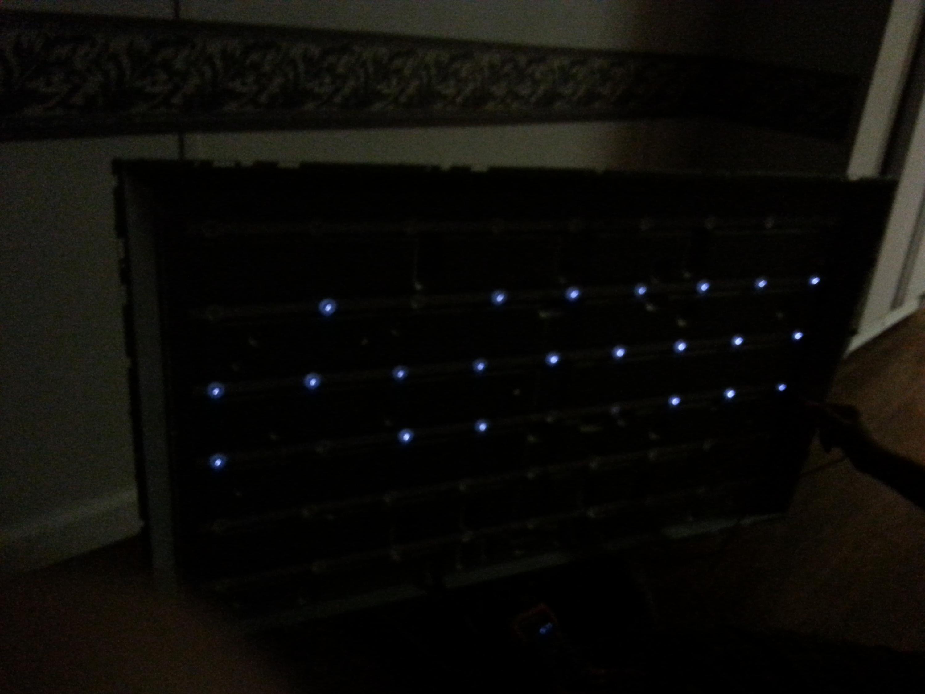

    BTW, you also split those 3 dead strips in half and connect then one at a time to one of the two bottom string to help you narrow down which half of the strip is dead.

      I wasnt sure if anyone actually replied to this post, because I never got a email to say there was a response. Kinda weird for a forum. Usually you get a notification email when you have a response in the thread. Either way I appreciate your help. I actually just got a new R2 strip and put it in where the two LEDs were out. It still wont light up, and those rows are out. I actually took my multi-meter and put it on ohm mode and started to test the contacts around the TV. I actually found 4 more leds that are out in the 3 series. I just want to make sure before I actually buy 3 more strips that is whats wrong. I am going to post a couple pictures of what it looks like when lit up when im testing. I just read that people were saying that many LED's could be out, but it definitely looks like that is whats wrong. The first picture should be where the 3 good rows light up, and then the second picture which is very dim shows where the 4 leds are out. I would totally figure that this is the last of my problems but before I keep dumping money into this TV (which I got for $30) I want to make sure this is the last of what I have to do. If not then I may as well just part this damn thing out. Thanks for the help guys!

          Also just to let everyone know, I did end up fixing my TV by replacing those bad strips.

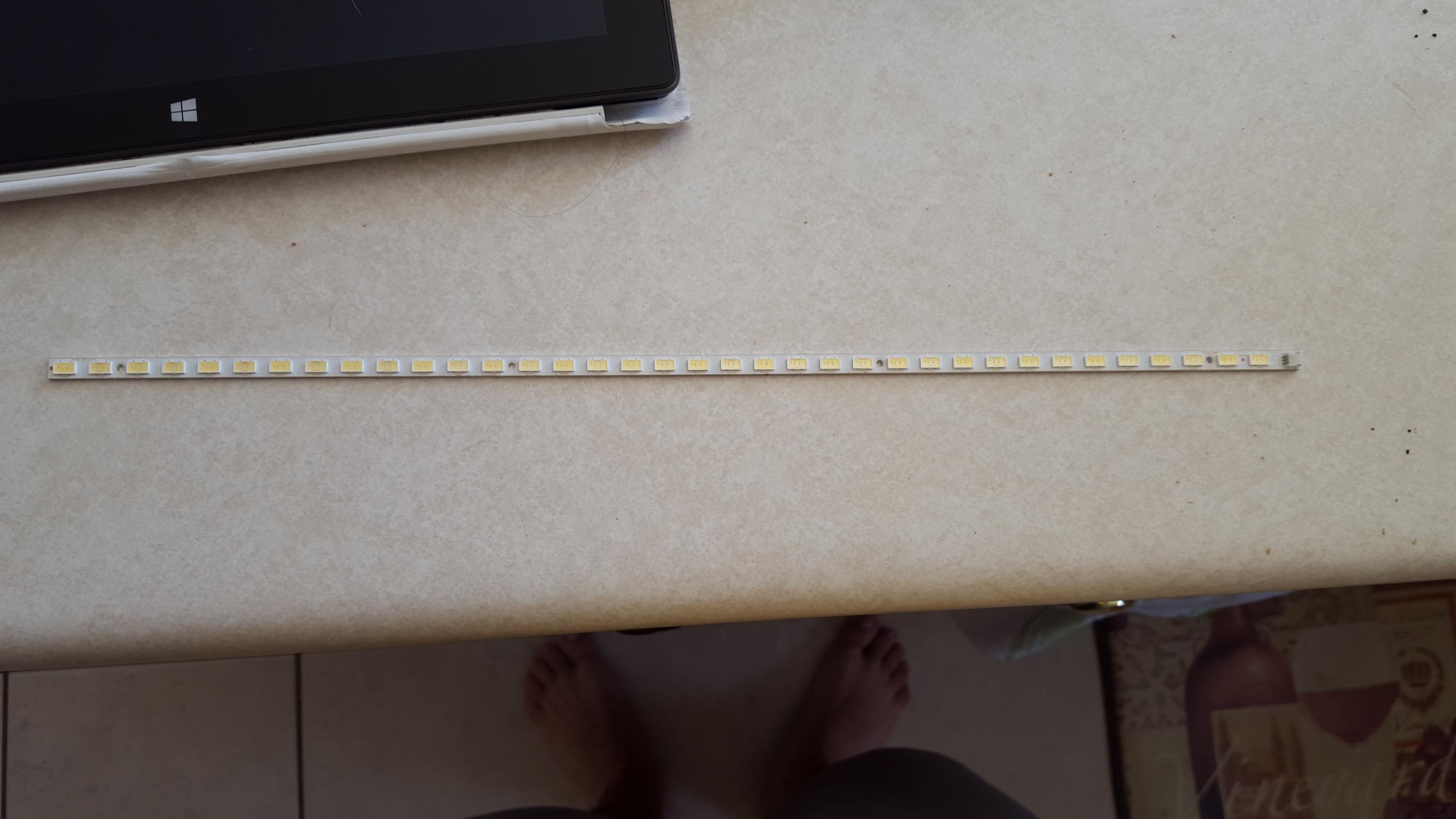

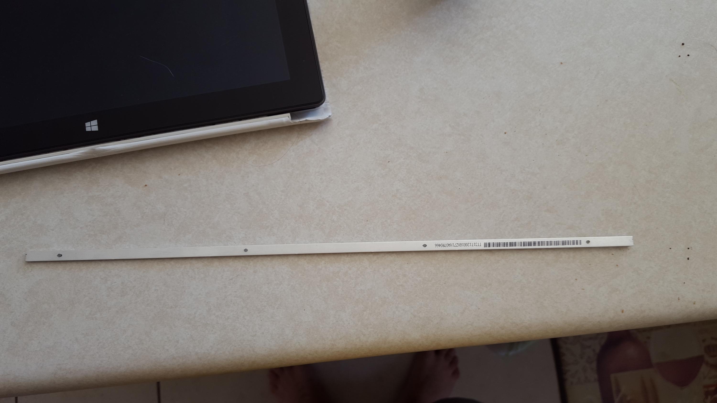

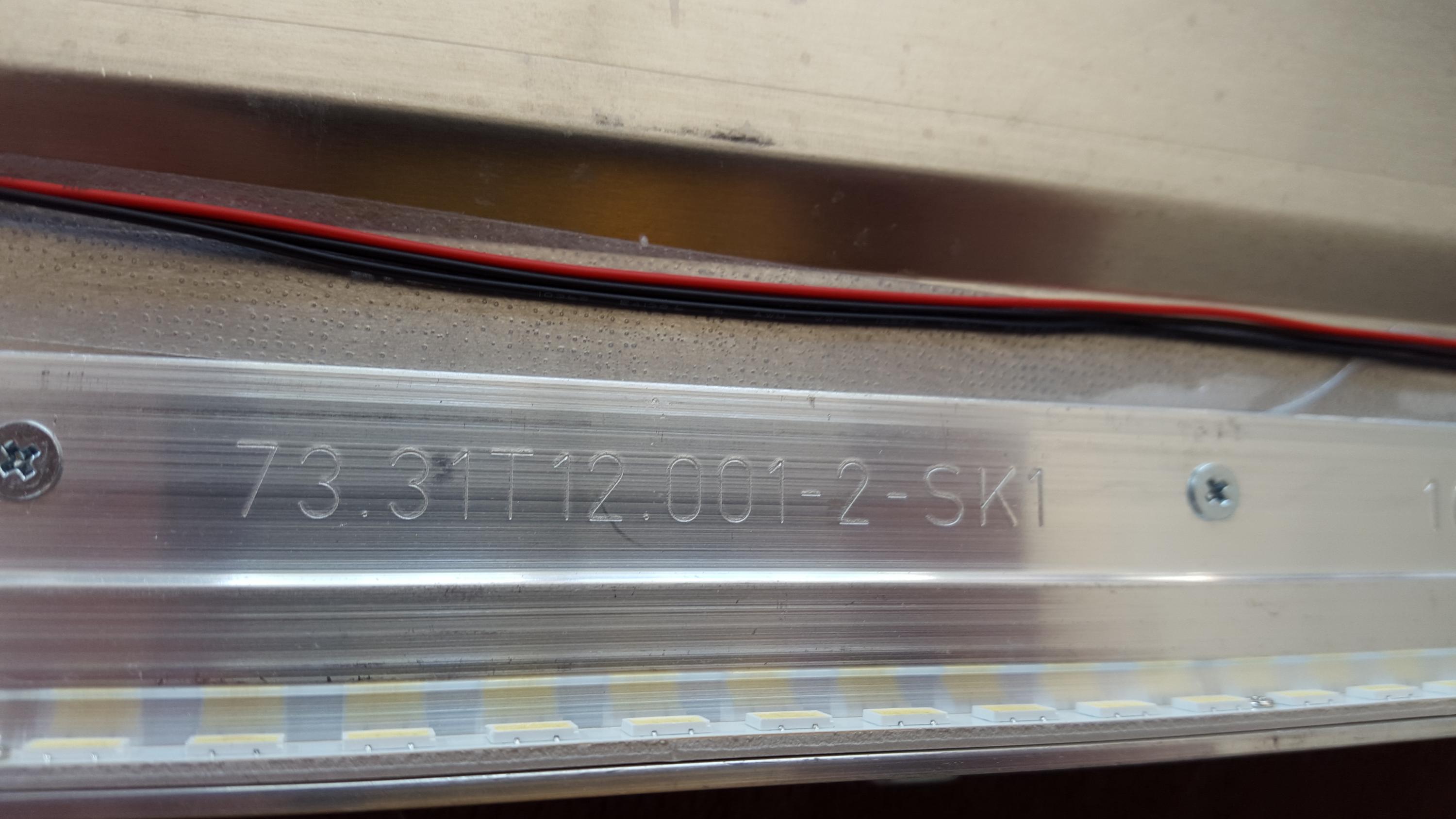

                    Good afternoon everyone. I'm having a similar issue with a different type of led strip, and am seeking help. I will post here, unless someone thinks I need to start a new thread, but it's the same issue. I have taken my boards out and tested them, and found that diode 016 on the lower left strip is bad. I can buy the individual diodes, but am not experienced in how to replace it. I have spent hours searching for a simple board itself, but haven't found any. What's the best way to replace one of these diodes, or does anyone know where I can just find this part? Been watching ebay for the past year, and haven't come up with anyone selling the part as scrap. The tv is top/bottom lit, so it's different style LED strip than the original poster. I am by no means an electrician, but I am a DIY hobbyist, and if I can fix this easily or with a little finesse, I'd like to do it.
                    I've attached pictures for reference and as you can see, there's an aluminum strip on the back of the LED strip. My tv is LG 32LE5300.
                    I believe this is the European version, which is out of stock. I cannot find the part online anywhere.
                    http://www.tvparcasi.com/t315hw05-v1...1-up-31t12-01a

                      On the LG ln series sets if you don't replace all the led strips you will be doing again within a year. The leds keep shorting till one of them opens usually. That causes the remaining led's to be in a over voltage state till it stops working. We tried just replacing single strips at first but stopped due to recalls. Since then we have been replaceing complete sets. And its not just lg that has this problem. some models samsung have the same issue and also the cheap sets. Cheap Led's is the Problem
