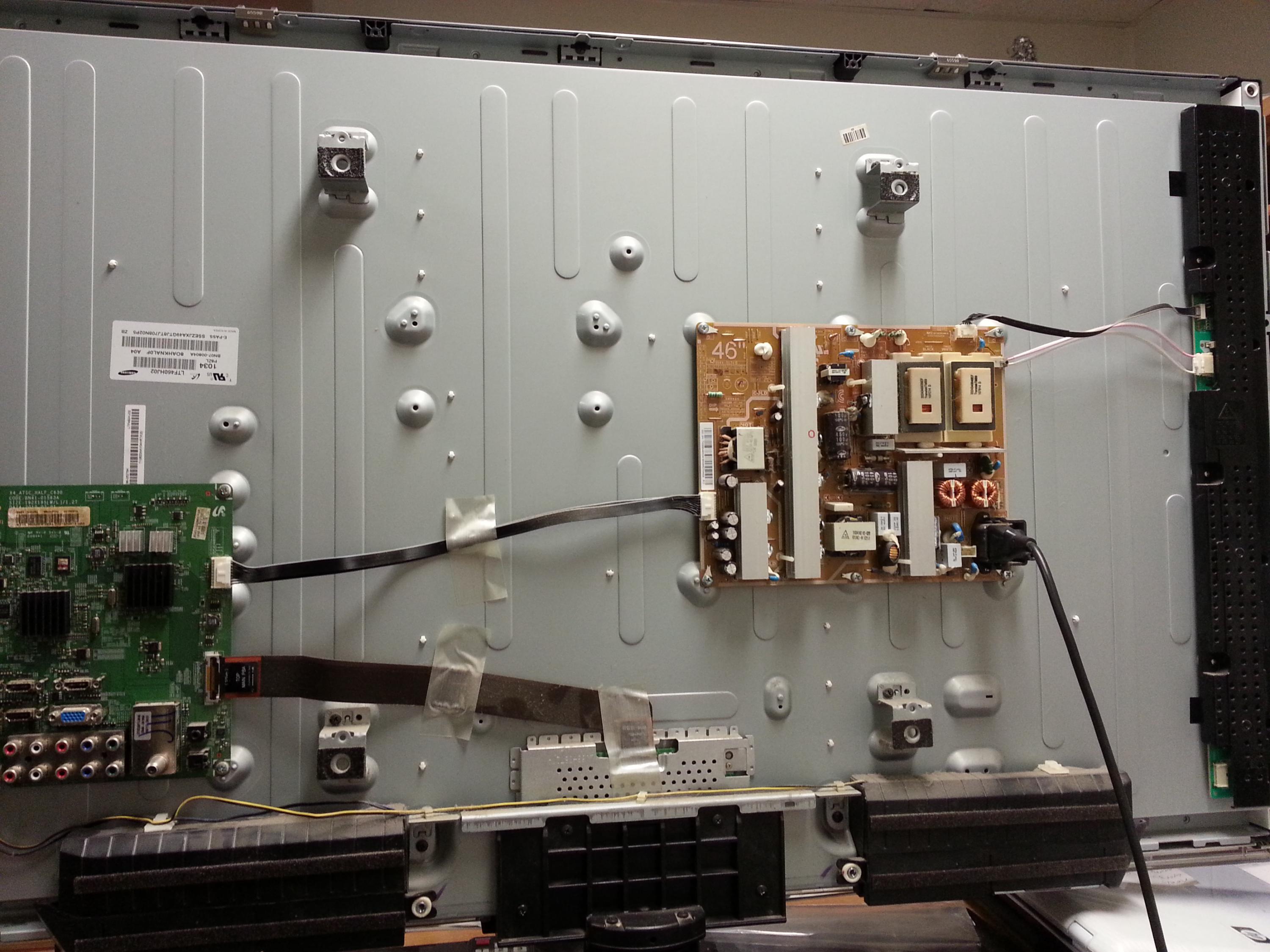

    I'm working on this Samsung L46C600F3F LCD which works, but isn't lighting up the backlight. Does anyone know of a good place to start troubleshooting this? Would the readings from the connector described in this other thread be a good place for me to start?

    Does the power supply get the BL-ON signal from the mainboard?
    Upload some pics.

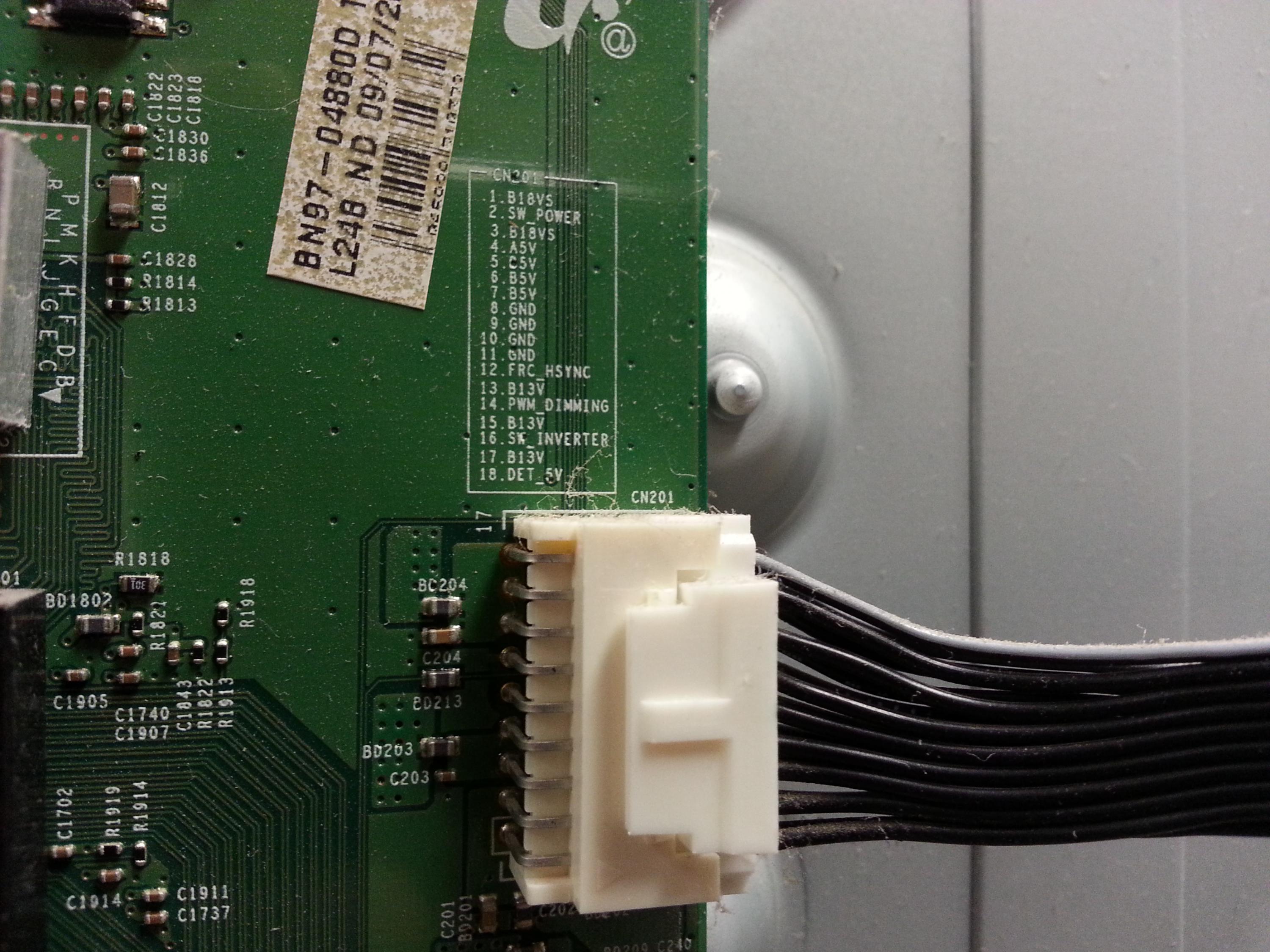

      I'm not completely sure. Here's what I've got for measurements from the connection between the power supply and the mainboard (most of these look to be on par with the little chart, as pictured):

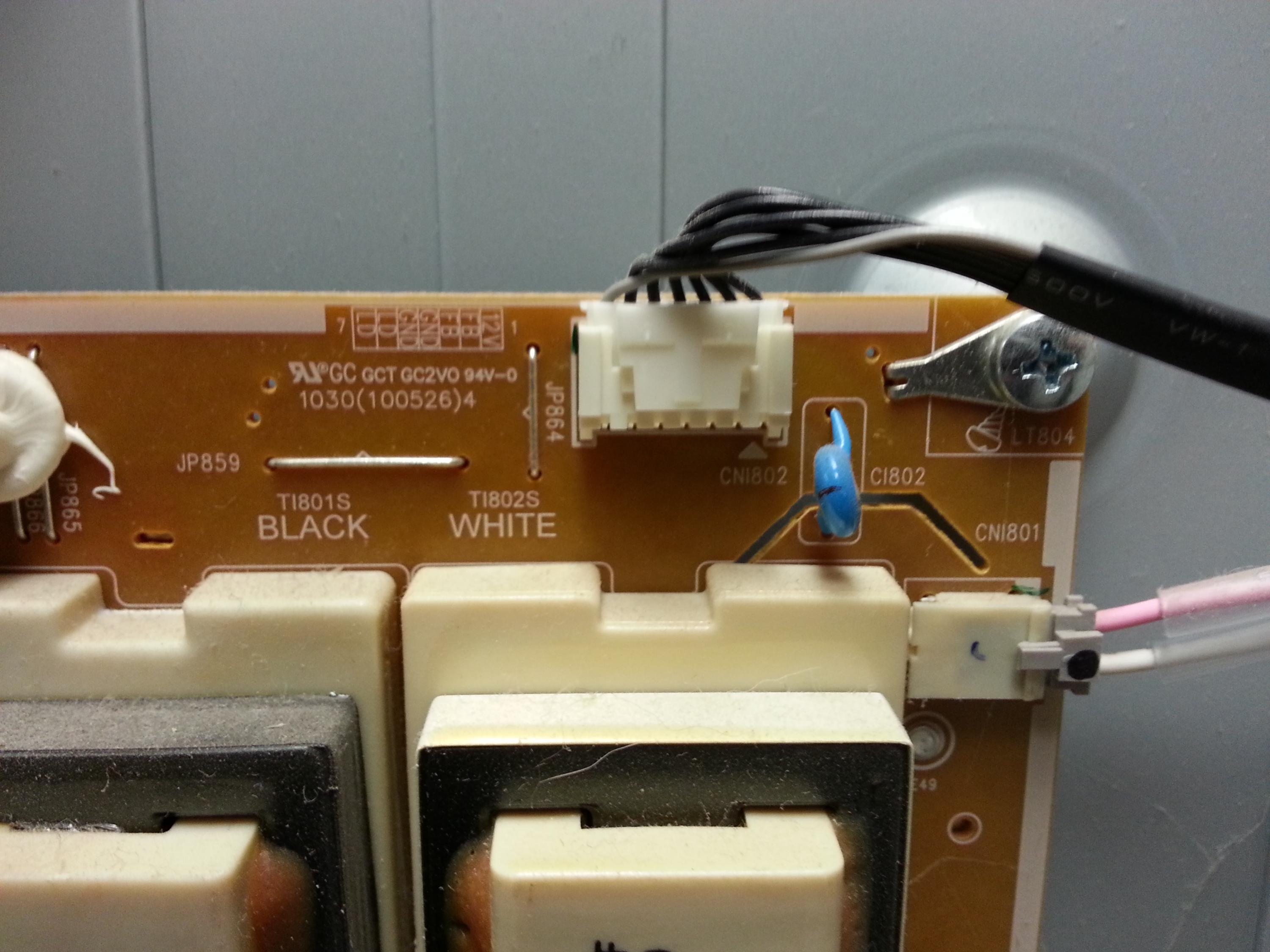

      If it helps, I also measured the CN1802, which connects the power supply to the inverter. I got 12v on pin 1 and 9v on pins 6 and 7. Turning on the power with the mainboard disconnected from the power supply (as suggested in the other LN46C600F4FXZA thread) does not elicit a response either.

          Here are the voltages with the pin names, going by the printout on the board next to the connector:
          1 (B18VS). 12v
          2 (SW_POWER). 0v
          3 (B18VS). 12v
          4 (A5V). 5v
          5 (B5V). 5v
          6 (B5V). 5v
          7 (B5V). 5v
          8 - 11 (GND). Ground
          12 (FRC_HSYNC). 1v
          13 (B13V). 12v
          14 (PWM_DIMMING). 1v
          15 (B13V). 12v
          16 (SW_INVERTER). 5v
          17 (B13V). 12v
          18 (DET_5V). 0

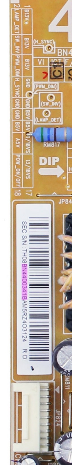

            OK, your pinout and the names are way off as printed on the board (BN44-00341B).
            I.E.
            Pin 1 = B13V
            Pin 2 = LAMP_DET
            BTW, the exposed pins on the top side are the ODD NUMBER pin, the EVEN NUMBER PINS are on the bottom side of the board. The white triangle is pin 1.

                No, that readings with the name and pin numbers are wrong.
                For example, pin 18 of the board is PWR-ON/OFF, you show pin 18 reading of 0V, that means the PS-ON is not present to turn on the power supply board.
                Pin 7 you show that it has 5V which will be impossible since pin 7 is GND,
                PIN 7, 9, 10, 12 are ground pin. You have "8 - 11 (GND). Ground"
                You should take the Voltage readings again with correct pin names and numbers.
                Without correct readings then we cannot tell what is going on.

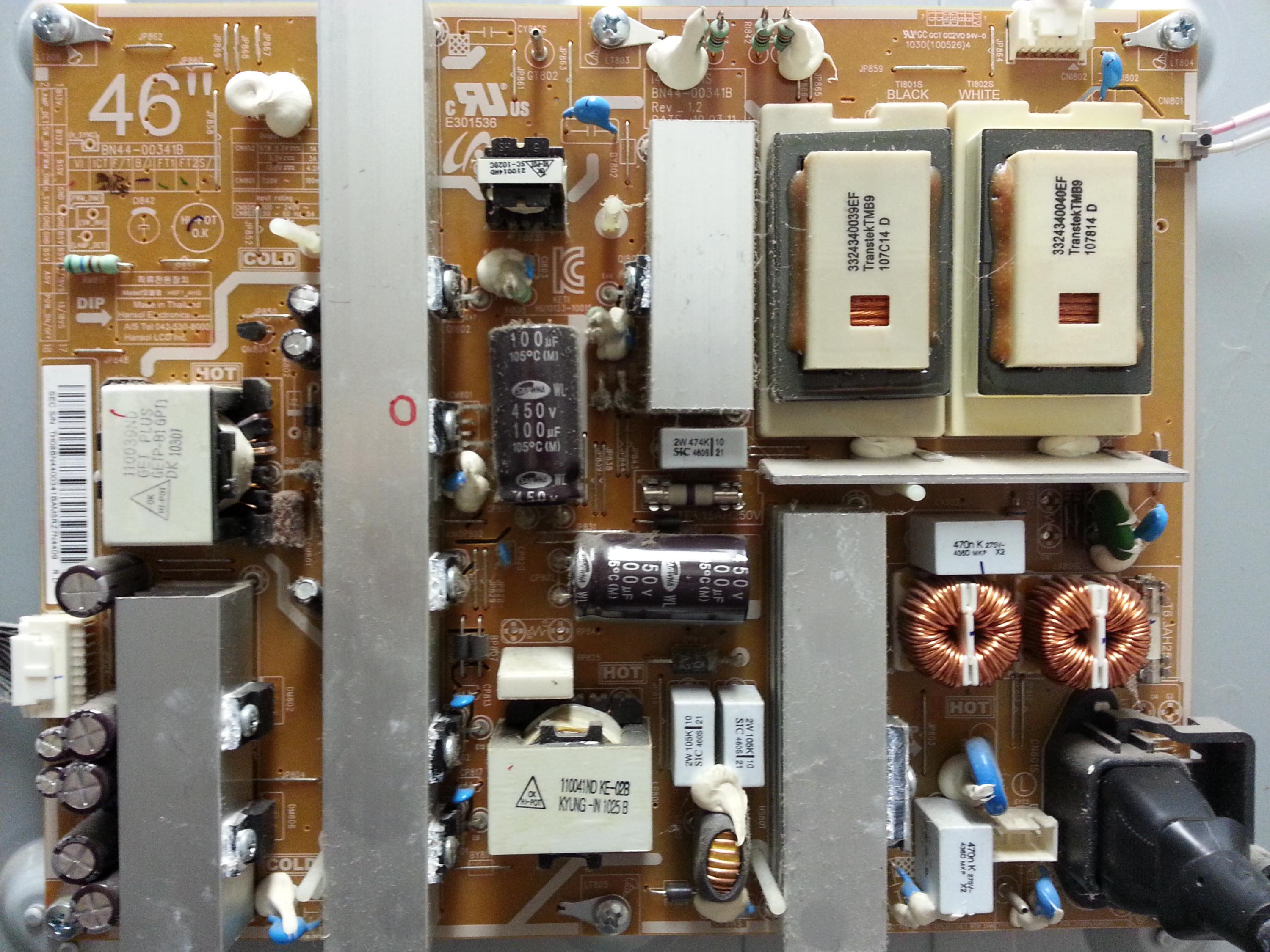

                  As suspected, the power supply was indeed the culprit.
                  Fixed!
