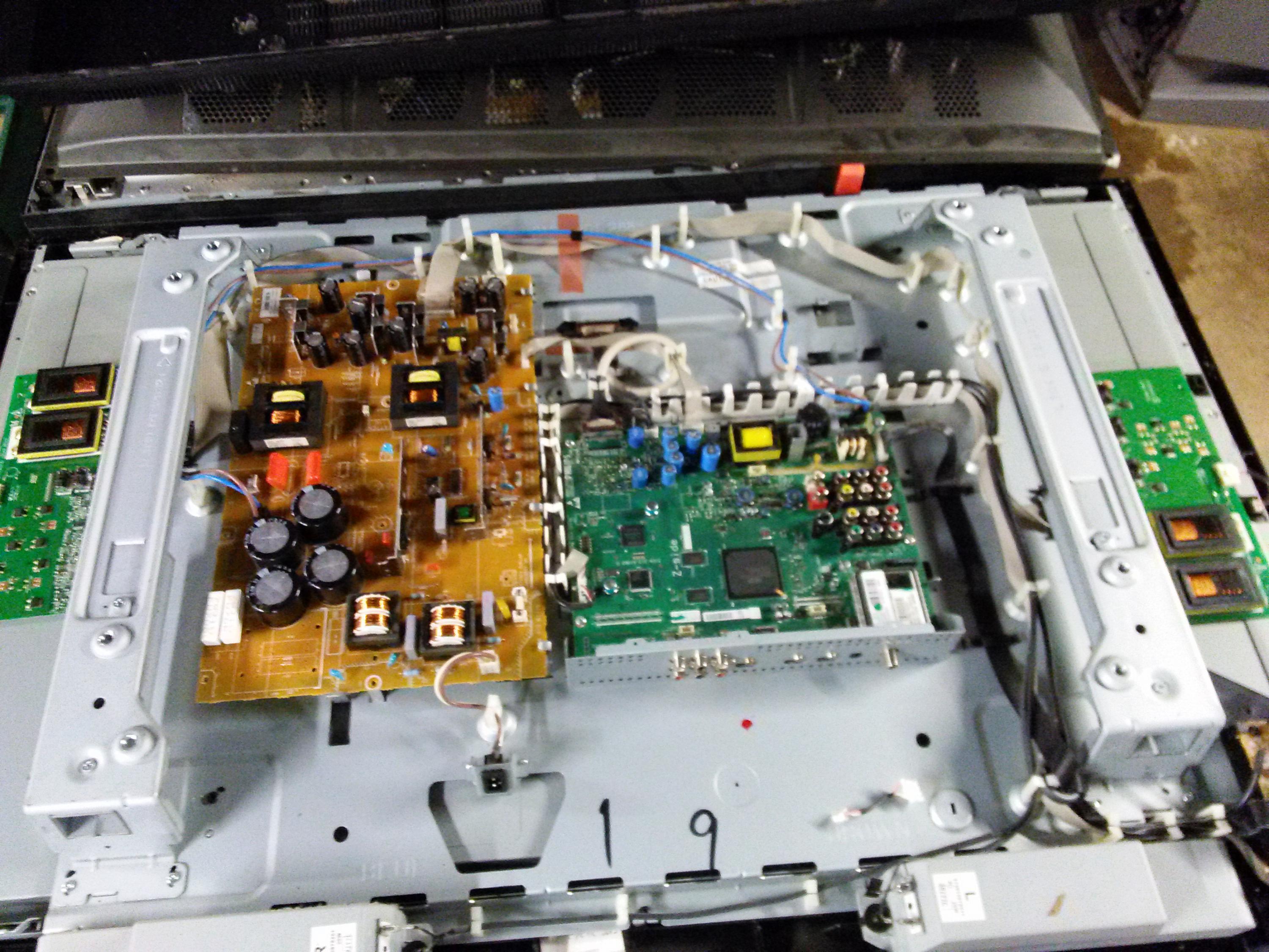

Philips 42pfl7422d/37 no backlight
  • mattstolte
    • Dec 2013
    • 612
    • usa
    Tv turns on but no backlight. I see image so i thought it was inverters, i tried replacing them and still didnt work, and i know they are good cause tried them in another set. Then tried power supply still no back light?

    Re: Philips 42pfl7422d/37 no backlight
    Are the inverters getting power and a control signal to tell them to power up?
      Anybody have a power supply schematic for this power supply so i can find measure ments
        Look next to the connectors, most have names next to each wire so you know what they do. Most are self-explanatory. Post photos if you can.
          This power supply dont
            What about on the inverters?
