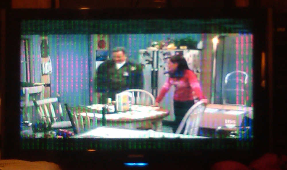

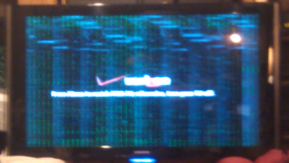

    Any information on the issues seen in the photos would be helpful, tried reseating LVDS with no change, this issues does effect the border of the OSD and i found out it is input independent as changing the no input signal screen to "BLUE" it will develop these lines. I did notice that it wont be quite as bad if i don't activate the OSD box and when I do the thicker bars seen in the black verizon screen will appear and stay after exiting the OSD and the white dots/lines in pattern on the top of the screen are a new one for me? I would like to fix the issue myself, I work on a lot of electronics but when it comes to display issues I'd rather ask than jump into anything myself.
    Thanks any and all help will be appreciated.

    Does the picture improve the longer the set is on?

      Re: Samsung LN-T4671F : need help display corruption / RGB lines
      I had it on for about 90 minutes and it did not get better. If i turn it on to the cable tuner "snowey screen" there is no corruption. If i leave it on the black screen with the red Verizon it shows the lines as seen and wont get worse. When I tune to a channel the colored lines appear and do not go away. I don't know if 90 minutes is enough time where it would improve or not.
        Service mode and run test patterns.
