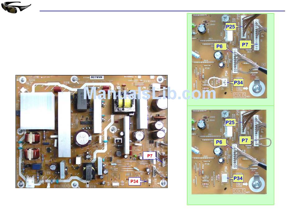

    I had begun to help a friends resolve an issue with a Panasonic Plasma TC-P50VT25 several months ago. Between visits however, someone convinced him to take it to a shop about 70 miles from here. Where it has sat since September.
    I knew before it was taken that the boards for the TV were about impossible to get anymore but was confident that they problem lie in the power caps. Which according to the shop - that is the problem. They claimed however, that they could not get the parts. That would be true, is they are speaking of the entire board. But as you can see in the pic. there's PROBABLY nothing special about the caps.
    Also, as it is the power board, the replacement should not be nearly as risky as on a multi-layer board with far more concerns to consider.
    As the TV is not here, I cannot simply pop the back off and ID the caps myself.
    If anyone has a lead to the board level schematics OR - can ID the cap values - I would be forever indebted.

                                    Re: Capacitor ID for Panasonic Plasma TC-P50VT25
                                    These are on a 50GT25 P board but will be the same. electrolytics
                                    c256 1000uf 230v CE nippon chemicon
                                    c406,408 1800uf 80v KMQ
                                    c560 220uf 25v ZL Rubycon
                                    c561 10uf 50v ZL Rubycon
                                    c404 100uf 50v ZL
                                    c366 560uf 35v ZL
                                    c403 470uf 140v KMG
                                    c352 560uf 35v ZL
                                    c554 820uf 25v ZL
                                    c551 470uf 10v ZLG
                                    c701 220uf 10v ZL
                                    c514 220uf 50v ZL
                                    c505 22uf 50v ZL
                                    c623 390uf 450v CE CHEMICON
                                    c503 47uf 450v PAG CHEMICON
                                    So, do you have any symptoms to share from the original fault, blink codes etc ?
                                    Is this the same Tv with no ground from this post? last I read it looked like the A board had been corrupted but somehow the TV fixed itself.
