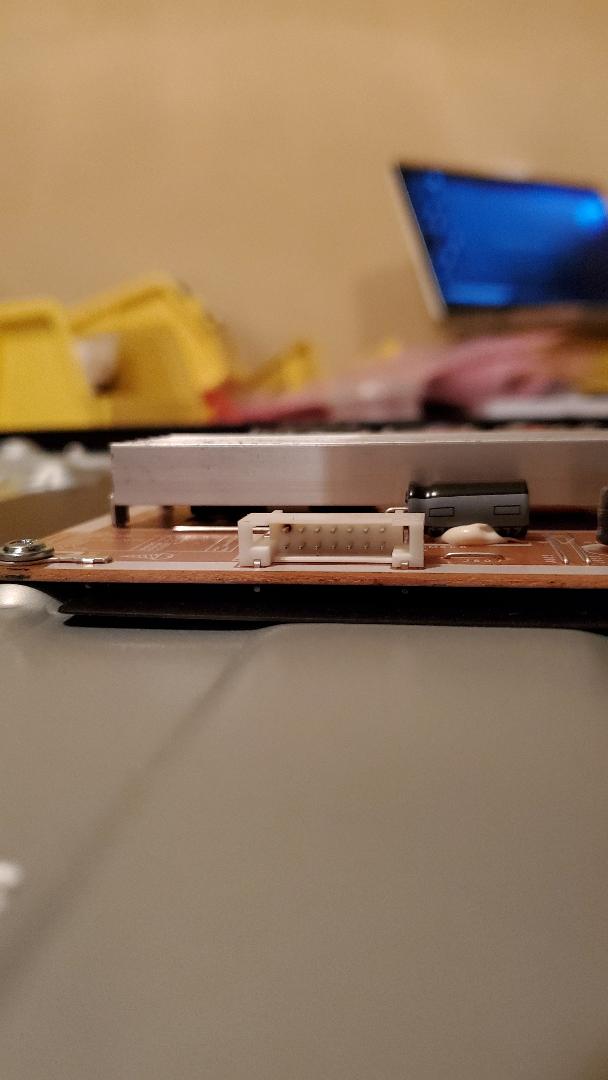

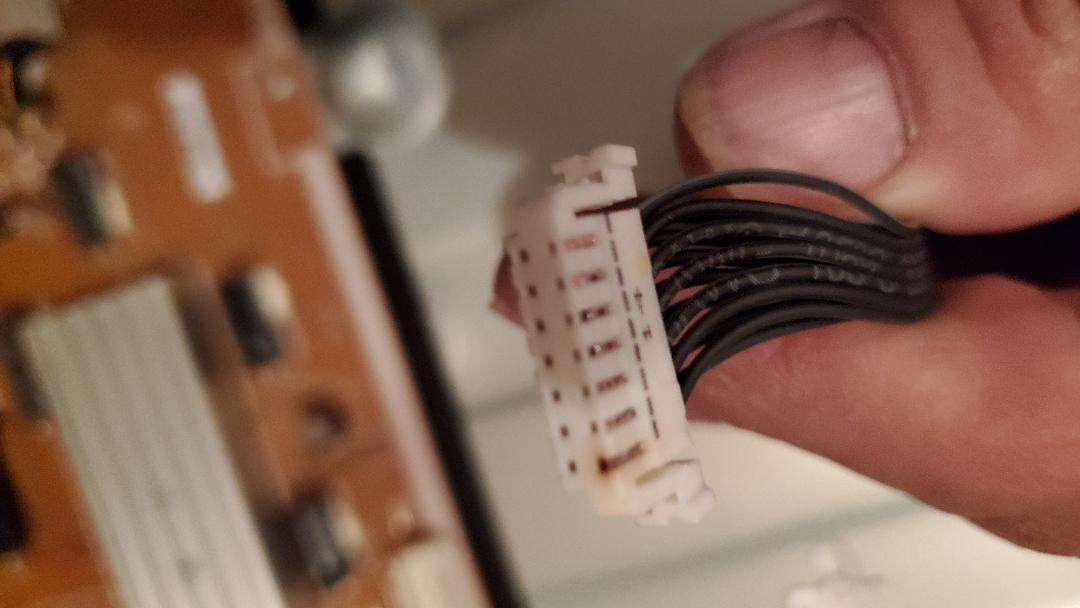

        Re: Samsung un60f6300afxza led light 6 blinks
        Here is a example of what Terryfictv is talking about. On this model I'll disconnect the cable from the power supply first and examine the connector closely for signs of arcing on both the cable and inside the power supply connector. Look at the top left pin on the power supply connector and see if you a sign of brown arcing and also on the cable end too. If it's nice and white I'll reconnect the cable to the power supply and leave the end off the main and then power it up. If the backlights stay on and steady then we found replacing the main board usually takes care of the power cycling issue. If the connector and cable looks brown then I replace both the cable and power supply and that usually fixes the on and off power cycling issue. Here's a couple of pics we found on the arcing issue on this model just like we see on the ES models.
