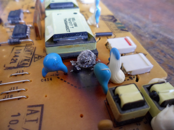

M2762DL backlight wont click on,
  • Miner928
    • Mar 2015
    • 10
    • U.S.A
    Picked up this model, and opened it up seen that it had a bad disk burned up inside.. replaced it and still have no backlight??? anyone had this problem? found a picture with exact problem.
  • Shane711
    • Dec 2014
    • 493
    Re: M2762DL backlight wont click on,
    I know this an old post but here is the solution. Both Caps have to be replaced with 5pf 6.3kv. C404 & C418
    If you can find ones with a higher voltage that would be better but I do not think they make them any bigger.
