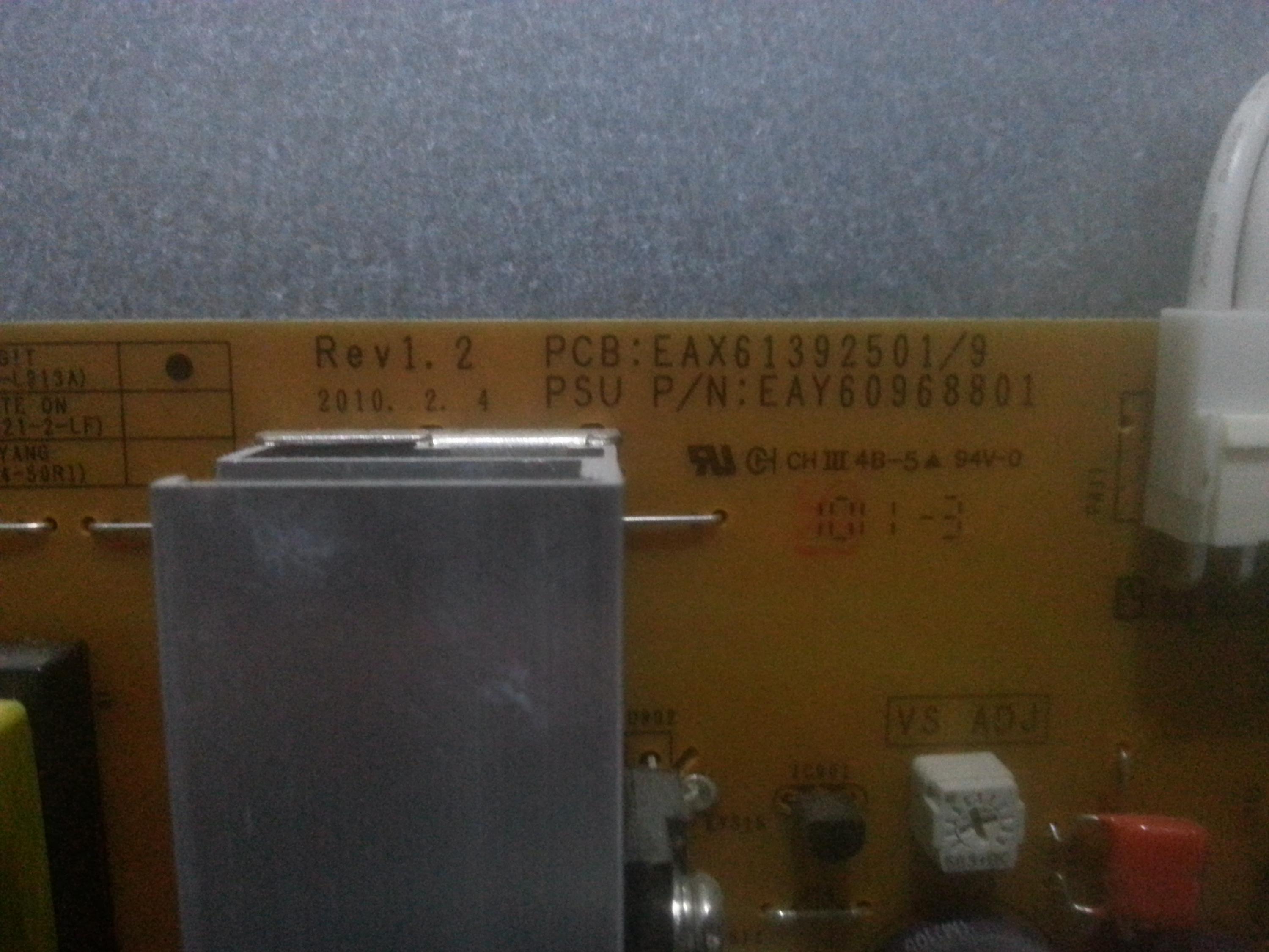

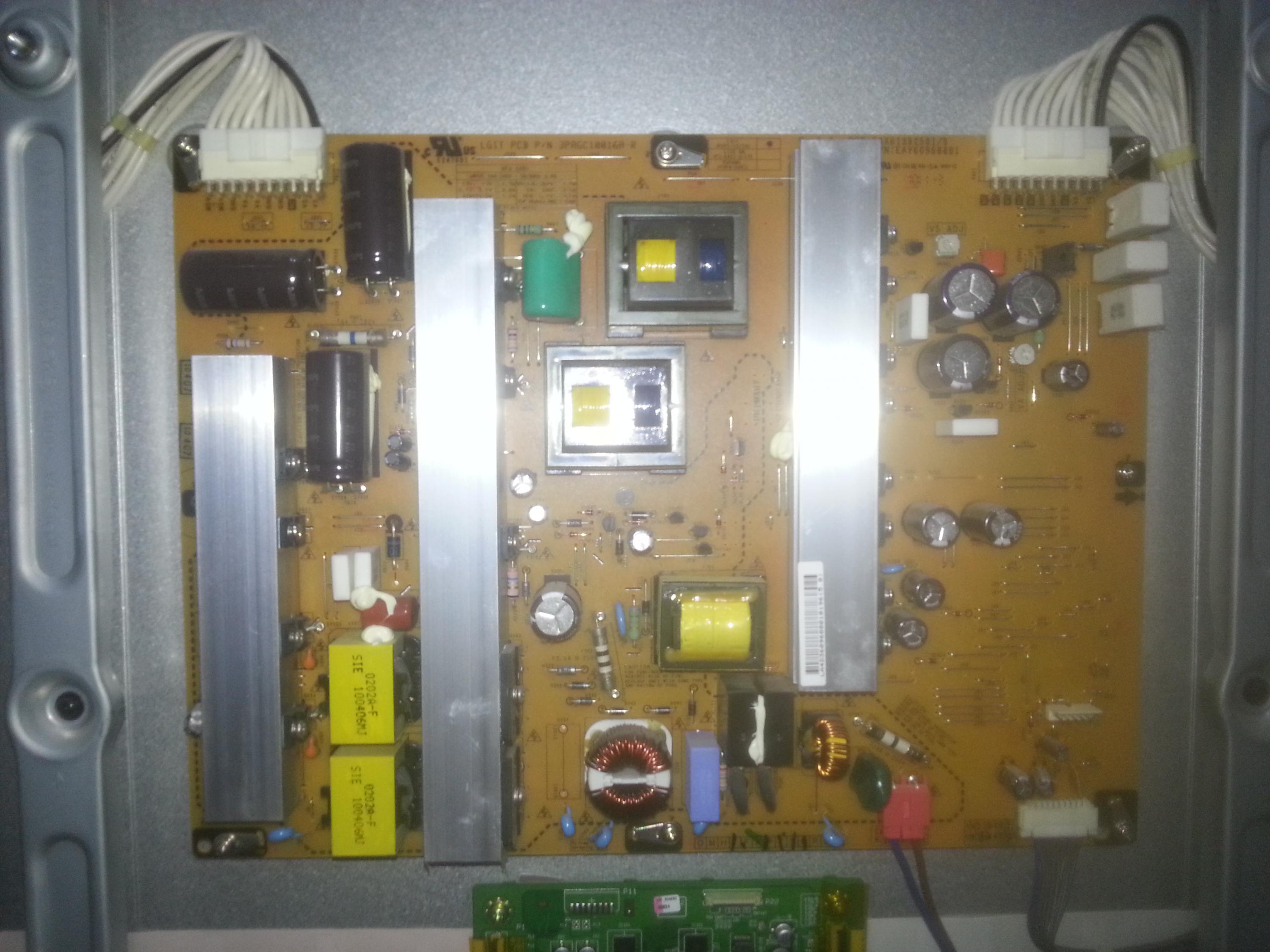

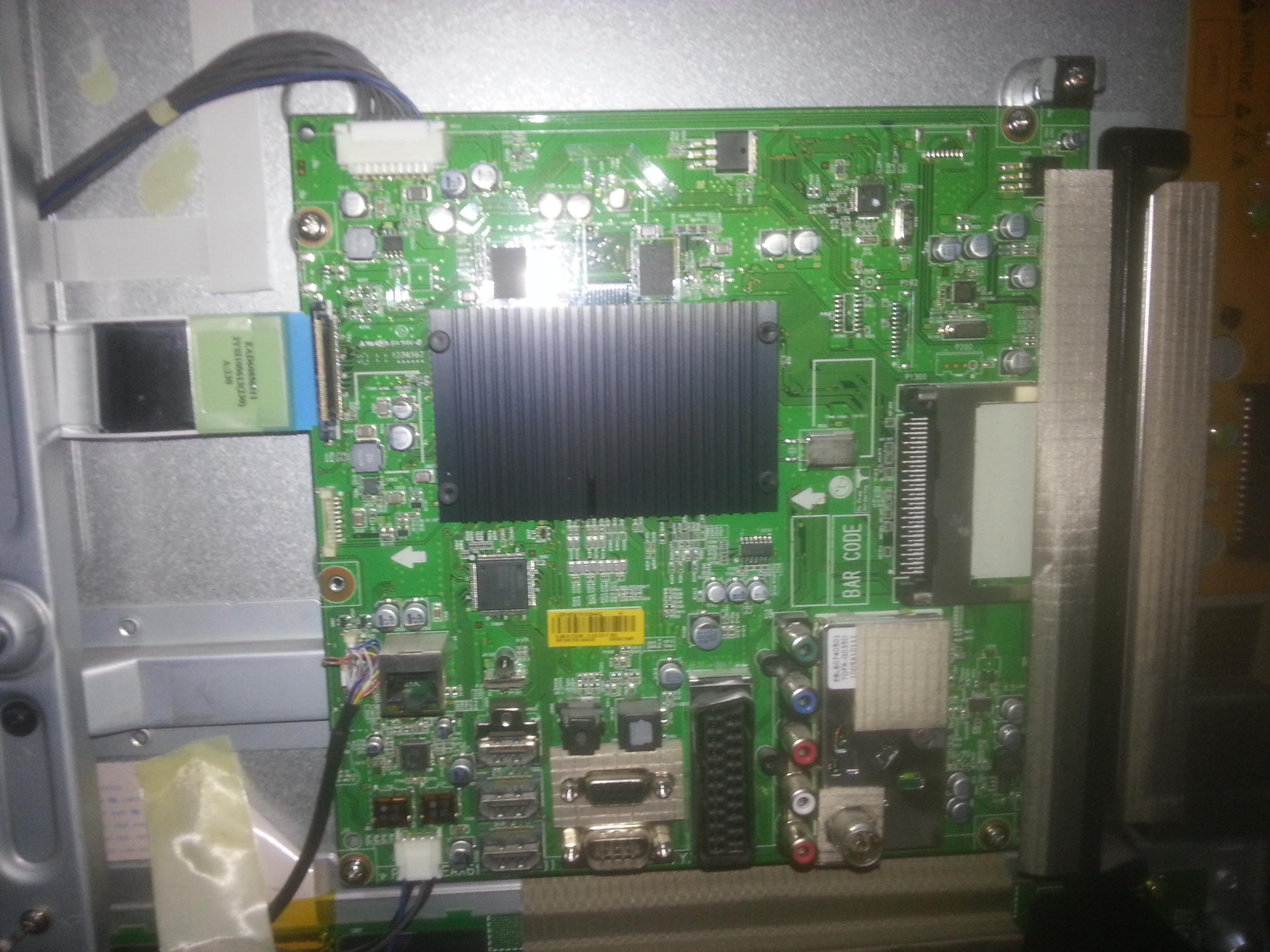

    Hello, i have an LG Plasma here with an EAY60968801 PSU.
    I have read the threads with the same PSU and there is a repair kit i can buy, before i purchase i was hoping someone would confirm, or help me confirm this should sort the problem.
    The standby light comes on when i plug in the TV. When i press the power button on the remote i hear two clicks and the screen flashes white for less than a second then goes off. There is another click and the Tv goes back to standby.
    Thanks.

    firstly you can check various supply voltages such as Vs, Va, VSC, Ve

      Thanks sordids999
      VS=201.4v
      VA=60.9v
      M5V=5.07v
      These seem to be spot on.
      I've just read on the Coppell website, that if all of the cables are disconnected apart from the AC then it is plugged in, a click followed by one or more within a second indicate a faulty PSU.
      I got 3 clicks, so i guess it is faulty.

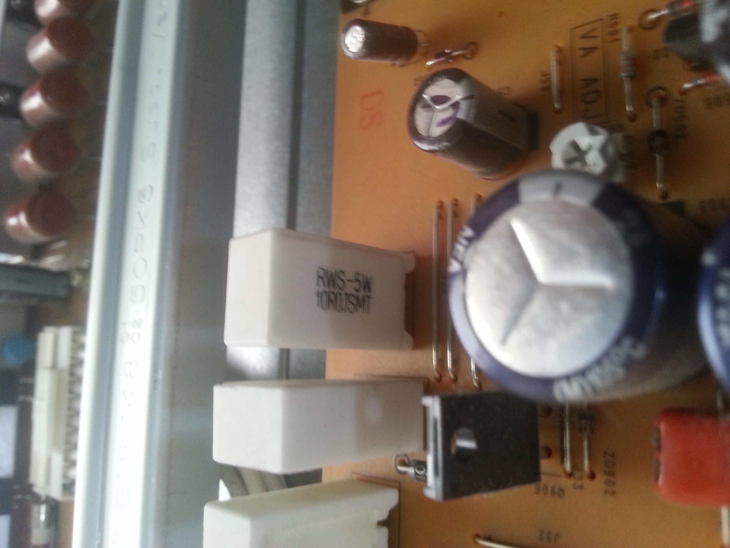

        Check the 3 power resistors in the top right corner of the PSU.
        • Hamie
          • Apr 2014
          • 1383
          Re: Lg 50pk590
          Does the vs and va stay on with the y-sus disconnected?
          • Hamie
            • Apr 2014
            • 1383
            Re: Lg 50pk590
            A good way to test the PSB is to buy a 200w service light bulb (maplins sell them) and solder it to the vs test point and ground.
            Furthermore if the 5watt resistors test good ive not heard many other types of failure for this PSB. Personally I've never seen the diode or ic go bad.

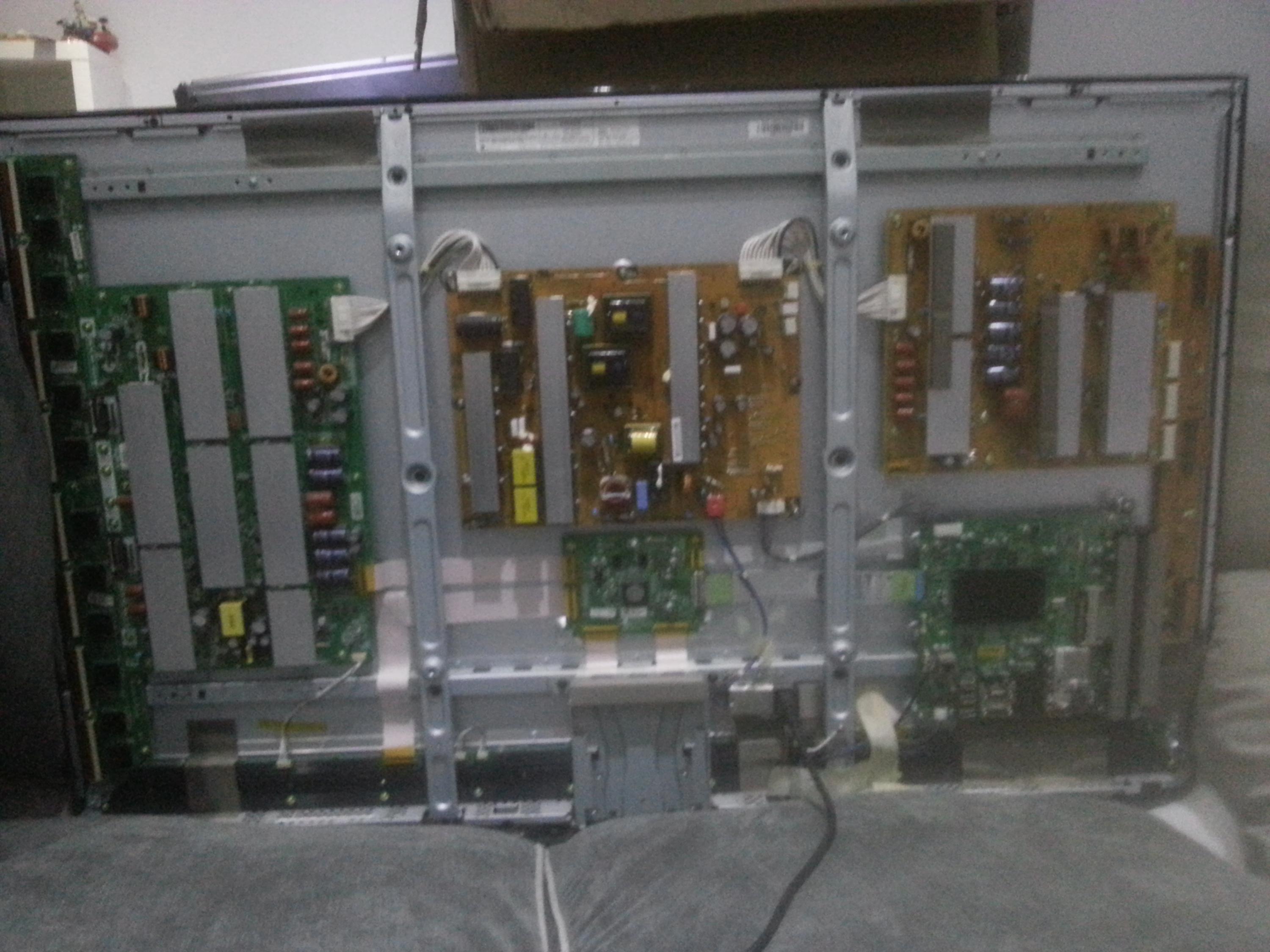

              Thanks guys, I've just measured the three resistors and get 10.5, 10.4 and 10.2 ohms.
              Is the y-sus the board on the left ? this is my first plasma i have worked on.

                I take it those measurements are in circuit?

                  With the Ysus disconnected does the vs and va stay on in the power supply?

                    Yes i measured in circuit. I then removed one from the board and got the same.
                    So i connect the Zsus but leave the Ysus disconnected, then check the VS VA ?

                      Yes remove the ysus, plug the x back in and power on.

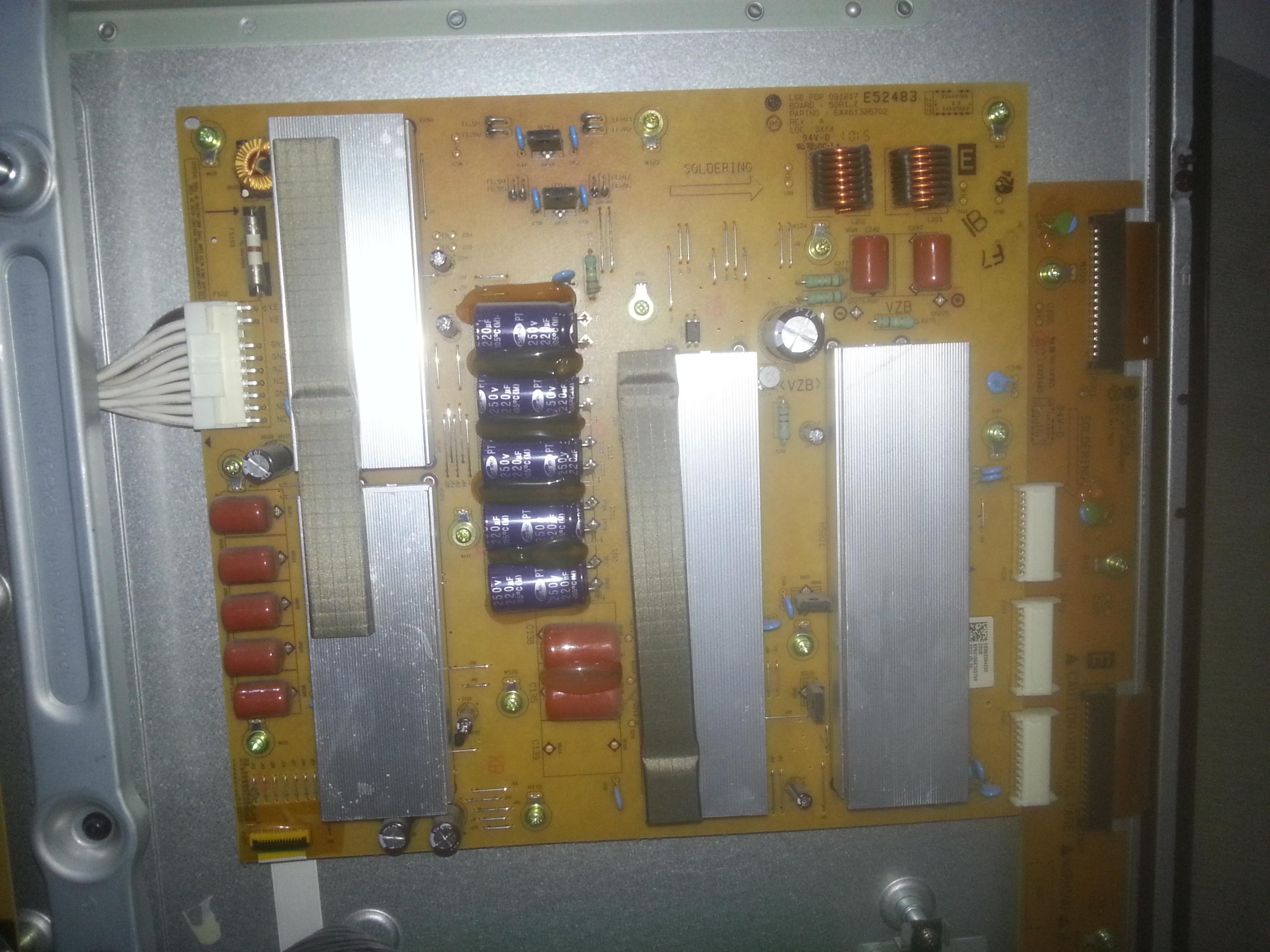

                        Thanks Hamie, i am a little confused now. I have identified the Ysus and Zsus, which is the x ?
                        • Hamie
                          • Apr 2014
                          • 1383
                          Re: Lg 50pk590
                          Sorry z is the x.
                          • diif
                            • Feb 2014
                            • 6978
                            • England
                            Re: Lg 50pk590
                            Thanks Hamie, yes VS and VA still present with just the Zsus connected.

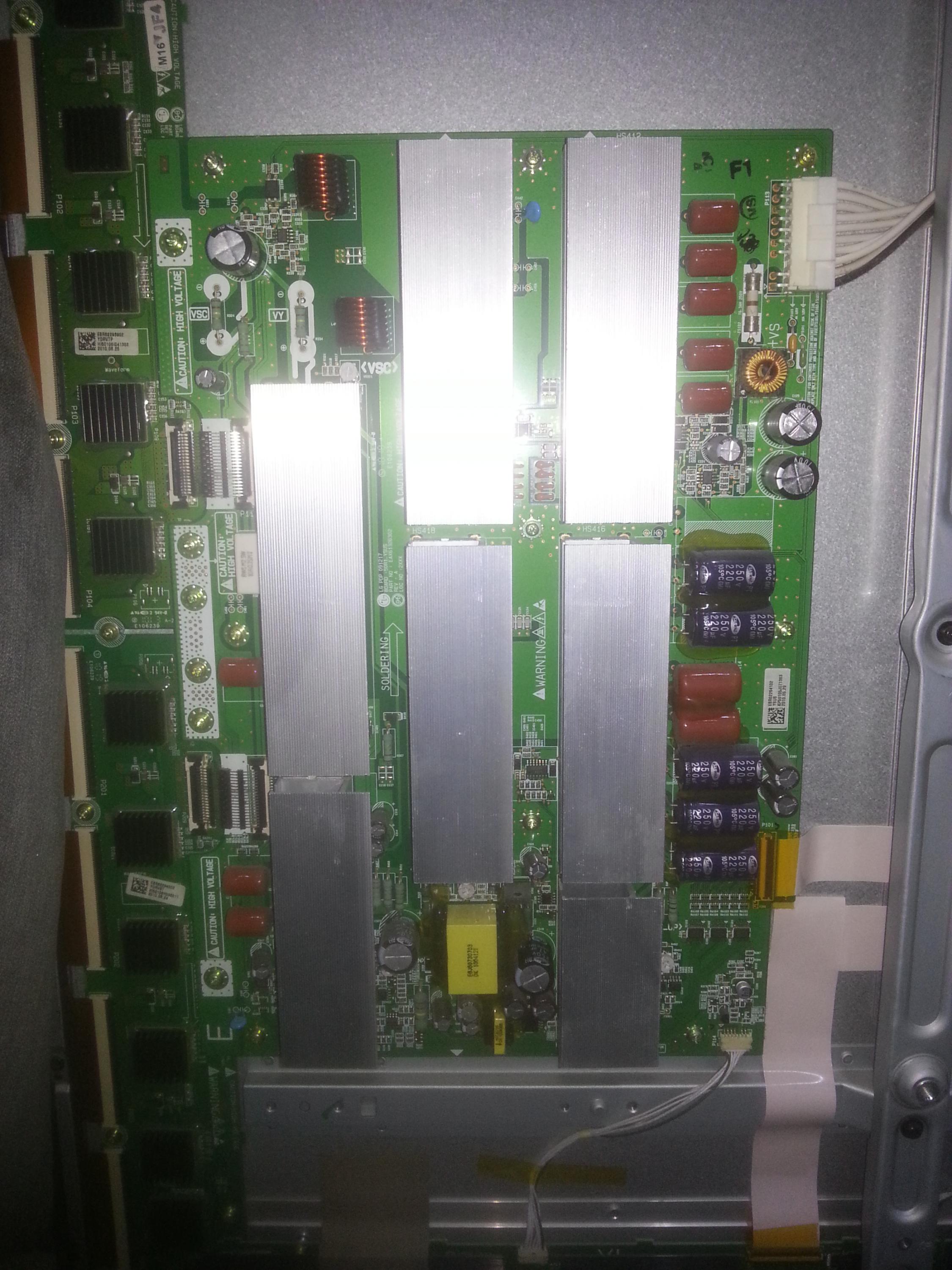

                              Ok finally disconnect the buffers from the ysus and power on.
                              • diif
                                • Feb 2014
                                • 6978
                                • England
                                Re: Lg 50pk590
                                Thanks, I appreciate your patience Hamie, buffers ? the big long board with the ribbon cables ?
                                Zsus still connected or just the Ysus with buffers disconnected ?
                                • Hamie
                                  • Apr 2014
                                  • 1383
                                  Re: Lg 50pk590
                                  Yip everything now connected apart form the buffer boards that connect to the ysus.
                                  • diif
                                    • Feb 2014
                                    • 6978
                                    • England
                                    Re: Lg 50pk590
                                    Cheers, VS and VA still present.
                                    • Hamie
                                      • Apr 2014
                                      • 1383
                                      Re: Lg 50pk590

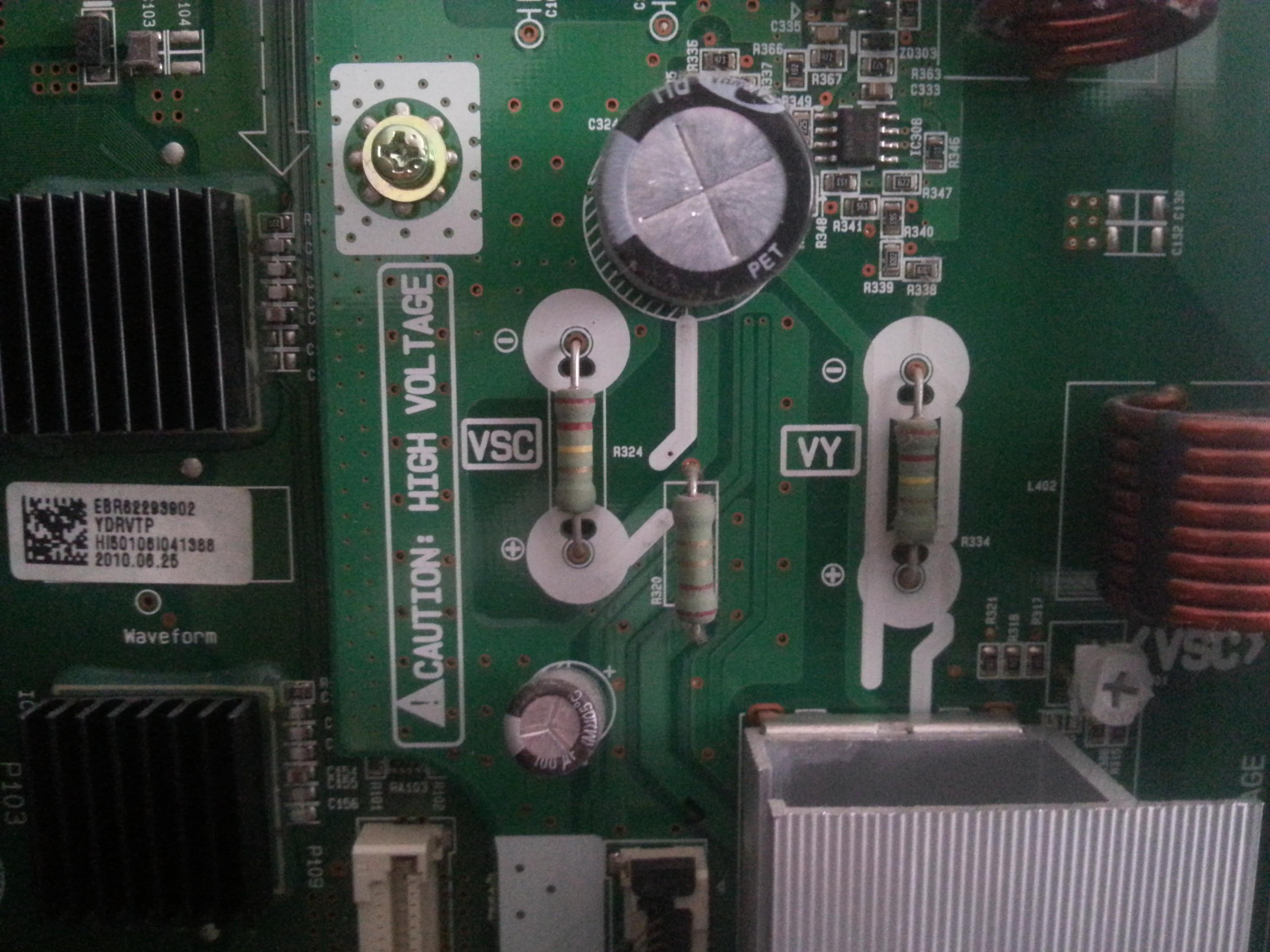

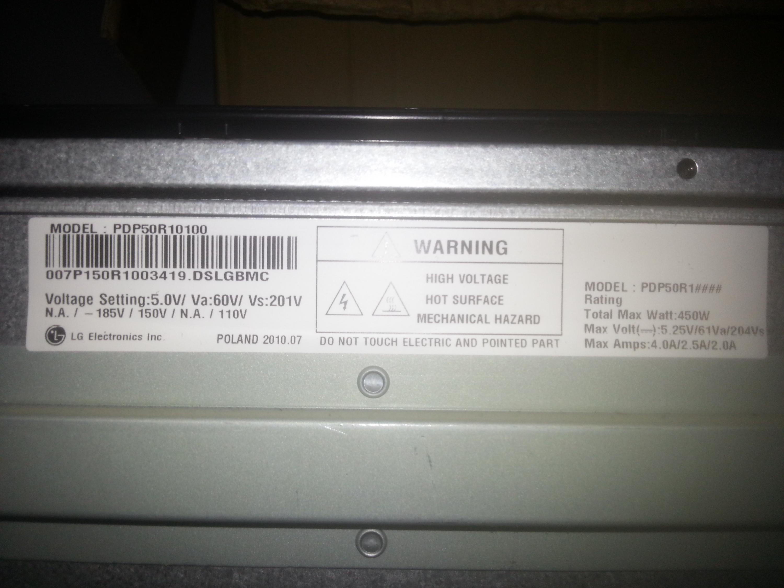

                                      Ok check vsc, -vy, and zbais
                                      They should match your panel sticker.
                                      Like this.
                                      Vsc, and -vy are located on the ysus.
                                      Zbais on the zsus.
                                      -vy is measured sometimes across a resistor, but is marked with + and -
                                      All in dc volts.

                                        With or without the buffer connected ?
                                        i did see those on my sticker and wondered where the points were.
