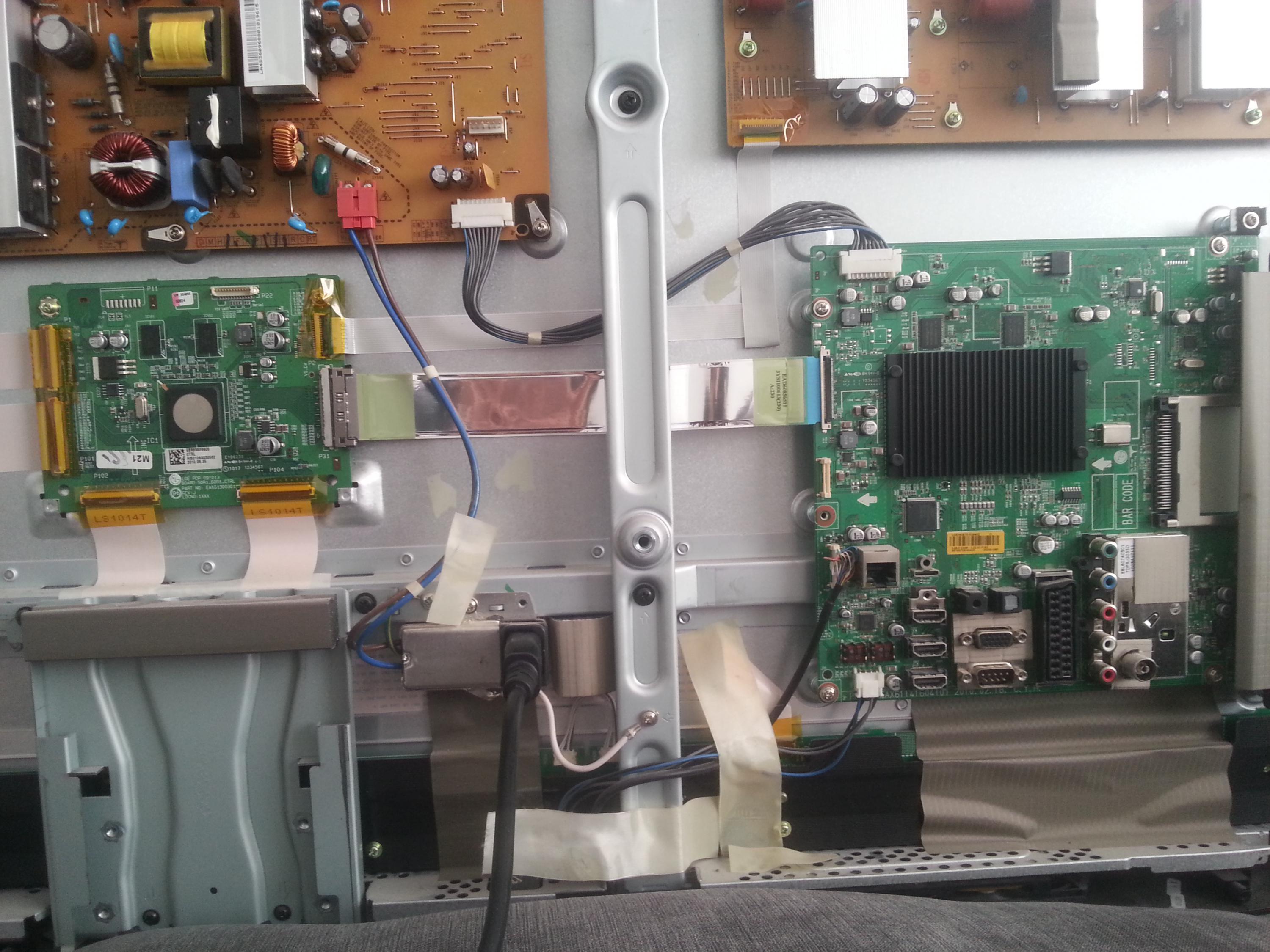

      Re: Lg 50pk590
      -vy = -185.3v
      vsc = 151.1v
      Zbias = 109.8v
      Similar results with the buffer connected.

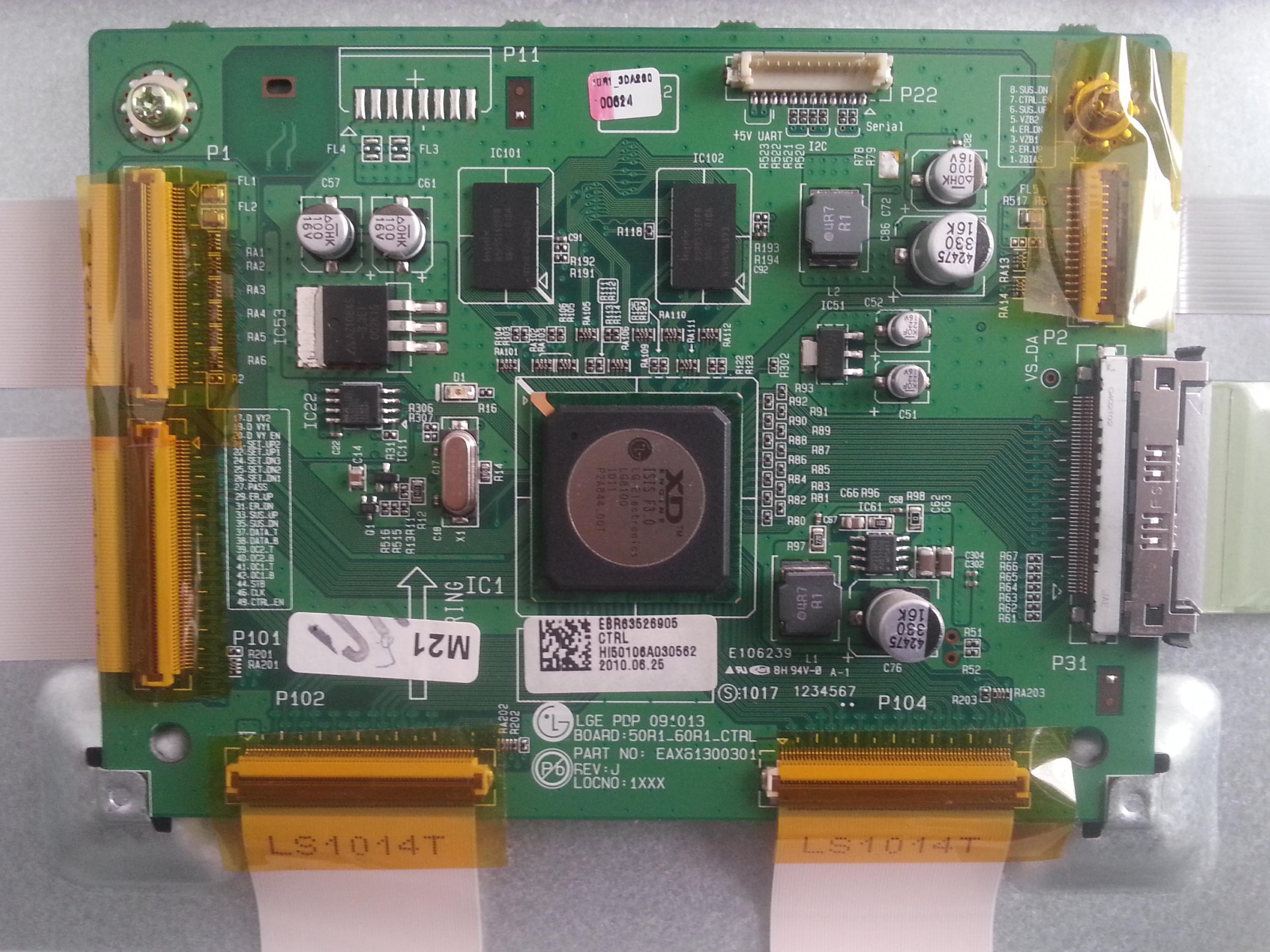

                  Re: Lg 50pk590
                  Ok is the panel glowing?
                  Is there an LED light on the small control board?
                  • diif
                    • Feb 2014
                    • 6978
                    • England
                    #29
                    Re: Lg 50pk590
                    The panel glows for a split second when i take it out of standby but then goes back to a dark screen.
                    The LED is flashing, long flash then short, then a pause and repeat.

                      Re: Lg 50pk590
                      Ok disconnect the LVDS cable from the main board and control board.
                      Then locate 2 holes marked ext auto gen on the control board an put a wire jumper across them.
                      • diif
                        • Feb 2014
                        • 6978
                        • England
                        #31
                        Re: Lg 50pk590
                        The LVDS cable being the silver one going left to right ?
                        I am struggling to find the 2 holes you mention.

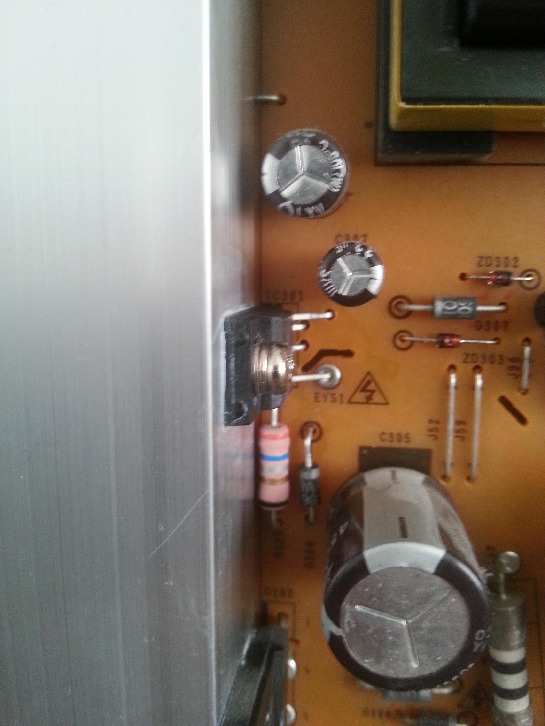

                                  Re: Lg 50pk590
                                  Found this so might be a idea to check
                                  One typical failure symptom of a failed power supply board is a TV that has a standby power, but upon attempting to turn TV on it clicks on and quickly back off, never actually turning on and staying on.
                                  An open fuse F302 or shorted diode D304 (located on the right side of heat sink HS2 toward the middle of the board)
                                  At the time of this listing's creation the kit contained 1 fuse (F302), 1 diode (D304) , two power resistors (R927, R929) and the IC301 voltage regulator IC.
                                  Contents may change as we gain more experience and see other commonly failed components and this listing may not necessarily be timely updated

                                    Re: Lg 50pk590
                                    Now it is dark, i can see a feint glow from the screen.
                                    I have just checked the diode and fuse and they are ok, so i've ordered an ic and i shall see what happens.

                                      Re: Lg 50pk590
                                      I have replaced the ic this morning, however i still get two clicks, the panel is white for half a second then dims.
                                      The LED on the control board has a different flash pattern now, 3 short followed by a long one.
                                      Whilst i am looking for some documentation to identify this flash code, can anyone shed any light as to what it indicates ?

                                          Re: Lg 50pk590
                                          I bought a replacement part IC301. It was the only part in the repair kits i hadn't tested as i was unsure how.
