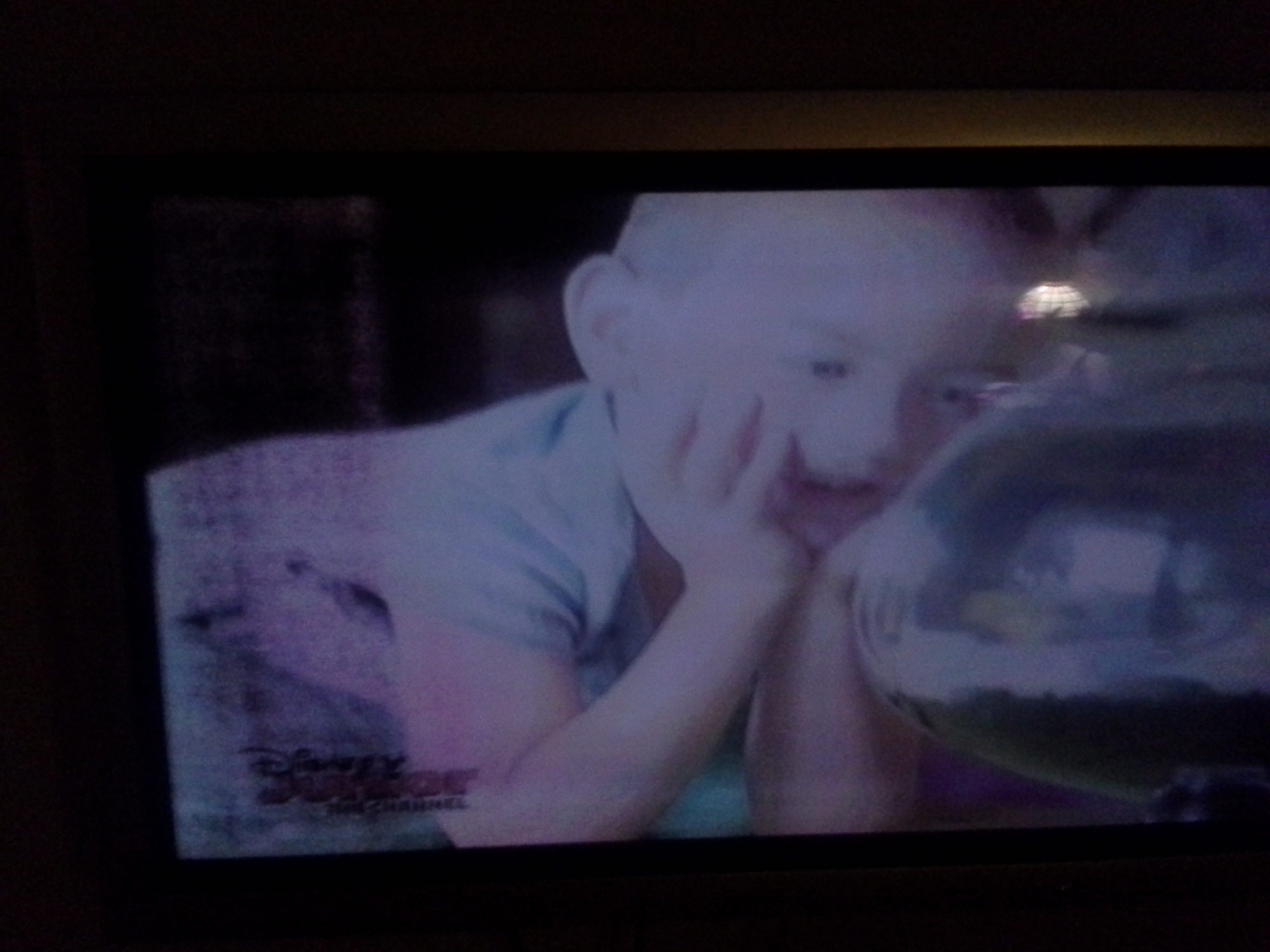

    Okay people I have been through tom66 troubleshooting for plasma tv
    Will post a picture if needed but I have no voltage on the vs side of the power supply
    My question is I have a picture that is viewable at night but very dim in the day
    I had to turn the brightness down to even view the picture
    Would a bad power supply cause this

    First picture is the tv screen

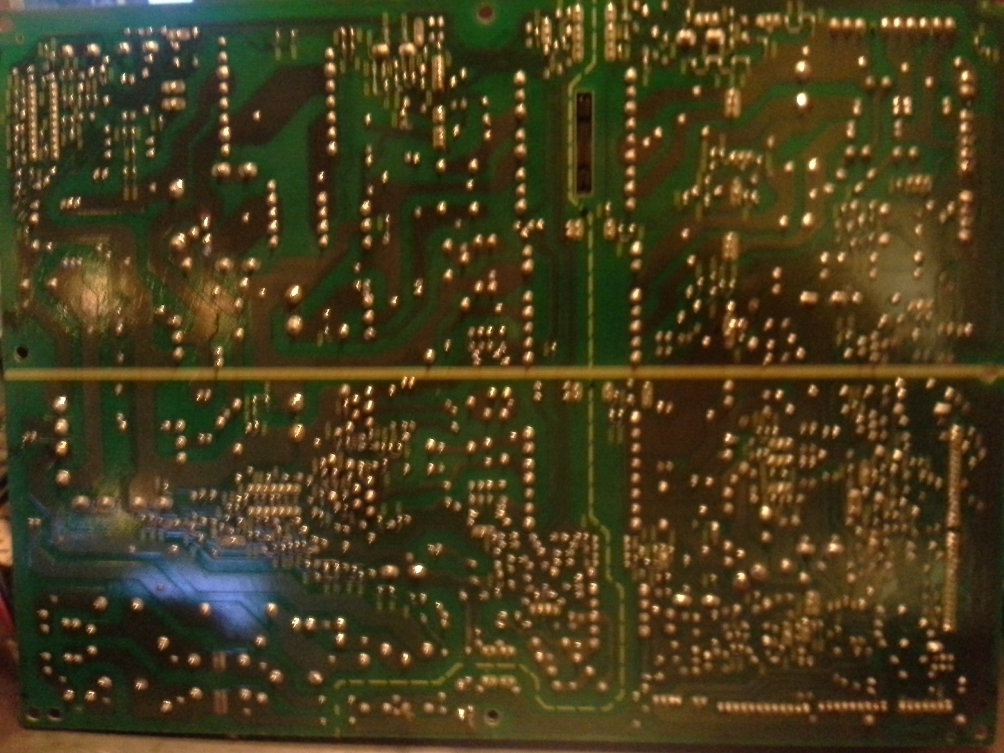

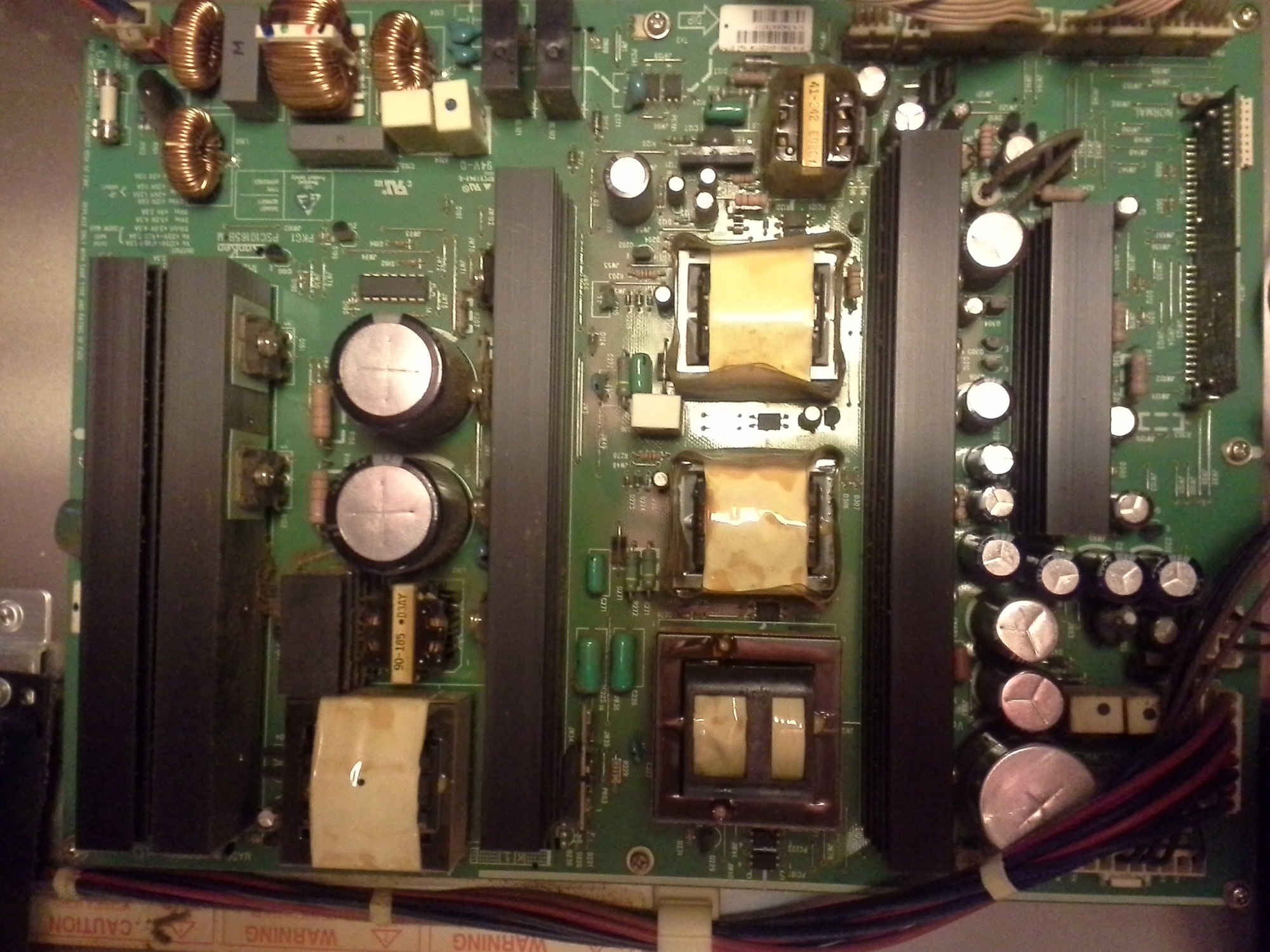

    Second is the top of the power supply
    and the third is the bottom of the power supply

      1st you will need to verify your SMPS voltages to the sticker in found on the inside of the panel.
      I suspect this is a bad X/Z board as the picture looks very washed out and faded.

        Re: Viore pdp42v18ha
        vs voltage was a touch low at 185
        now set as per sticker at 186
        vd voltage spot on at 60
        5v is showing 4 volts
        The reason for not showing any voltage last night
        Replace batteries in multimeter
