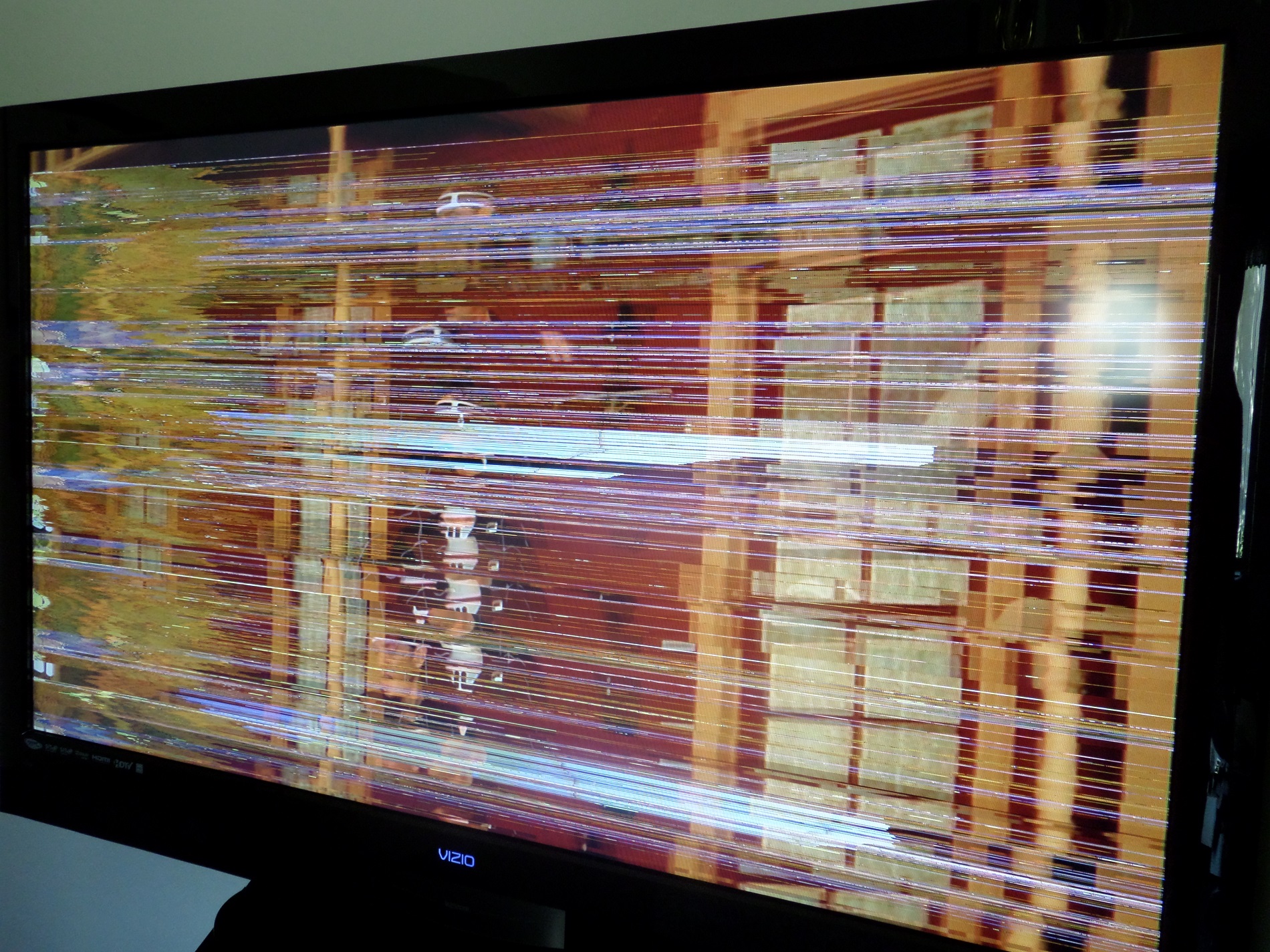

    I have a Vizio XVT553SV, I got this from my daughter and son-in-law. I'll cut to the chase:
    1) TV turns on, great picture and sound
    2) Then 90-120 minutes on, screen flickers, horizontal lines appear (see pics), some popping and cracking heard
    3) Turned off, waited 30-45 seconds, tried to turn back on, splash V appears, no picture but do have sound
    4) Left TV on, after about 45-60 minutes, picture appears and looks great
    5) After 10-15 minutes, picture goes black, but sound is still working
    I am very willing to follow DETAILED instructions on how to trouble-shoot the boards.

      Re: Vizio XVT553SV
      Heya
      When you say pop and crackles as in electric type sound of shorting?
      When you leave the set off for a while and repeat the above do you again hear pops and crackles? From speaker maybe?
      If so looks to be the main at fault but not 100% sure, let one of the other guys chime in

          Re: Vizio XVT553SV
          Ok so sounds like something fried.
          Sniff test... Do any of the burns emit a burnt smell?
            Re: Vizio XVT553SV
            Did that (smelled/sniffed), no odor that would point to it being fried.

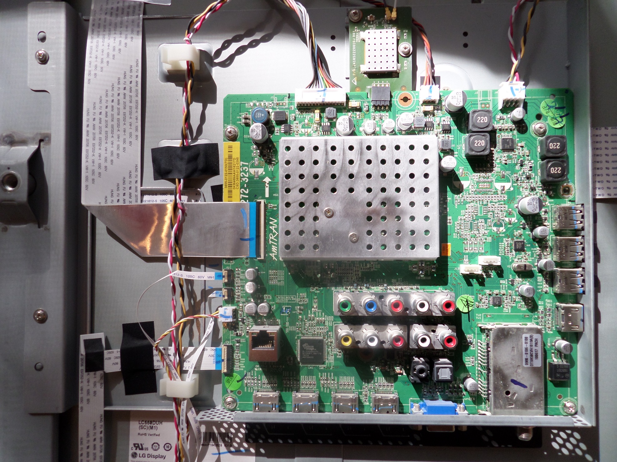

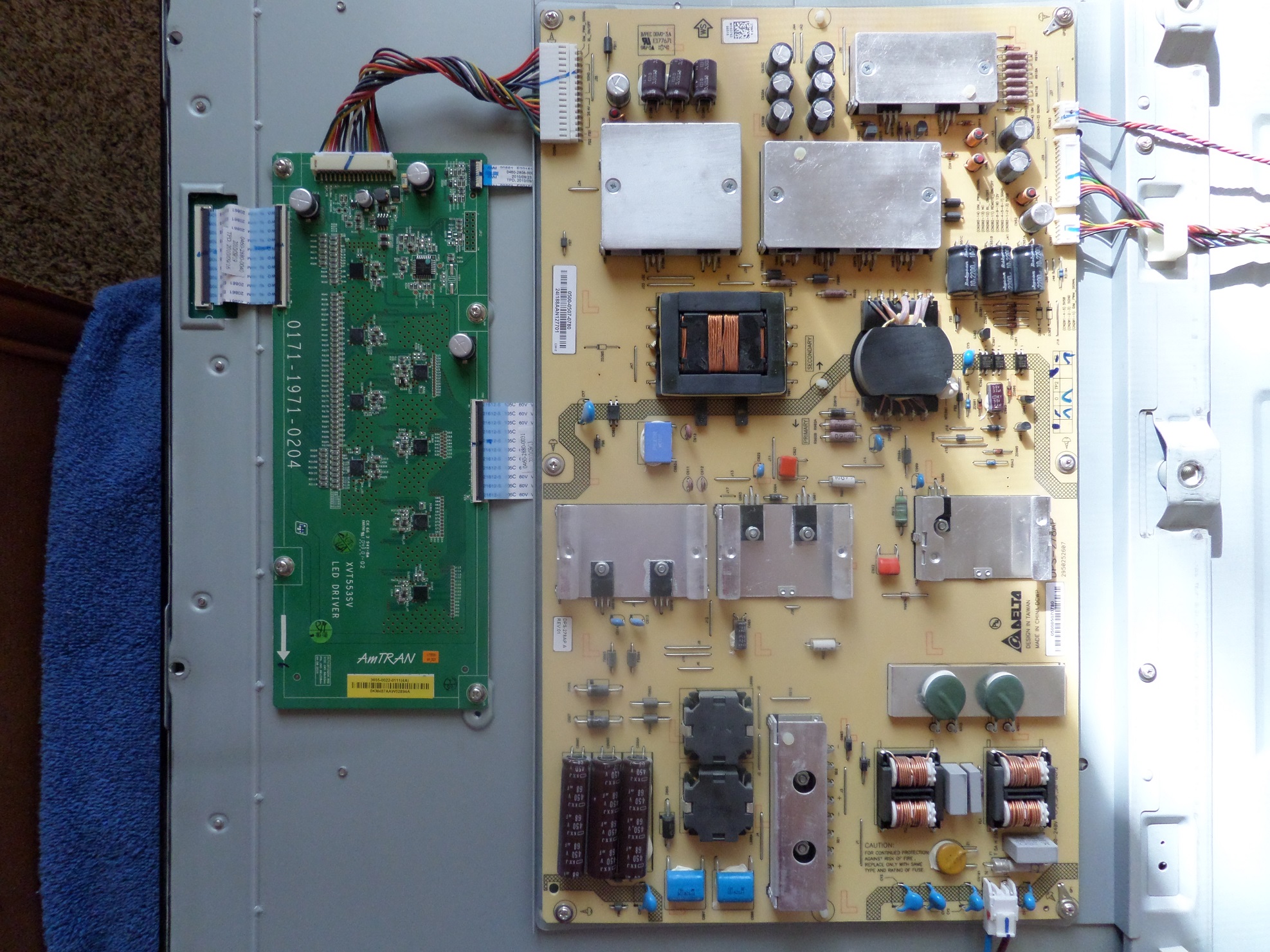

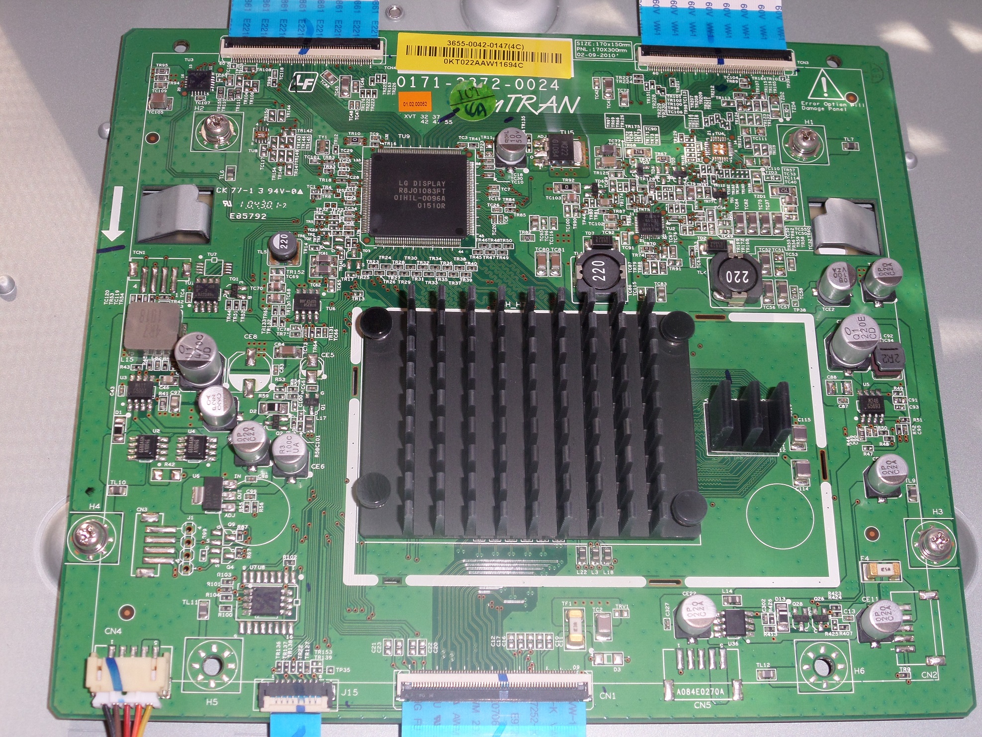

              Check underside of the boards for any visual discoloration.
                Re: Vizio XVT553SV
                All boards? It'll take awhile...
                  Re: Vizio XVT553SV

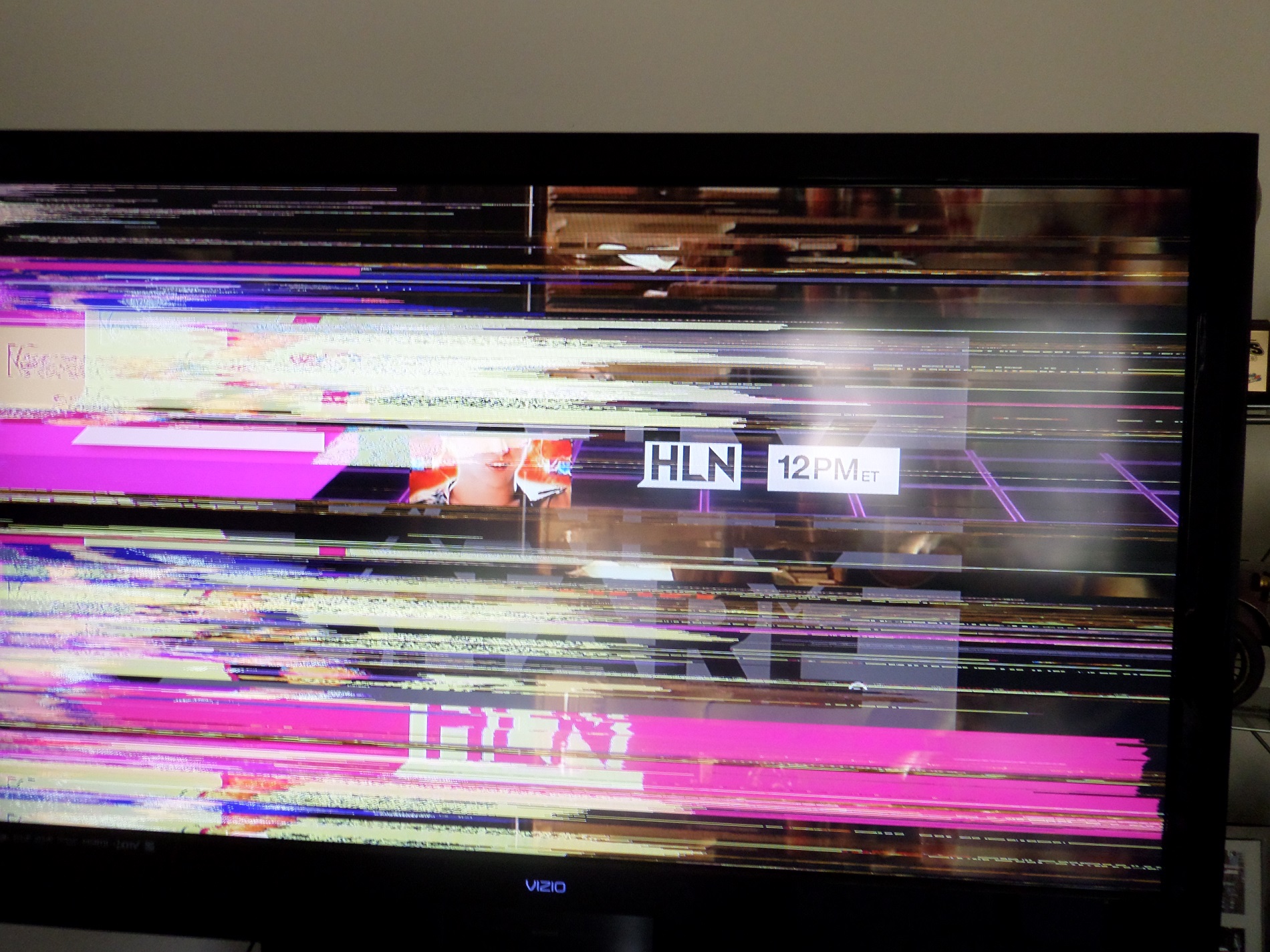

                  Maybe a bad solder joint? Since it takes 90-120 min for the flickering, etc to appear, try heating each board with a hairdryer to accelerate the process. This might help isolate which board is causing the problem. I'd start with the mainboard first.
                    Re: Vizio XVT553SV
                    Had all boards out and inspected, used magnifying glass to get the best view possible (old eyes?), nothing to note.
                    Put boards back in, went the hair dryer route, when TV was first turned on (before using hd), TV was already flickering with horz lines. Used hd to try to knock picture out, no success.
                    At this time, TV still playing with horz lines (110 minutes).

                          Re: Vizio XVT553SV
                          Final follow-up, replaced Main Board- part #3655-0122-0150. Fixed problem, picture looks great.
