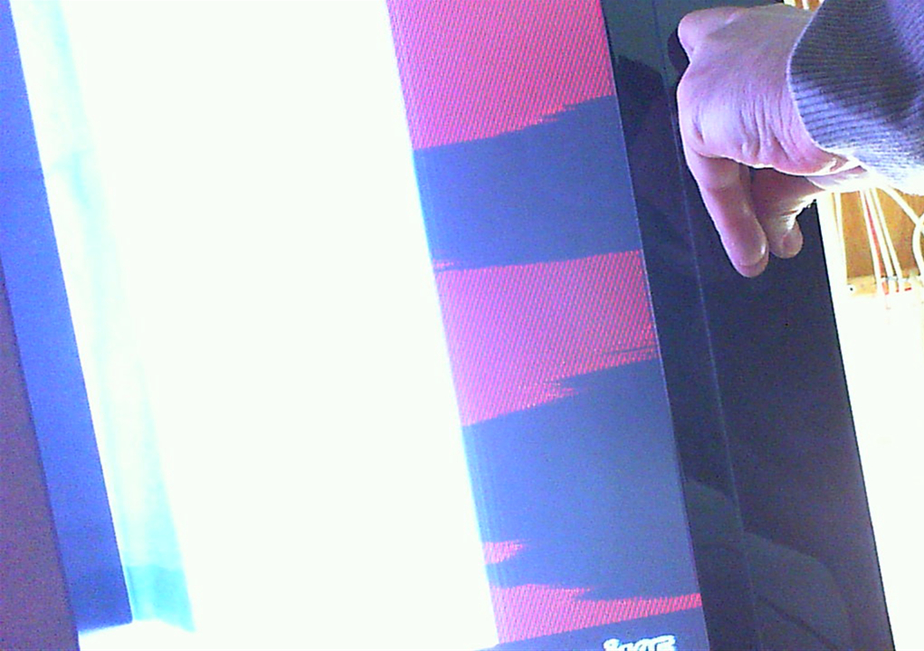

    LVQ40HLA visionquest smeary red picture LTA400WH-LH2
    Does this look like a TCON failure?
    Panel is not sensitive to bending, nothing is sensitive to temperature changes or vibration. red smears are following the picture content.
  • paulstef
    • Dec 2013
    • 724
    Re: LVQ40HLA visionquest smeary red picture LTA400WH-LH2
    It changes a lot when adjusting brightness and contrast.

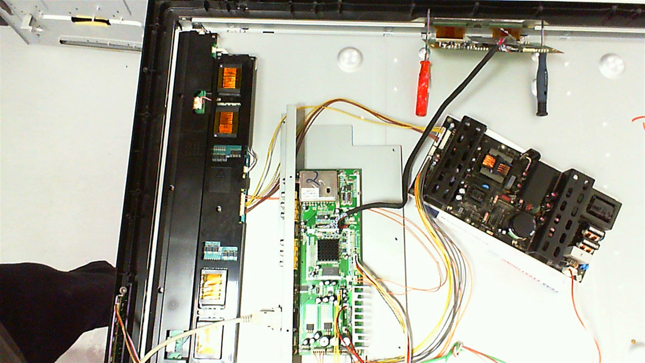

      Actually I think it really is the TCON, I now cooled only the main processor and it gets worse. Must be it. It's a Altera EP1S30F780C8N.
      • paulstef
        • Dec 2013
        • 724
        I put some flux under the Altera and heated it to 210C on a hotplate and voilà, it works again. Must have been some of the balls becoming loose. :-D
        It`s a cheapo LCD TV but still better than the old plasmas...
