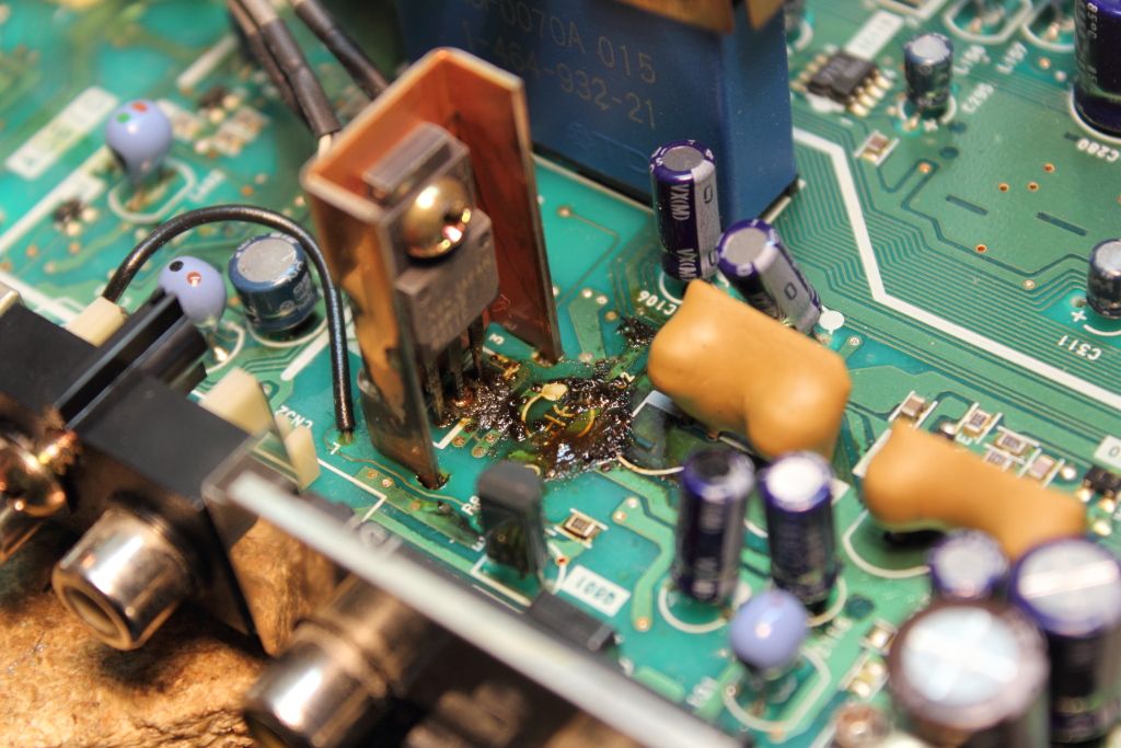

    Opened it up to see why the laser assembly was not parking right (there's a switch going iffy somewhere and it just makes an awful racket). Player otherwise worked fine.
    Wasn't expecting this at all.
    Wowza!
    Not the problem I came in to fix, but a problem regardless.

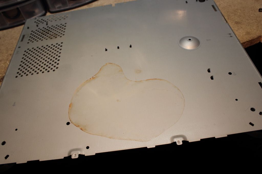

    Wait, so is the stain on the case all from the electrolyte of the cap? Or did someone spill something, causing over-voltage of the PSU, thus making the cap bulge and leak?

      It's all leakage from that one cap. All the damage circles around that cap on both sides of the board, and on the bottom plate as it dripped down.
      I've never seen that before.

        It's possible they are faulty from the manufacturer. Like the nichicon PF and PL series. I've seen them leak first-hand. Must be a faulty seal design or something to that effect. They smell like vinegar.
        Note, there is this thread from quite a while ago:
        https://www.badcaps.net/forum/showthread.php?t=4405
