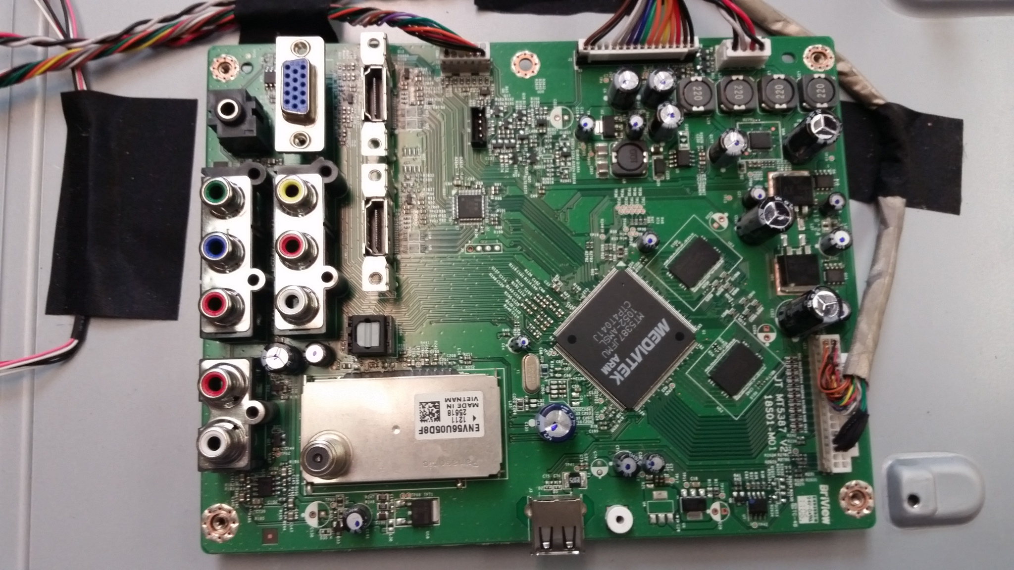

    toshiba 32SL410U
    OK i have this tv, wont power voltages in conectors cn2 and cn3 psu are ok, i already replace the output caps just in case,,, what i found kind of weird is voltages on big fat transistors in logic board go up and down every 2 seconds,,0.7v->3.7v U3 and 0.7->1.2v UD1,,,, any ideas,,anyone have the diagram ??

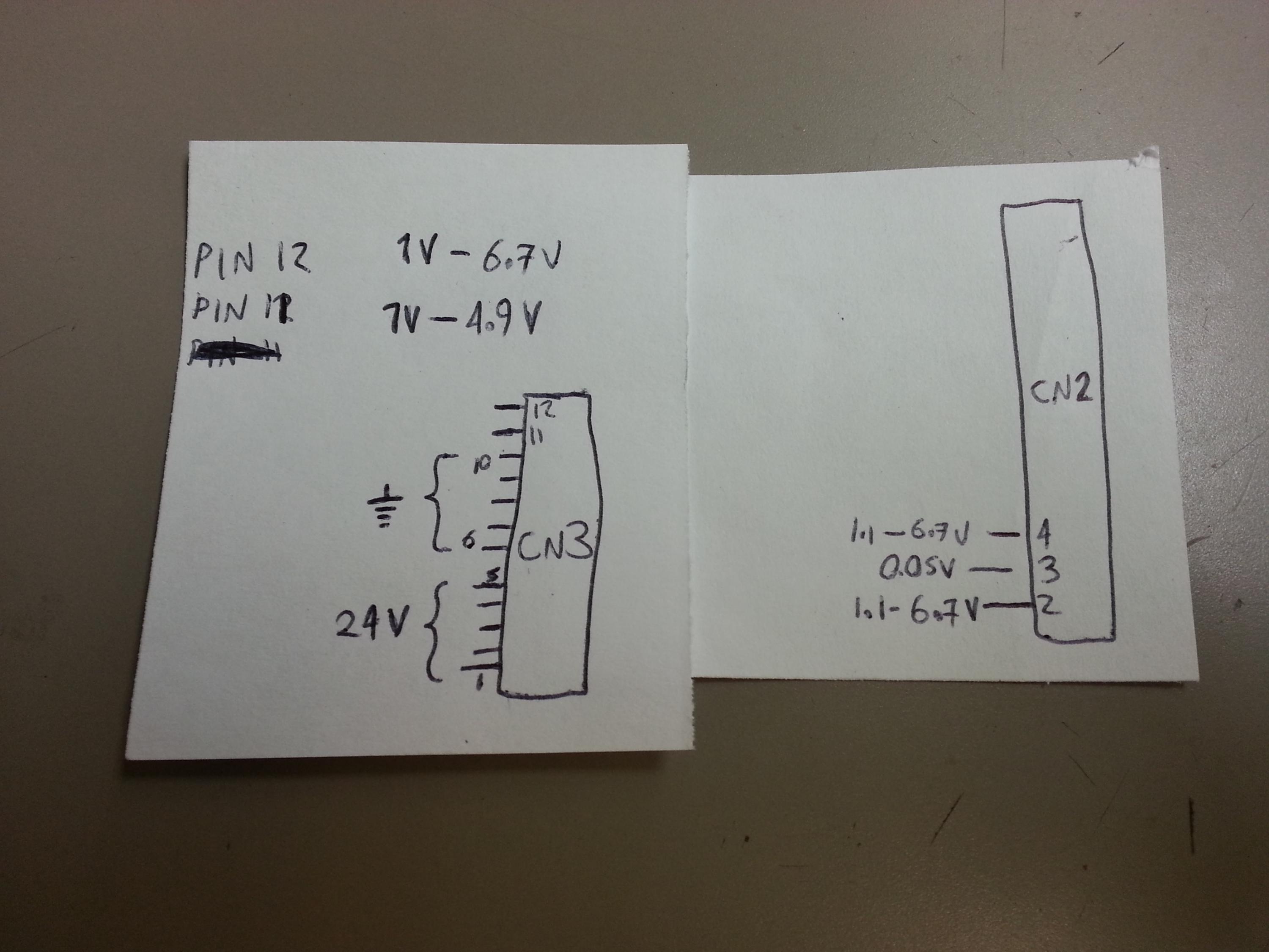

    Can you pleas give us the list of the Voltage reading of the connectors CN2, CN3.
    Please make sure to list each pin names, pin number, follow by the Voltage readings when TV is OFF and when TV power switch is activated.
    For example of what kind of format we are looking for:
    CN2:
    PIN 14:12.0VDC TV OFF = XX Vdc, TV ON = XXXVdc.

      Re: toshiba 32SL410U
      i began to write all the votages and i found most of this going up and down that is why i didnt finish it,, something is shorting the circuit it may be the 2 main transistors or the transformer,,, tv wont turn on therefore i cannot read voltages on and off

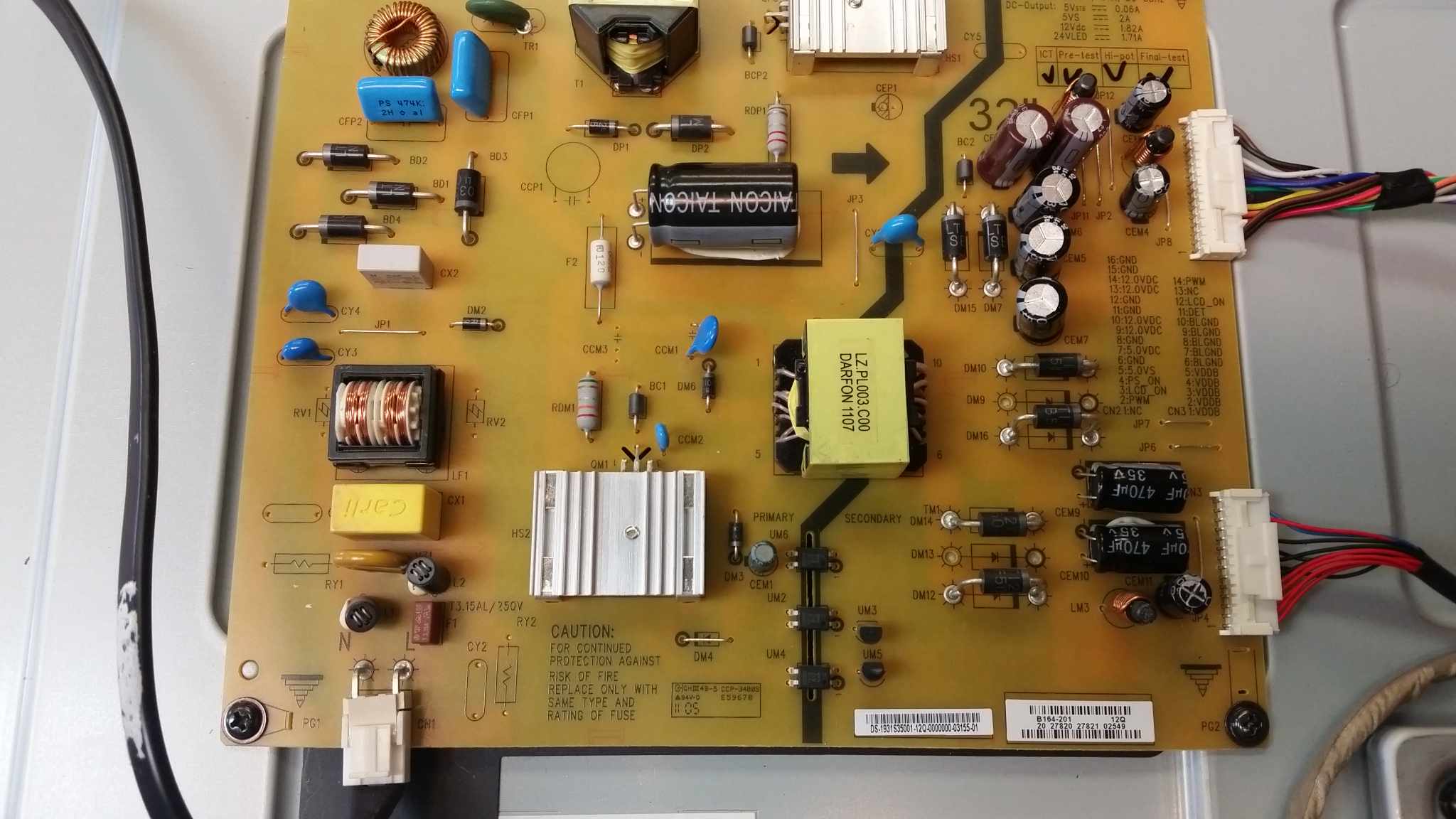

        i already order 01 of the transistors (k3264) but the other one i cant find it,, do you know a compatible FET of p1060atf ?
          The reason I asked the Voltage readings is to find out at least if the STBY power supply is steady or not, if it is not, it will cause other the Voltages to go up and down as well.
          So is the STBY power supply steady?
