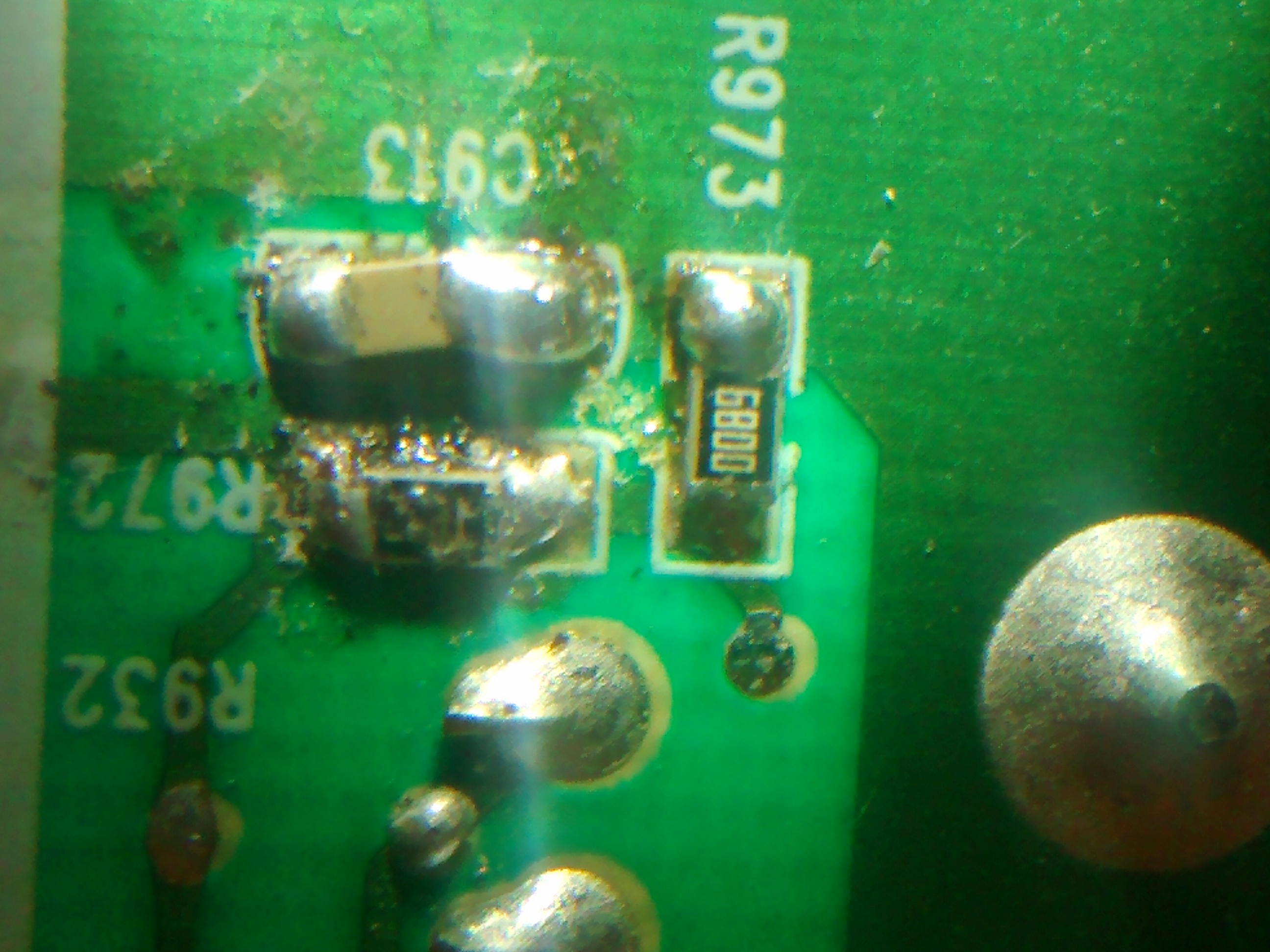

                      So I picked up the same model TV as his showing same issue. TV would not power on with no standby light. When plugged in the unit didnt event have a relay click. Opened it up and went straight to the power board and the capacitor that was bad on his board is the exact same one that is bad on my board. Figured this would be a simple recap the board and this TV would be saved. I flipped the board and found something I had questions about before I ordered the caps. I guess my question would be what are those exactly and how would one test them to see if they are bad. It just looks like a bad spot and that solder is just too shiny or am I wrong? If anymore info is needed please let me know.
                      For future reference did I go upon this correctly as in to continue this thread or should I have started a new one?

                        These are two resistors and a capacitor (You can see on the board it says RXXX (resistor) and CXXX (capacitor)). The resistors are the black ones with numbers, the beige one is a capacitor.
                        The resistors you can test with a multimeter that can test resistance(ohmmeter function). The capacitor you can check if shorted with check-diode/ohmmeter functions, and test the capacitance with a LC meter. You might have to take them out of circuit to get accurate measurements.
                        What you are looking at is a poor soldering/clean-up job. If you wanna fix it, you'll have to take the components off the board, wick the solder off the board, and solder the components back on. Doesn't mean it is at fault, chances are it's working, but whoever soldered there sucks at it.

                          You really think somebody has been in the already and did some soldering ? You would think if they were to find a detail like that they would have seen the cap that was clearly bad. Pretty sure they didn't even consider the power board to be bad cause they told me the only thing they played with was the tcon board. Any chance this was caused by the board itself? As soon as I get home I will test them and see what comes of it. Thank you for your insight on this.

                            BTW, that section you look at is the PFC Voltage booster circuit.
                            So do you get close to 400VDC between the two legs of the main filter cap when TV turned on?
