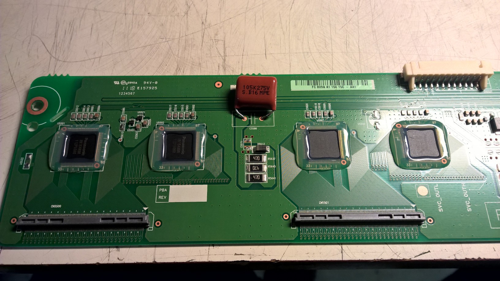

                            Then I measured across the Y-buffers. 20ohms across the red caps...
                            Caps are ok.
                            Driver IC's?
                              Re: Samsung PS51D8005 no picture
                              4th IC on right looks like it has a hole in it.
                              Panel is DEFINITELY not cracked? If so, Y-buffer should fix it. But slightest crack (even right on the edge), that will fry the IC and it won't be fixable.

                                The 4th IC has some of the silicone splashed to it. It looks like a hole though.
                                But I begin more and more to believe the panel are bad.
                                Perhaps the main failure was bad mainboard. During transport the owner managed to crack the screen...
                                  Well, bad Y-buffer on these will cause a black screen and the screen can still be OK. But, it is important to check the panel has not been cracked, causing the Y-buffer to fail.

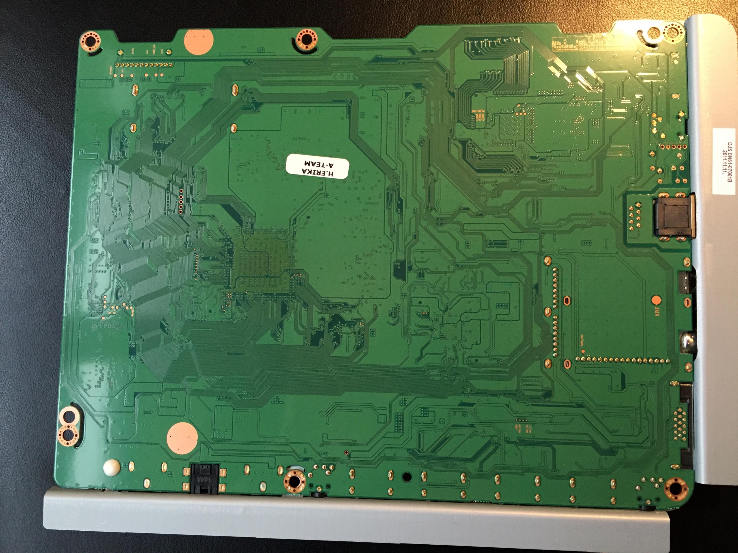

                                        Yet another update and sorry for spamming. Detached the mainboard from the TV and looked it over. Noticed that the area around the main processing unit is yellow/brownish (see attached picture). Is this normal, or is it an identification of a burned out processor?
