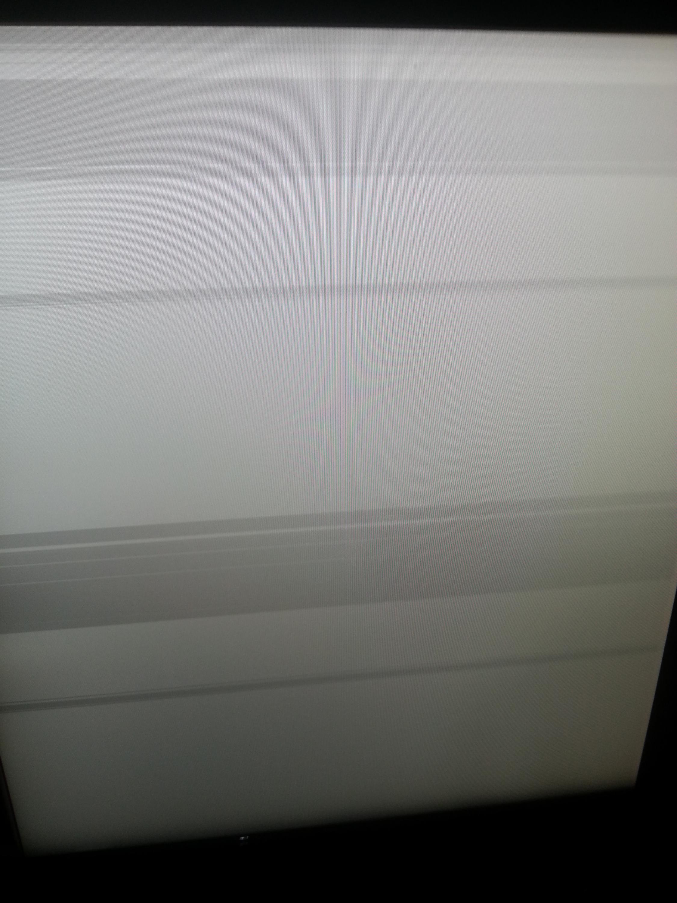

    Hello, does this look like a faulty panel to you ? or something else ?
    The lines show up on all inputs.

    Re: Samsung LE40M87BD faulty panel ?
    Could be the main or the t-con if not then is the panel
      I would say panel.
