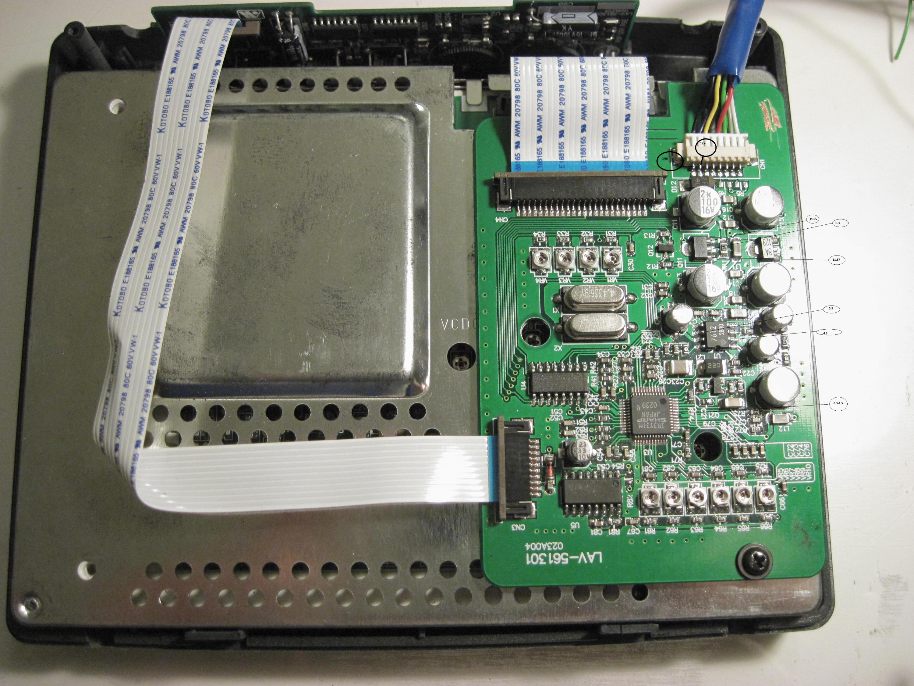

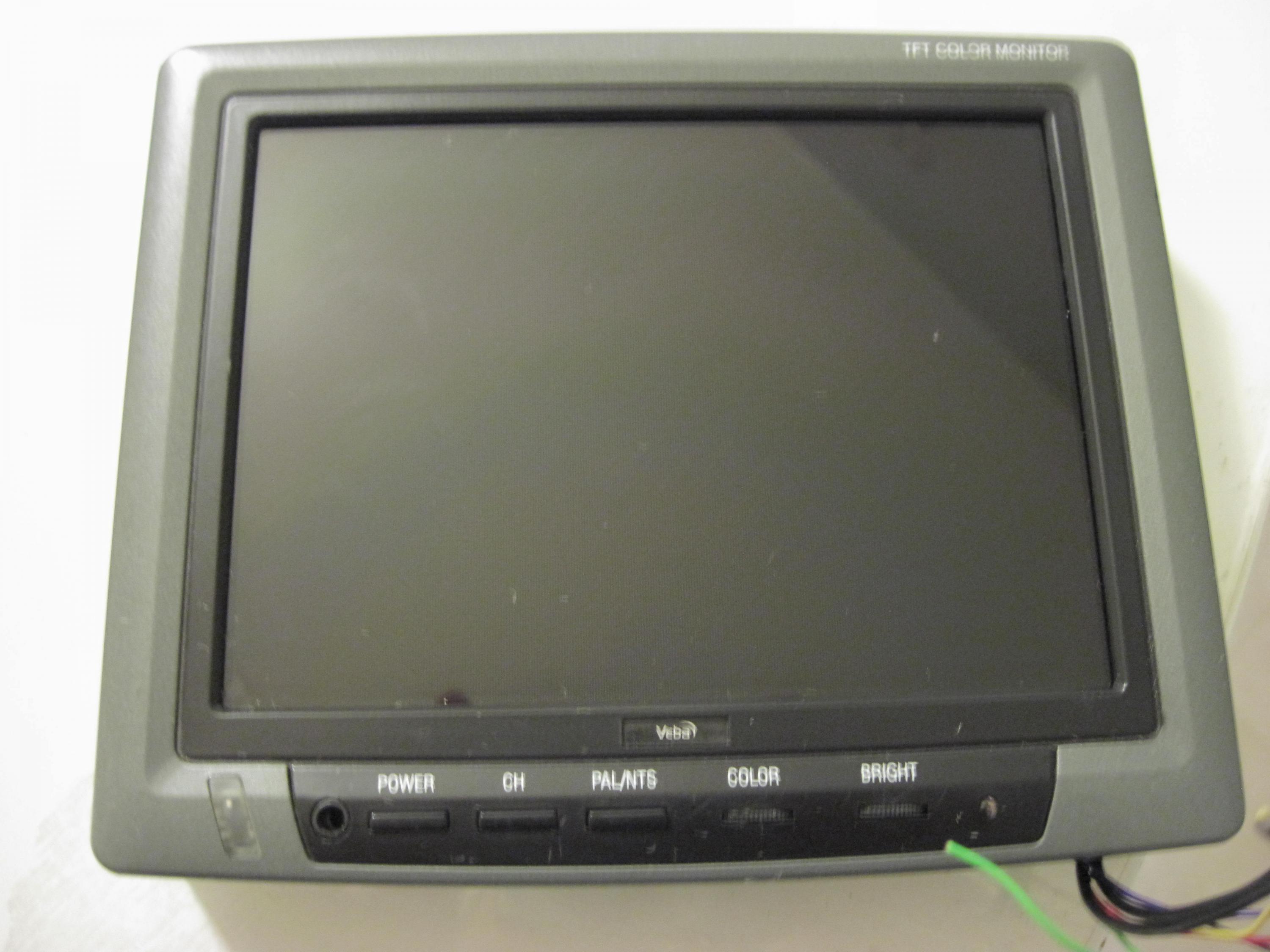

    I have a VEBA TFT color monitor with S/N RTD7 105748-p
    The device doesn't power on. Any schematic out there or advice. The first circuitry marked as LAV-561301 with bigger sized figure, beneath stand
    023A004 with a bit smaller sized figure.

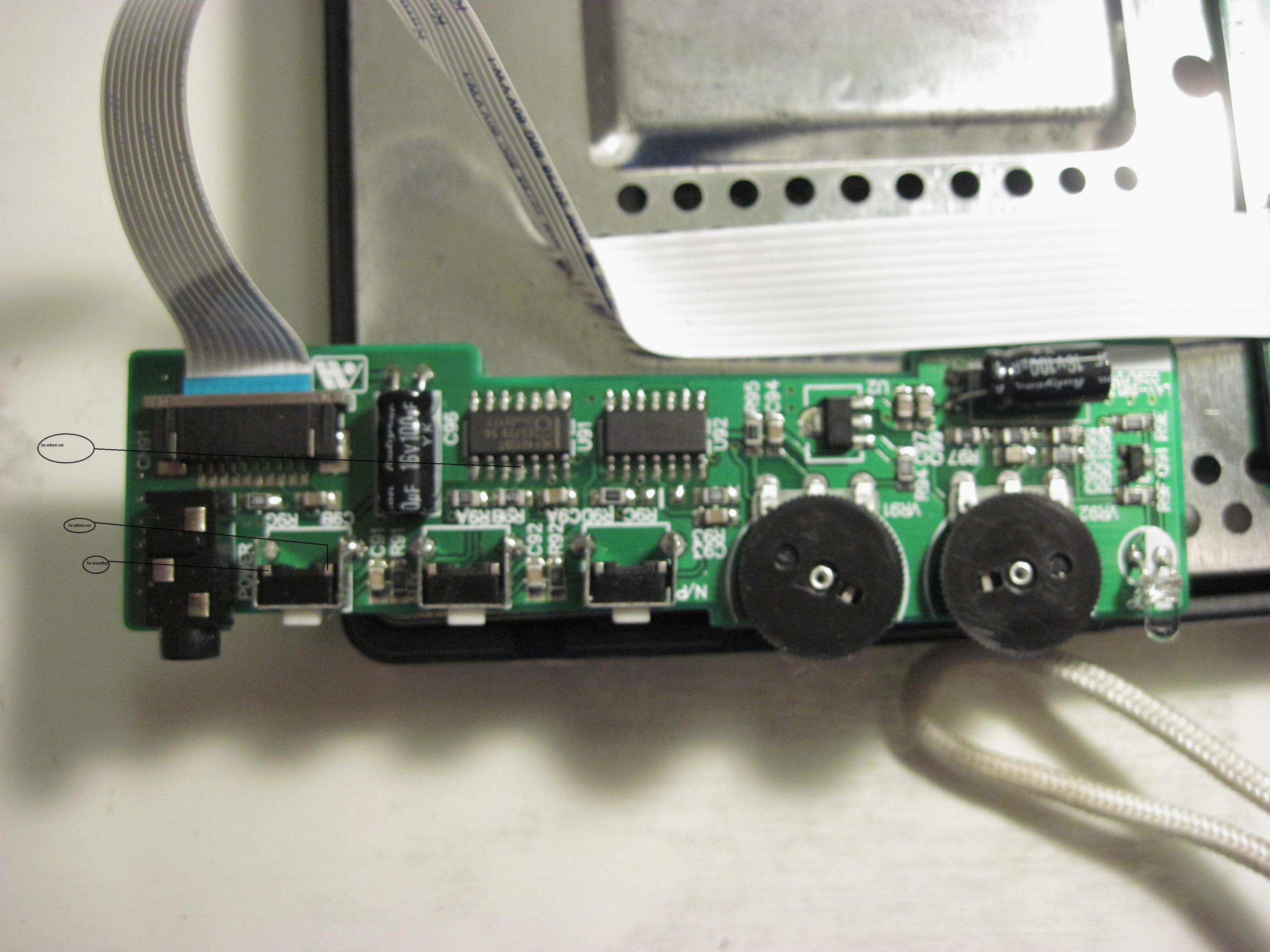

          Sorry for not uploading pic before, I got a problem with my phone. Here are pics showing the device. At the mainboard pic I added some measurements. As for the Q11 its marked BC RB, I tried searching coding but didn't get anywhere.
          The voltage at both Vin for the sharp IC are 0.3-1.5, the 0.3 at standby and 1.5 if I push the PAL/NTS button.
          At CN3 I'm getting 11.95 v at standby. as for the switch board there is 5 v at the on/off button at the leg according to pic. Trying to turn on device nothing happens and the LED stays off. The only change I get is at U91 where the 5 v reaches but nothing else happens, the 5 v disappears from that pin U91 as I release the on/off button.
          As for CN4 which leads to the inverter board beneath I only get voltages from 0.2- (2v with PAL/NTS trick).
          Checked all the smd caps on mainboard, non is shortened to GND. Diodes were ok too.

            sounds like without a schematic we are screwed. Half of the chips I can't read anything off it. Did you try to unhook the inverter board? Maybe it drags something down?

              I thought that too. If it helps I'll try to take some other photos with a better focus!!
              -The Q11 that is marked BC RB, any idea what it is?
              -Same reading as the inverter cable detached.
