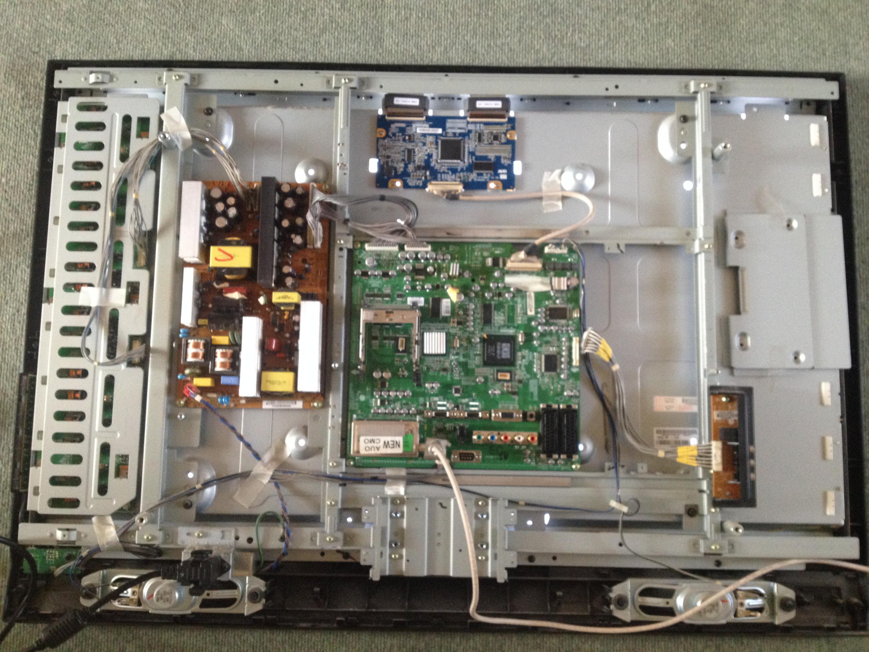

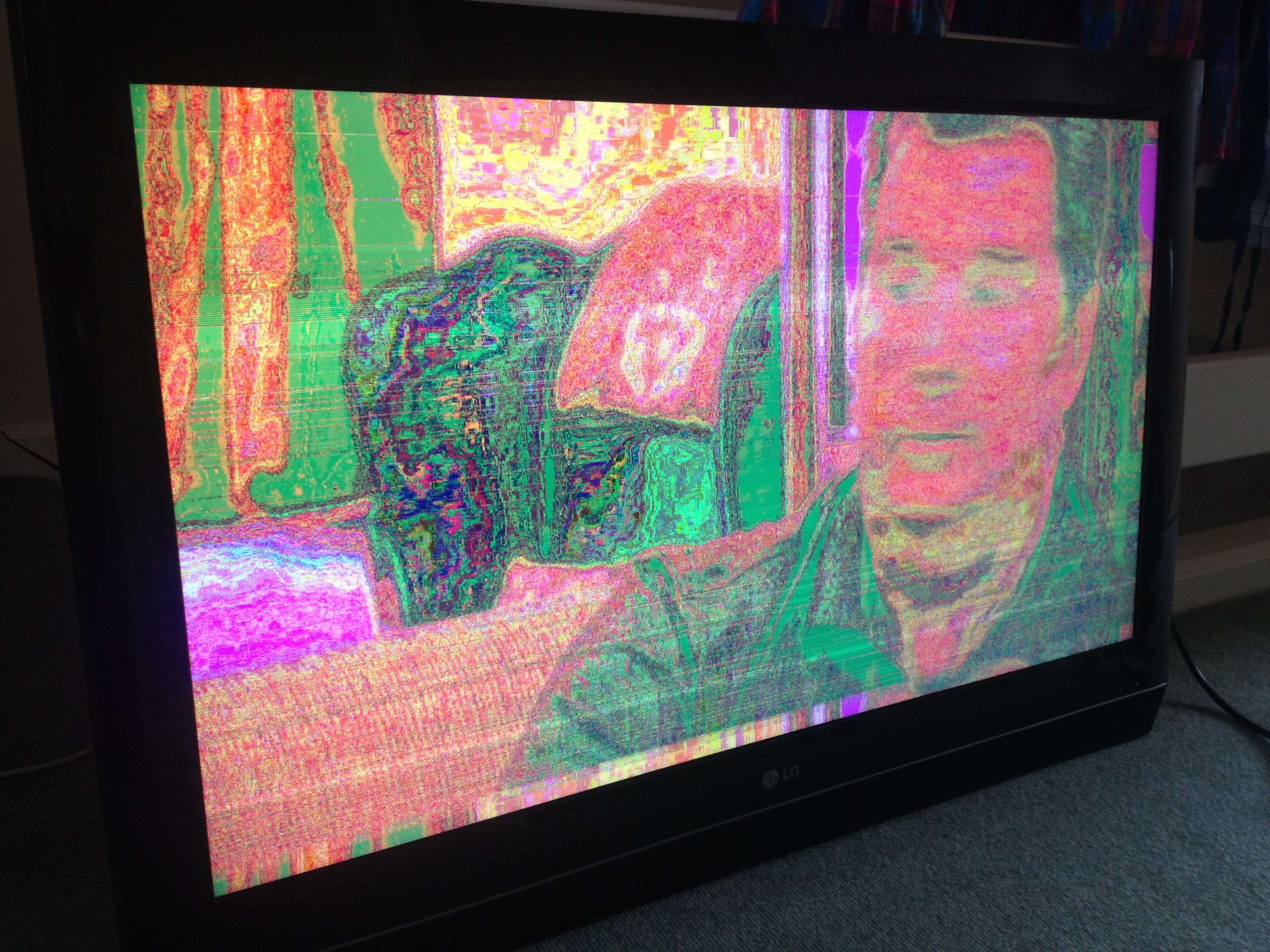

    new project, lol
    solarised picture after being on for a few mins, with lines and jumping picture.
    gama volts all over the place.

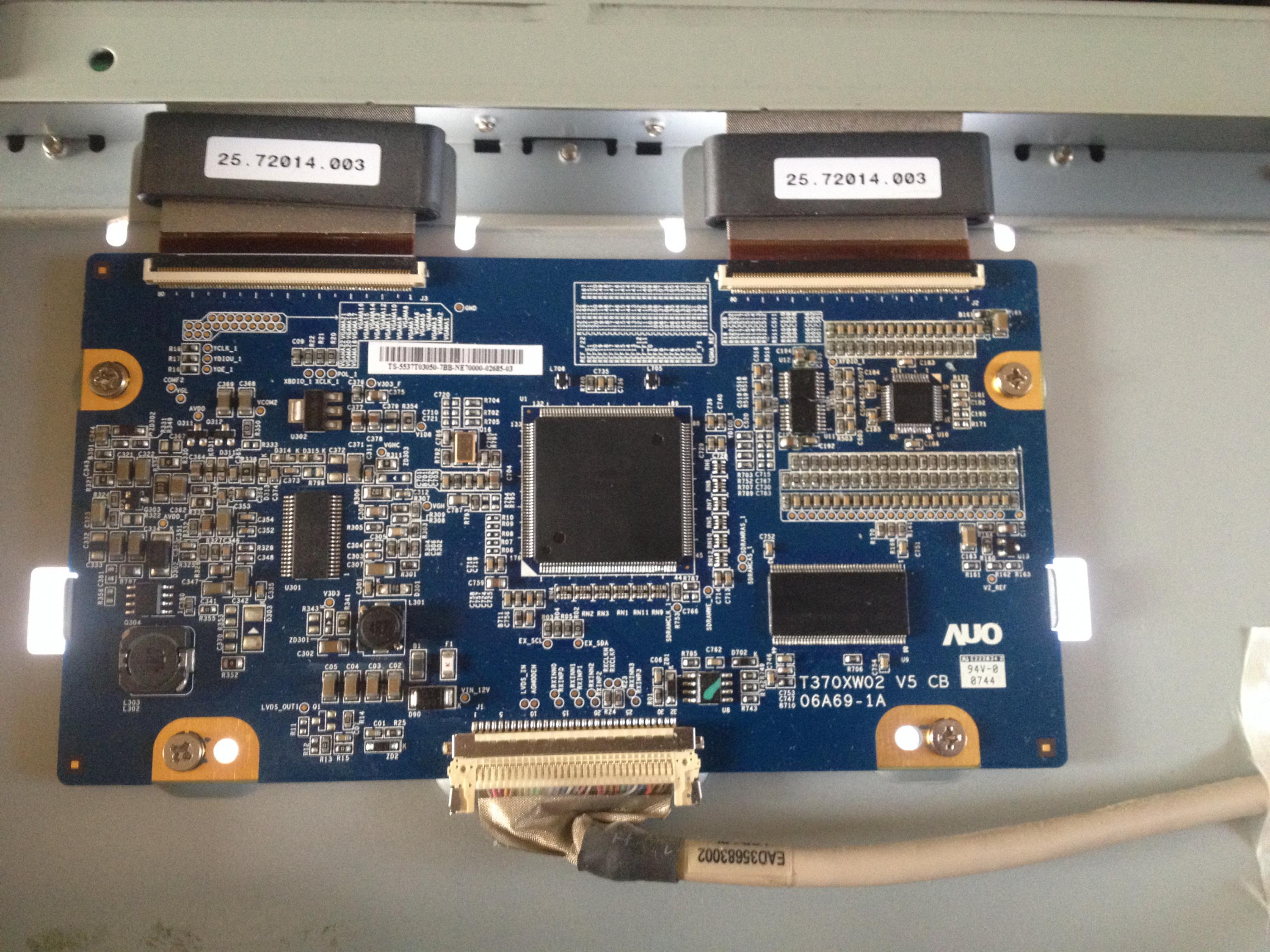

    changed AS15F chip, now got good readings from 15.3 down to 0.3 except 2 test points show the same volts at 4.3 volts.
    tv still acts the same as it did before changeing the AS15F chip ?
    what do you guys think ?

    Re: LG 37LC55 solarised pic
    You may have got a dodgy gamma IC or chip not soldered right... could also be a main board fault.

      maybe tom, but the time it took me to get it right was long enough, don't fancy
      going though that again, it was my first time at one, lol, was on and of 3 times,
      untill i got my USB microscope, man, talk about shorts on the pins, it looked fantastic with a maggy glass.
      but i have got another chip, just in case i messed this one up,
      wonder if overheating the chip with hot air would damage the chip.?
      as it has had a few warmings.
                chip must be 99% on right, may be there is still a bridge somewhere, as 2 test pads show same volts, and there next to each other, 16 and 17

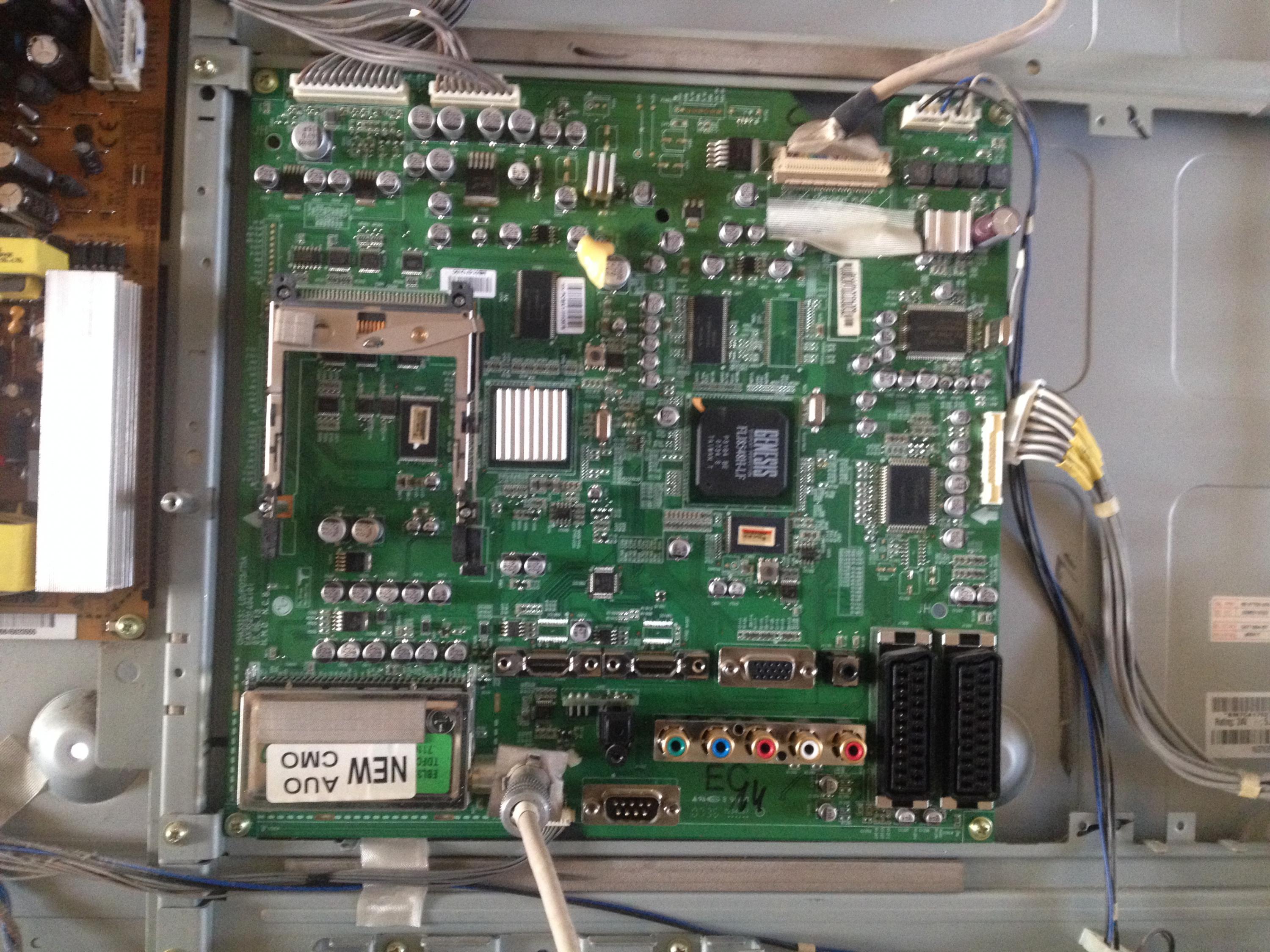

                    ok, now put new AS15 chip on t-con, and voltages are much better, decreses as they should do,
                    still same prob with picture, after being on for a few mins, so gonna put it down to main board, can;t find one the same to replace it,
                    looks like another tv to sell as is.
