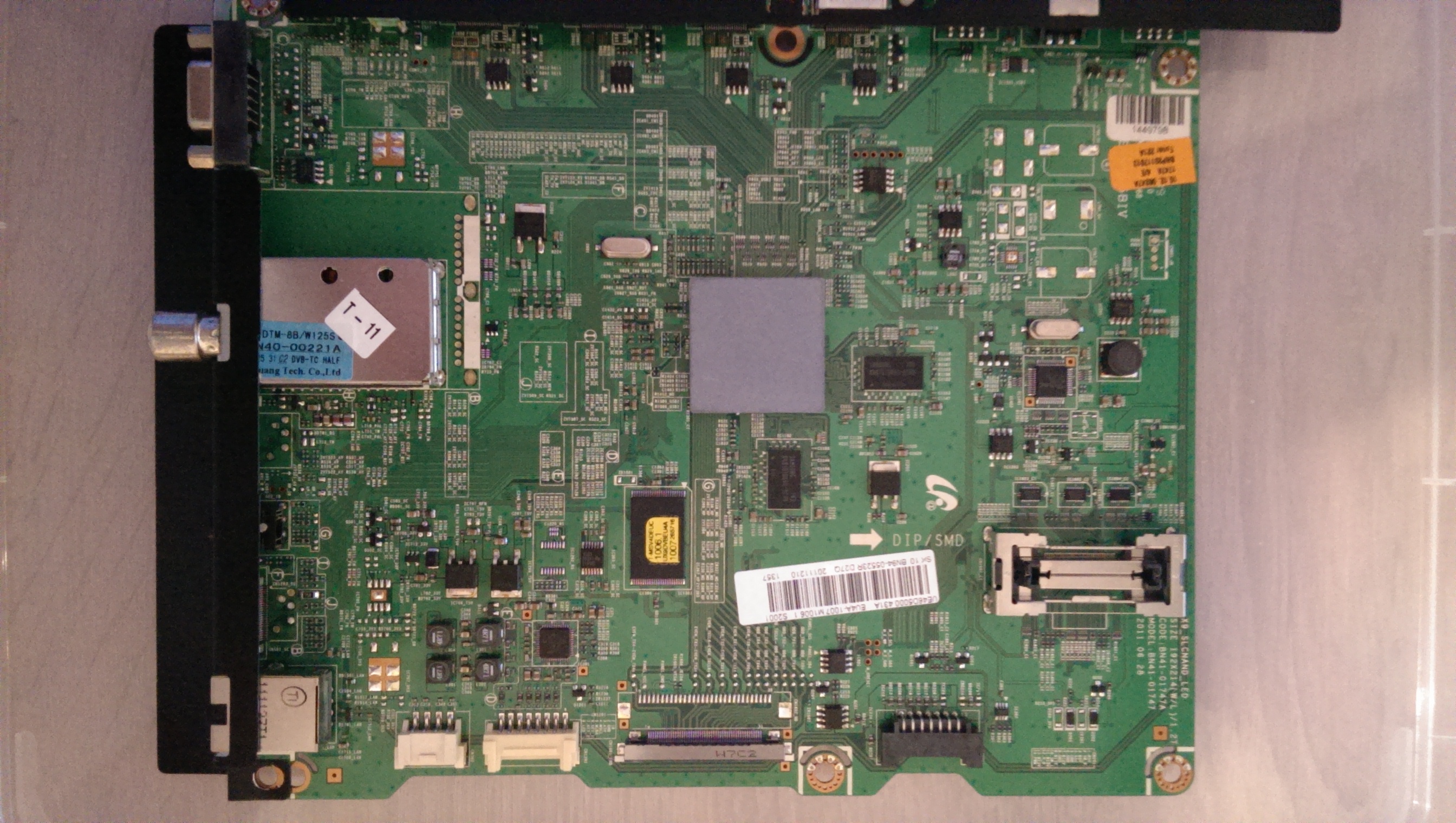

        Hi there,
        I ended up buying a new mainboard for 25€, which solved the problem in combination with the new power supply.

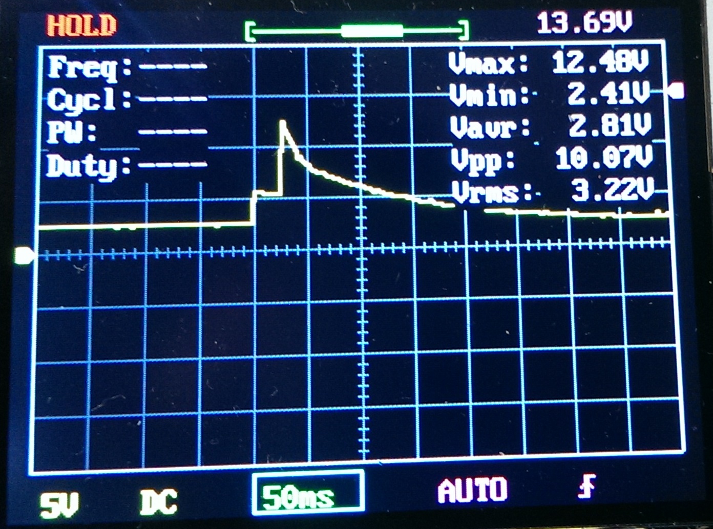

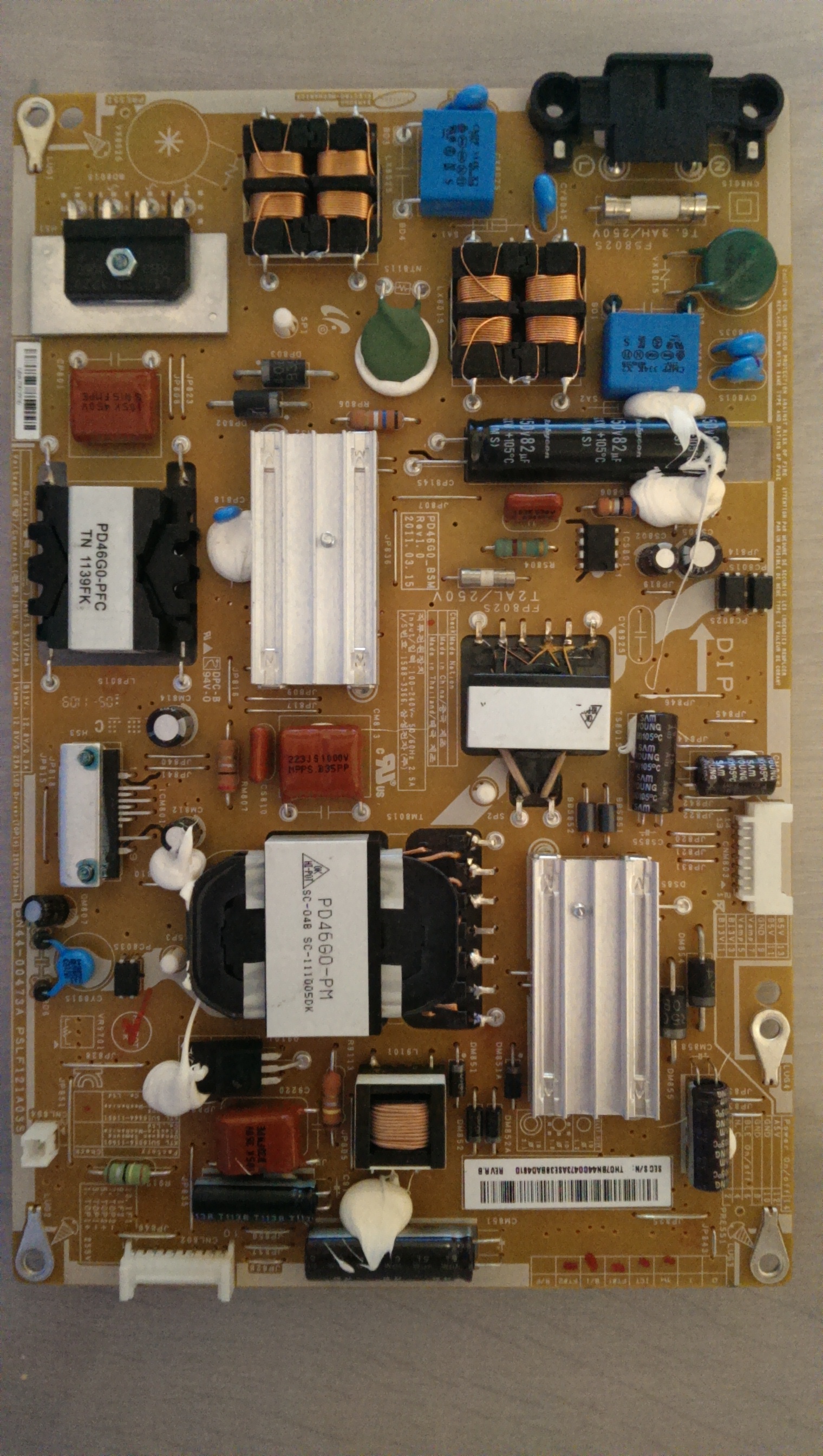

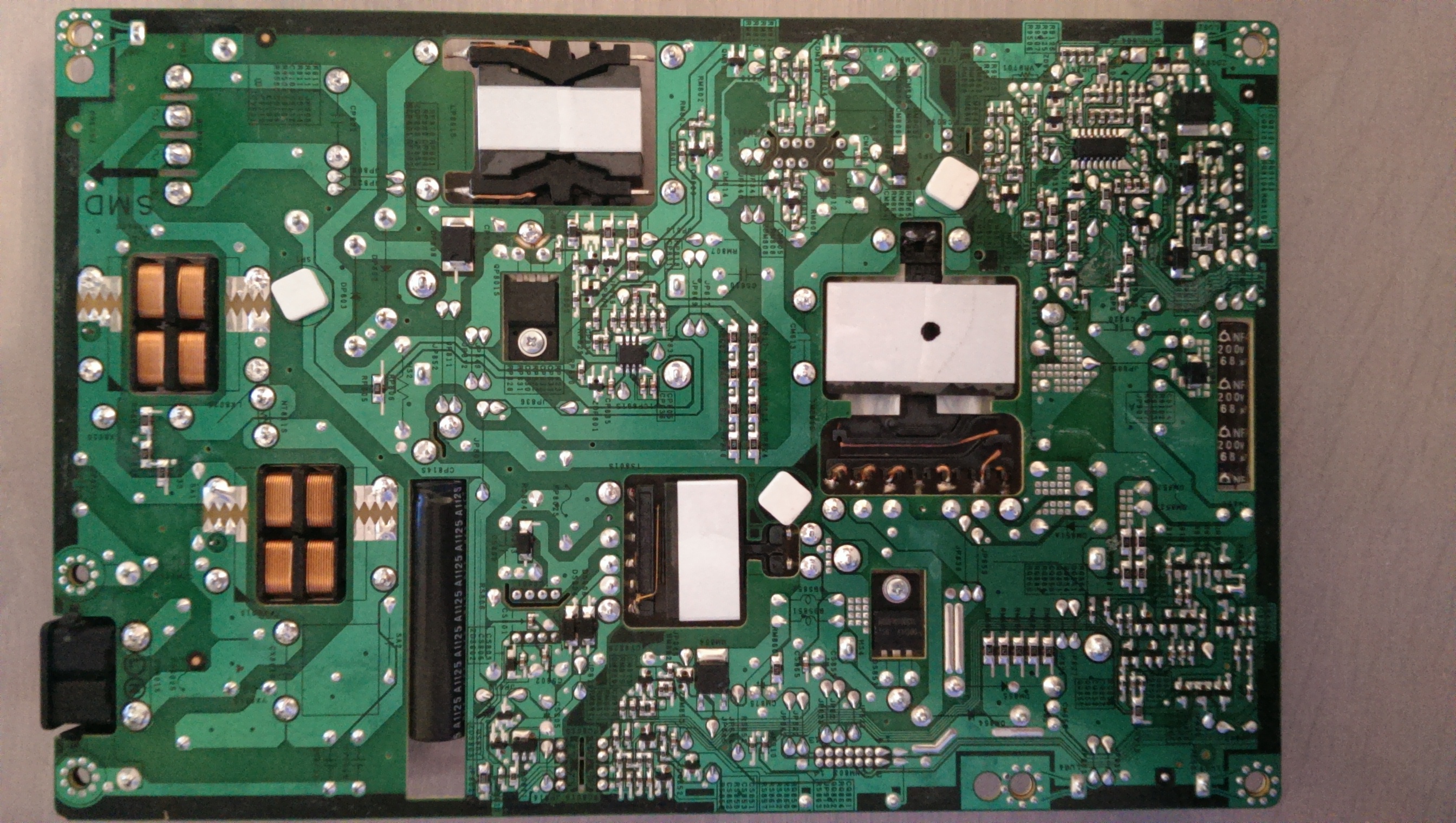

        I unmounted the power supply and am testing it on my table. Without anything connected it just makes a silent clicking noise every second. While trying to find a 5V standby line I just saw, that every voltage is jumping around between 0V to ~18V. Even the Power On/Off line jumps between 1.5V and 3V.
        I attached a diagram of the A5V line.
        There are no bulging caps and the main cap is charged to 385V. Checked both fuses.
        I'm quite surprised by this behavior and don't know what to do.

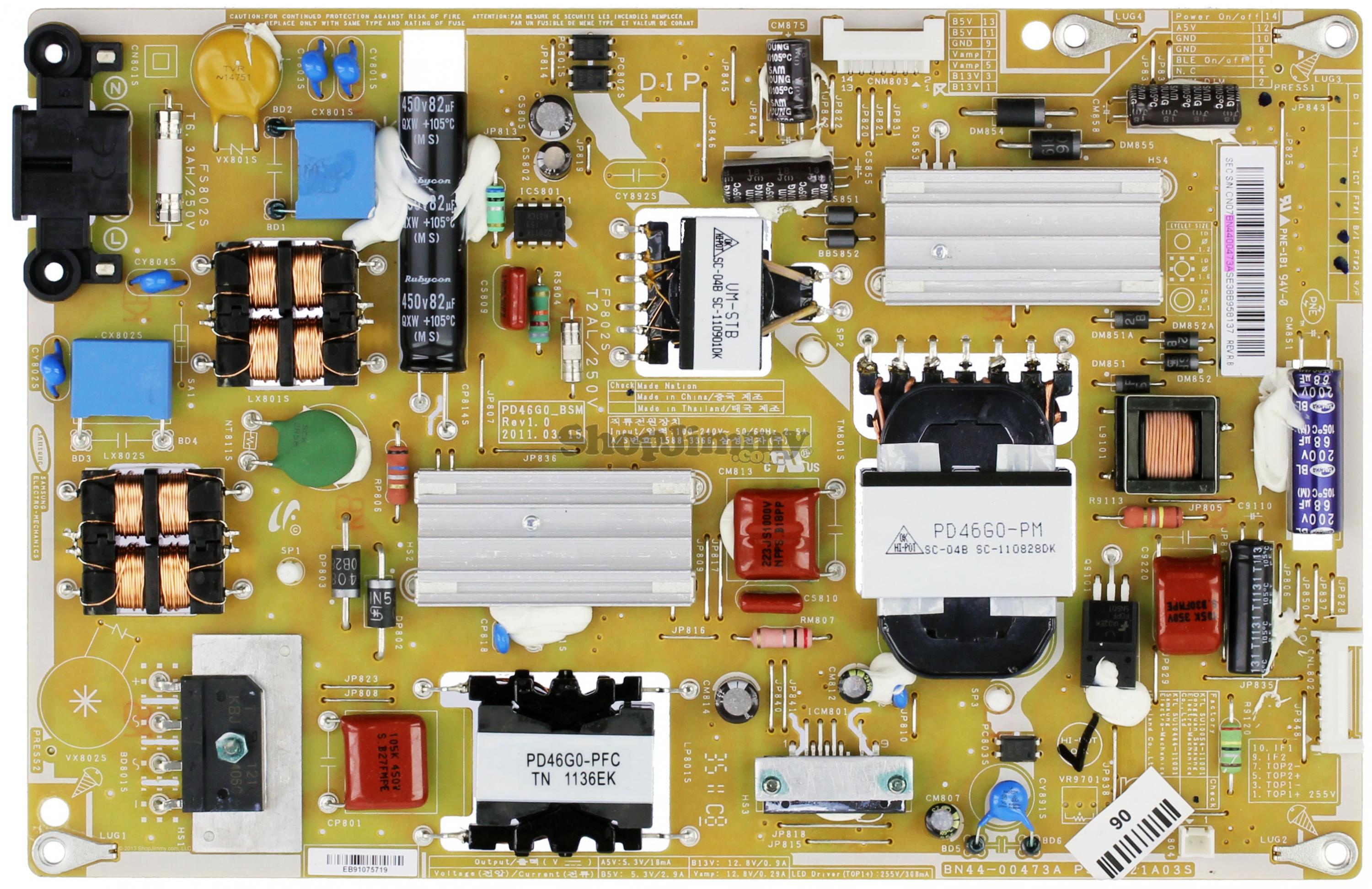

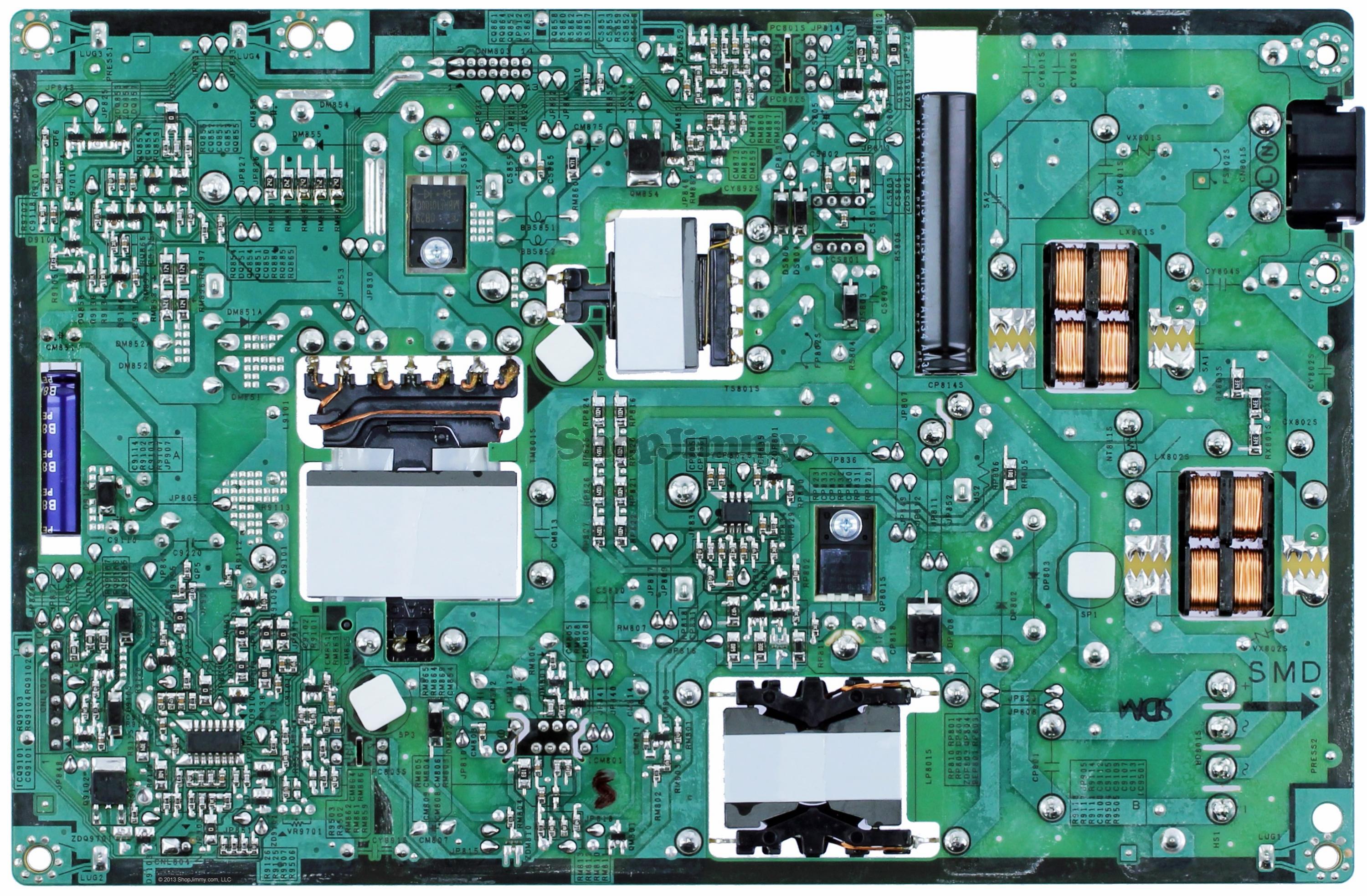

          Re: No Stdby Light Samsung Ue46d5000
          Check the resistance between GND and the A5V pin to see what you get.
          Pictures provided by shopjimmy.
