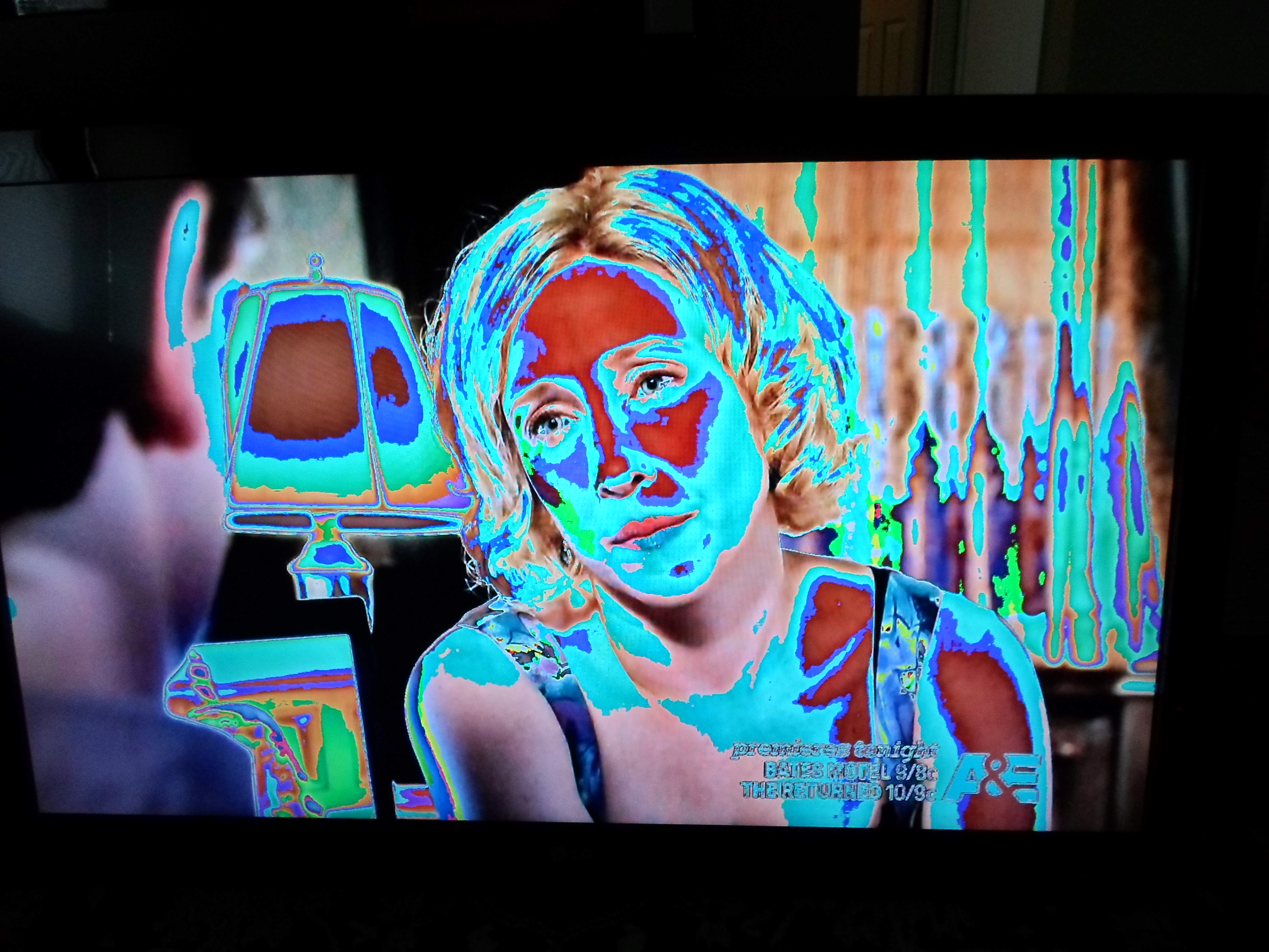

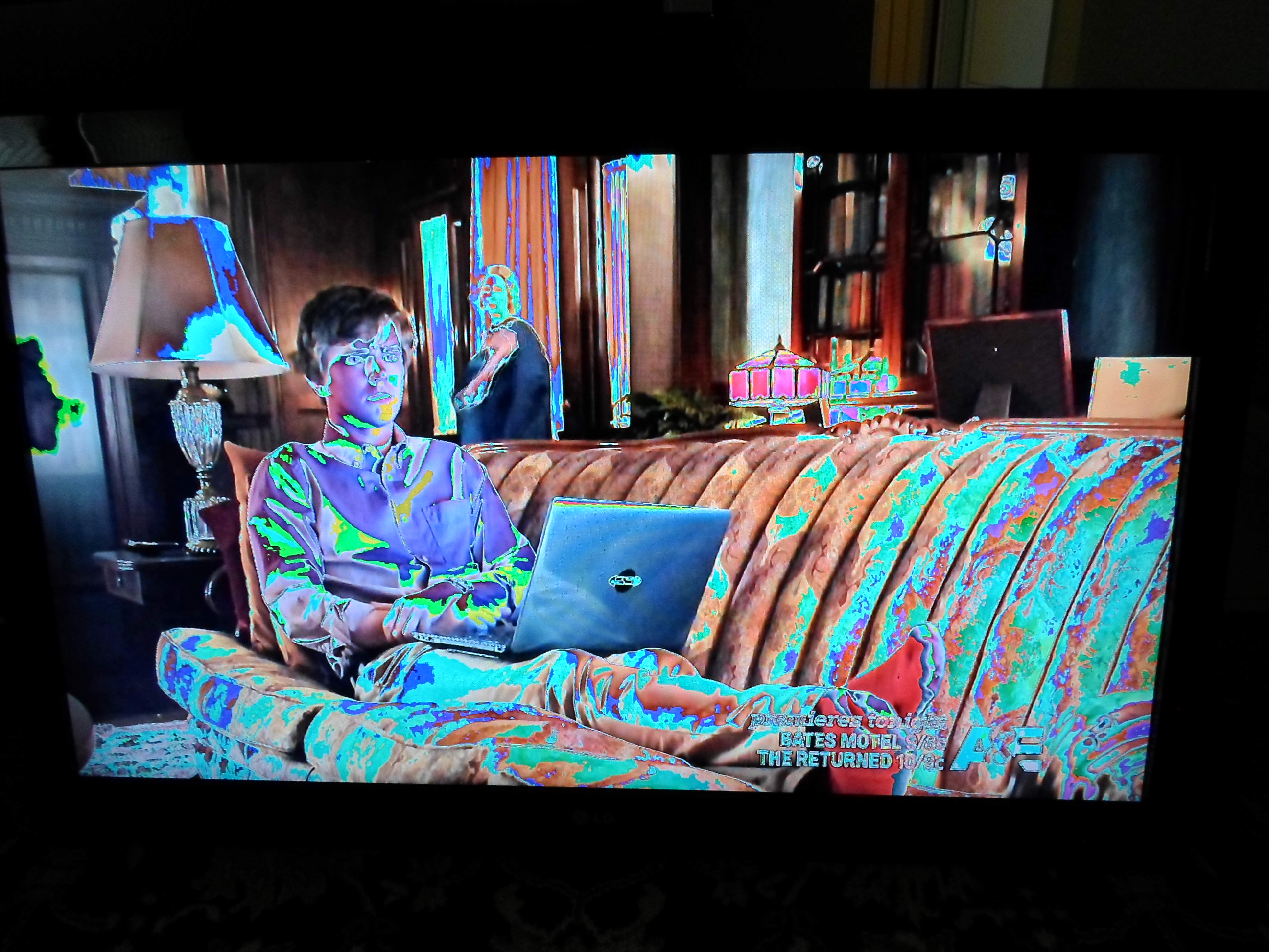

    LG 42LK450-UB.CUSDLH Has Inverted Color After Main Board Replacement
    I have this TV which didn't turn on. I diagnosed as having a bad main board. The original board in the TV is an LG 55.73G01.001. I couldn't find this board, but Shopjimmy has a substitute listed EBT61525903. I found that one and ordered it.
    The TV works now but has the inverted/negative picture like the AS15-19 problem. This T-Con does not have that chip though.
    I'm wondering if the main board is really not compatible even though the full service code matches. The board I ordered shows it's for a LG LC420WUE-SCA2 panel while my TV has a AUO T420HW09 V.0
    Is there a service menu on this TV?

    Re: LG 42LK450-UB.CUSDLH Has Inverted Color After Main Board Replacement
    OK does anyone know if there is a service menu on these where you may be able to possibly change the panel type, and how to access it? Thank you.
      You'll need to change the Panel Type in the boards service-settings--But whether the 'menu/menu' service page goes deep enough I dont know.
      --You may need the computer software and data-lead to do it--Both only LG service centre stuff....
        I was able to get into service menus
        http://openlgtv.org.ru/wiki/index.ph..._modes_/_menus
        using a universal remote
        http://openlgtv.org.ru/wiki/index.ph..._menus_/_modes
        But not way found to change the panel unfortunately.
          Replaced main board with part # EBR73308816 and it works fine.
