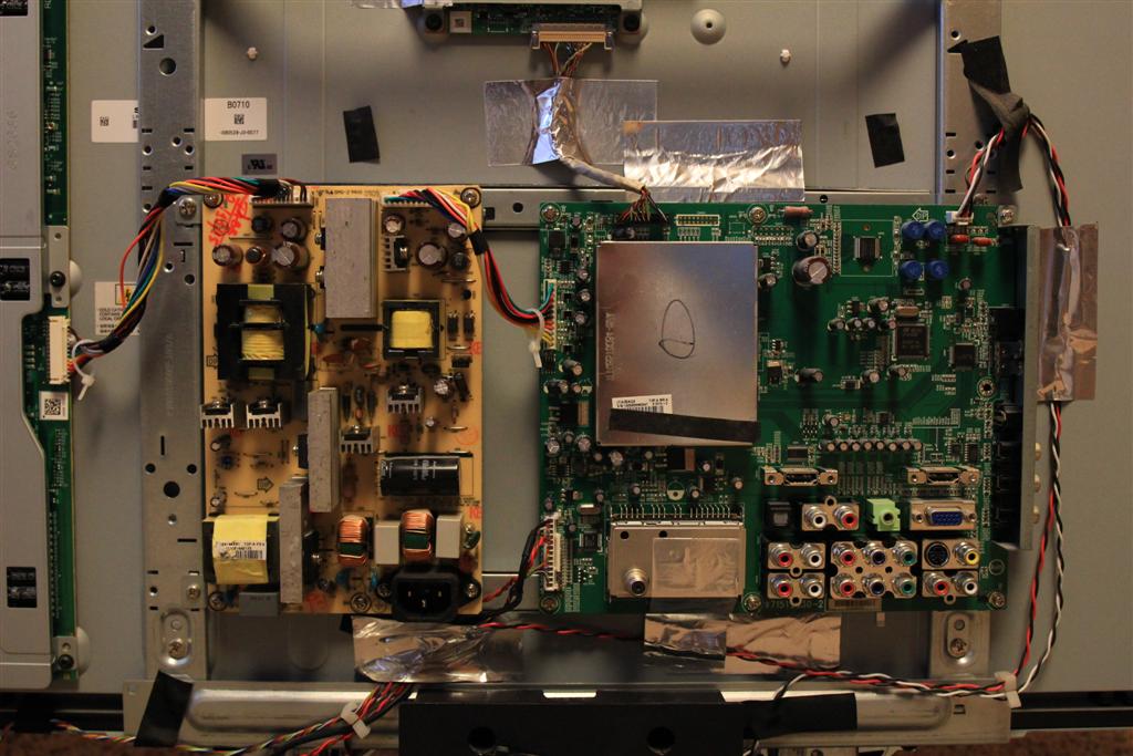

    I figured it was the power supply board so I bought one online but the problem is the same regardless of if I use the original power supply board or the one I just bought.
    Turn the TV and then after a bit it will turn off, then awhile later it's back on again. I unplugged the cable off the top of the power supply board (when looking at it from the back of the TV) that goes off to the left into the center of another board (maybe the backlight board). Same problem.
    There is also a cable coming off the top of the main board that goes up to the top of the TV in the center which I'm guessing is what drives the LCD panel. Disconnecting that also makes no difference.
    So the only thing left is the main board. Can disconnect the cable that goes to it as obviously nothing works then. Is there anything on the main board that someone could point me at the would cause this type of issue?

    We need to see the pictures of the whole back side of the TV so we can see how all the boards are connected together and understand all those boards you connected and disconnected.

      Sorry it took awhile to get back on this but here is the picture of the back of the TV that shows the cables I was talking about.

        OK, the top right connector of the power supply that goes to the main board on the right of the power supply, does that connector on the power supply have any label for each pins to tell us what they are? We will need the DCV of the PS-ON pin, 5VSTBY (if it uses 5V for standby Voltage).

          Yes the connector (going from left to right) has 1 green wire (can't read the signal name), 1 blue wire (signal name ends in "DIM", 2 red wires (12V), 3 black wires (Gnd), 2 orange wire (24V), 1 white wire (PS), and 2 yellow wires (5V).
          I measured the voltage and the 5V is always on, and the PS signal goes away when the TV turns off, the 24V signal slowly goes to 0 when the TV turns off, and 12V immediately goes to 0 when the TV turns off. This is the same regardless of whether I install the new Power supply board I bought.
          So what next?

            Re: Insignia NS-LCD32-09 keeps turning off and on again
            So the PS-ON command from the main board is there then disappear, it is generated by the main board to turn on the 12V (for sound) and the 24V for the inverter board.
            You will have to do visual inspection of the main board next, look at top and bottom side of the board to see if it has any bad solder joints, burnt parts, and etc.

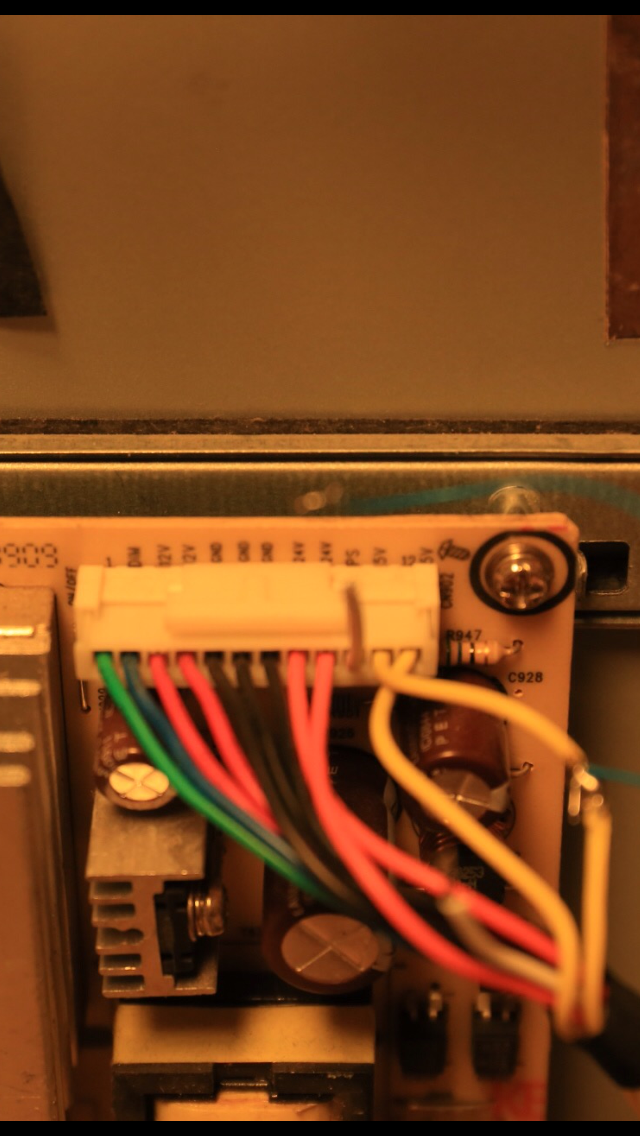

                          I need to see good clear pictures of the connector, since now you have 12V and 24V but no backlights, it may mean that the BL-ON signal is also gone now too.
                          "The 24V and 12V don't go away when the TV turns off either" that is because the power supply is forced on so the 12V, 24V will be on 24/7 as long as the TV is plugged into the outlet.

                              Here is a closeup of the top right PS connector that you requested.

                                OK, I found good picture at SJ:
                                http://www.shopjimmy.com/vizio-insig...wer-supply.htm
                                CN902 ON/OFF pin is the backlights ON/OFF control pin.
                                So see if it has >2V on that ON/OFF pin.

                                  OK I'll look at this tonight when I get home. I think it is the green wire on the far left of CN902 that I sent a pic of. There is silkscreen to the very left of the edge of CN902 that says ON/OFF.

                                    That is the one, it is the backlights on/off (BL-ON) control pin.
