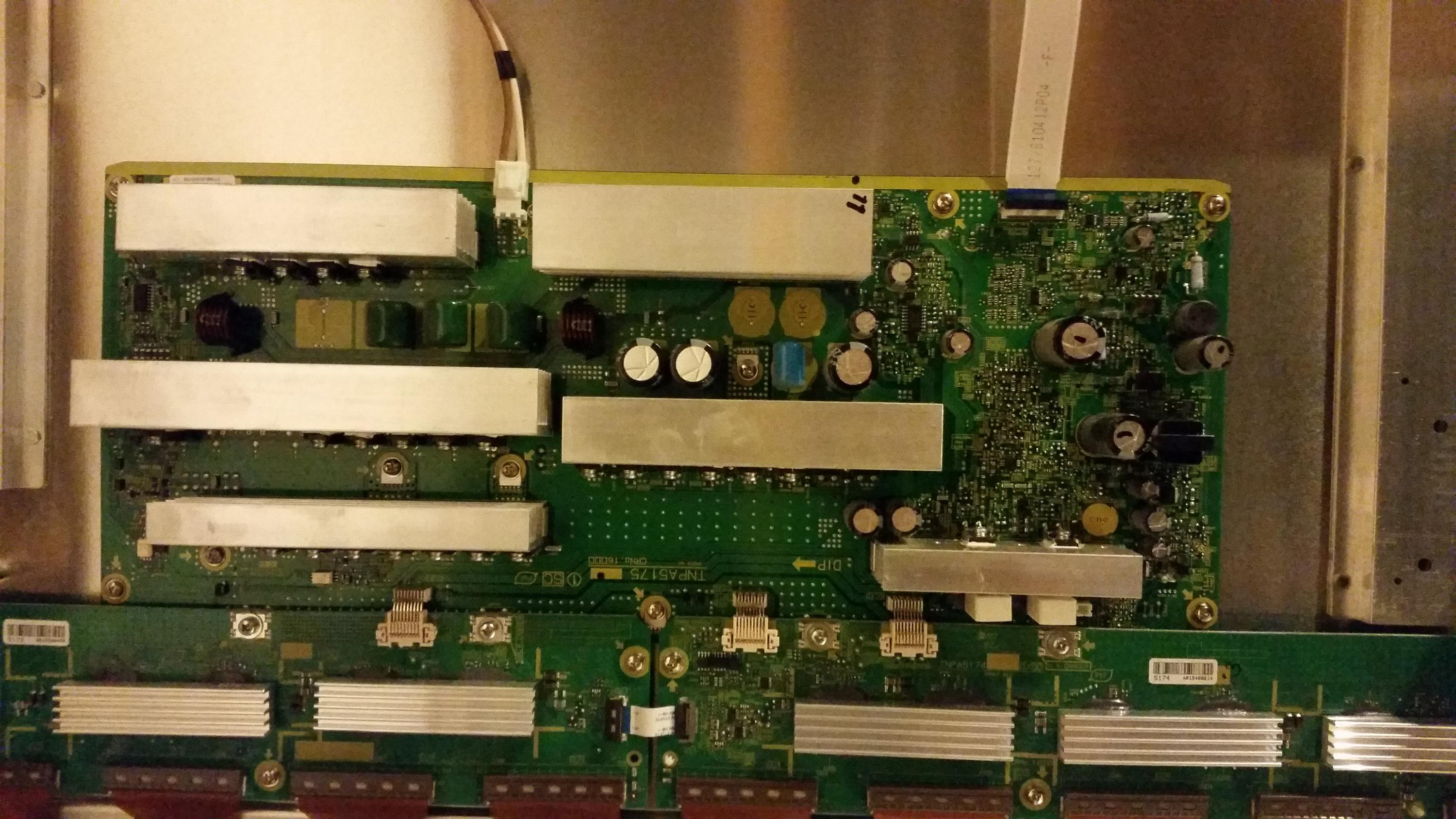

    First off I am a newbie to this and am trying to save a TV that I cannot seem to find an SC Board for(which I think may be the problem). If this is something that I can be guided through to find the problem I am fairly proficient with desoldering/soldering. I just am not sure what and how I need to test the board components. That all said here we go!
    I have a Panasonic tc-p58s2. It has the 7 blink error when powered up. When I disconnect the power and ribbon cable from the SC Board, then I had 6 red blinks. I hooked the SC Board back up and disconnected both the SU and SD boards and then powered the unit up. Then I still received the 7 blinks. I wanted to check if this means that I have isolated the SC Board as the issue?
    I saw on another post on here: https://www.badcaps.net/forum/showthread.php?t=36114
    This lead me to believe that the SC board is most likely at fault, or the buffer boards (which I am not sure what those are)
    If the SC Board is the likely culprit can anyone help advise me on what testing should be done to find out what the problem components are? If any additional pictures or close ups of a certain part of the board are needed please let me know. Thanks in advance for any help! It will be greatly appreciated.

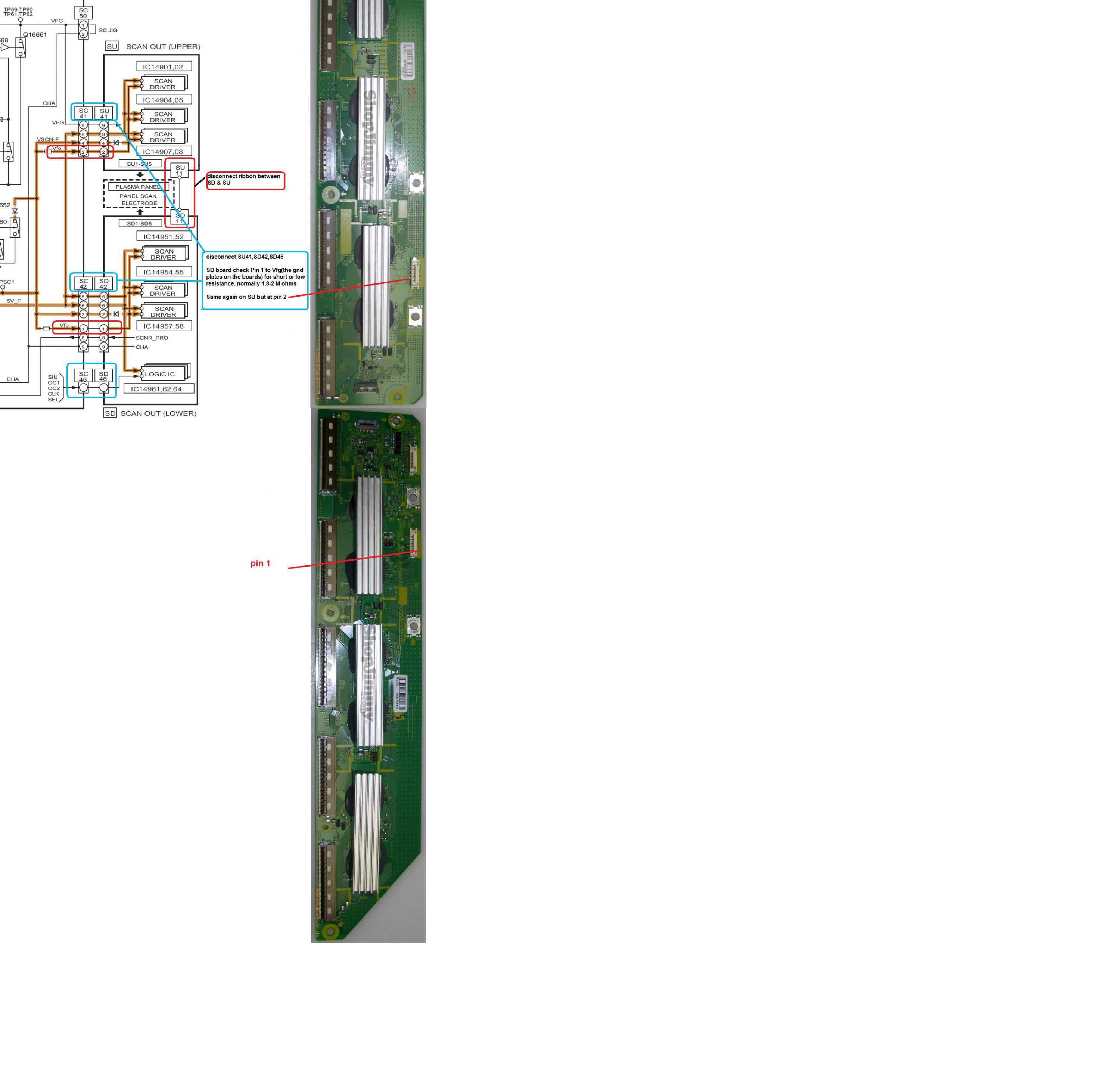

            go to the block diagram in the manual and find where it shows the sc sd su boards
            identify the pins for Vfo, VSCN-F, & 5V_F on the sd and the su boards. disconnect the small ribbon between the sd/su
            then measure the resistance for each of those points on each board and post them up. you'll need a meter that get go to about 5-6 meg
            measure reference is vfg which are those metal plates on the buffer boards

                    does not sound promising, that's bad luck, normally the buffers survive but this can happen. I've had it myself.
                    see if you can make sense of the image I've created
                    • engelwood39
                      • Mar 2015
                      • 93
                      Re: Panasonic tc-p58s2 SC, SU or SD Board issues
                      On the SU between pin between pin 2 and Vfg it is shorted. On SD board and pin 1 it does not show a short.
                      • tw2005
                        • Oct 2011
                        • 6457
                        ok, so are you able to measure resistance at the SD42 pin1 and recheck that there are shorts between the gng plates and the outputs pins. Normally if output short , Vfo shows short but maybe it has low resistance just not low enough to trip the continuity beeper.

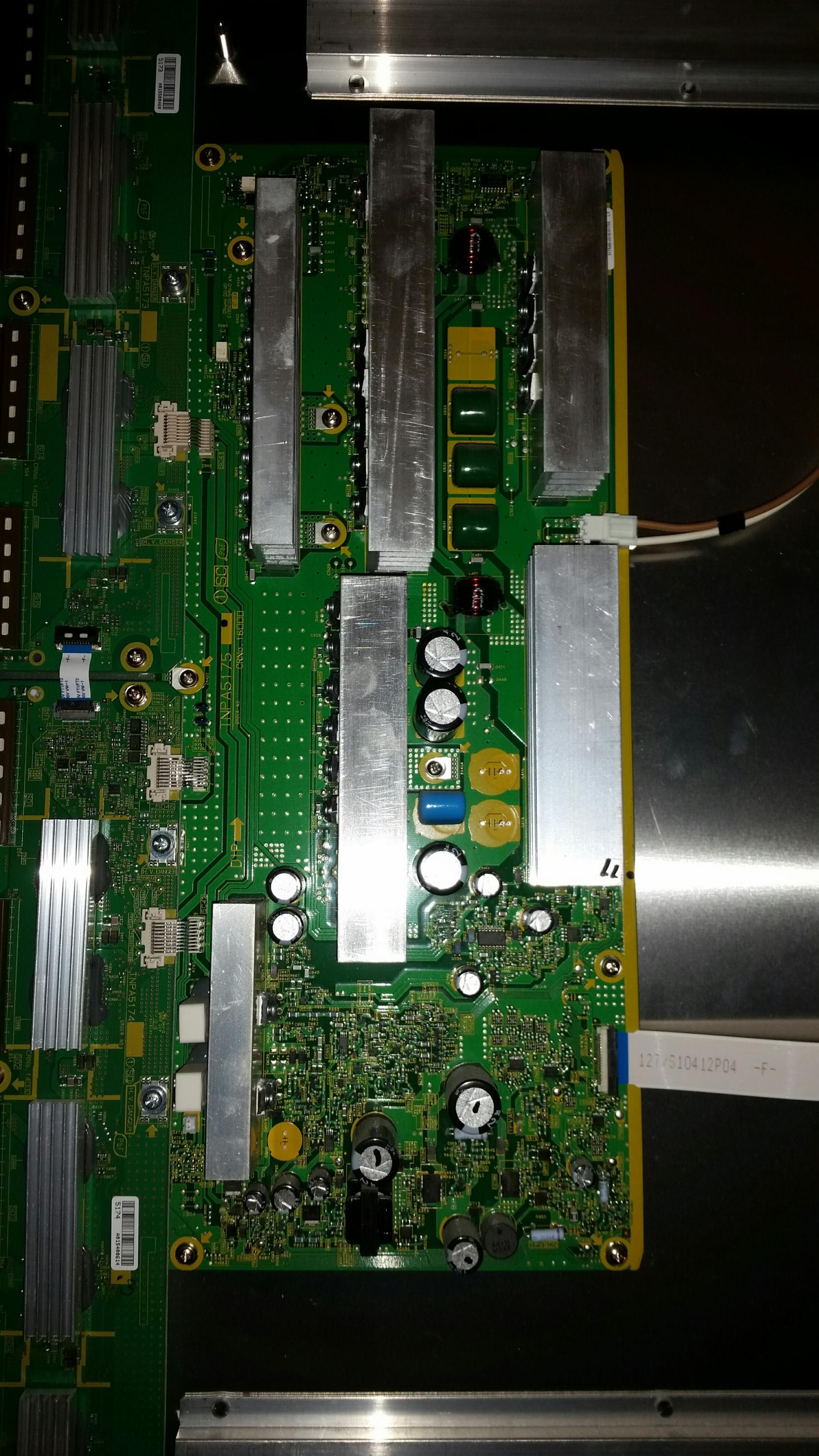

                                    Okay... I was finally able to the SU and SD boards on Ebay for a justifiable price. I also found and bought a SC board, (It is the same board number) but it has different style plugs that go to the SU & SD boards (I didn't know this when I purchased).
                                    I know the old SU and SD boards were bad because they showed shorts on multiple pins on the ribbon connector to ground. When I power the TV up with either of the 2 SC boards I have and leave the SU and SD boards disconnected from the SC board I get a 7 blink code. I don't see an led light up on my old board, but I do see a green led light up on the new board.
                                    On the Service manual it says 7 Blinks are SU & SD board (check points) It says 6 Blinks is SC (check point)
                                    What I want to know:
                                    -What does the 7 blinks mean when the SC is not connected to the SU & SD boards?
                                    -Is it safe to try the new SU & SD boards with the old SC board that has no led lighting up?
                                    -If that's not recommended should I desolder the pin connectors out of the old SC board and put them into the new SC board that has a green led but slightly different pin connector?
                                    Please advise
